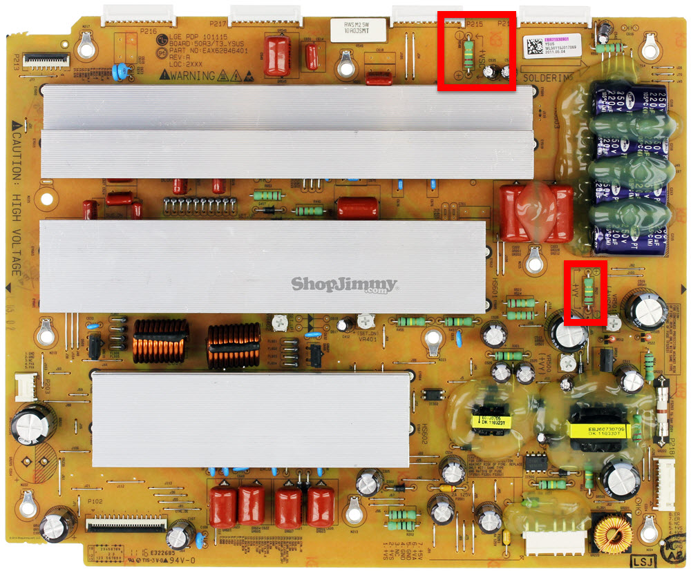

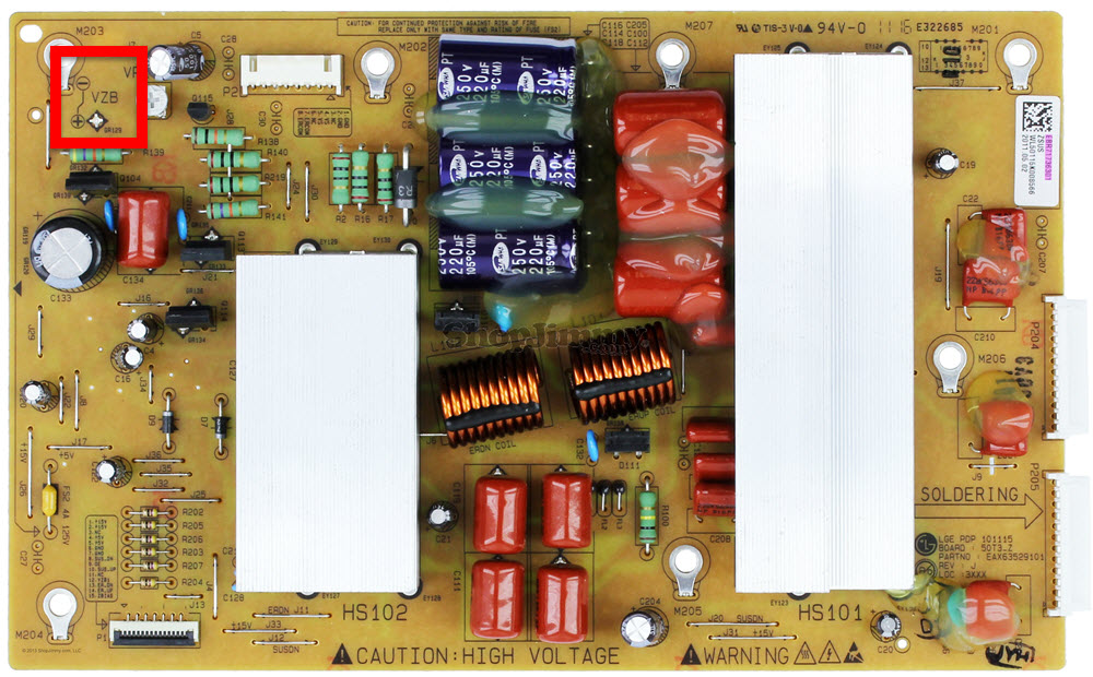

    Can you post a pic of the label that lists the panel voltages? I've attached pics with the test point locations on the YSus and ZSus.

      OK...sticker reads:
      5v/Va:55v/Vs:205v
      300v/-193V/NA/90v
      took measurements and got following results -
      Va=55v
      Vs=205.3v
      YSUS -
      +VSC = -35v
      +VY = 14.4v
      ZSUS -
      VZB=89.8v
      so, I assume the 300v and -193v on the sticker are the YSUS voltages and I am way out of spec.
      If I need a new YSUS board is there any way to test the 2 Y Buffers to see if I need them as well? Is there a particular resistor or transistor that fails on the YSUS that can be replaced and upgraded? I do not see any burst or swollen caps on the board.

        Re: LG 50PT350 sound but no picture
        Before you buy a new ysus, unplug the buffer boards and check the voltages again.
        You might find when the buffers are unplugged the ysus voltages are ok and it's the buffers dragging them down.

          Ok...unplugged power ribbon from lower Y Buffer and re-measured
          YSUS -
          +VSC = -35v
          +VY = -178v
          So now +VY has now gone from +14v to -178v?
            Ok ysus is bad. Probably not that hard to repair.
            Check for shorts on the heatsink igbt's and diodes.
            You may also have shorted buffer ICs, you'll need to check these.
            There are a few videos on YouTube how to check buffers.
              I'd totally disconnect the buffers from the YSus then retest. Also, I'm not sure what the 300V on the panel label represents, but VSC is normally somewhere around the 130-150V range for most LG panels.
