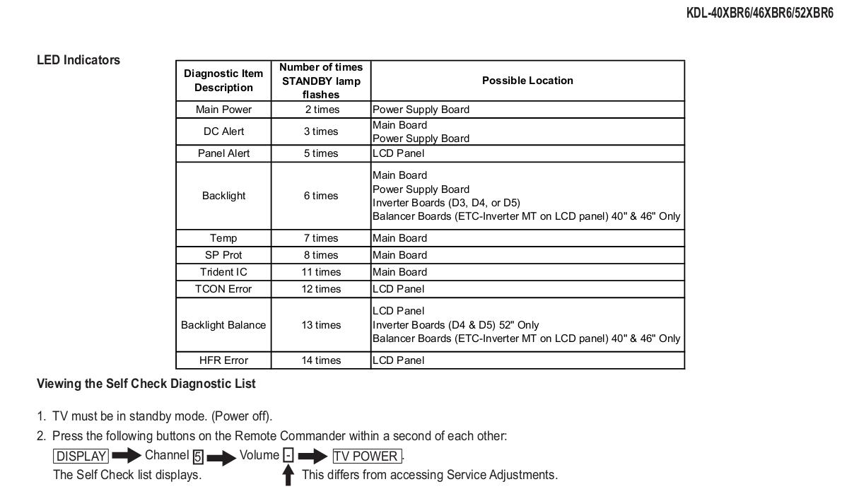

I have this sony, as soon as i plug it in it turns on and screen is light blue then after about 45 secs it shuts off to a 14 blink code. I have heard 14 blink is panel failure but thats only if the set will not turn on, the set turns on but screen is light blue, im stuck between would this be tcon or main?
SONY kdl-46xbr6 14 blinks

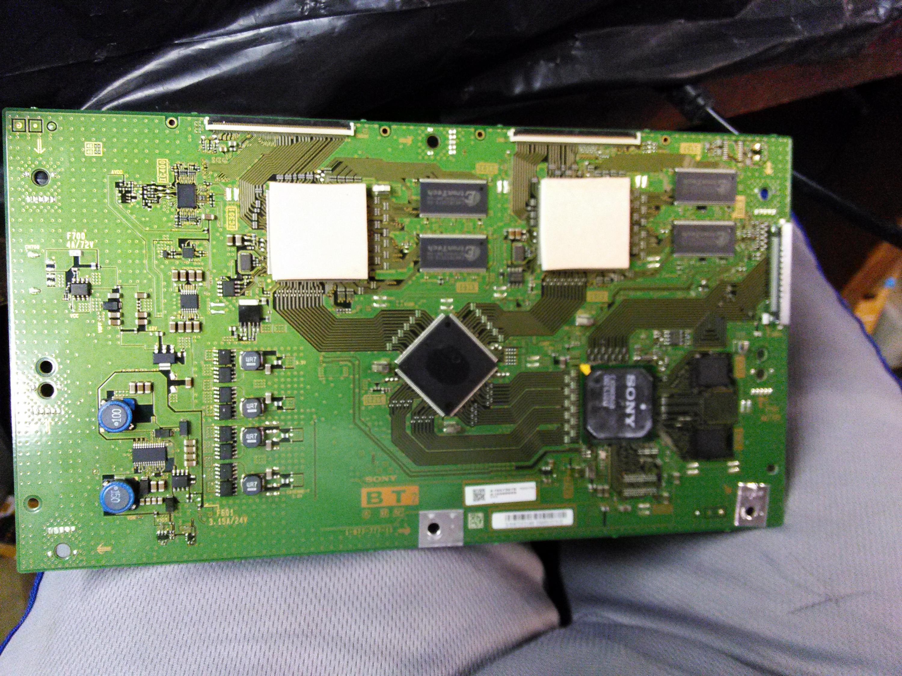

Show us the good clear pictures of the T-CON board so we can try to locate the SMD fuse. You have meter, right?Never stop learning

checked the fuses there is like 3 of them the little smd fuses I checked them all there good. could it still be tcon? I was thinking main boardComment

Try disconnecting the ribbon cables from the LCD panel to the T-CON to see if the error goes away.Never stop learning

Well, let start with this, where are the pictures I requested?

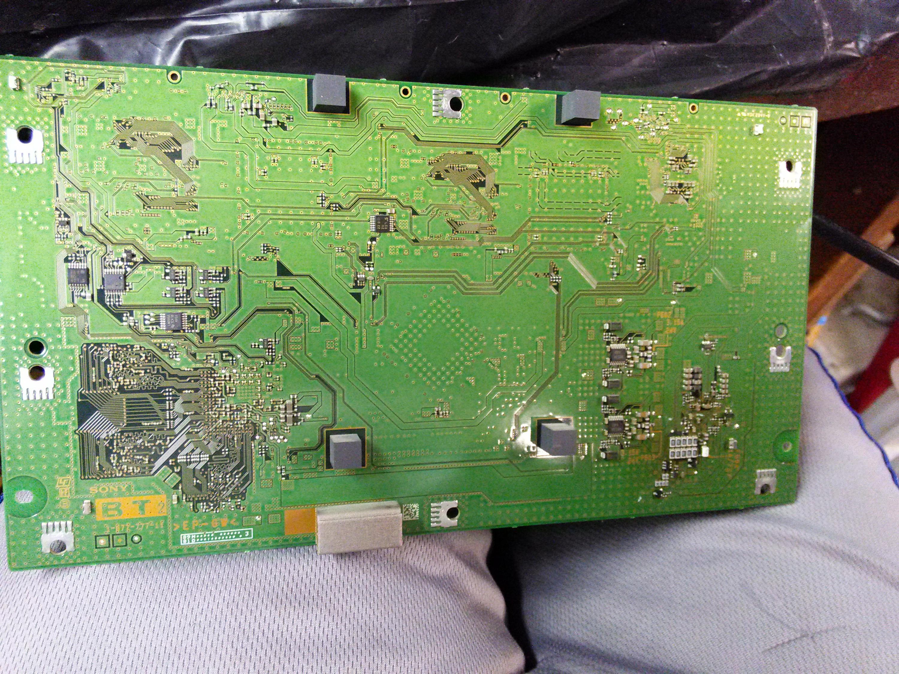

There are 3 fuses on the top side of the board (F700, 701, 601) and 3 on the bottom side of the board F602, 603, 604.
To test the Voltages, you will set the meter to DCV, black probe on the chassis, red probe to each end of the fuse and reports the readings.
There are also test points for the Voltages as printed on the board.

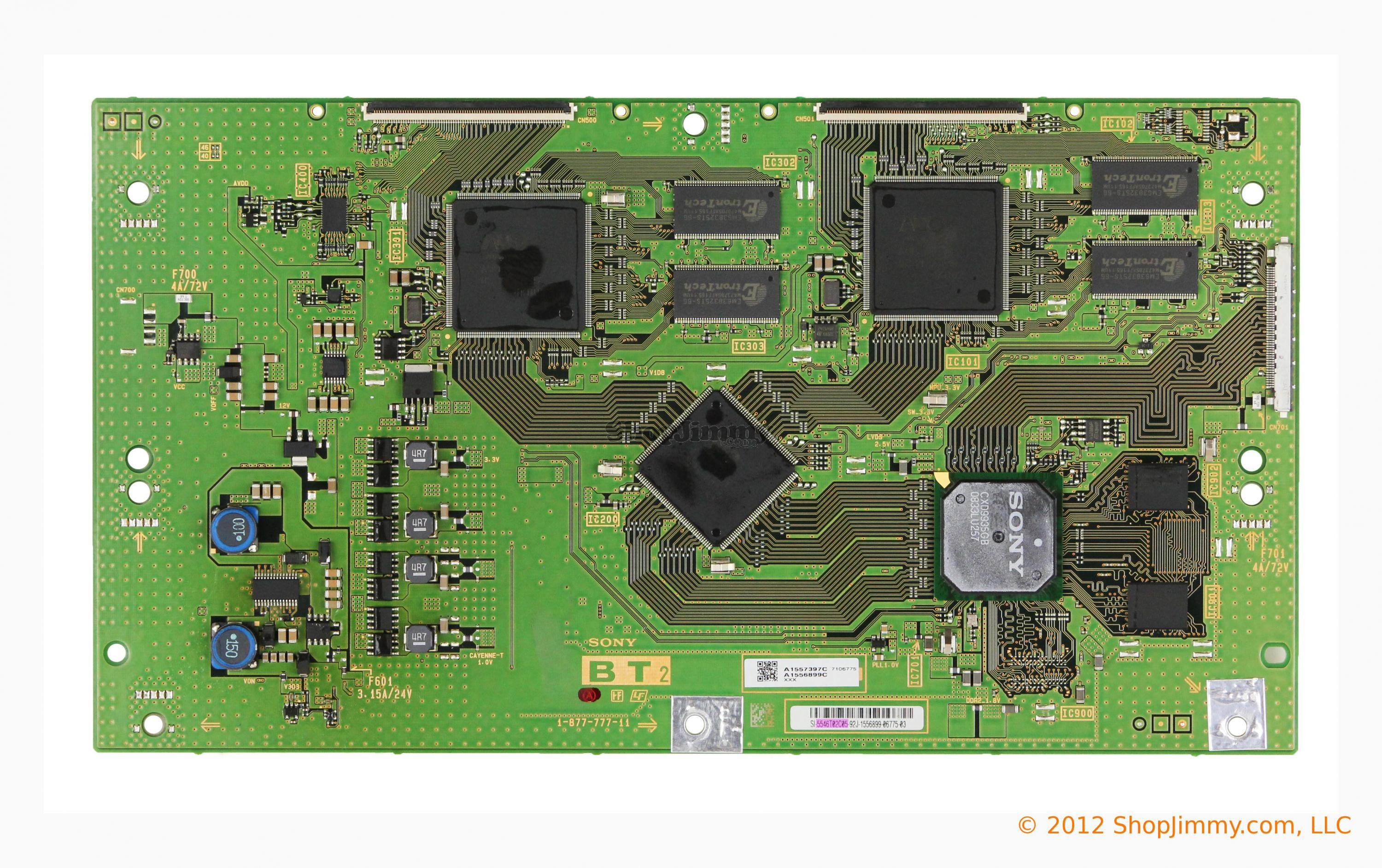

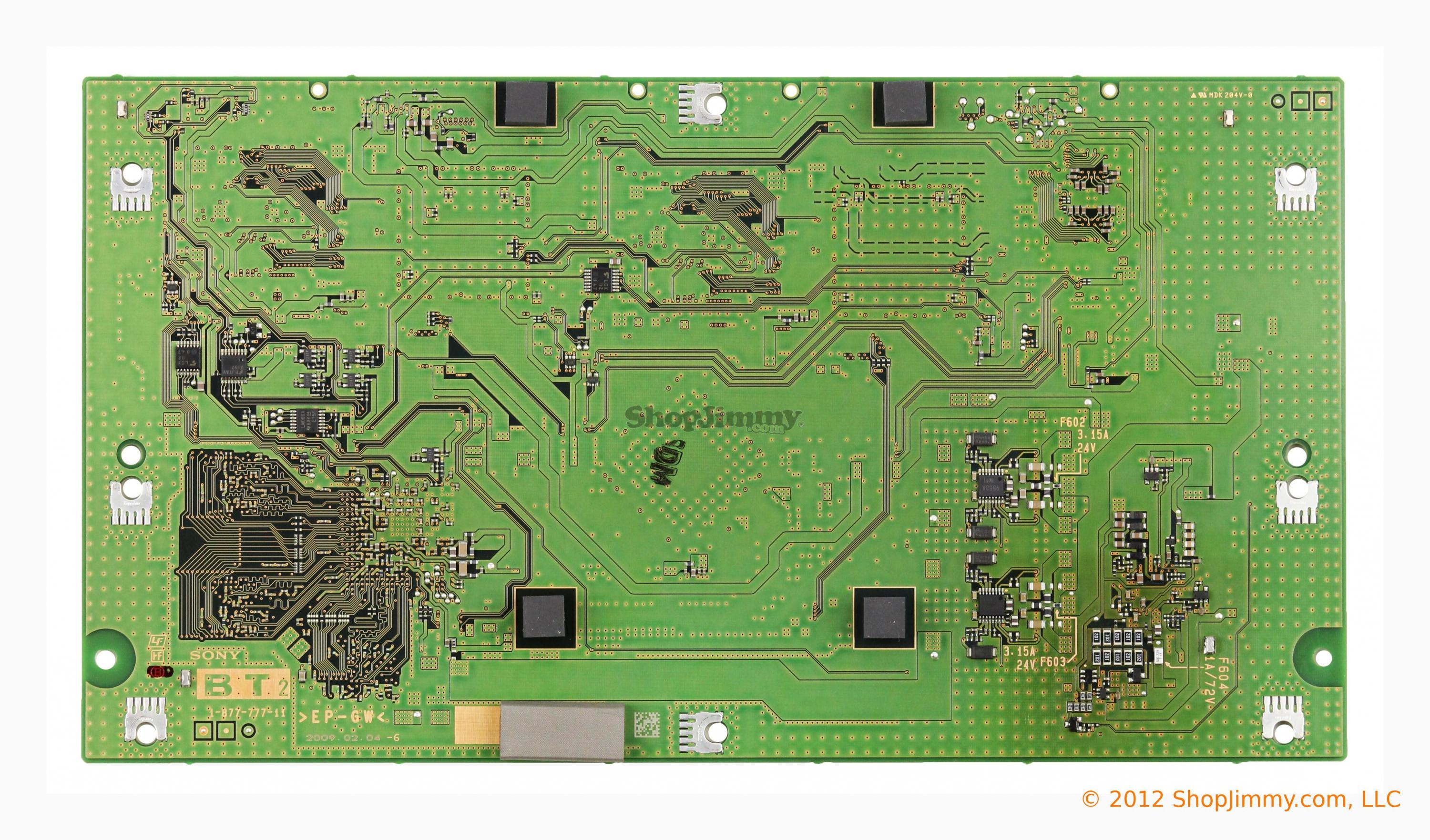

Your pictures are way put of focus to see anything clearly but luckily SJ has the goods pictures.
http://www.shopjimmy.com/sony-1-857-...con-board.htm#Last edited by budm; 04-05-2015, 06:18 PM.Never stop learning

ok so I disconnected the ribbons from the lcd and yes still same problem, the tv screen lights up then after about 45 secs it shuts down and its a red blink code 14 blinks. so are we thinking its bad lcd?Comment
