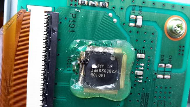

    Hi guys ! long time lurker here
    So it is an LG 50pm6700, chassis pdp50r40000
    No picture at all but sound on hdmi source by going blind at selecting an input
    Vs = 206v
    va = 55v
    5v is good also the 17 volts
    Heat sink on boths driver boards are warm
    fuse on the 16 volts on one driver board is ok
    the other one on the 55v supply is ok also
    vzb = 150 v
    vsc and vy are all over the place can't get a stable reading on the resistor test points ??
    Where to go from here ? can't find a schematic even on tom66 site
    Thanks,
    Rick

    Check the -Vy, Vsc and Vzbias voltages on the sustain boards. They should be clearly marked.

      Like i said vsc and vy are all over the place, should they be stable DC voltage ?
      I measured them where across some 1 watt resistors where they were marked.
      the voltages were varying like crazy, i was not able to get a clear reading, both of them.

        Probably bad buffer boards.
        Unplug the buffers and check the -vy, vsc voltages again.
        If they now match the panel then suspect bad buffers, and check for shorts.

          There is 1 chip blown on the buffer board, i didn't see it at first glance, i smelled it that's what caught my attention .
          My question is IF i can find the board, is there a chance that the plasma itself has a problem that will blew-up the board again ?

            I have the same tv and same problem except the buffer chips look fine. Any other thoughts on what might be wrong with it? If not I guess I will be ordering some chips to see if I can replace them because the board would cost as much as I would sell the tv for.

              Test buffer before guessing, all im saying.

                How do I test the buffer?

                  You can test the buffer board using a multimeter. Take out the cables that connect the buffer board to the panel. Then, put your multimeter to the diode test mode (it should buzz when the positive and negative ends touch). You should then put the negative end on a screw and move the positive endalong the connectors on the buffer board. If you get a buzzing noise, one of the chips on the buffer board is short circuited. If you aren't getting a buzzing noise, it is most likely working fine.

                        Got that sucker it was one of the ICs on the lower part of the buffer board
