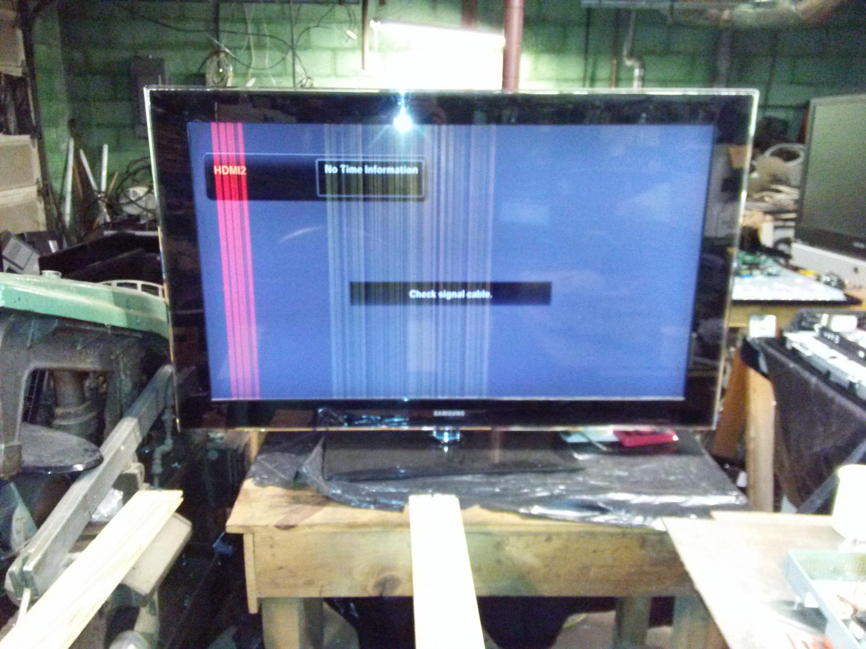

Samsung plasma screen help. Ln46b640r3f
  • mattstolte
    • Dec 2013
    • 612
    • usa
    Would this be bad panel?or y sus?
    Re: Samsung plasma screen help. Ln46b640r3f
    Panel fault... and it's an LCD...
    If that were a plasma, it'd be the Y-main and/or possibly Y-buffer
    • mattstolte
      • Dec 2013
      • 612
      • usa
      anyway this is bad tcon?
        No, it's the panel. Seen it before.
