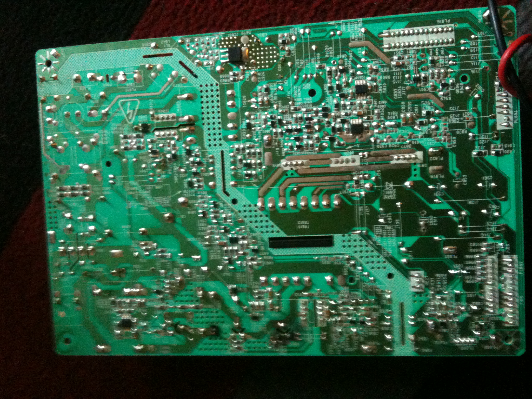

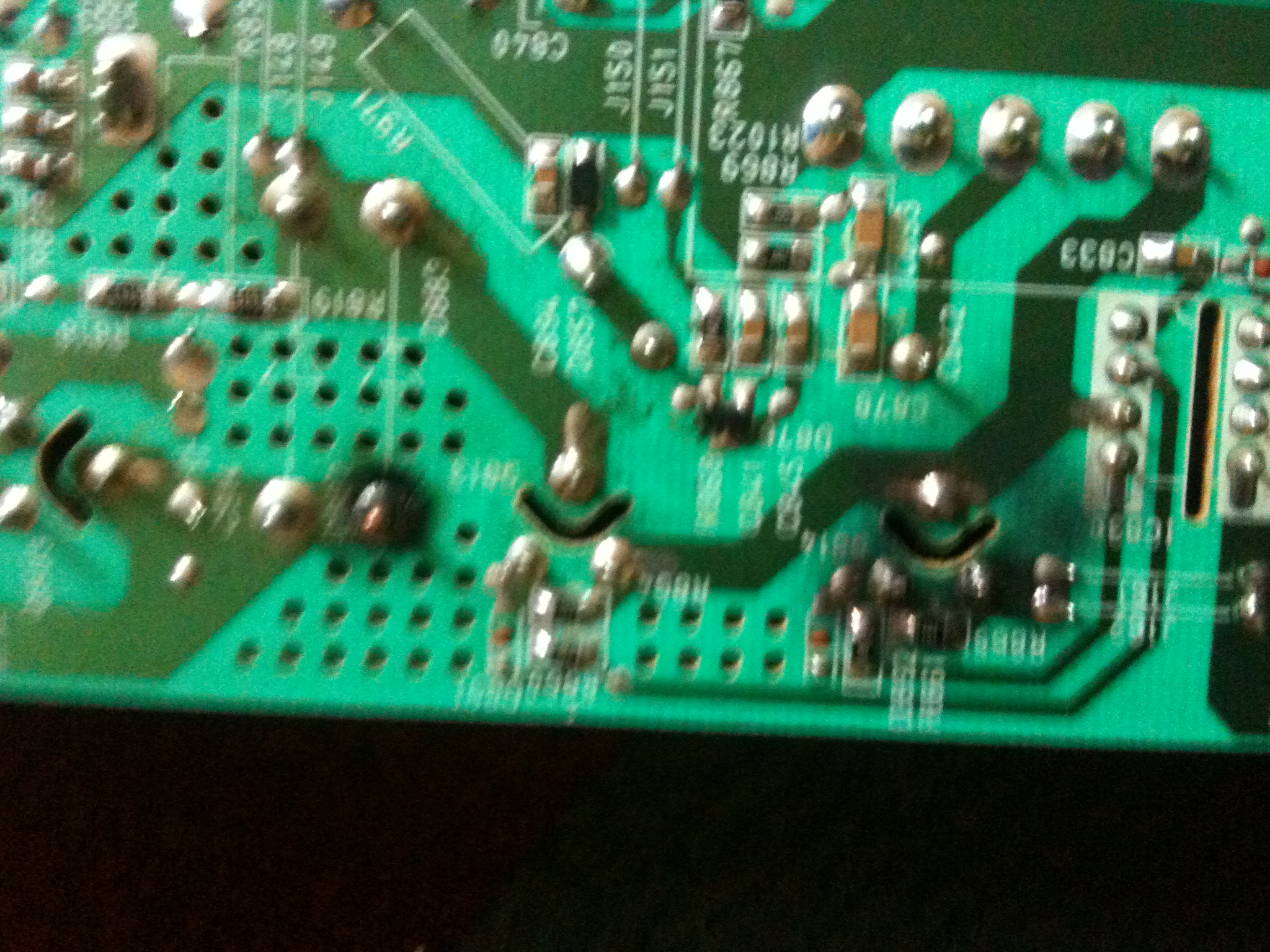

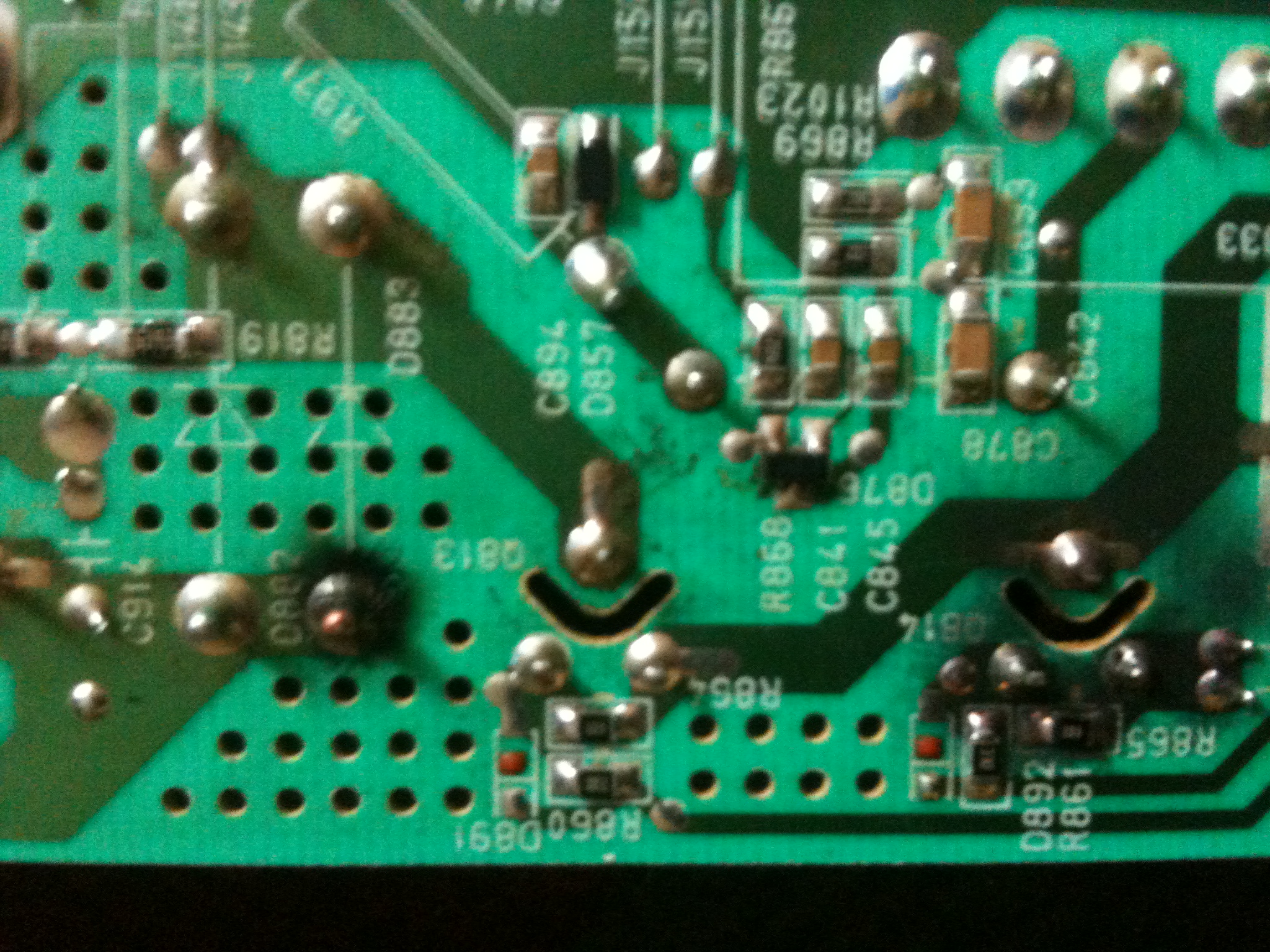

          I have noticed on my powerboard like asif the diodes have blown can you relate to this tom here is the pics?

              The pictures are not really clear ?

                They show what looks like black burned marks cant you see that?
