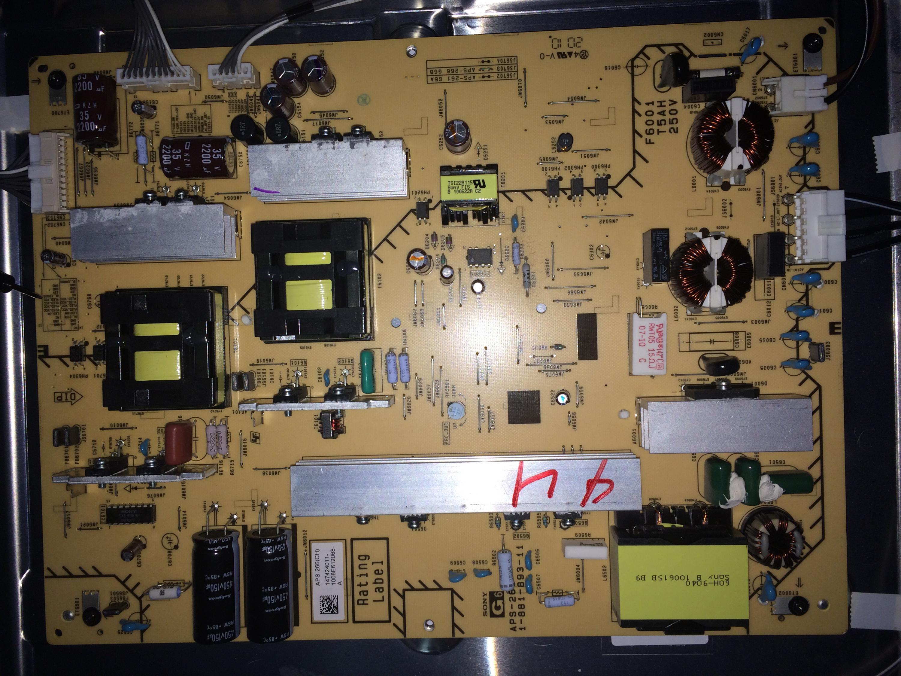

    Kdl-55hx800 4 blink, no picure or sound
    My pal gave me this tv for 40$(Steal!)
    • The tv would power cycle initially.(no picture or sound)
      I was able to get 3.3v on the standby voltage at all times.
      The on power and high voltage would be on for the first 2 seconds inbetween "clicks"
      I replaced the BAL board and the same issue happened.
      I was able to keep the power from cycling when the T-con board was disconnected from the Inverter. (This allowes me to update the firmware and get picture and sound but no backlight)
      All the capacitors look like there in perfect condition.
    I haven't tested the old BAL board without the inverter cable.
    I'm reaching out for input on this, I am debating purchasing a new Inverter board at the moment but i am unsure how to rule out the T-con.
    Thank you for your support All Great Ones.

    Re: Kdl-55hx800 4 blink, no picure or sound

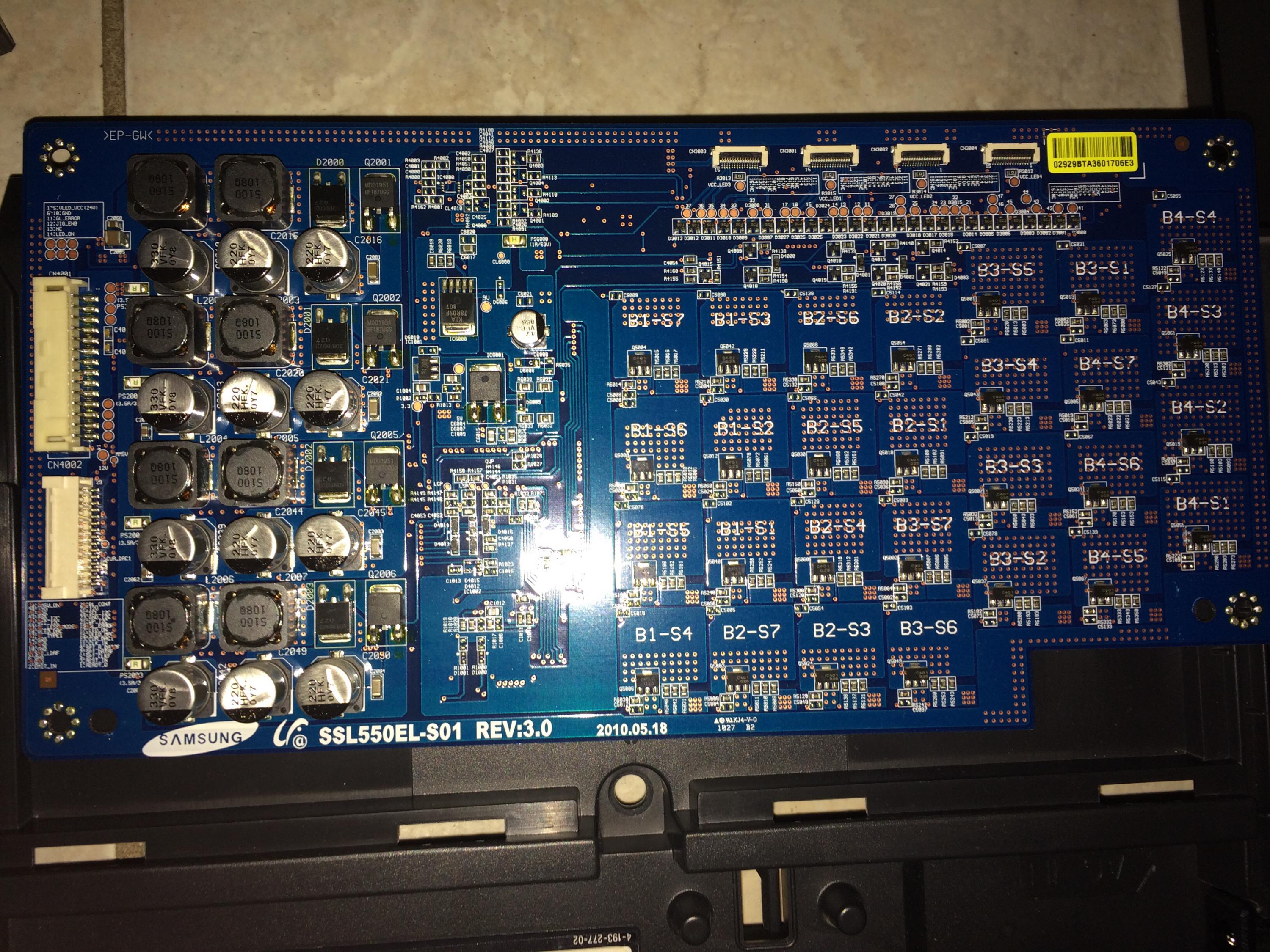

    Here's a photo, and below is the service manual.

        I think i located 4 smd Fuses marked R in green on the inverter, i will test them now.
        Can anyone see any through the potato picture I uploaded?
        Edit: all 4 are fine in circuit on the inverter.

          There is the fifth one with 'H' (1A 63V) on top.
          So this is LED backlights TV which does not have Balancer for the CCFL, it looks like the BAL board is the main board it is referring to.
          It has LED driver board which probably controlled by the T-CON board for Dynamic contrast function.

                  Hmm I wonder if the error code is correct then, it is pointing to the LED driver board. I am not 100% sure as to what is going on here.

                              So than i feel like I'll test a new Driver board.
                              I wasn't able to find a REV:03 model so i hope the REV:02 works :/

                                Update!
                                New inverter is in, the backlight now powers up!
                                That is for about a minute.
                                After about a minute it powers off with code 6.
                                Swapped out the BAL board to the new one I'm about to return, resulted with the same issue. The service manual points to the G board, i can only assume the power supply(g4e).
                                Another thing to note is that in the upper left corner theres a dark area like the LED isn't lighting up.
                                The BAL board doesn't have Panel_Fail as the service manual requests.
                                    It's not I found another post which point it to a different pin.
                                    No matter though!
                                    I discovered that the lights weren't leading up because the ribbon cables weren't flat against the board? I don't know why but all I had to do was press and down with a piece of tape.
                                    It's been going strong for probably about an hour now without any more codes.
                                    Thank you so much for the assistance ^.^
