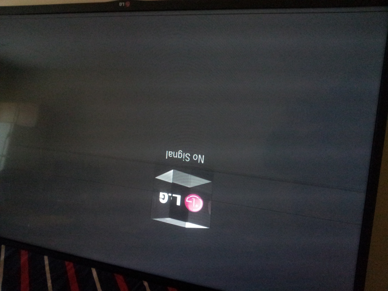

    I have this TV here from a friend and it's got some horizontal lines showing for about 2 seconds - picture is fine for about 3 seconds and so on.
    no inputs are used - just power on and it does this constantly.

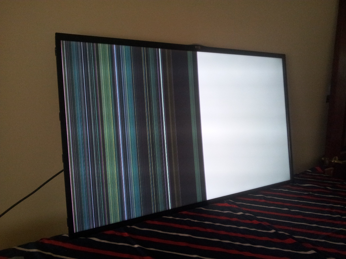

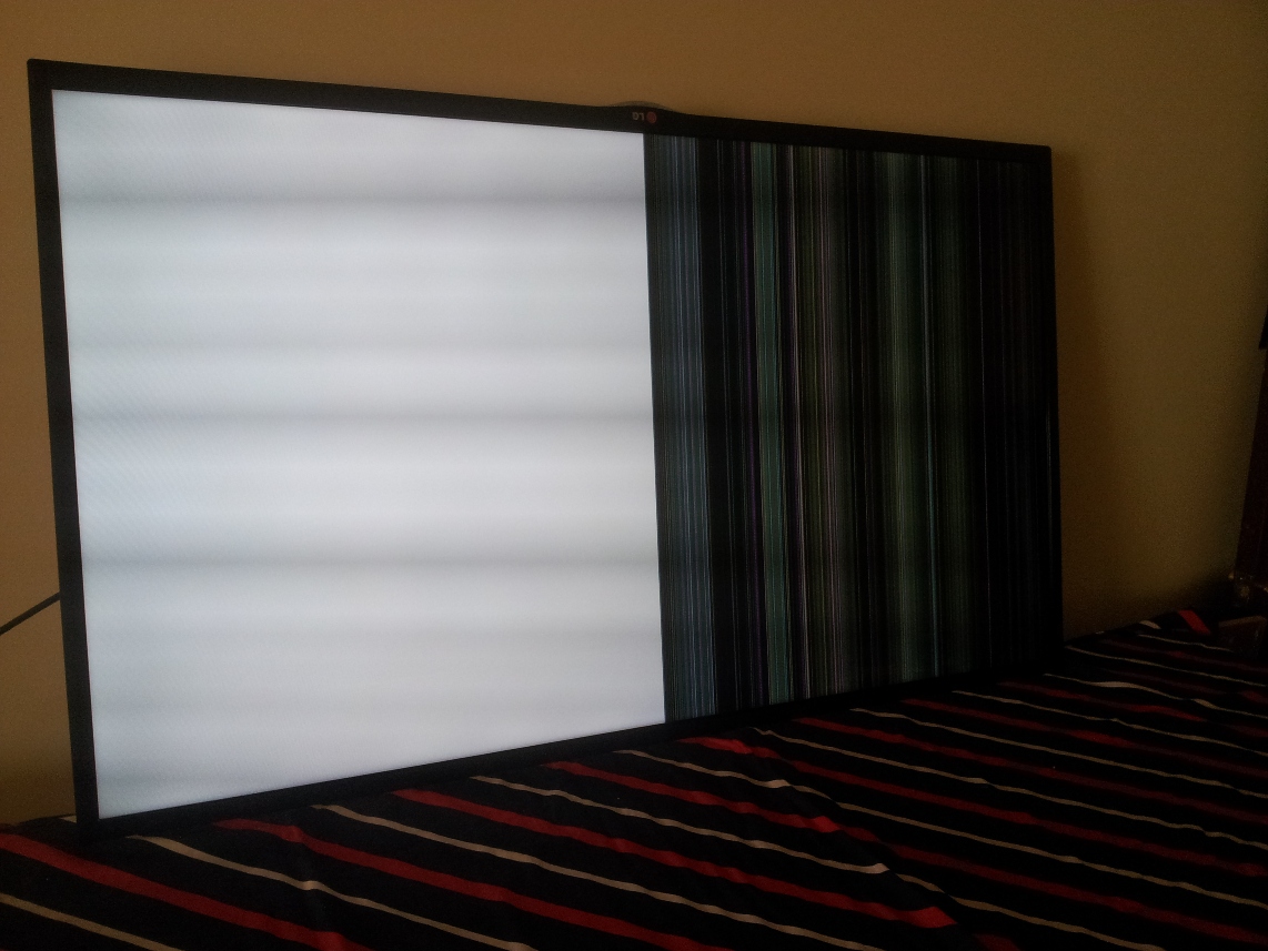

                have you disconnected one side of the T-con going to the panel and see if the lines persist?

                  Re: LG 50LN5750-UH horizontal lines
                  1 half of the screen get's vertical lines when i disconnect a ribbon cable
                    reverse it and see.
                          1 side at a time diconnected

                            Connect both ribbons again, and take a photo with a source attached to the TV that displays a bright picture preferably a solid white/green/blue.
                            Horizontal lines is a rare fault on a LCD/LED (possible).
                            Only thing left to do is to break down the panel and check the TFT boards that connect directly to the Panel.

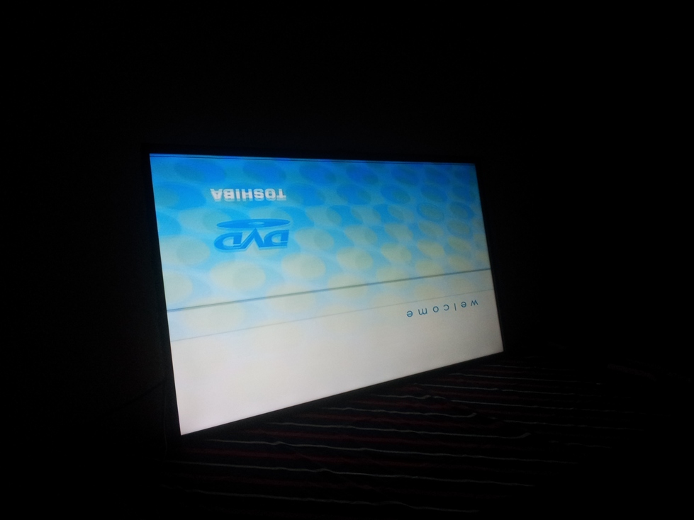

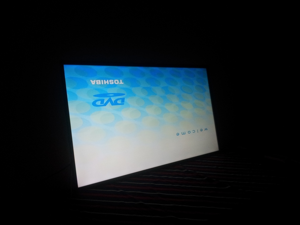

                                    here are 2 pix with DVD for input. 1 pix with the lines, the other without
                                      So the lines to away after it warms up?
                                      Yeah it's probably a bad panel, I would just run it till it dies.
