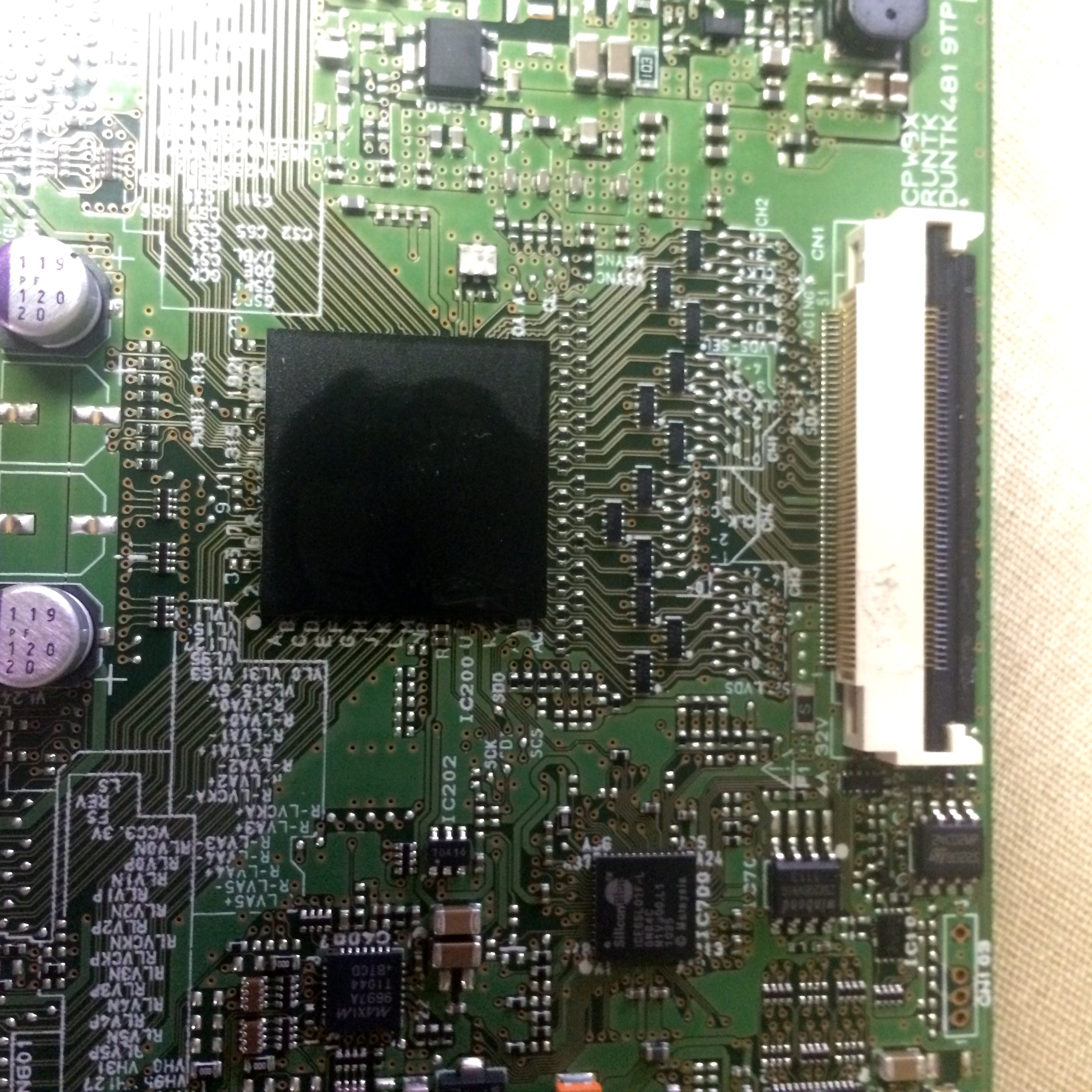

            Also, I noticed a wet substance on the big black processor in the center of the T-Con board, after the above mentioned test. What does that moisture mean? See pic

              Re: Samsung UN60D6000SF LED TV Sound but blue screen
              No, this indictes that the LCD panel is shorted on one side. Unfortunately in most cases this will not be repairable. Sorry.
              The moisture there is just left over from the thermal SIL pad... nothing to worry about.

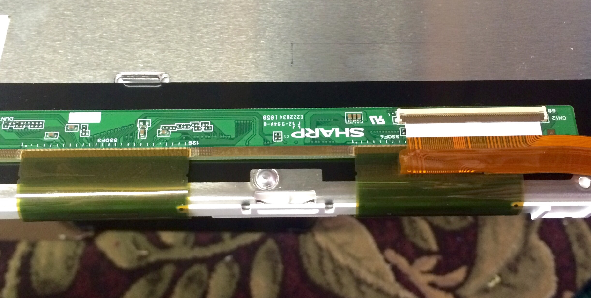

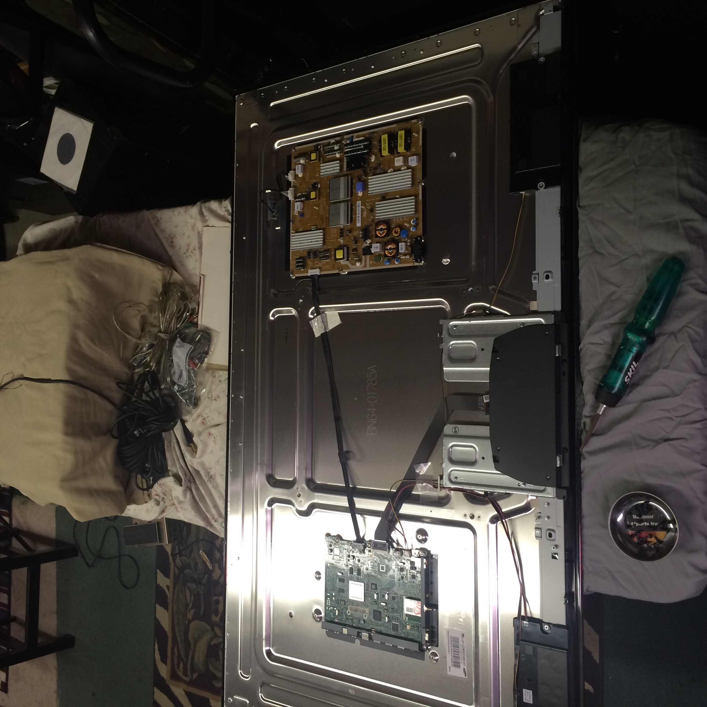

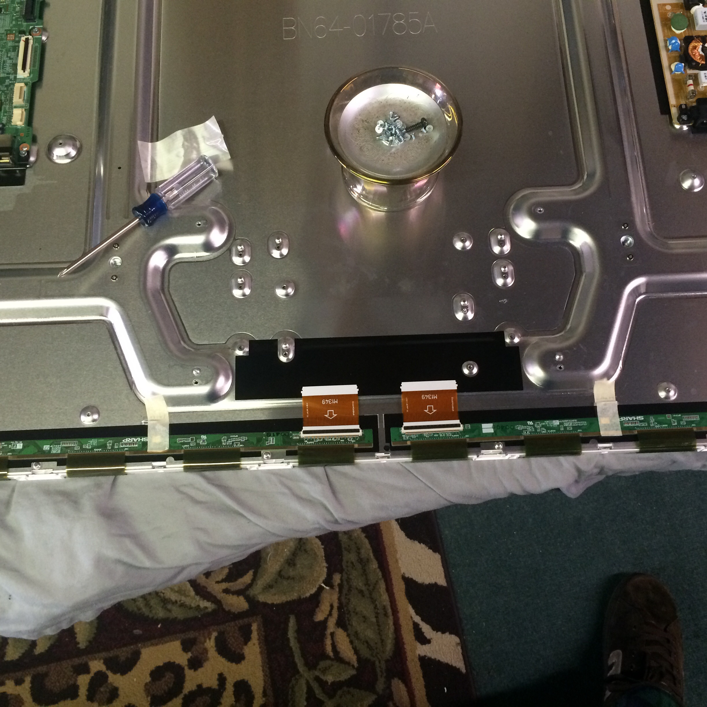

                        Ok tom66, I've gotten this far. I see nothing out of the ordinary on these panel boards. Do I need to go further? Like complete disassembly of the panel?
                          Is that all the tab bonds shown in that picture? Also, Sharp TFT board in a samsung, first time I have seen that!
                            Those white tabs? They're all around each side. Is that what I need to do, take off the back of the panel? Oh, the T-con board is a Sharp
                              No, the tabs that are glued to the green TFT board that wrap around and are attached to the LCD screen.
                                Yes, that's all that I know of. What should do next?
                                  Retake the photo and include everyone of those tab ribbons on both left and right boards as close as you can get. I can see your photo cut off a few per side.
