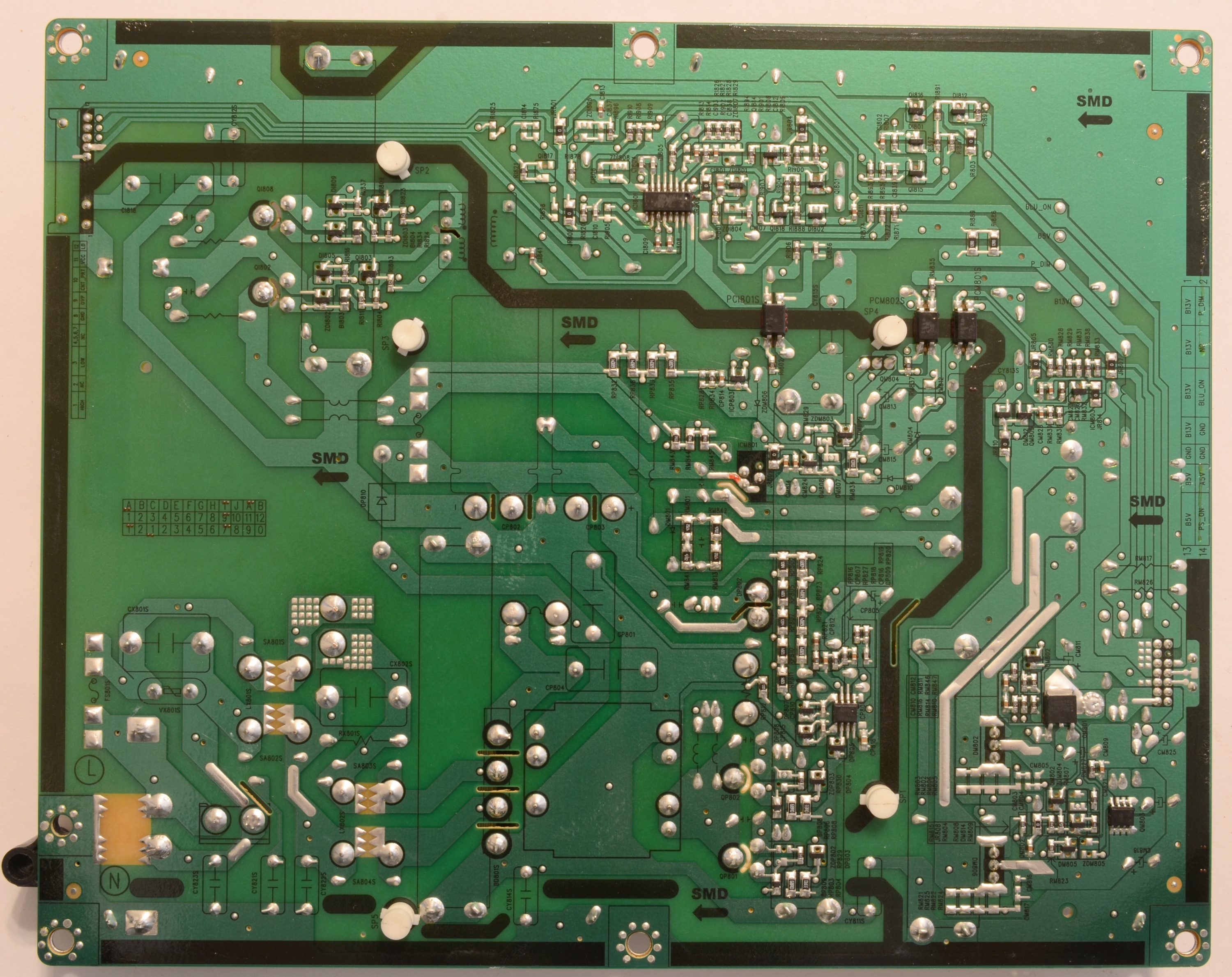

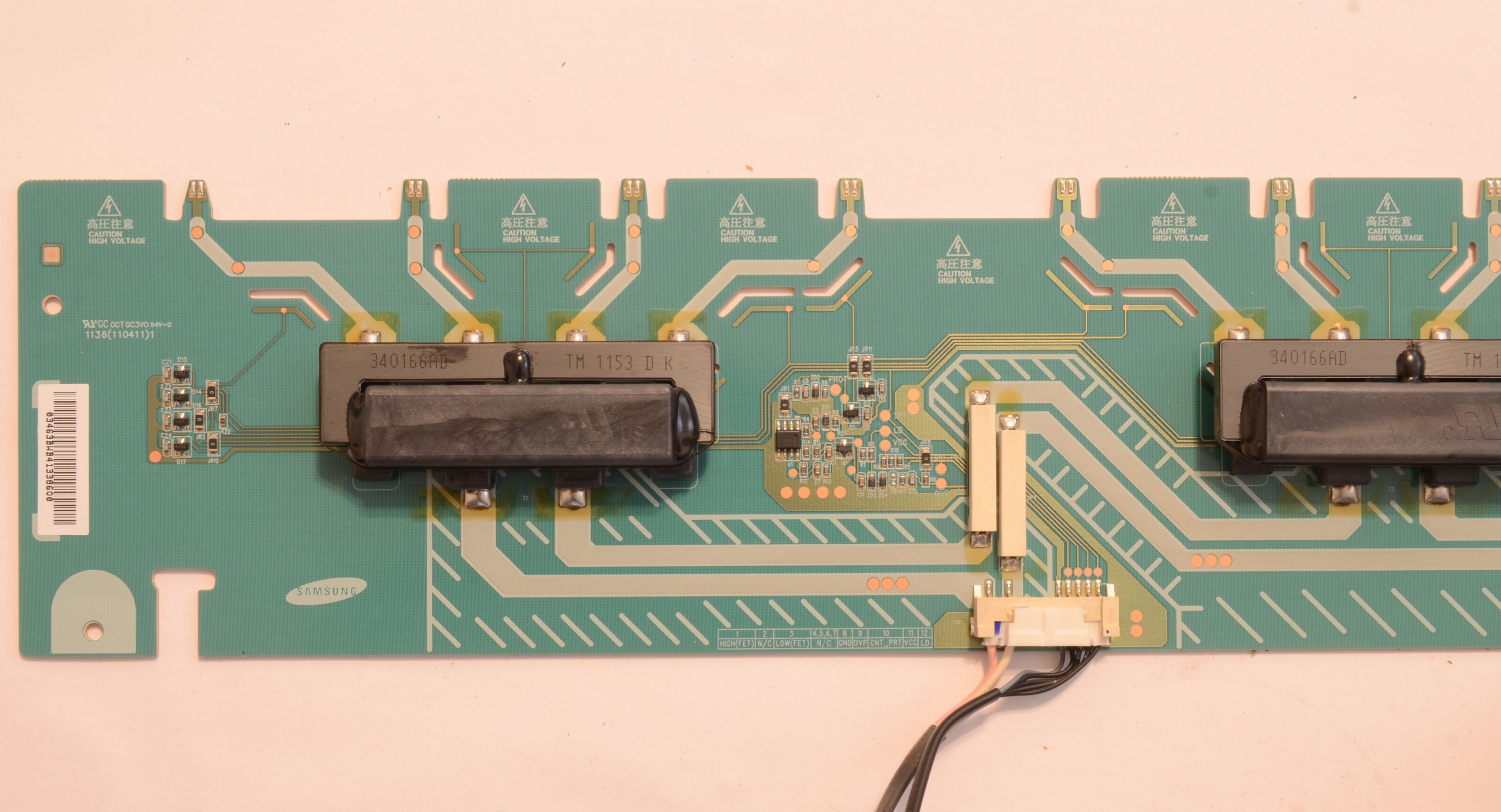

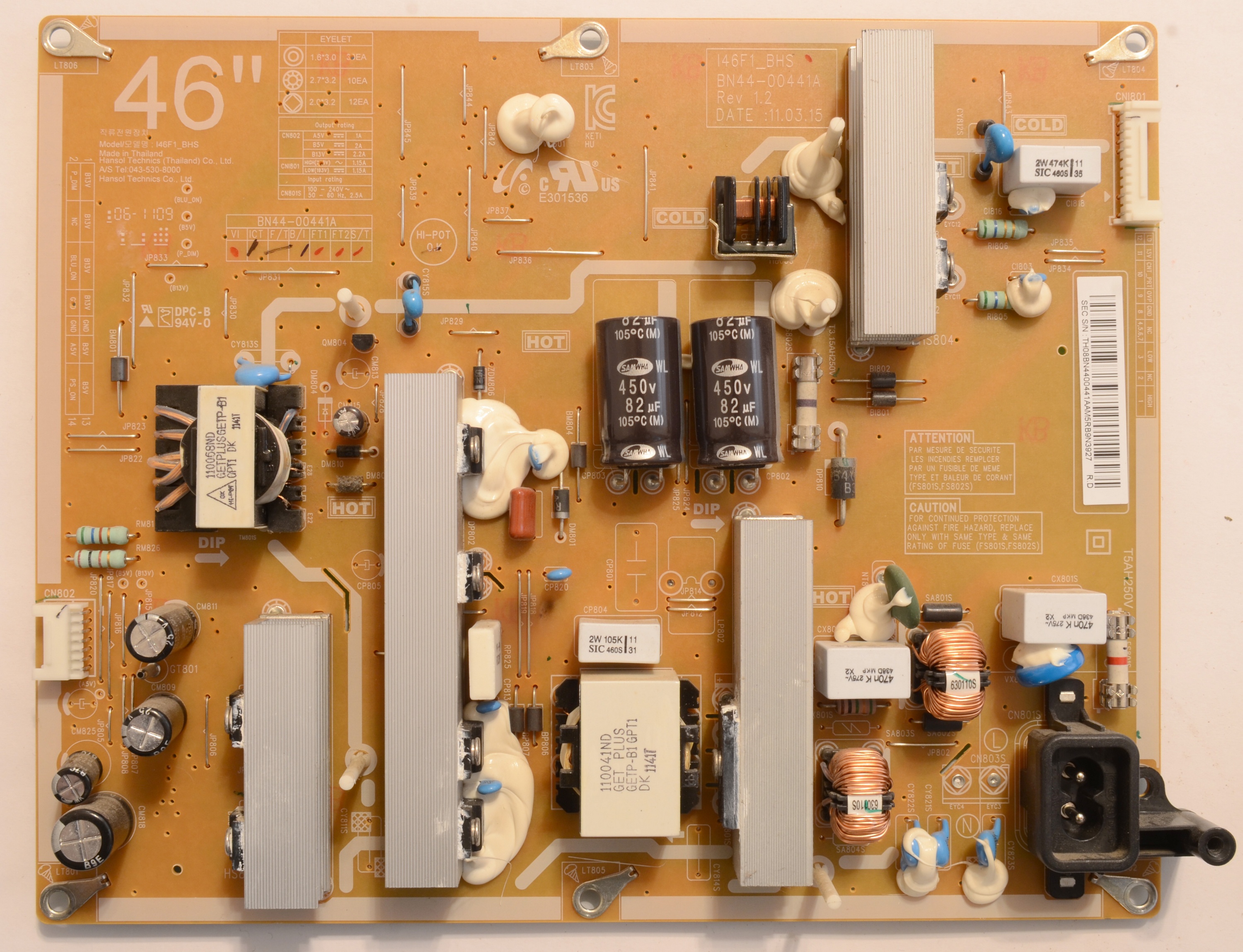

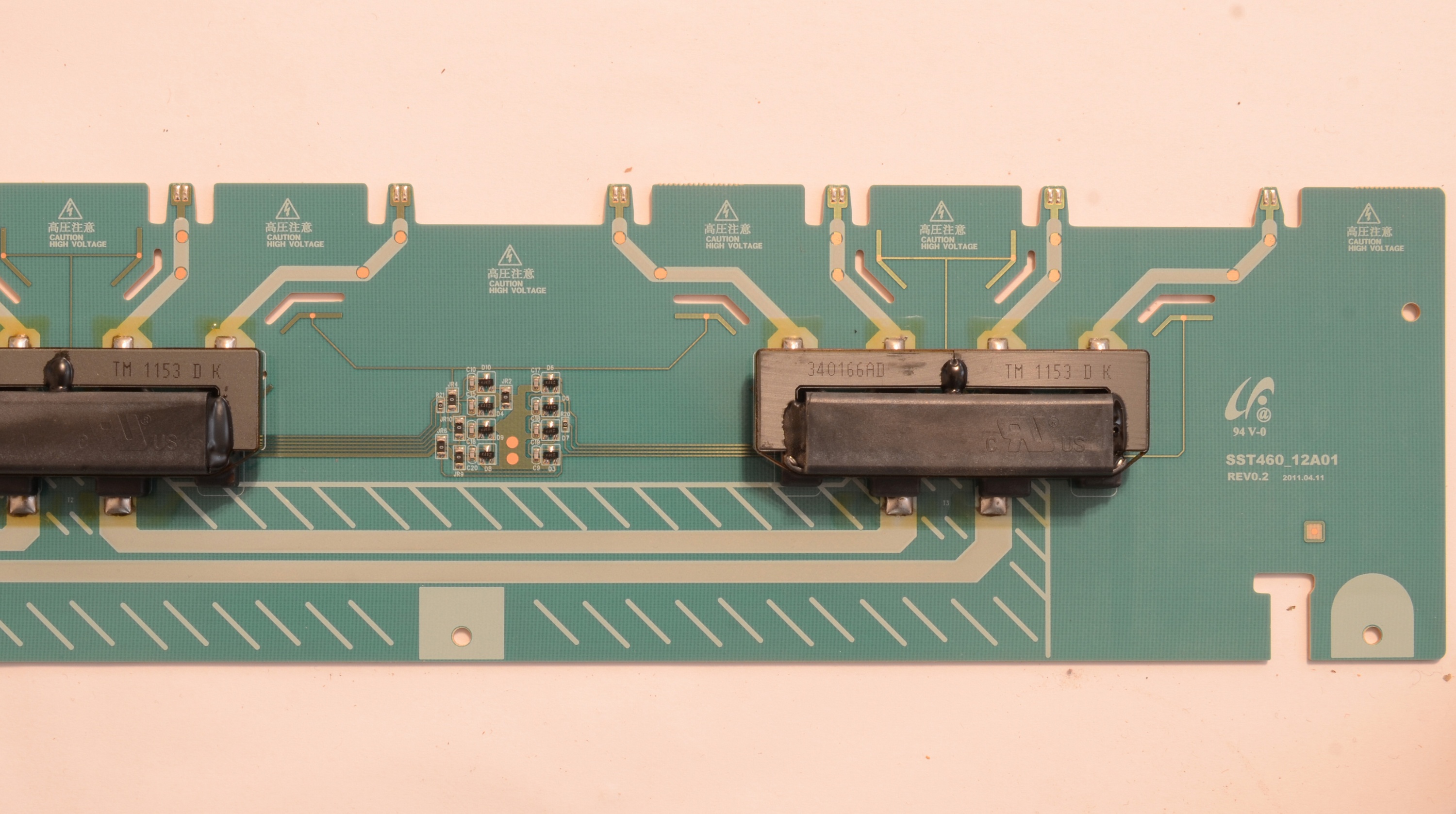

    Yesterday I rescued a 46" Samsung LN46D550K1FXZA destined for the landfill. The backlights are not coming on. The display seems to work fine, as I can see the bouncy "Check Input Connection" message by using a flashlight.
    The caps on the power board aren't bulging and I see no signs of leaks. No strange smells on the power board or the inverter board. I have continuity across fuses FS8012S and FS802S on the power board, but I did not remove them from the PCB to test.
    I've attached photos of the power and inverter boards. Please let me know if you'd like more photos of a certain area.
    Any suggestions on where to start? I have a cheap multimeter and VERY basic understanding of electronics. Thanks!!!

      Do you have >360VDC (measured right at the two legs) at the main filter caps, the the two 450VDC rating caps laying on the side?
      So the backlights DID NOT even flash on for seconds?
      What DCV do you have on CN802 BLU_ON pin and the P_DIM pin?
      What DCV on CNI801, LD pin?

                  13V for BL-ON and Dimming control do not look right at all, way too high.
                  The power supply board is also indicating the PFC Voltage booster circuit is not working or the board is not getting the PS-ON (PWR-ON) from the main board, so you need to verify if the PS-ON is present or not.

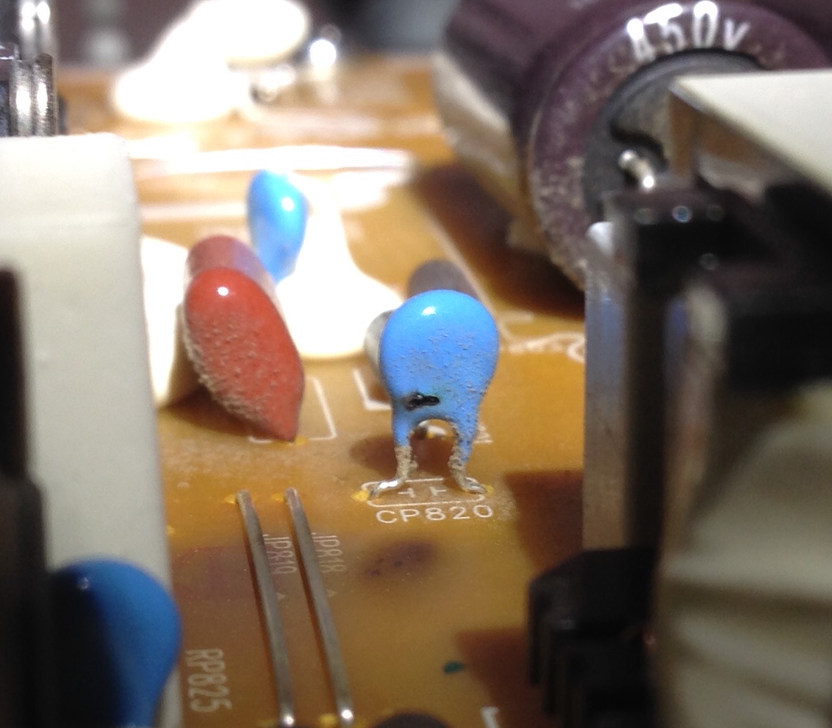

                          As I was looking over the power board, I noticed a strange mark in the area of CP820. It is not obvious in my previous photos because of a shadow that happens to fall in the same area.
                          Attached is a photo of CP820, as if you were laying under the TV looking up at the board. Looks like I found a bad cap after all.....
                          Unfortunately the nearby electronics shop is closed for the day, so I'm off to the scrap bin to scrounge for a cap!
                            Re: Samsung 46" TV LN46D550K1FXZA good picture, no backlight, PCB photos attached
                            Yes, that could cause this fault, be aware it is possible the diode is also damaged (it is a snubber for the PFC diode)
                              The cap is probably showing as shorted circuit right now, so you also need to check the PFC Diode DP802, that will explain why you do not have boosted Voltage right now. Make sure the replacement cap is rated at 2KV or so.
                              What is printed on the body of the cap right now?
                                  That is what I expected, shorted.
                                  It is 220pF 1KV, I would go with 1.5KV or 2KV instead since 1KV rating still break down.
                                  Once you remove the cap, you might as well verify that the Diode is not shorted out either.
                                      SUCCESS!!!
                                      I managed to find a 220pF 2KV cap on a modem PCB in my scrap heap.
                                      I removed the blown cap and the diode seemed to check out fine.
