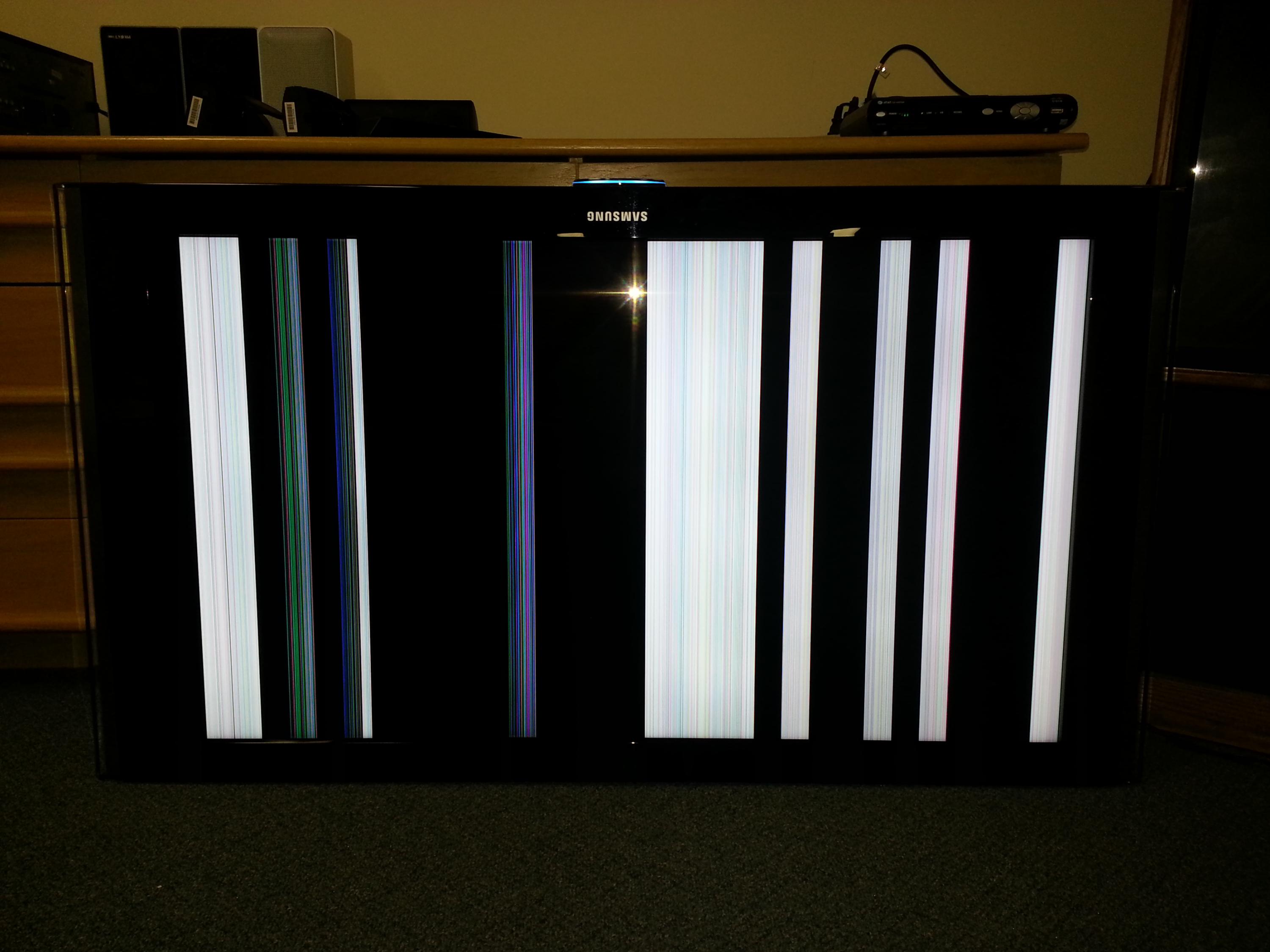

        OK, I saw the Video, that looks like when the panel is bad. I would try connecting the flat cable from the LCD panel to the T-CON board one at a time to see if you will get good picture on section of the screen.

          I unplugged both LCD flat cables and plugged in one at a time. One of them did not make a difference, and the other gave me this:
            Re: Trouble with Samsung LCD LNT4671FX/XAA
            Hmm. From my experience of what I see on the screen with all the cables connected is due to the panel, I did try new T-CON when T-CON is chap enough to gamble on just to see if it will fix the problem but I never have luck fixing it with new T-CON. You can try T-CON if it is cheap enough.
              Well unfortunately a new t-con board did not help. Any other thoughts?
                The panel is bad then, as I indicate in post #6.
