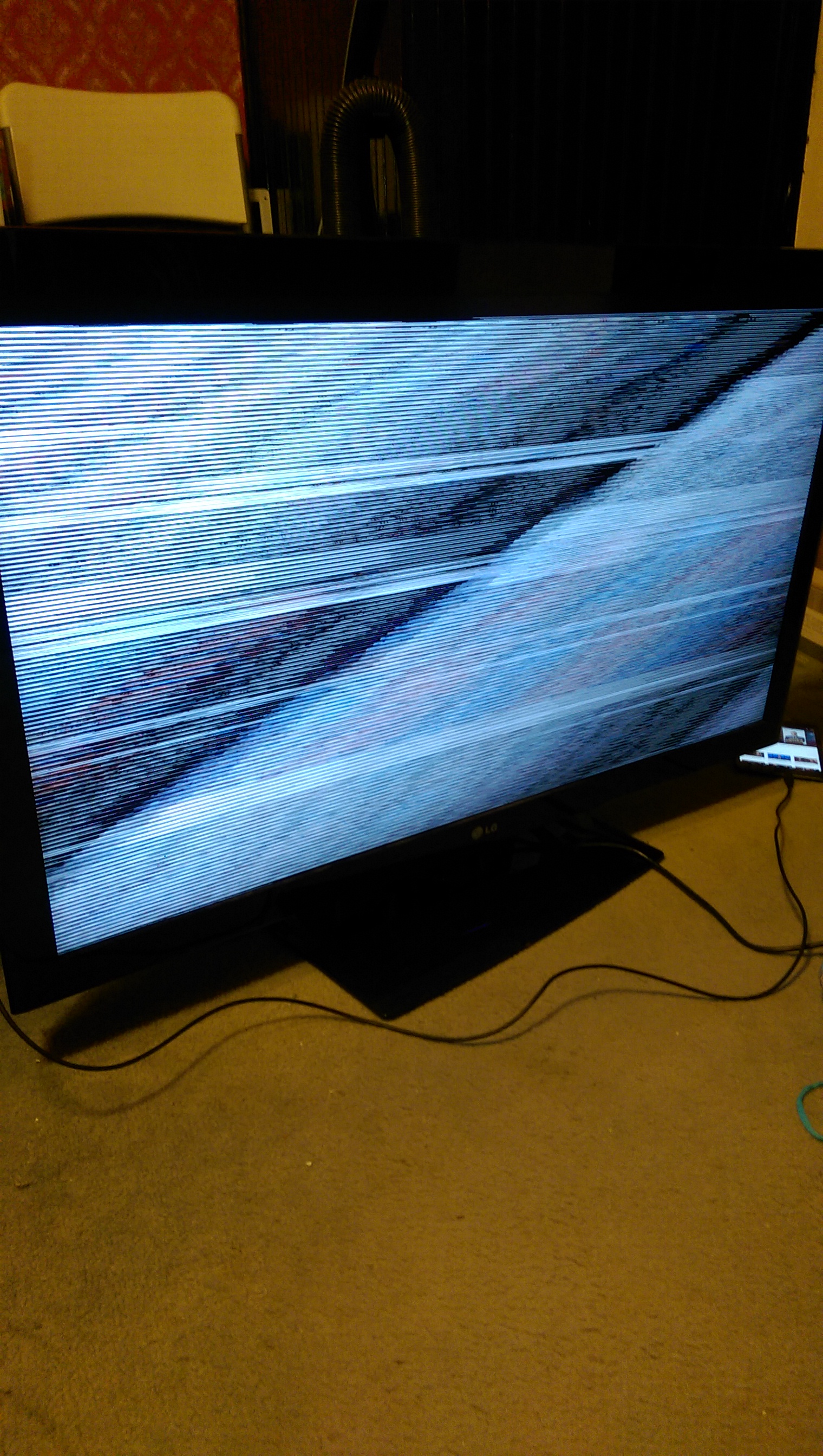

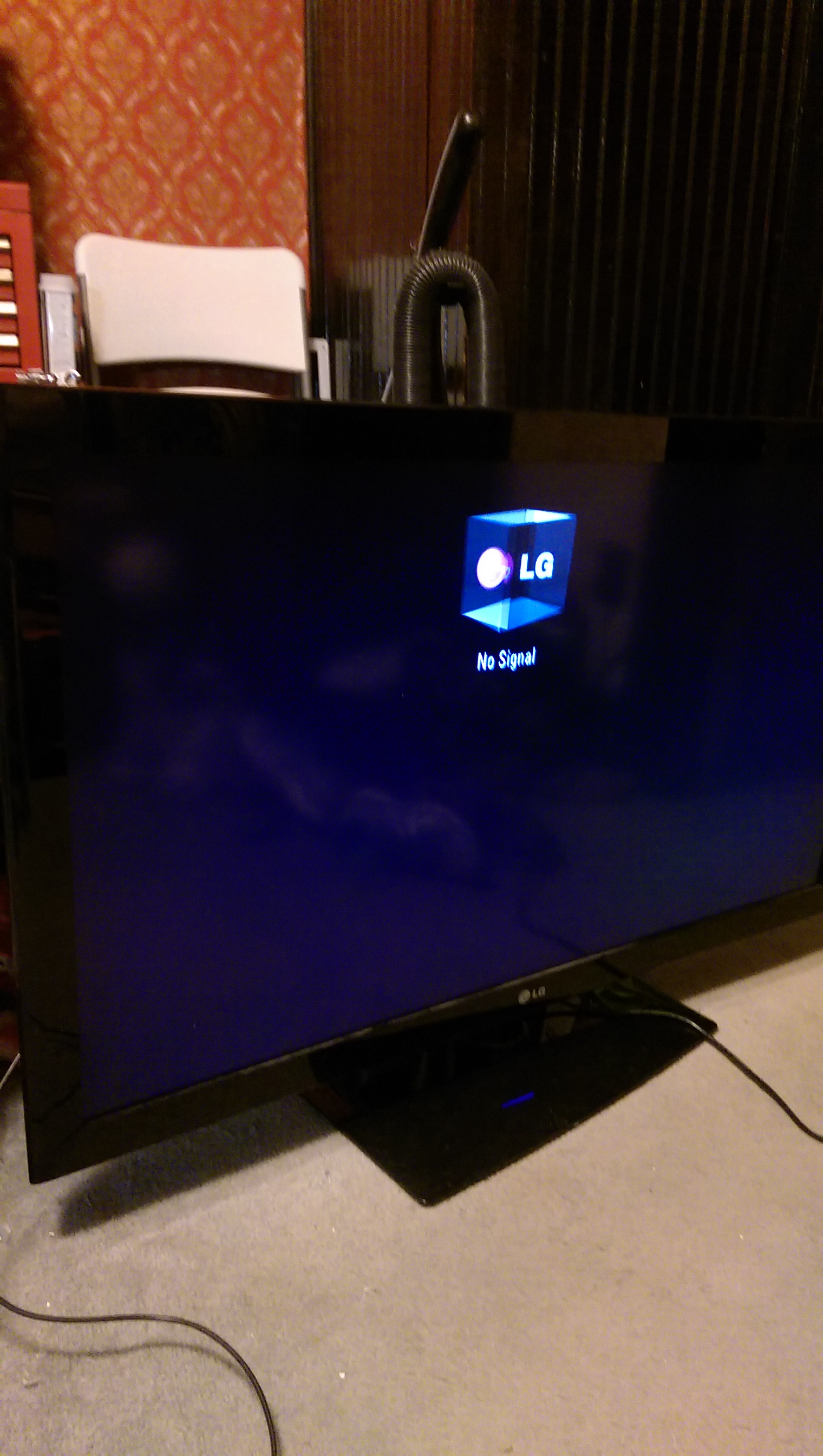

    I have a LG that as you can see in the photo has a scrambled image, my first thought was the tcon board. After I disconnected the hdmi cable it began displaying the LG image and it slowly moved across the screen. My question is, can it still be the tcon board even though it displays that image perfectly. I tried it connected to a tablet, a cable box and an Xbox, none worked. Thanks for your time

      Re: LG 46ld550 screen issues
      Update, it still has the scrambled picture when I first turn it on. After being on for a few minutes it slowly clears up. Can anyone steer me in a good starting direction.

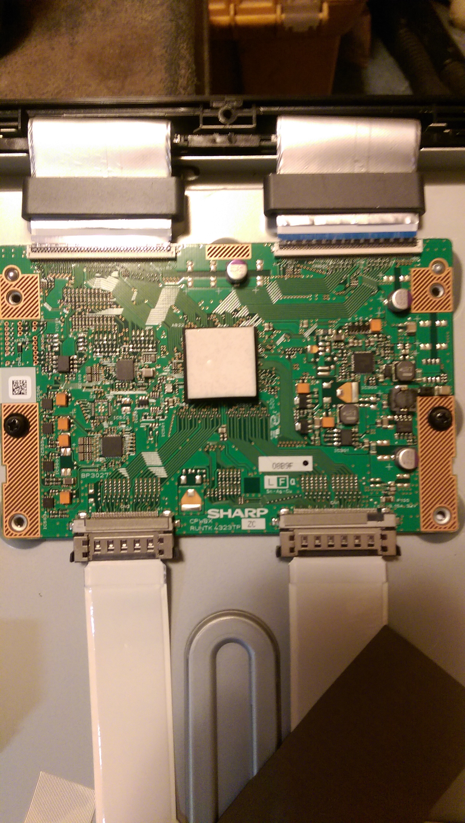

        Posting pictures of the back of your tv showing the boards with clear pictures may help you more with fixing your problem
          Thanks for the response, I'll post some soon

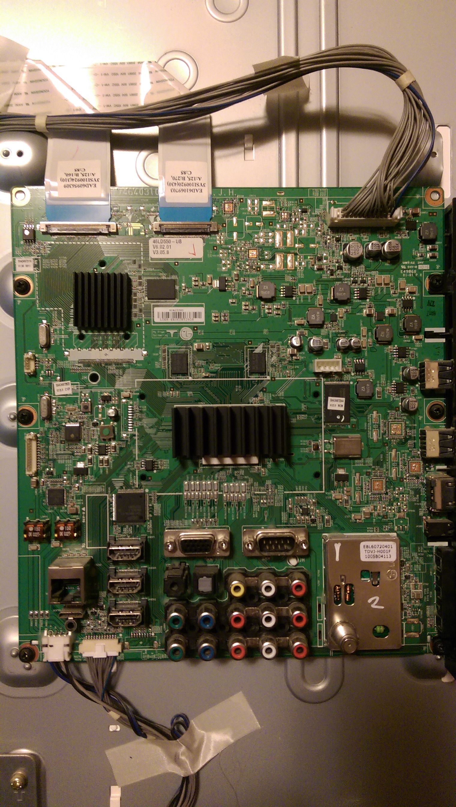

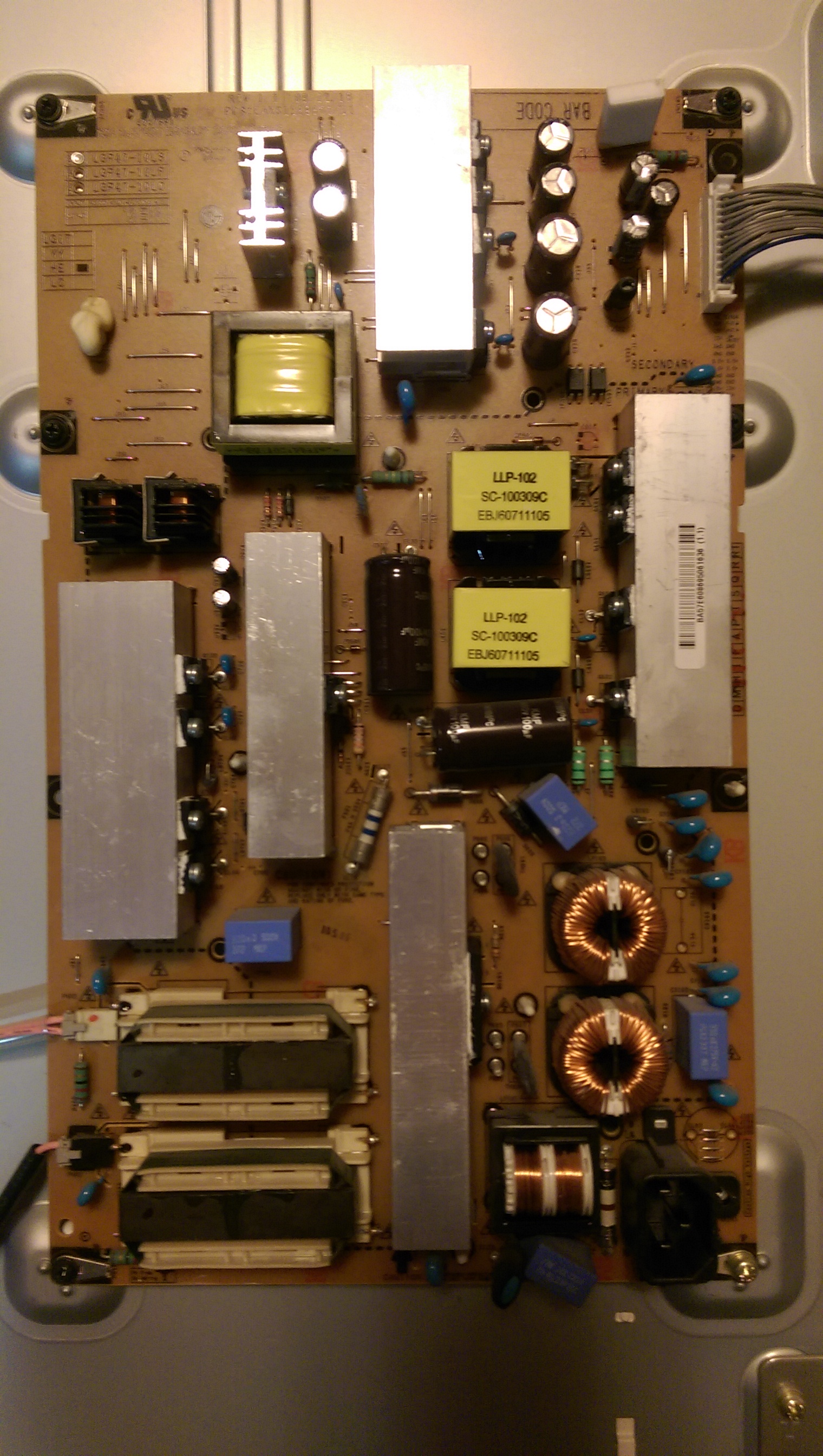

            Here's the boards, I couldn't see any glaring issues but I'm sure someone else may
              I had a 42 version LG where my picture on the screen would play up but i had to warm up the BGA on the main board with a hairdryer to make it work
                They look like their pretty much the same board. I was hoping someone had identified an easy fix for his but after a day or so with little action on the thread I realized I wouldn't be so lucky. Usually heat is the devil for these things. Thanks for the input
                    reflow the main board.its a busted bga.
                    if it can display menus screen saver,ect properly it is NEVER the panel!
