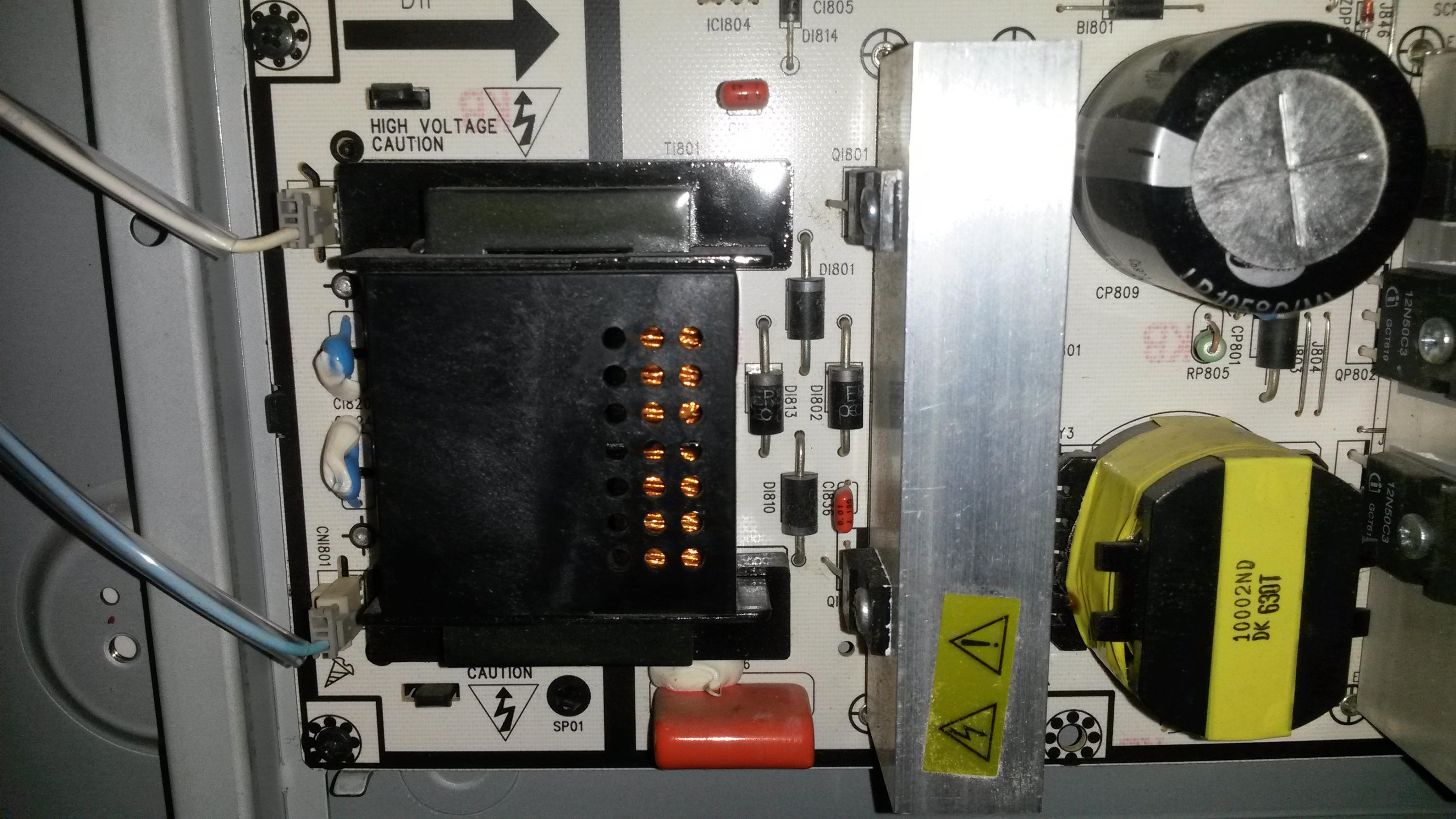

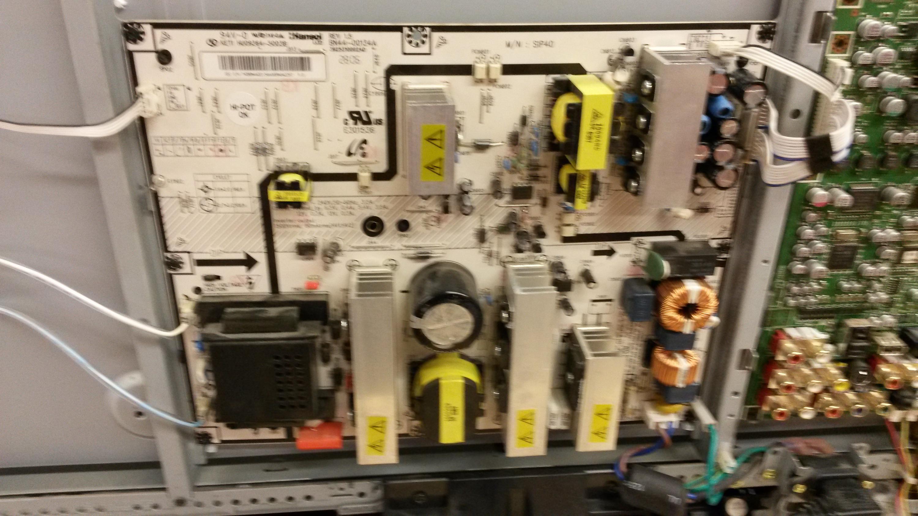

    I've replaces all the caps on this board. Getting clicking and 4 flashes on power button of red led. No back light and no sound or screen. heat sinks are all warm when cycling with the clicking except for the lower left one next to the inverter.
    Any help would be greatly appreciated
    Re: at a loss with samsung s4051d

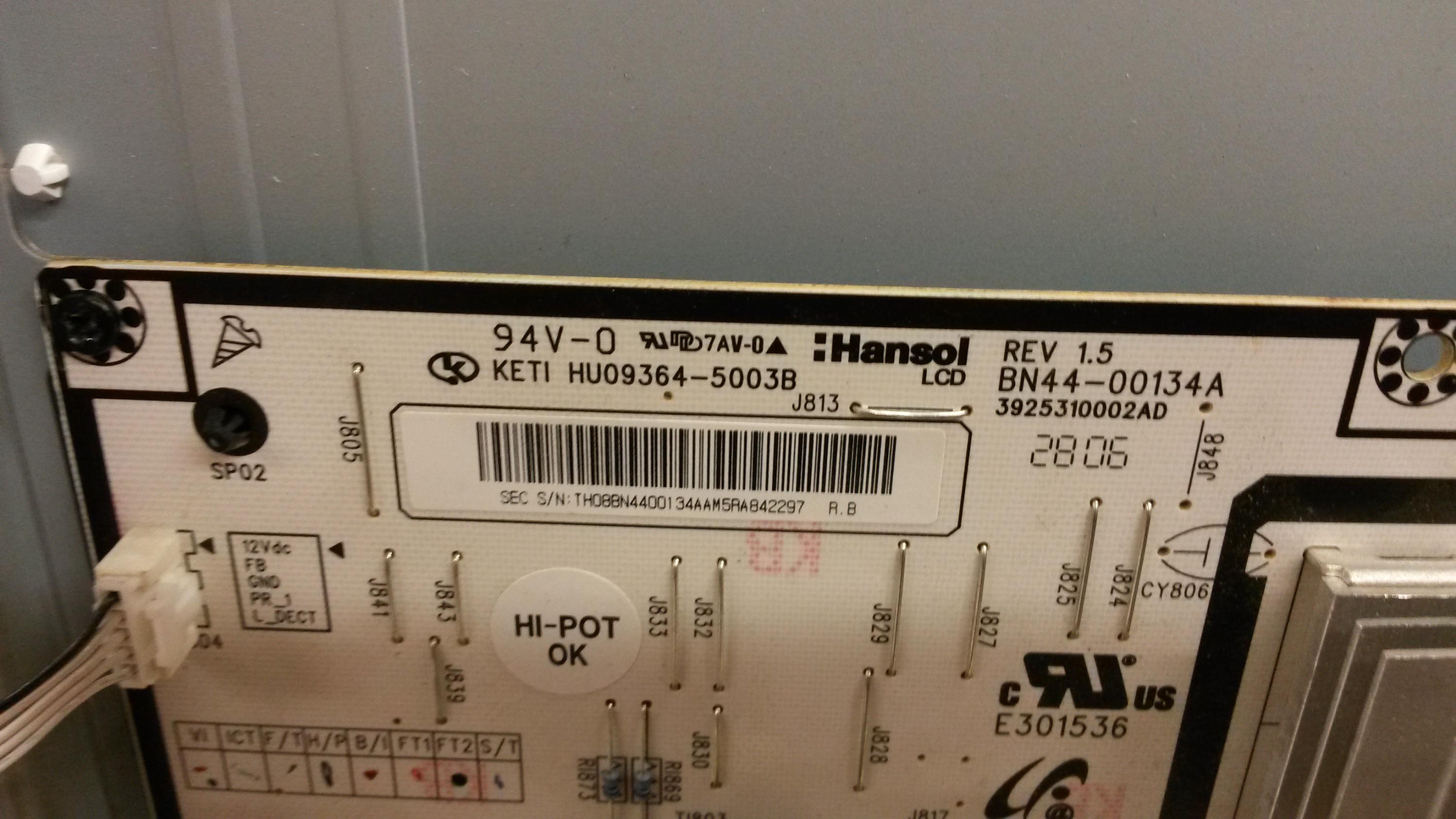

    OK, first you need to provide pictures that are in focus, 1st pix is bad, 2nd pix is good.
    You need to get the pin labels of those two connectors of the power supply board to go to the main board.
    You need to measure each pin DCV when the TV is off and when the power switch is activated.
    List each pin number, follow by the name of the pin , and then follow by the DCV reading of the pin so we can see what is/are missing and what is/are not correct.

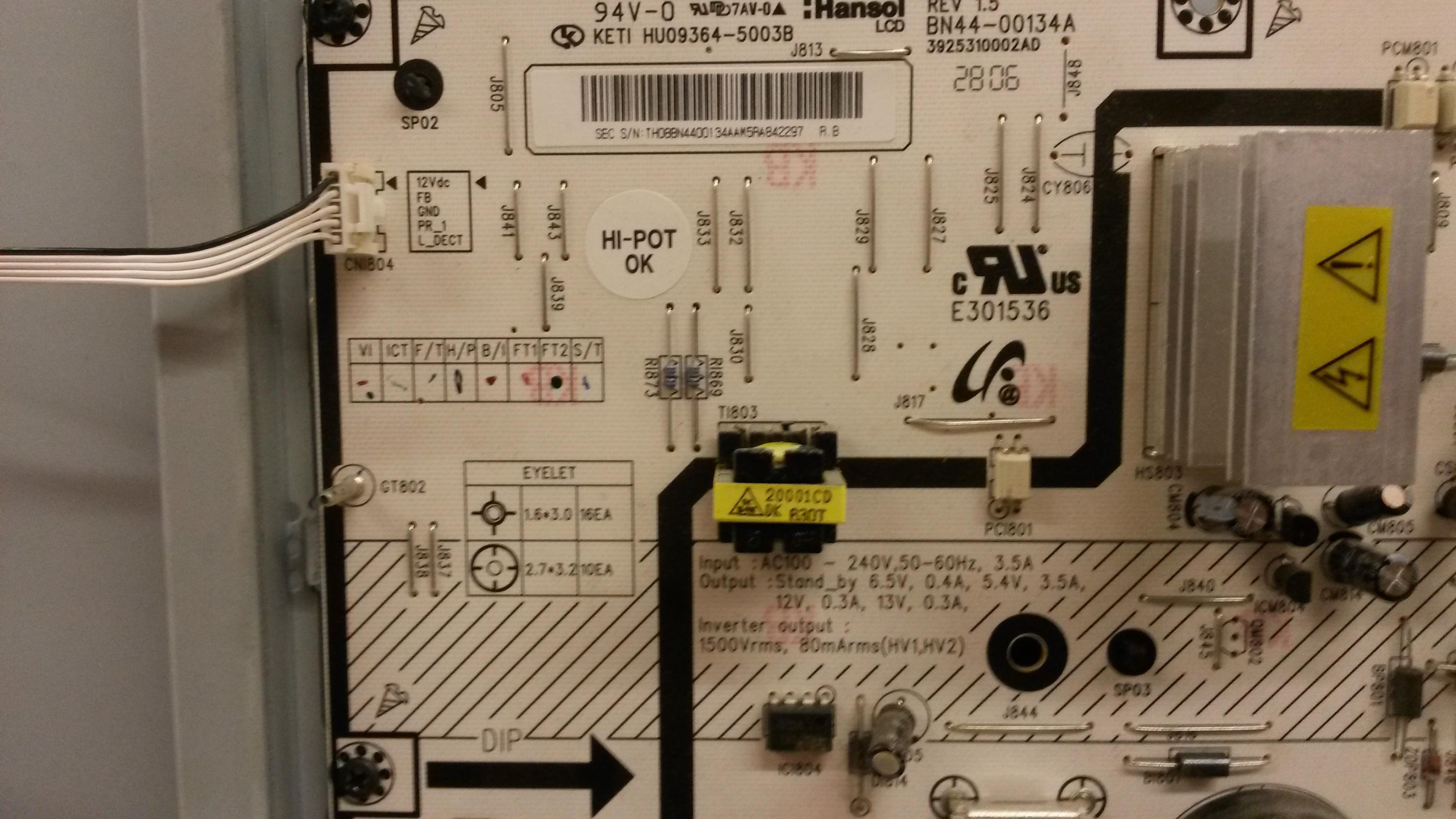

      sorry about the picture.
      here are the voltages I'm seeing.
      The clicking has no effect on any of the voltages on this cable.

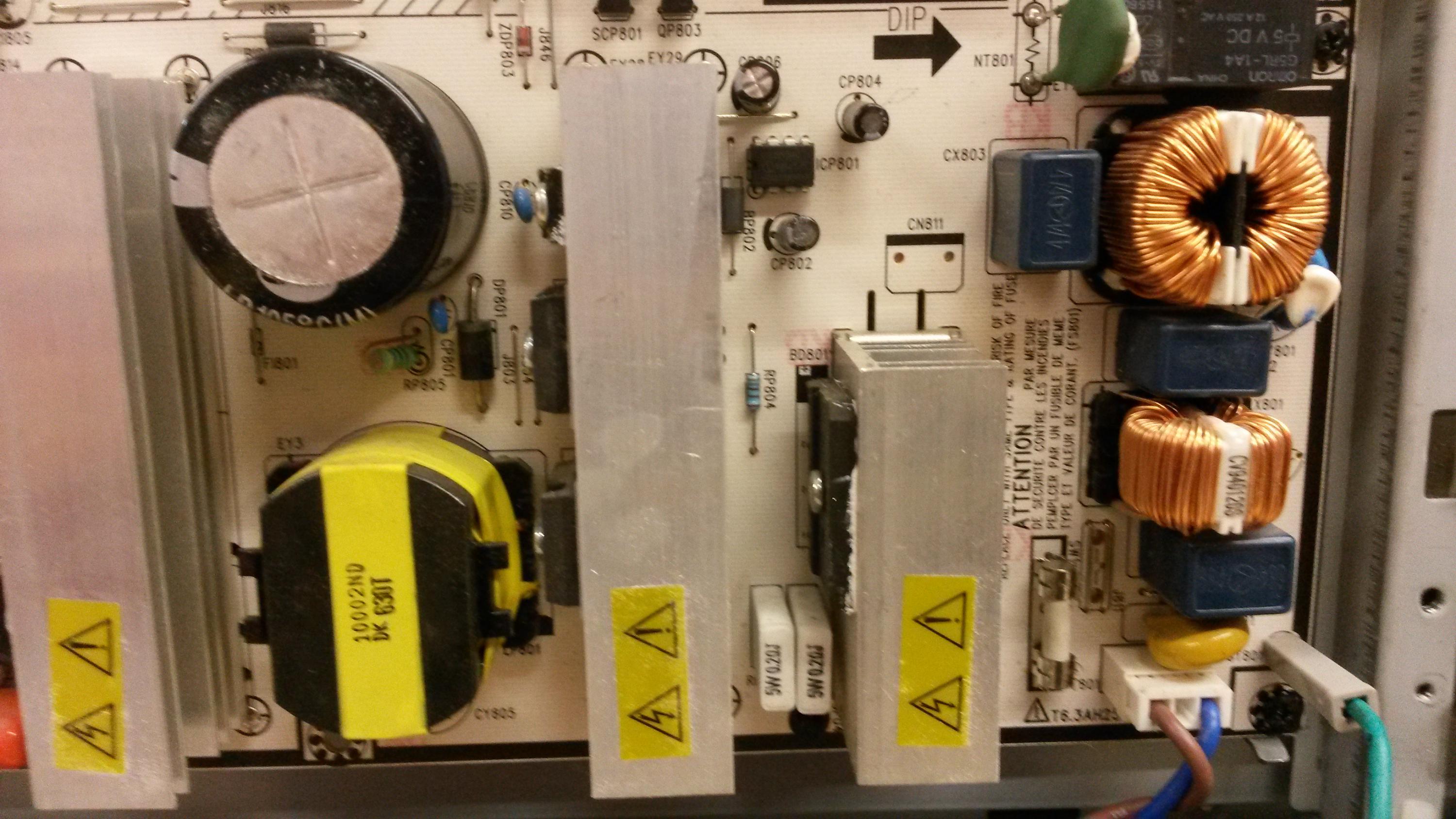

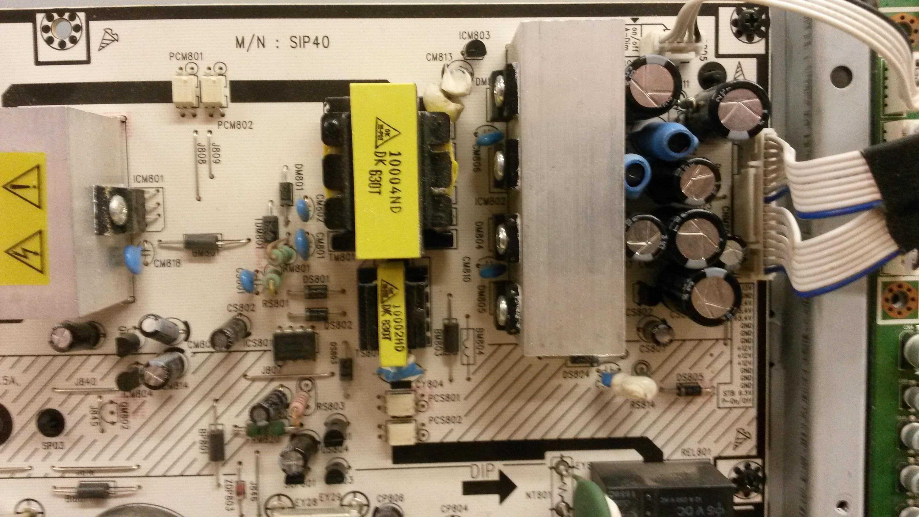

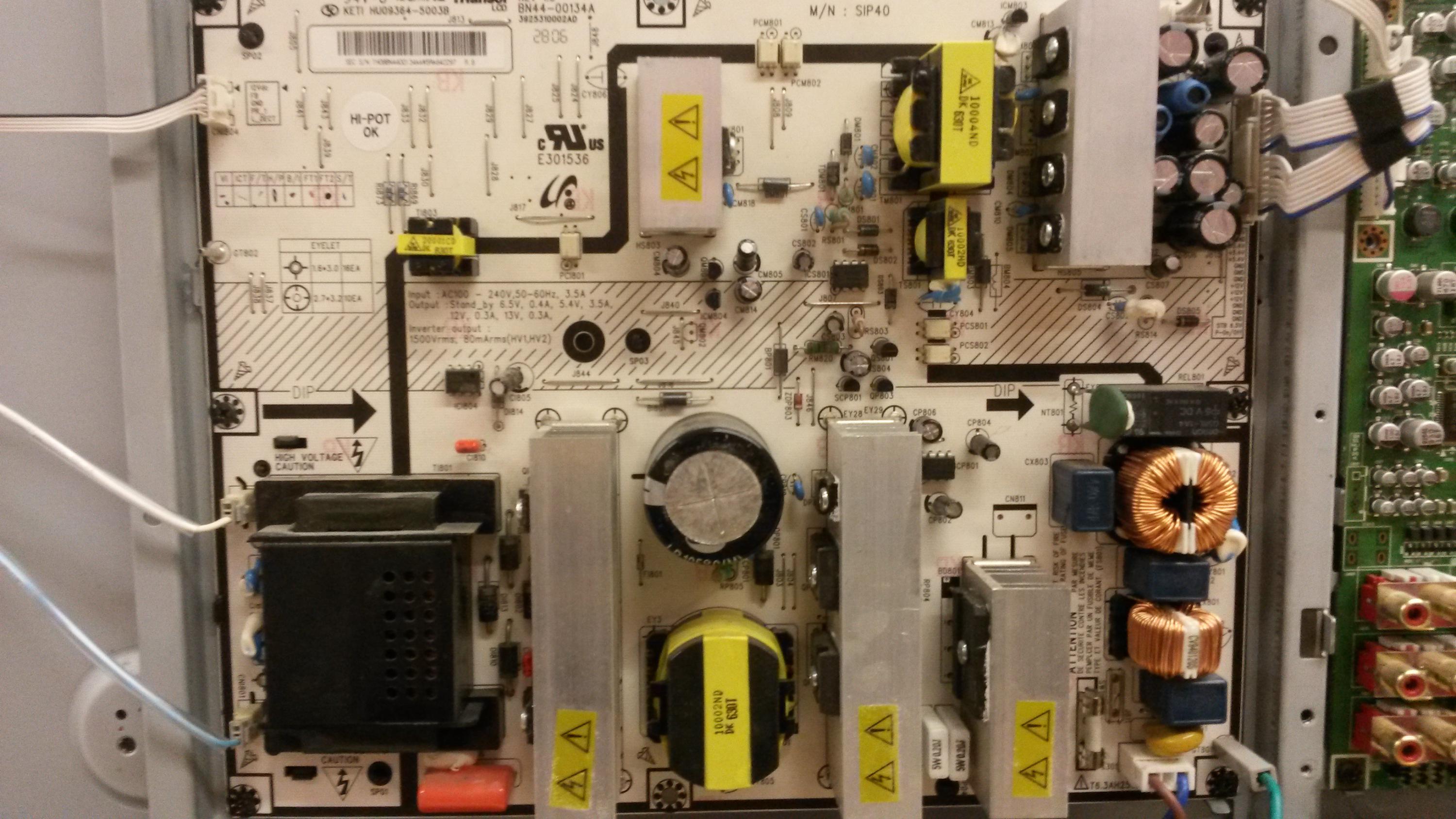

      While testing I noticed all the heat cinks were warm except for the one just right of the inverter, with Q1801 and Q1802 attached to it.
      Attached are pictures, first is full, next is clockwise starting with upper right
        "NC - on/off - .01" The backlights is no getting the BL-ON signal from the main board to turn it on.
        Did the signal on this pin ever go up > 2.5VDC?

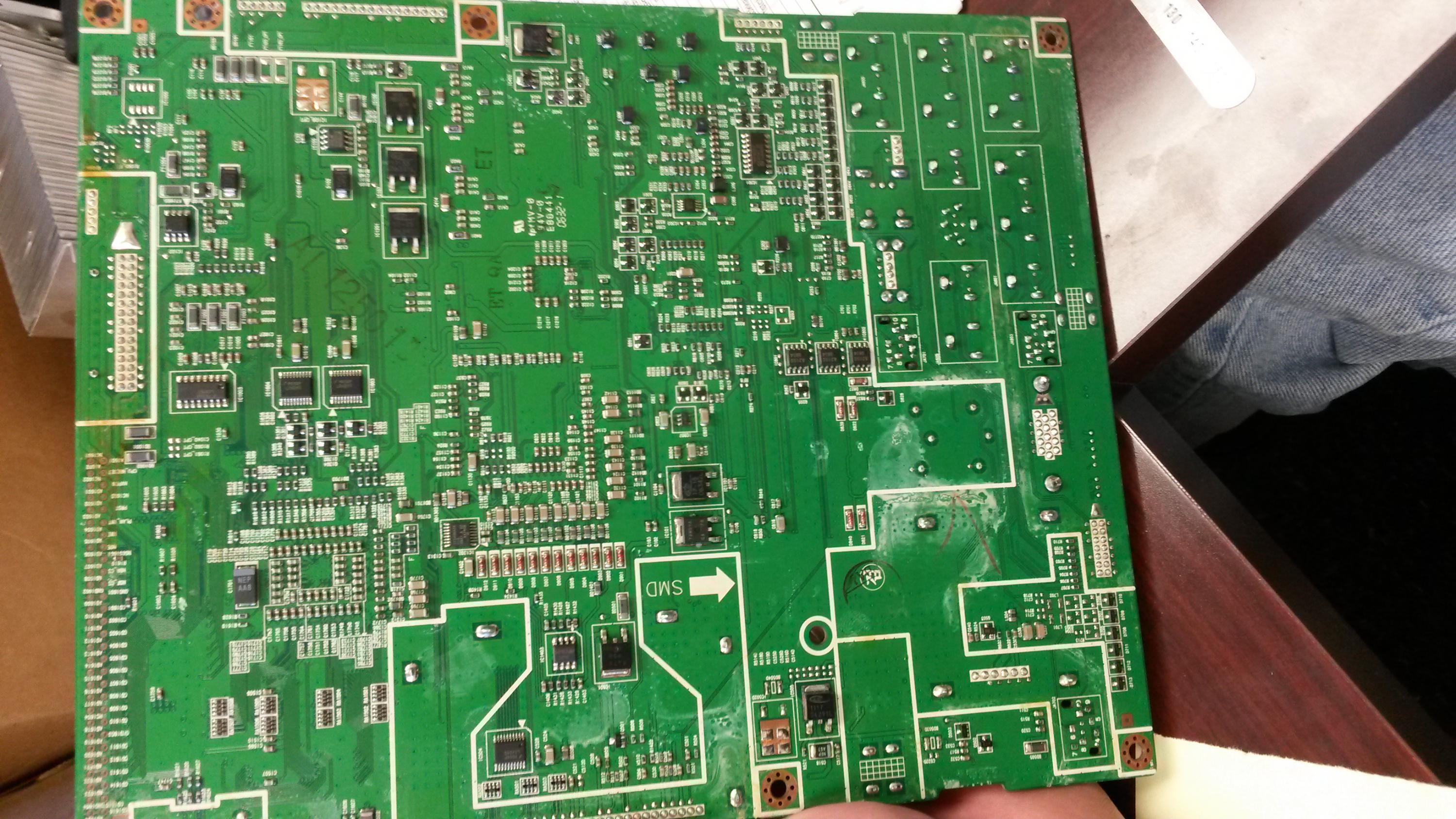

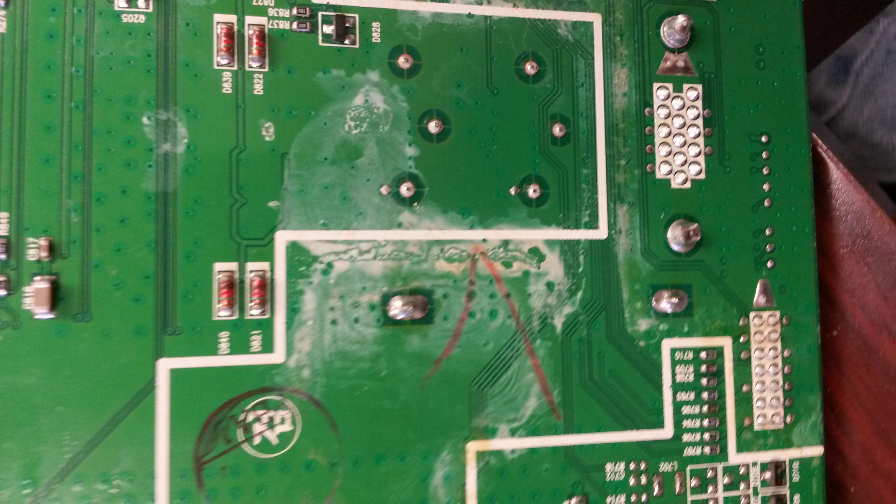

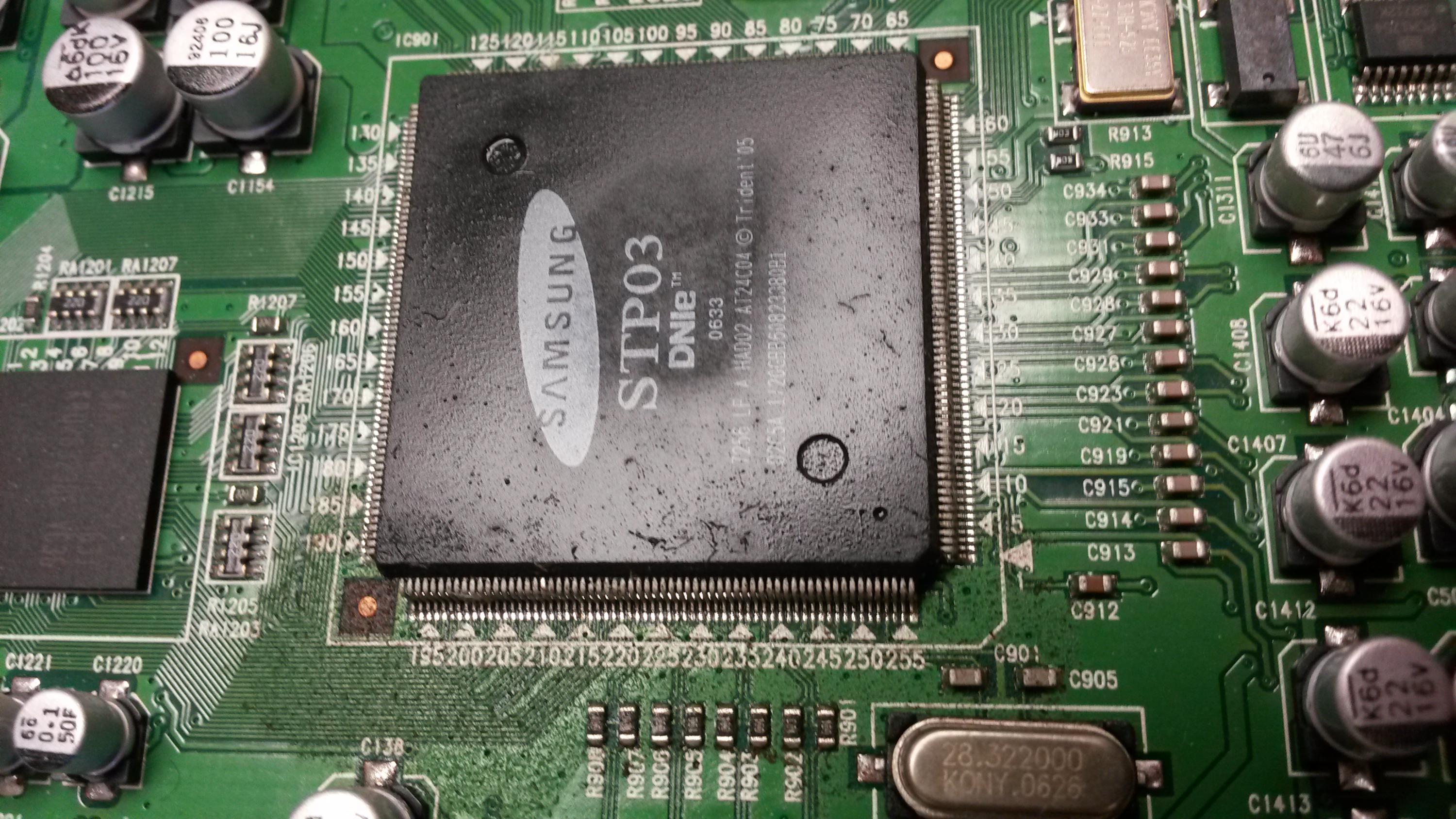

              I pulled the main board out and found evidence of moisture on the back of the board. Also the big IC in the center seems to be leaking. Would you suggest just replacing this board?
                Can we see what is looks like, the moisture and the leak?
                  Pictures attached
                    The white stuff is the left over from no-clean flux residue.
                    I am not sure about the black oily stuff on the IC though.
                    Is this your TV or you bought it used from someone else?
                    • tstokka
                      • Jan 2012
                      • 20
                      I doubt it's flux. looks more like dried milk. No I got it free from craigslist about 2 years ago. It did have 4 caps that were bulging, and I fixed those.
                      • Dang
                        • Aug 2013
                        • 440
                        I'll second the flux residue, seen enough of these to safely say that's what it is, as to the oily residue, that's just leaking from the thermal pad under the heat shield, nothing to worry about.
