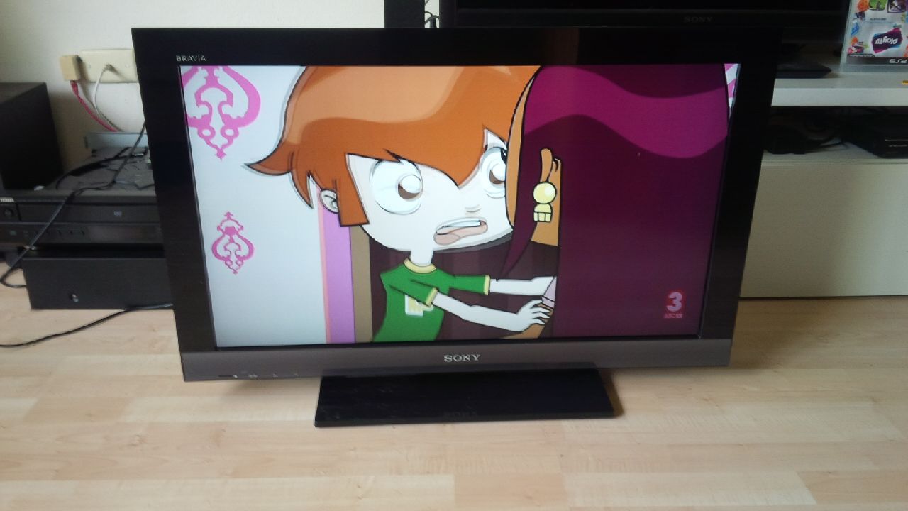

    AFTER IC6301 SONY A3809 REPLACED
    ------ STBY | POWER ON
    C6325 339V 394V
    C6117 12.45V 14.02V
    C6118 12.41V 14.34V
    Vcc @ CXA3809m 12.44V (stby) 14.04V (on)
    Pin2 (mode)@ CXA3809m** 12.38V (stby) 93.8mV (on)
    pin3 (AC_detin) @ CXA3809m** 5.36V (meter on DC) 1.83V (meter on AC)
    Secondary voltages to follow when i've had a sleep
    Thanks!

      As per my posting, standby voltage was clearly a lot higher with the working ic, acdetin was up to 6v from 0.6v, and as predicted by you budm the mode voltage was at vcc in standby mode with a working IC
      Here's the document I found with a repair process. It mentions adding the two diodes. I notice on the hires screenshots of the power supply board ending in -12 on shopjimmy (mine ends with -11) these diodes are present!
      Here's the spanish doc as promised. If I take any more measurements they'll be when I reopen the tv to fit the two additional diodes.
      Would anyone be able to theorise the reason they have been added?
      cheers!
