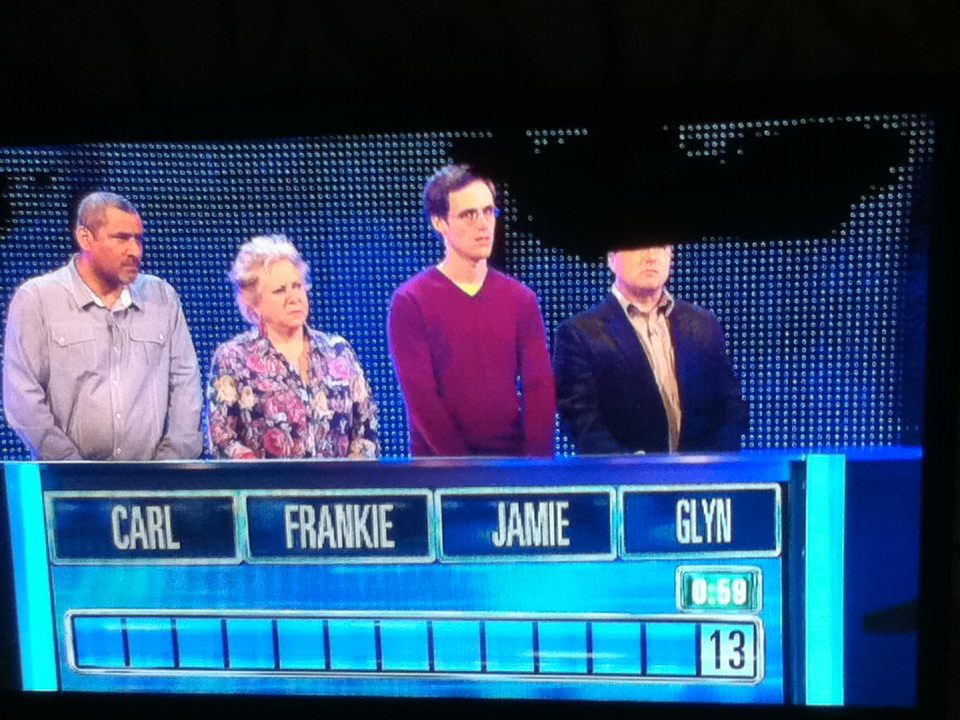

    LG Plasma TV Model No. 50PJ550
    FAULT

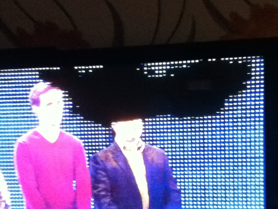

    Top third of picture hazy across full screen plus black patches that dissolve to nothing only to reappear depending on the brightness/darkness of picture. The haze symptoms remains at all times the TV is on. Any assistance would be appreciated, thanks.

    possible picture of the fault ?
    Posting pictures of the back of your tv showing the boards with clear pictures may help you more with fixing your problem

        Post a picture of the fault first then, before you take the panel down.

            Re: LG Plasma TV Model No. 50PJ550

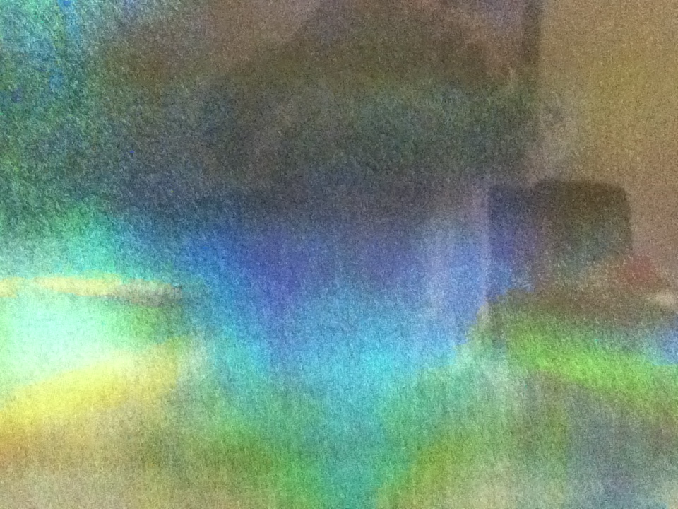

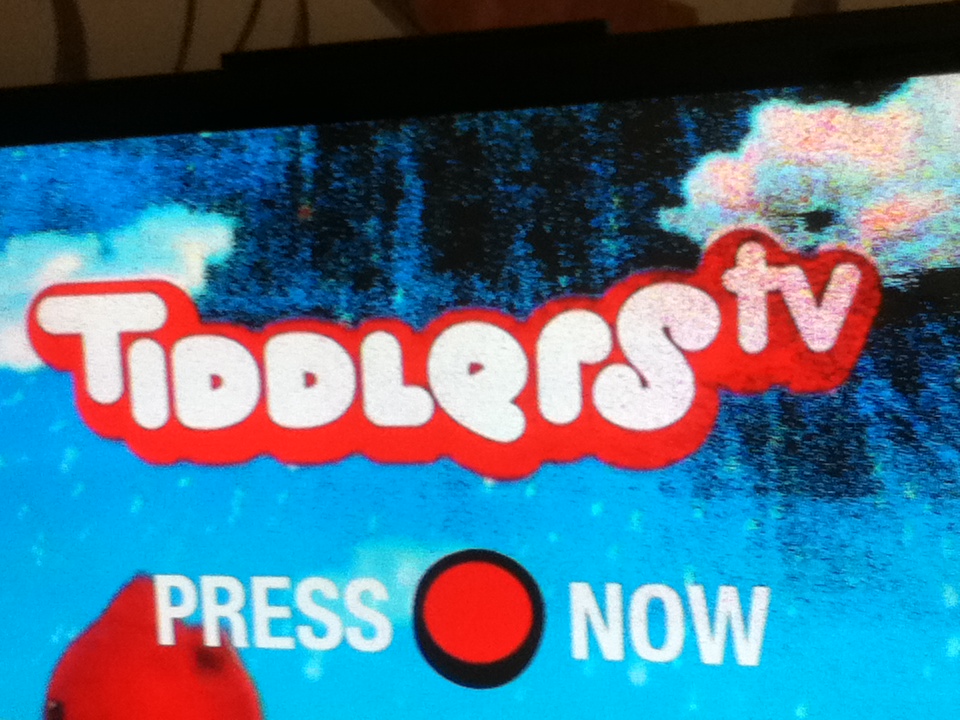

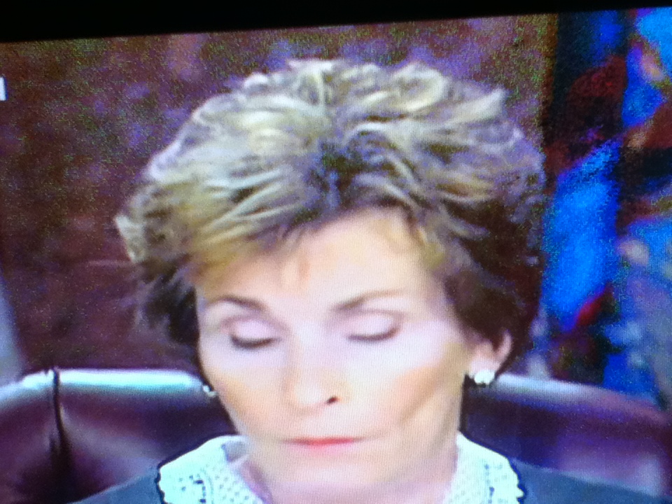

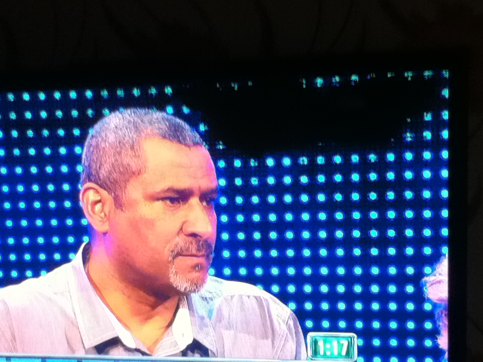

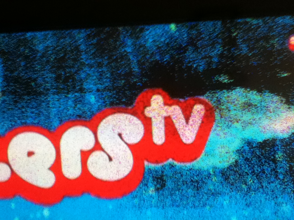

            Hope these pics are helpful, Thanks
              Check Vs, Va and particularly VSc Vy and VZBias....
              Ive got one of these rotten abortions, Keeps blowing SUS-Up and SUS-Dn IGBT's after say 10 minutes of otherwise perfect operation, in my case, I'm suspecting the panel itself but one thing I did notice--wrong VSc and Vy will give the effect you have....

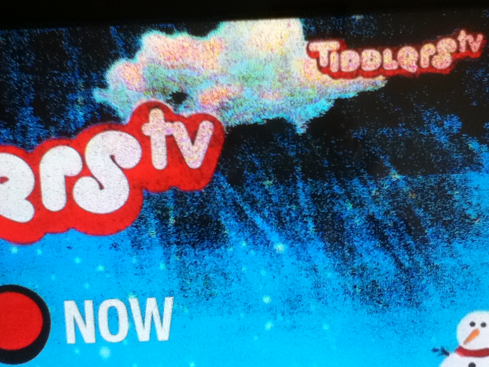

                Thanks for your reply however I am not very technical minded, I know basics and feel confident I could do an exchange board/panel without blowing myself up. I have clearer pics of what the trouble really looks like, I need to know what board I need to change that may cure the problem. Any help would be appreciated.

                  Does that black patch ever display picture or is it always like that?
                  I'm thinking that the fault would be on your Y-SUS board, if that patch shows picture sometimes--Same board I have a problem with, but at least yours doesnt blow up!
                    Alastair, the patch dissolves very much like clouds as the sun warms them, they do reappear as quick as they go and the process starts again.
                      I would suggest Z-sustain fault.
                        Really Tom....?
                        It Looks a bit bright and fair contrast for an X-fault to me....
                          Originally posted by Alastair E
                          Really Tom....?
                          I only suggest it, because I've seen similar on Samsung panels. The Z-output is working, but the Z-bias is missing for some reason. Some panels will even run ok without Z-bias, if Vsus is turned way up. Image may look a little fuzzy. Think freakaftr8 was playing with one doing that...
                                      I have been informed on another forum that my problem is on the Main Logic Board, not sure if the Z- board is the same one you guys are meaning, what do you think?
                                        Service manual for tv here http://www.scribd.com/doc/98218930/S...Service-Manual
                                        I have a Sanyo 50" that uses a Samsung panel and boards that was having similar issues with picture, see video here https://www.youtube.com/watch?v=xSewl8OINrA
                                        Turned out to be a bad cap on X or Z board, a 680uf 35v. The only low voltage cap on that board. After changing cap video https://www.youtube.com/watch?v=mB9i...ature=youtu.be
