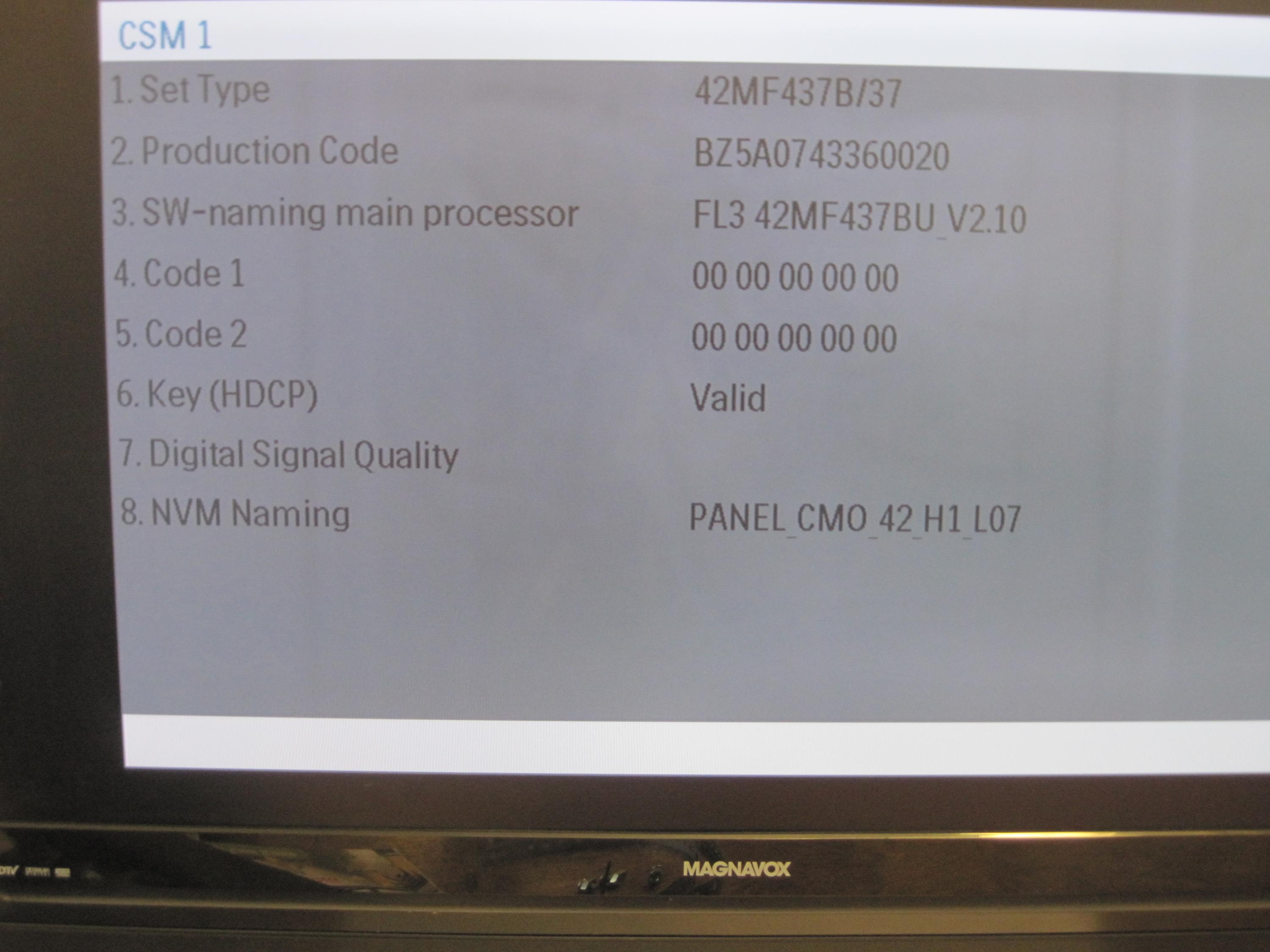

    I can access the 123654 menu from the remote and the other smaller menus, but the main menu fades quickly so I can't access the factory reset mode.

      I can access the 123654 information using the remote.

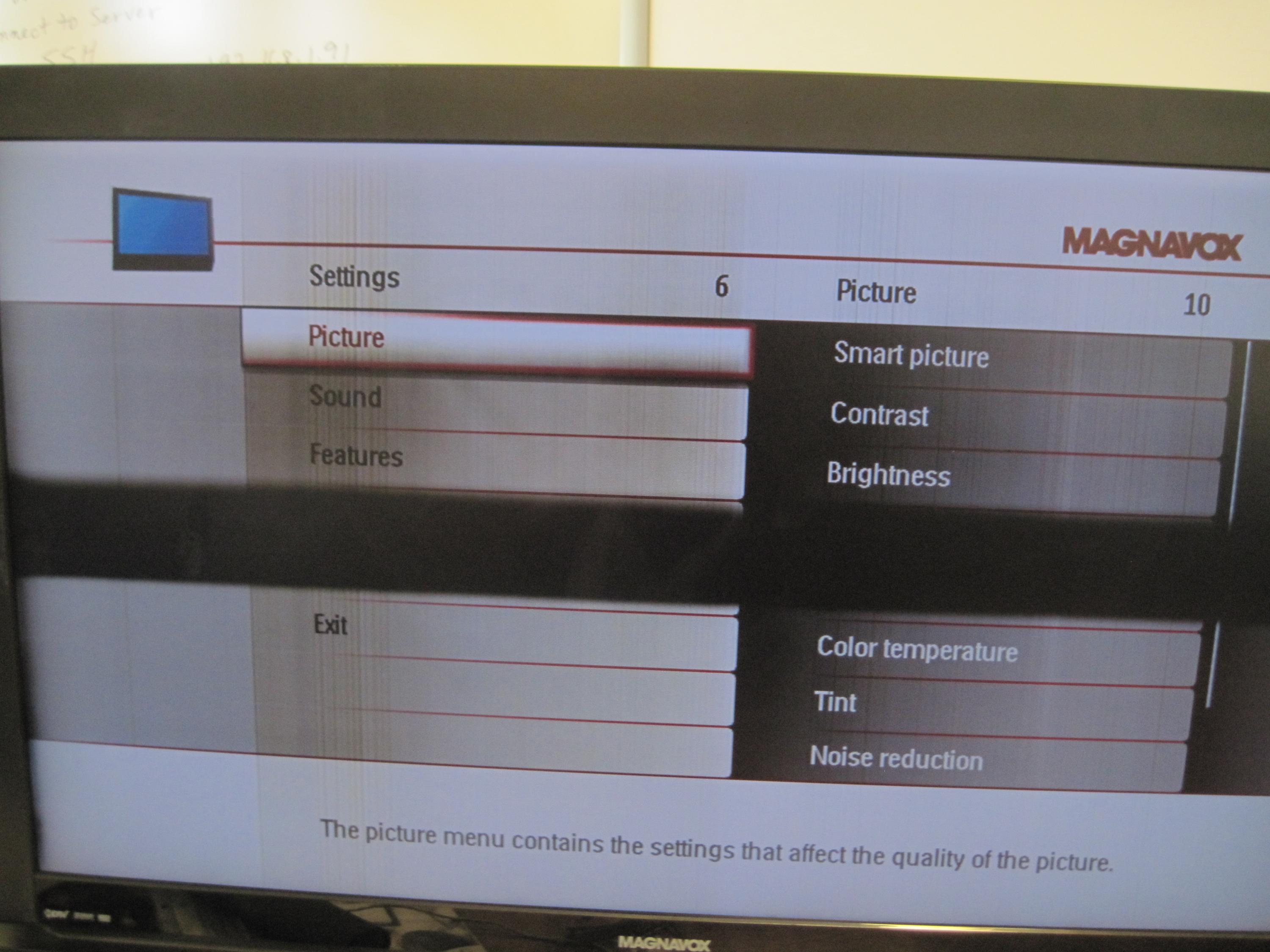

      The other two pictures show the menu screen fading out after hitting menu on the remote.
      What is a tab? I squeezed the frame and it seemed to make the picture last a bit longer.
        Re: Magnavox 42mf437b/37 picture fades
        I have seen this before, it is due to a tab bonding failure (panel failure) it MAY be fixable, but I've had bad luck doing it. Videos available on youtube demonstrate the fix, adding shims to the tab bonds to apply appropriate pressure to the tab bonds.
