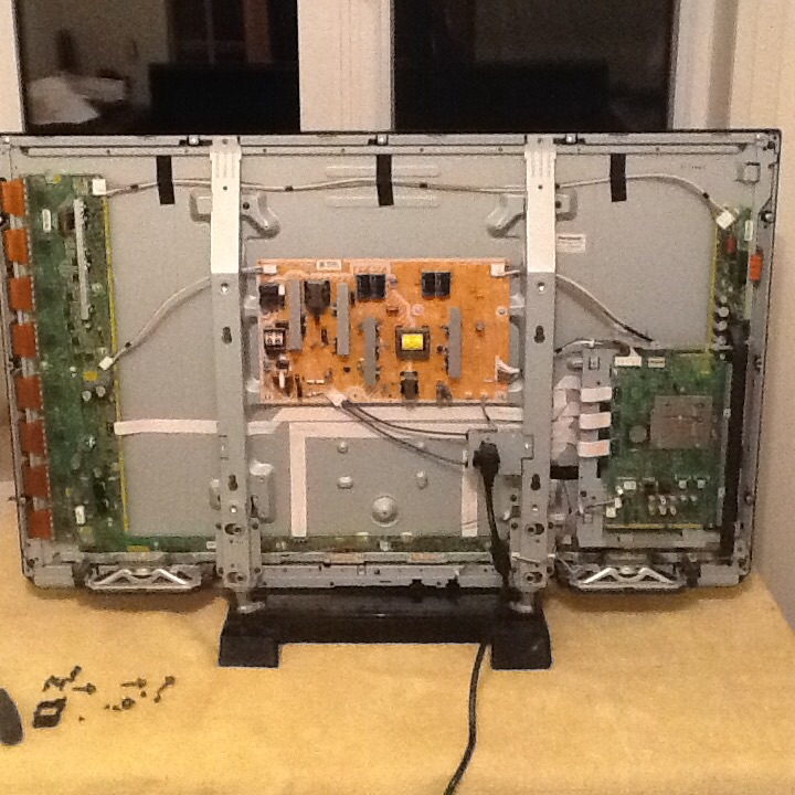

    Panasonic TC-P42X3 will not start
    I have no history on the set; when I plug it in I get a triple relay click and if left for ~8s another click.
    Initiating the power button gives the triple relay click followed immediately by the single click and the red standby led on steady the screen does not light.
    Did read over the service manual and did not find a place to start troubleshooting .
    If I hold the the power button a few seconds and release, I get 14 blinks from the standby led ?
    Any ideas where to look?

    Re: Panasonic TC-P42X3 will not start
    got a mulimeter? at the SN2 connector (TV off) first check in DC (215V) to be sure no voltage is there if it's been on recently, then measure resistance across the SN2 and see if dead short
      No voltage SN2 and yes it is shorted.

        that would be the fault then, I should have said disconnect the cable , if you did that and sn2 is short then Sn needs replacement / repair. I would also check ss11 and ss3 for short also with those cables disconnected as vsus goes to both sn and ss but I'm expecting just the Sn board has failed
          No sorry the short was on the p board side...

            can you expand on that. what was connected/disconnected and where measured.
            basically a dead short on vsus will cause a locked solid LED which it sounds you have. You have shorted vsus so we need to isolate to find whether it's sn,ss or both
              Sorry Tw2005 don't mean to be confusing...
              I did disconnect sn2, there is no short at the sn board terminals.
              When I checked the terminals at the p board I got continuity...
                ok, not what I was expecting so across p2 is shorted so if p11 is disconnected is there still a short measuring across p2?
                  With p11 disconnected no short at p2 anymore.
                    must be ss board, the only thing I'm unsure is whether any aprt of the SN is damaged. Is sn3 shorted at all if isolated, either pins 3 or 5 to gnd?
                      No 3&5 are not shorted to ground.
                        Originally posted by Fwrothy
                        Not sure of the pin #s,will have to check schem, short at top and middle pin of sn3.
                        look closely at the board, you will see numbers 1 & 5, 3&5 are the 2 pins you refer to so yes they are short to each other as they are the same connection, so are they shorted to gnd or to pin 1? I think pin 1 is gnd
                          Again tw2005 appologies, as soon as I looked at the schem I saw what was what, I've got a good light on the situation now as well ...Ive figured out that you are the resident expert on these Vera plasmas so I am trying to be brief and make the most of our time I edited the last post too late. That said, no shorts at 3&5
                            I really hate the word expert
                            I have some experience and a personal liking for the panasonic plasmas, always learning, still make mistakes.
                            certainly seems like SS board, cheap to buy, probably easy to fix but $20-30 for a board or $35 at shopjimmy
                            TXNSS1PPUU (TNPA5313AC)
                            keep the old board or flog it off for someone to play with. with these HD sets and the ss connected to the sn one can kill the other but I'd leave it as is and get a SS . If you are inclined to experimenting and powering it up I would make sure ss3 and ss11 are disconnected. if ss11 is removed and it will powerup there's a chance something wrong at ss3 could blow the Sn board. I've made that mistake.
                            If ss does not fix, depending on the error blink may also need SN but no shorts at the connectors at the sn is a good start. You could find tp82 (at the sc, usually near sn20)and just check that to gnd for the 15v line to be sure that is not short
