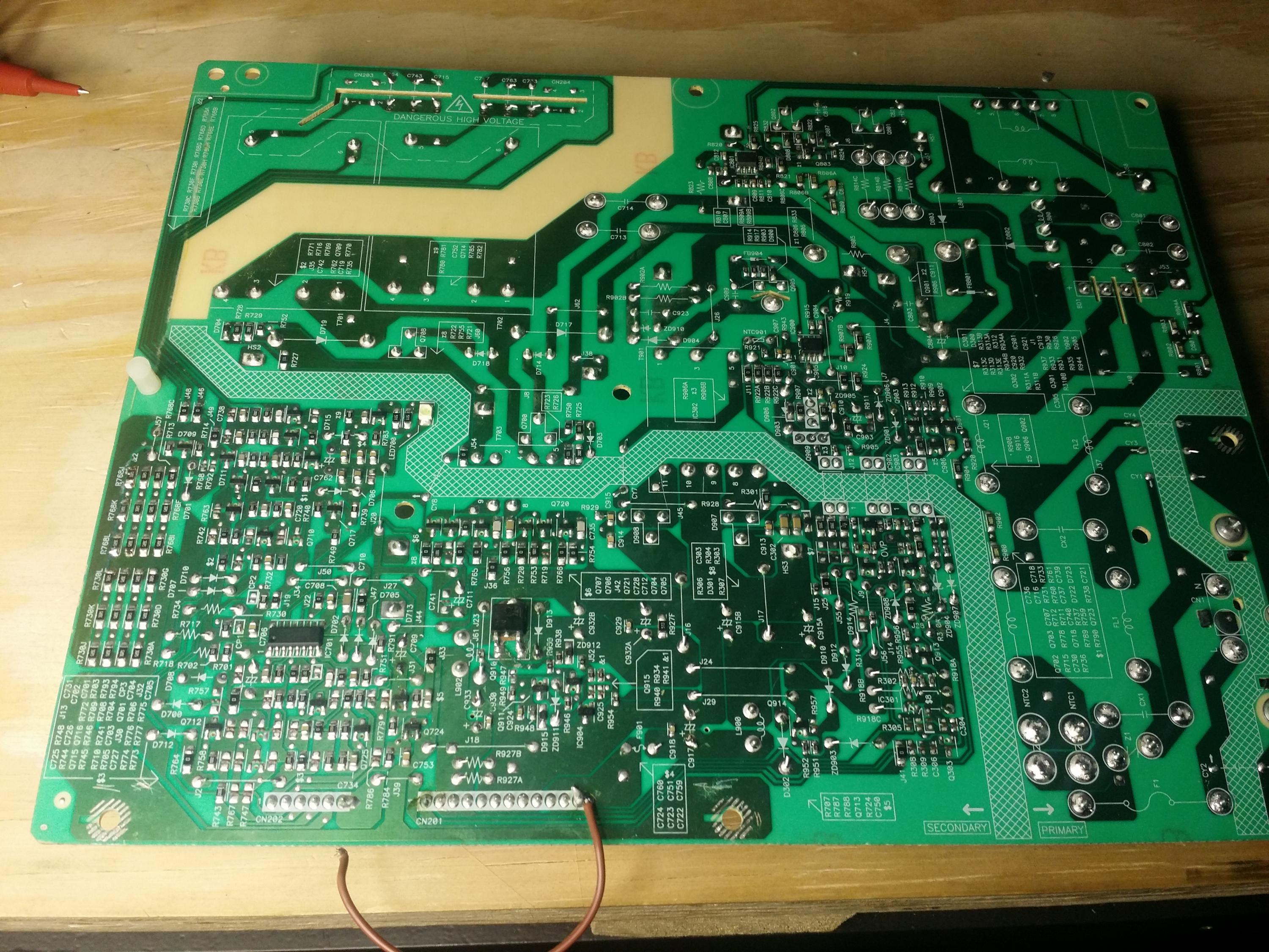

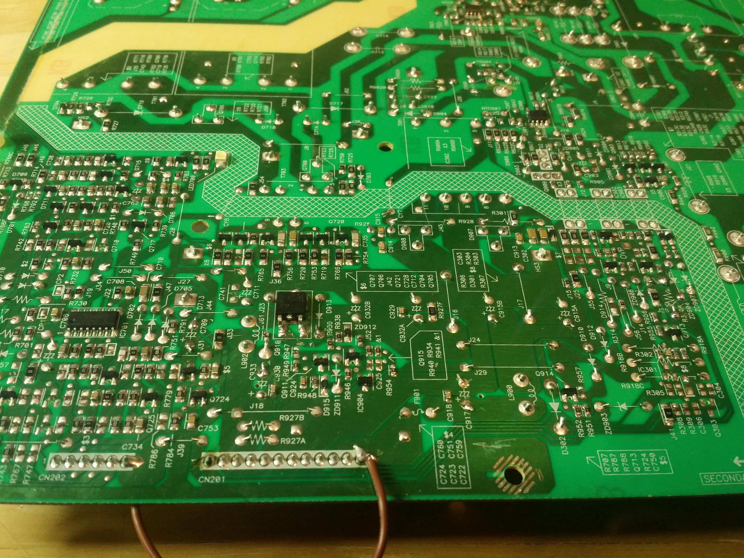

          I apologize.. I read that symbol wrong. I am getting 172V at the filter cap when it's on or off.. attached are pics of my actual board. I took the board out of the TV and ran a jumper from the 5V STBY to the PS_ON so it's at 5V. I removed Q910 to test it. I did think that it was odd that i got the 12V at 2 pins.

            Re: Vizio SV420M Power Supply 0500-0407-0890 No 12V output
            The PS-ON signal is not turning on the PFC Voltage booster right now because you are only getting 170VDC in stead of >360V.
            There is nothing wrong with that MOSFET. You need to get the PFC Voltage booster working first, the PS-ON is also used to turn on that MOSFET, but right now you need to find out why the PFC Voltage is not working, the PS-ON signal may not be getting to the circuits.
            BTW, I only one end of the wire attached to one pin of the connector, the other end is just floating.

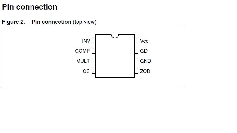

                    You need to get the P/N as printed on PFC Controller IC 801 to the spec sheet and the pin out to locate the VCC and see if if it is getting the VCC to run or not.
                      IC801 results below I used the the GND on the IC to measure the voltages..
                      L6562A
                      1-INV - 1.08
                      2-COMP- 6
                      3-MUNTI - .877
                      4-CS - 0
                      5-VCC - 16.69
                      6-GD- 0
                      7-GND -
                      8-ZCD - .473
                        So just to verify that the PS-ON is OK, the VCC should be at 0V, and then it should go up to 16.69VDC as you measured, then we know that the PS-ON does get through.
                        It is getting enough VCC (16.69V) to run, but there no Gate drive (GD) output.
