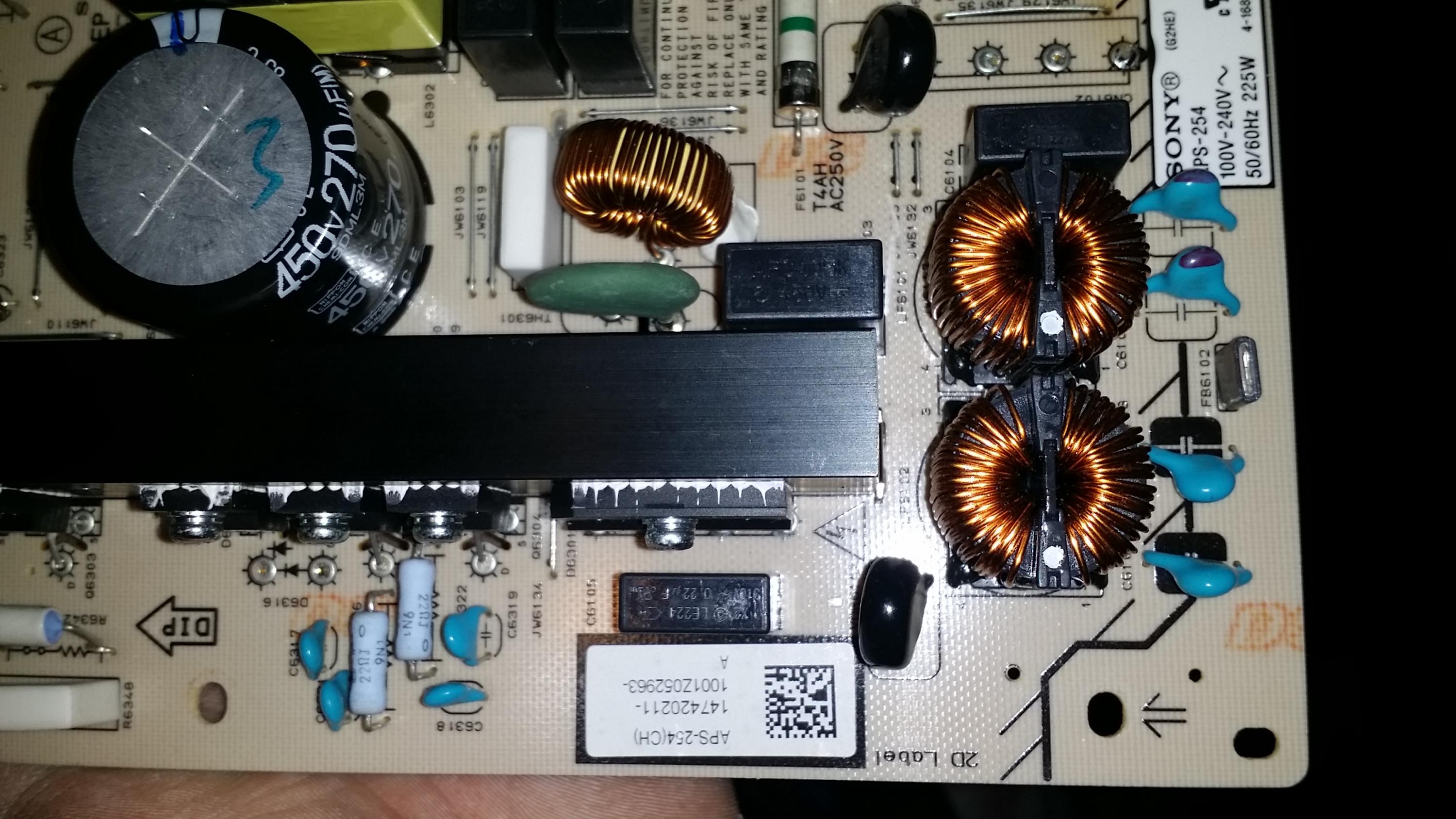

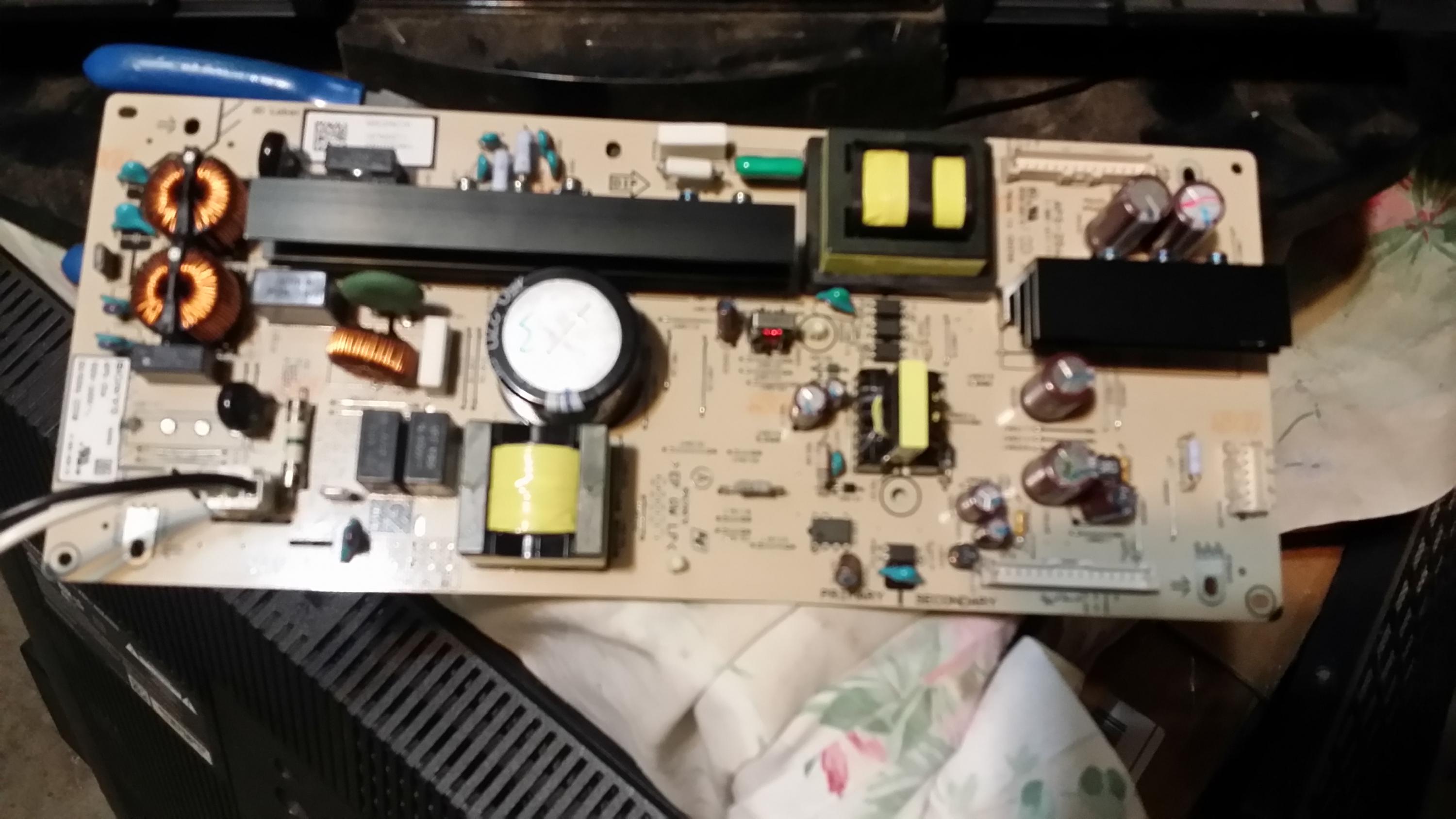

    Ive got a Sony 40EX400 That I get good reading from the power supply heres the list of what I get
    This is from CN6402 going to the inverter board. Im counting the pins 1-14 from top to bottom.
    Pin 1 - 25.7vdc This is labeled as 24v
    Pin 2 - 25.7vdc This is labeled as 24v
    Pin 3 - 25.7vdc This is labeled as 24v
    Pin 4 - 25.7vdc This is labeled as 24v
    Pin 5 - 25.7vdc This is labeled as 24v
    Pin 6 - 0 This is labeled as Ground
    Pin 7 - 0 This is labeled as Ground
    Pin 8 - 0 This is labeled as Ground
    Pin 9 - 0 This is labeled as Ground
    Pin 10 - 0 This is labeled as Ground
    Pin 11 - 3.292vdc This is labeled as BL_ERR
    Pin 12 - 3.9 mVdv This is labeled as BL_ON
    Pin 13 - Theres no wire here. Labeled as NC(ADIM)
    Pin 14 - 4.0 mVdc This is labeled as Dimmer.
    On the other connector going to the main board labeled CN6401 once again labeled 1-14 from top to bottom is
    Pin 1 - 0 This is labeled as TCON ON
    Pin 2 - 0 This is labeled as TCON VCC - 12V
    Pin 3 - NC
    Pin 4 - 4.1 mVdc This is labeled as Dimmer
    Pin 5 - 4.0 mVdc This labeled as BL_ON
    Pin 6 - 3.293 Vdc This is labeled as BL_ERR
    Pin 7 - 12.71vdc This is labeled as REG12V
    Pin 8 - 12.70vdc This is labeled as REG12V
    Pin 9 - 0 This is labeled as REG12V GND
    Pin 10 - 0 This is labeled as REG12V GND
    Pin 11 - 0 This is labeled as AU12VGND
    Pin 12 - 12.71vdc This is labeled as AU12V
    Pin 13 - 3.74vdc This is labeled as POWER ON
    Pin 14 - 2.712vdc This is labeled as ACOFFDET
    Pin 15 - 3.299vdc This is labeled as STBY3.3V
    I checked the voltage that is outputted from the main board to the key pad to make sure the power button was getting the P_ON and 2 out of the 4 pin connectors read 3.29vdc. This is on CN950 of the main board.
    Another thing to note, normally when you plug just about any tv into power you hear 1 or 2 relays click once or twice. When I plug this one in I hear no relays click.
    SOOO I have good voltage to the components, the inverter and the main board. Does this mean possibly the mainboard is bad? Or am I still looking at the power board with no clicking.
    Furthermore do the boards always output this high of voltage without being switched on?
    Another thing to note is when I got this tv the power cable inside had come loose from the pin connector on the power board and looks as if they were arcing out all over the place and I had to replace the fuse marked F6101 and underneath the board there places the the conductor metal in the board that were basically blown away, so I took some solder and bridged where conductive part of the board was gone.
    So am I looking at getting a new main board or do you guys think there will be more underlying issues with the power supply because the relays dont click when you power it on or plug it in?
    Thanks guys I really need your help on this one im stumped.

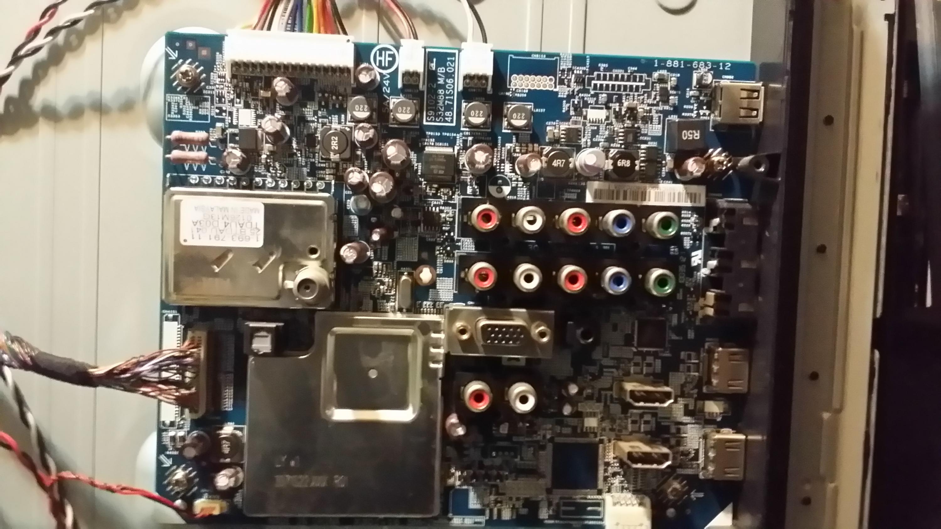

                              Okay, It seems my main board is just dead. Im getting voltage out to everything but the mainboard doesnt seem to do anything. The usb I put the update has an light on it that tells you when its being accessed or read, and it does nothing no matter what combination I try to power on the tv with. I just seems like once I plug the tv in its just on, but its really not. I jumped the standby voltage to the BL_ON and got a light from the screen but only for a split second. Then it goes away.
                              All voltages read the same as previously, still no progress.
                              • coreyand
                                • Nov 2014
                                • 88
                                Re: Sony 40EX400 Dead Power supply reads good
                                Bud, I tried disconnecting the cable from the tcon and mainboard already with no change. No lights on the front nothing. Is there an onboard fuse on the main board because if there is I bet its shot. I dont see one though. Are there even relays on this power board to click, Im not seeing anything like that on this board.

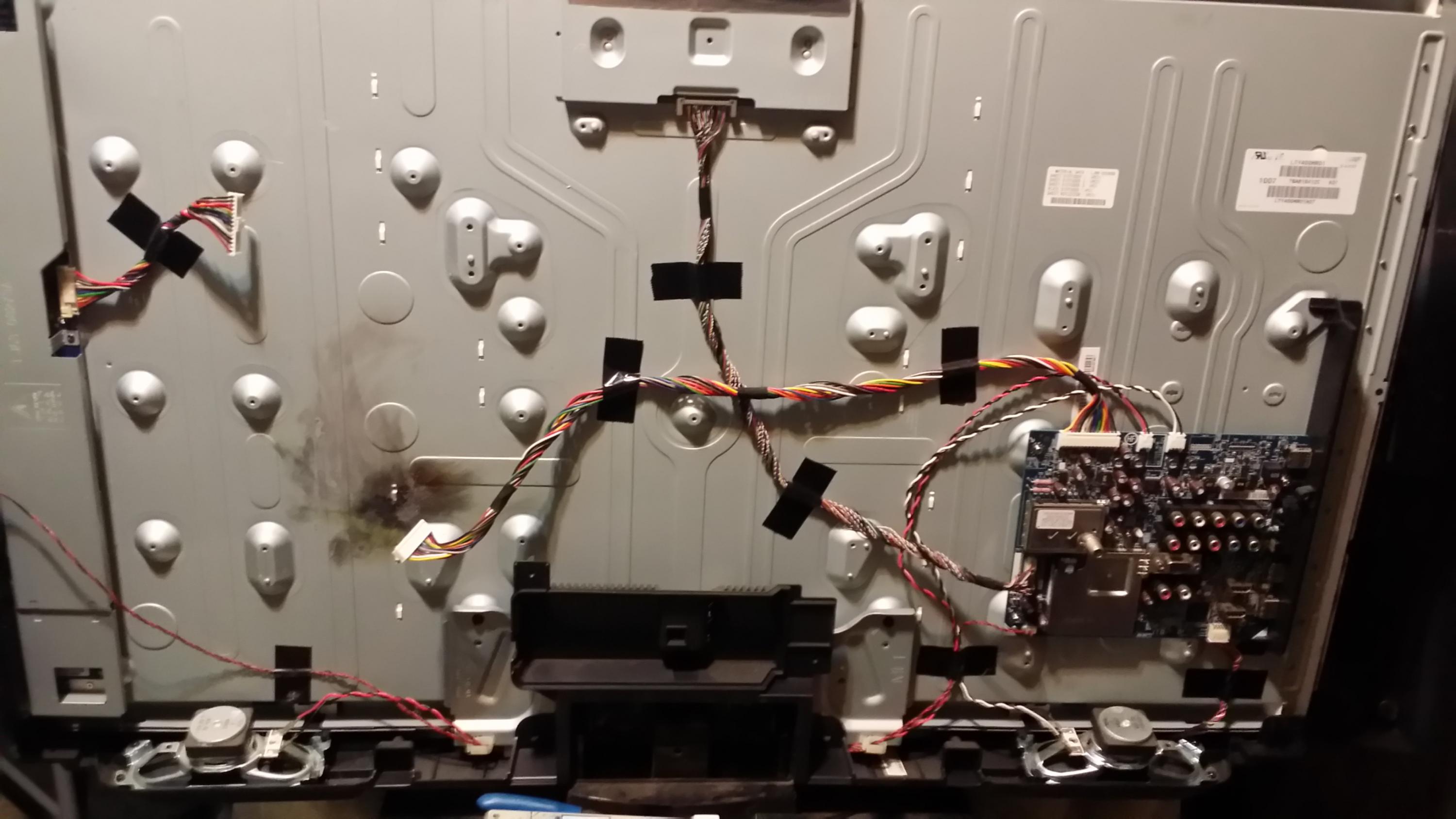

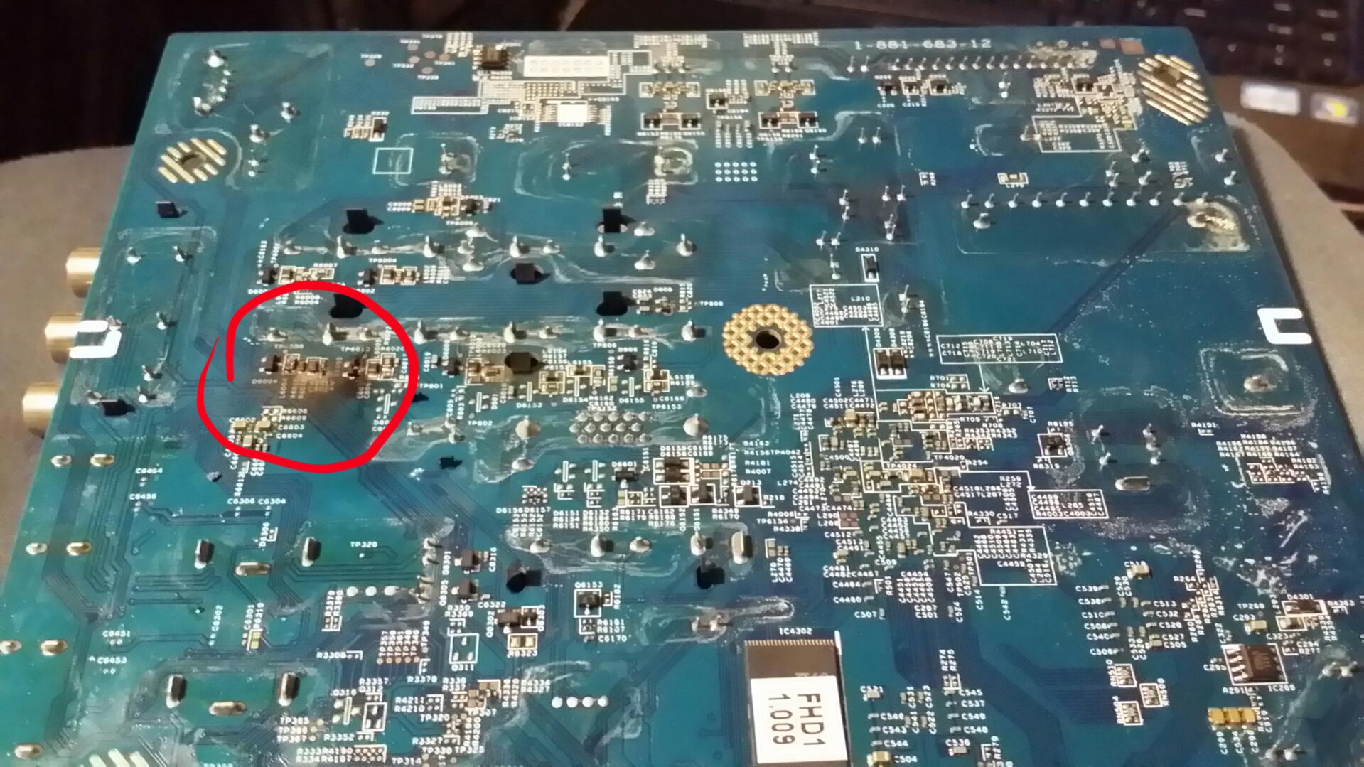

                                  I believe I have an problem with the main board right around this area(See picture)
                                    That looks bad, something got really hot there. I would say it is time for a new main board.
                                    • coreyand
                                      • Nov 2014
                                      • 88
                                      Yea me too, Im looking at this one http://www.ebay.com/itm/SONY-KDL-40E...item1c4e626f4d
                                      • CapLeaker
                                        Leaking Member
                                        • Dec 2014
                                        • 8327
                                        Ooyyyyyy... New main board it is.
