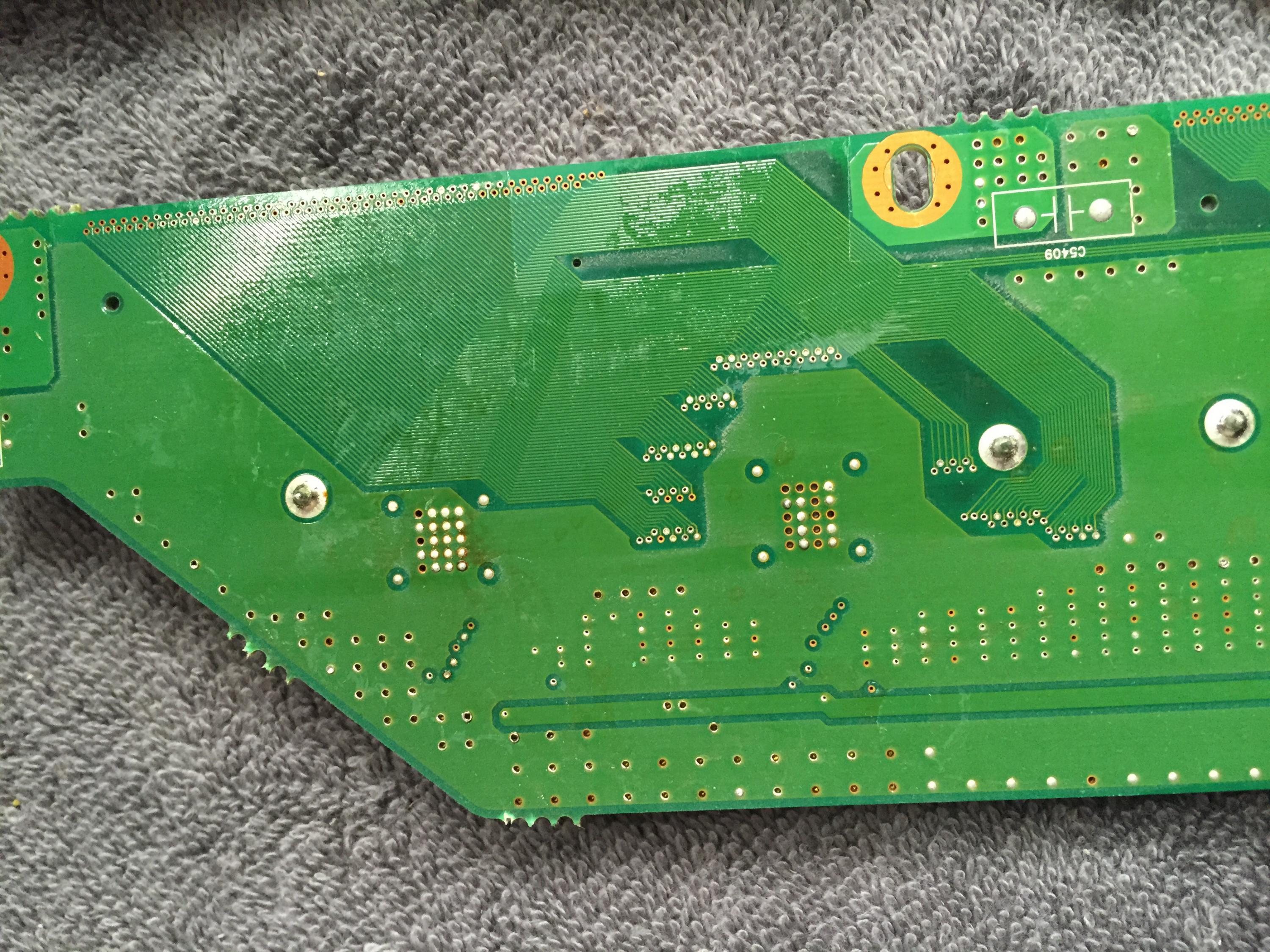

    Originally posted by freakaftr8
    definitely sounds like a short in buffer driving the voltage is down going into reset
    His upper buffer looks suspect to me, the up one in his photo the first set of 4x5 20 hole solider points look really dark as if it was burn but not though the board like mine was.
    But we will wait to see what he finds out from the test.

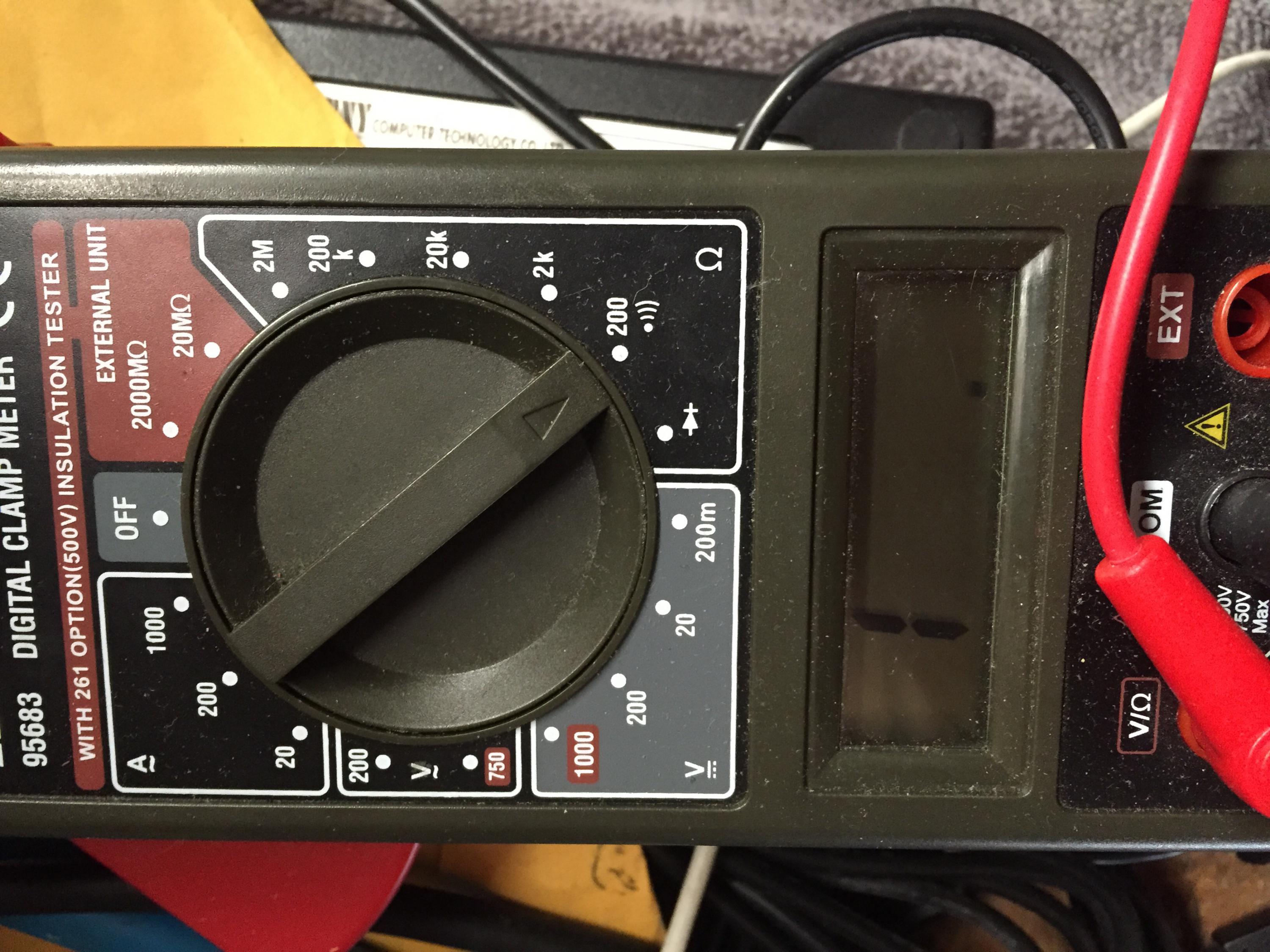

      Re: Samsung PN58A550S1FXZA turns on with audio chime, but doesn't completely turn on.
      So I checked all of them on bothe these settings and I git beeps on both boards on the "200" setting in this photo and I got a .000 reading on the other setting. Did I do it wrong?

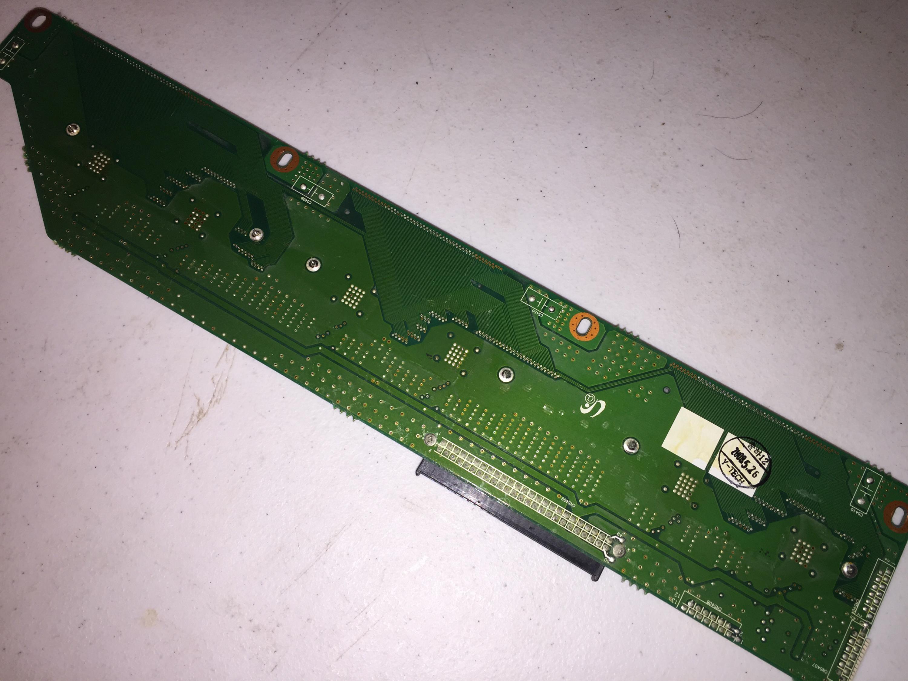

            Y board upper

              #46
              Gotcha, want to try some shotgun testing?
              Put in your bottom buffer and hook it up as normal and try to see if you get half a picture.
              2 out of the 3 I have worked on (one having a busted screen) the two I got working were both upper ybuffer failures.

                #47
                Upper

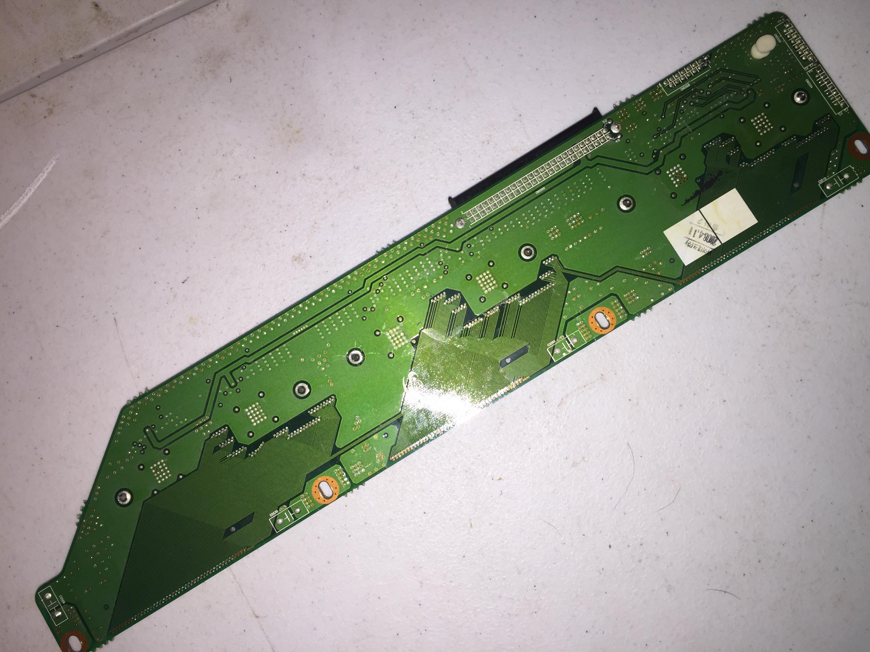

                  #48
                  Lower

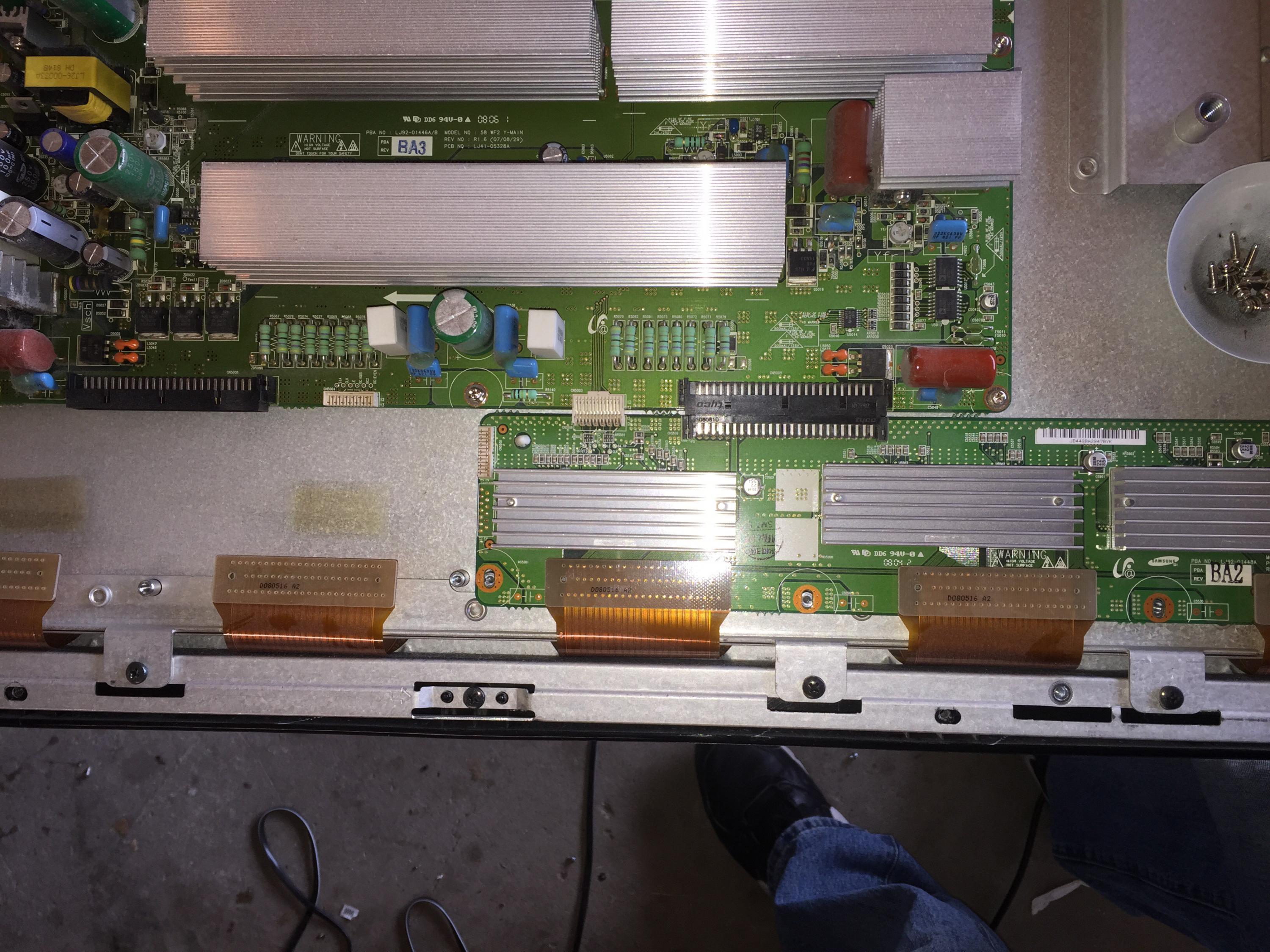

                    #49
                    Like this?

                      #50
                      Make sure all the screws are in the Ybuffer. But yes.
