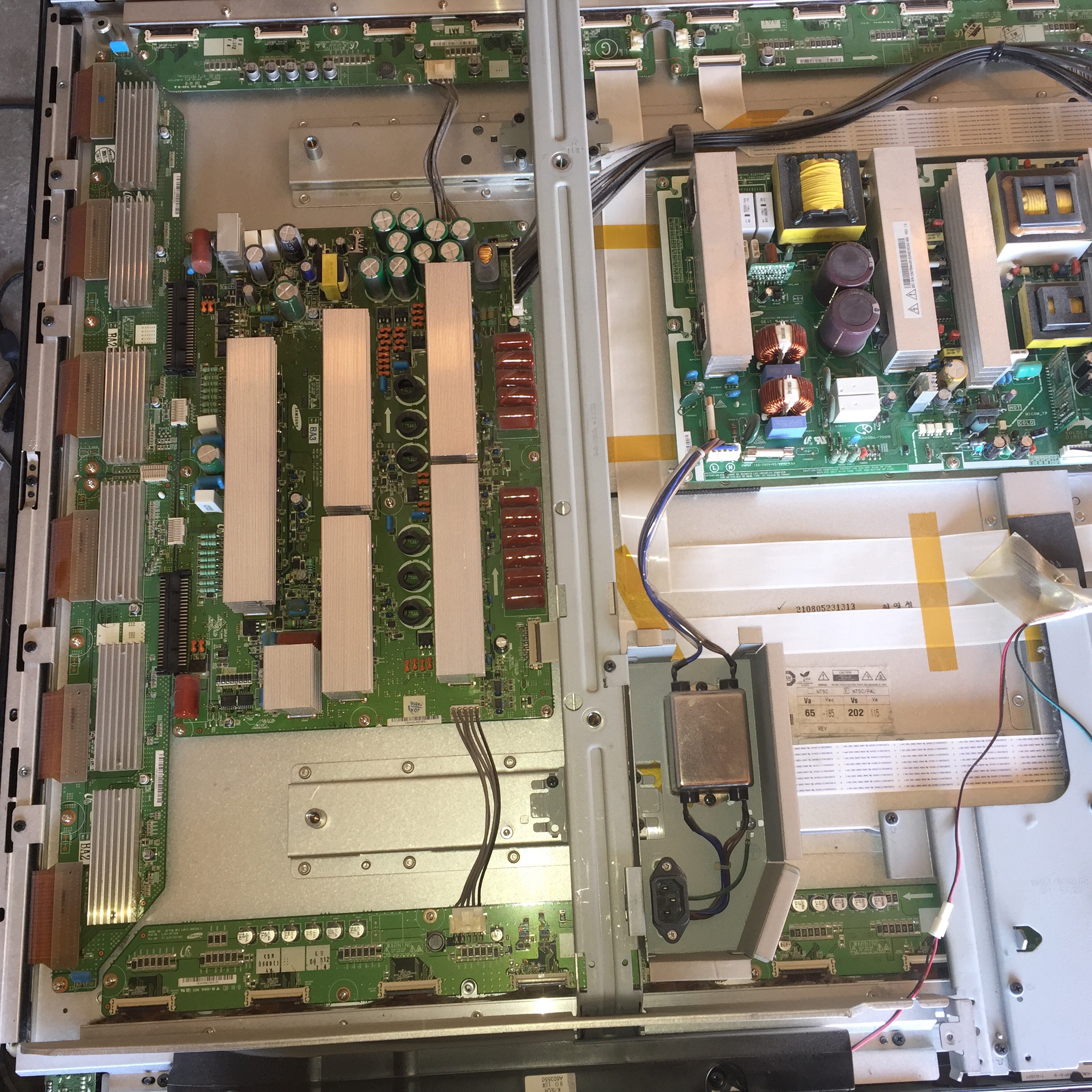

This is what it was doing. I plug the TV in and the power supply clicks a few times and the green LED lights turn off and on really fast one time. Then I let it stand for about 30 seconds while I write you this messege and it tries turning itself on by itself and fails halfway through, now the green lights are flashing at the same time non stop and there is constant clicking coming from the board on the left side of the TV . And that is it.
Samsung PN58A550S1FXZA turns on with audio chime, but doesn't completely turn on.

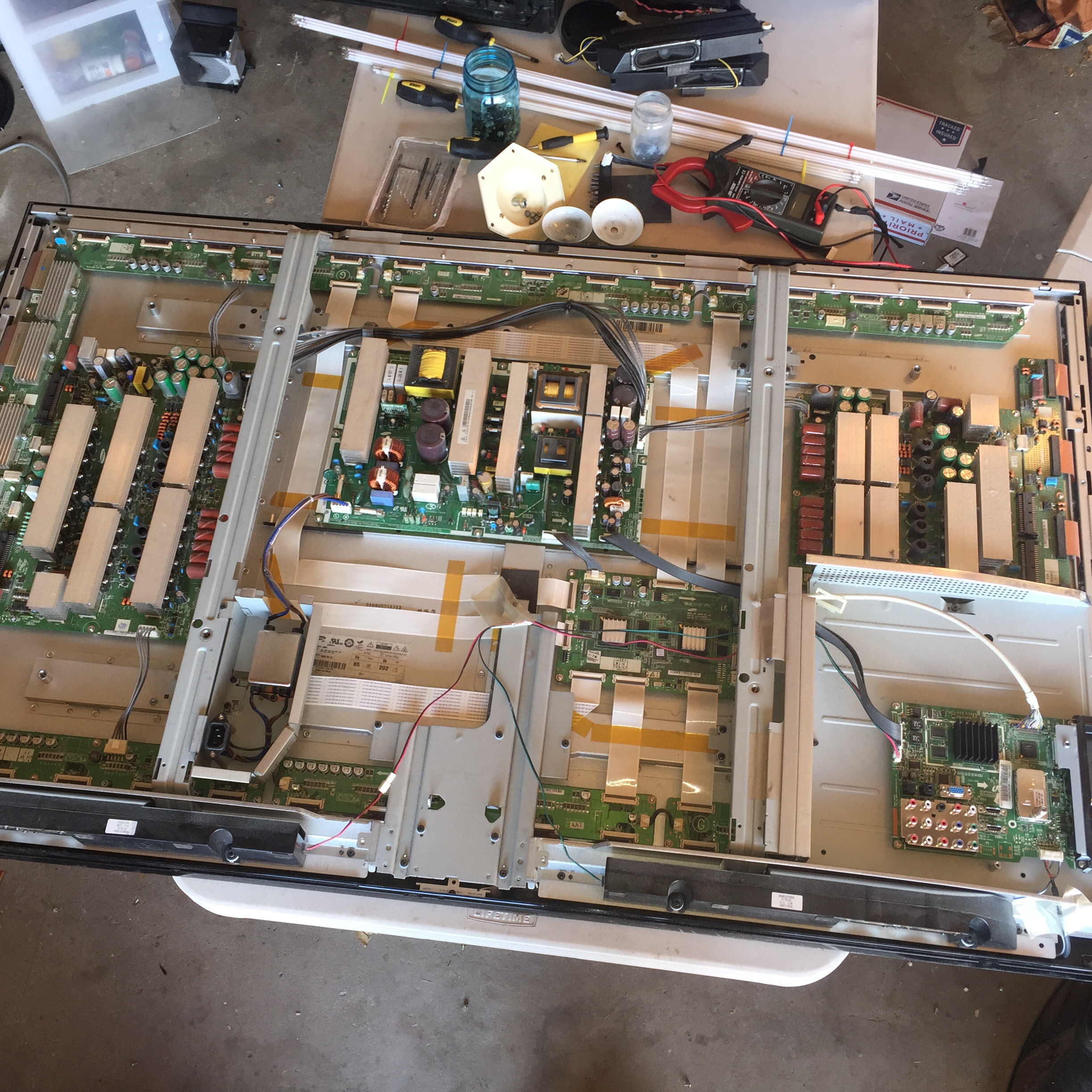

ALittlebit, post some pics of the back of TV with all boards attached. This will help in getting advise. Just scroll down from where you post till you see manage attachments and that is where you insert yours pics. -

Stand by for more photosComment
Re: Samsung PN58A550S1FXZA turns on with audio chime, but doesn't completely turn on.
Stand by doing it nowComment

Is that the y-main?Comment
Disconnected this ribbon cable with the same outcome.Comment
Okay I did the y-main. That's what the photo was.Comment
No but I will nowComment
Could this be the infamous C102 problem with the mainboard?Comment

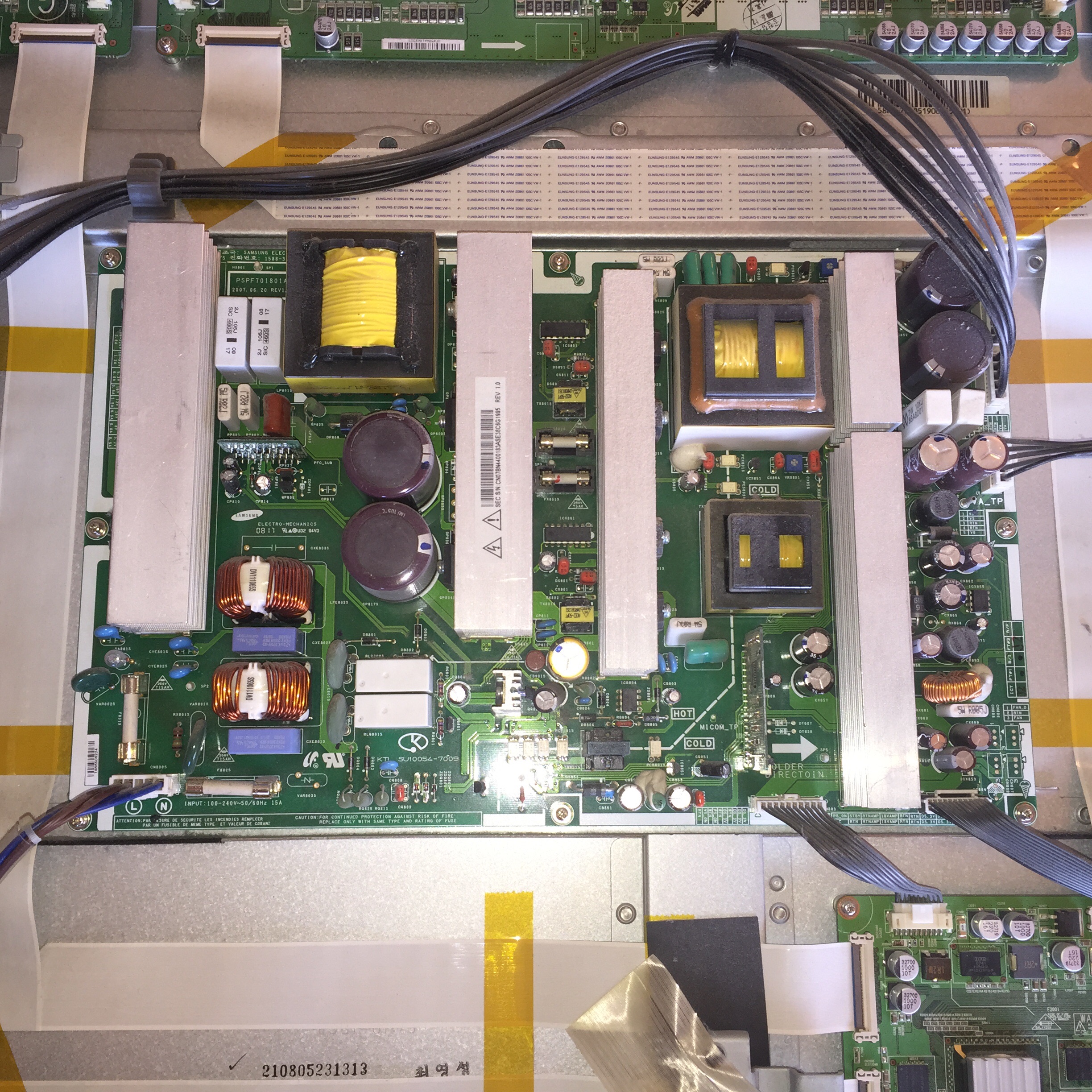

Disconnected the power supply completely from the y-main. Same outcomeComment
No this is not the main. I checked a lot of forums and asked a lot of repair offers for that issue and they all say it is not the same symptoms.Comment

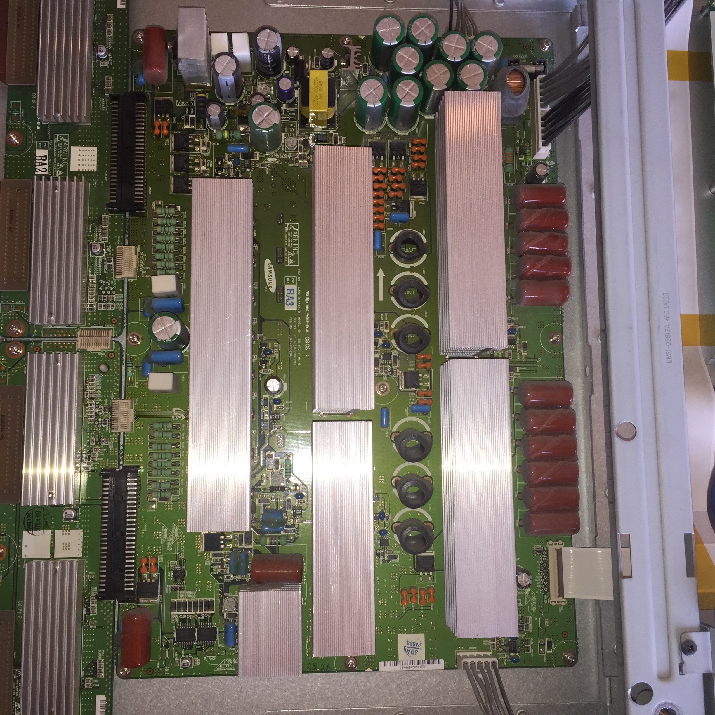

Was thinking that too,
Lets try the Xmain, Same deal as the Ysus (leave the ysus disconnected still).
I am pretty sure with both Y-X not connected the unit still powered up.Comment
