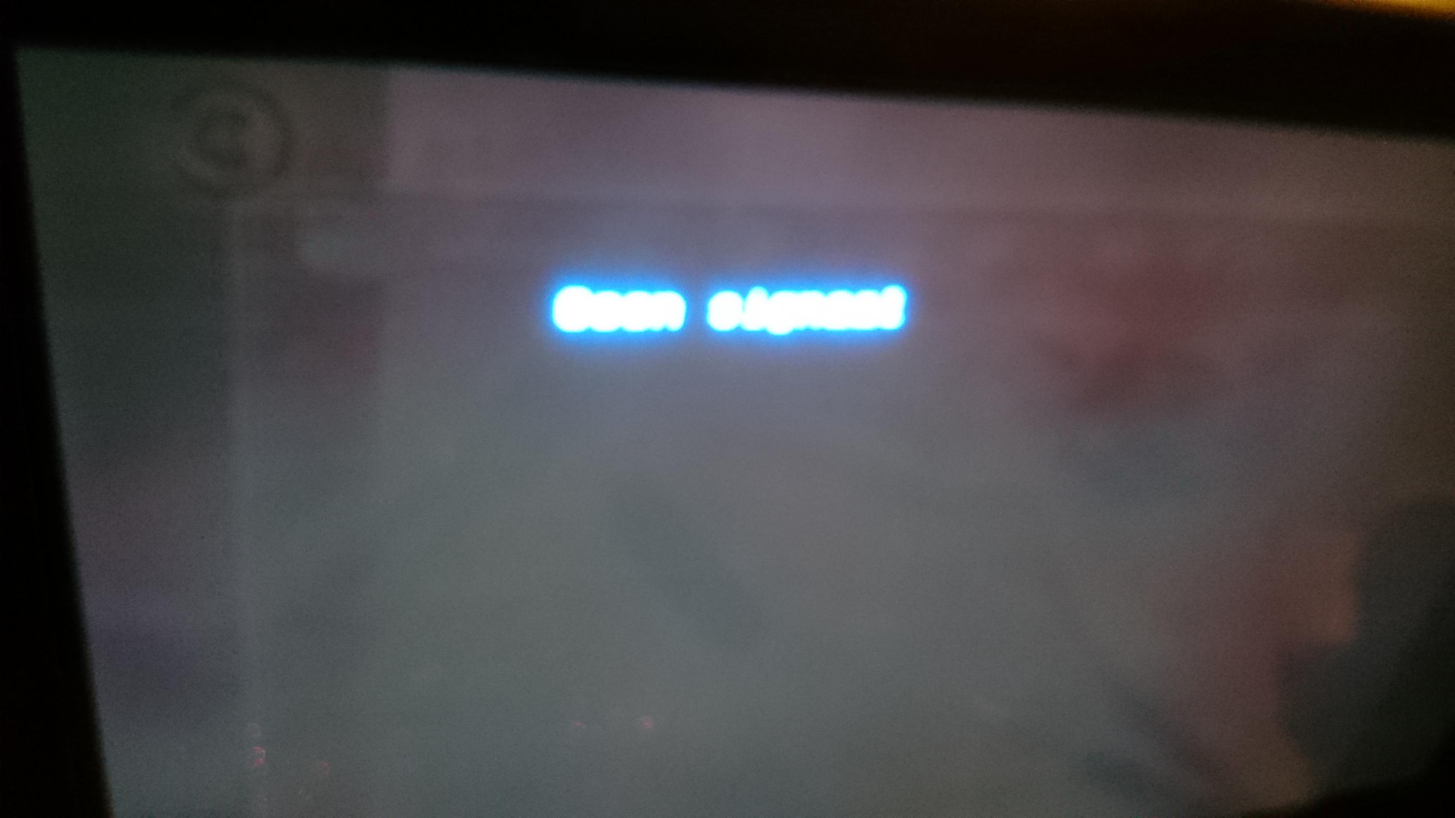

    Hey guys!

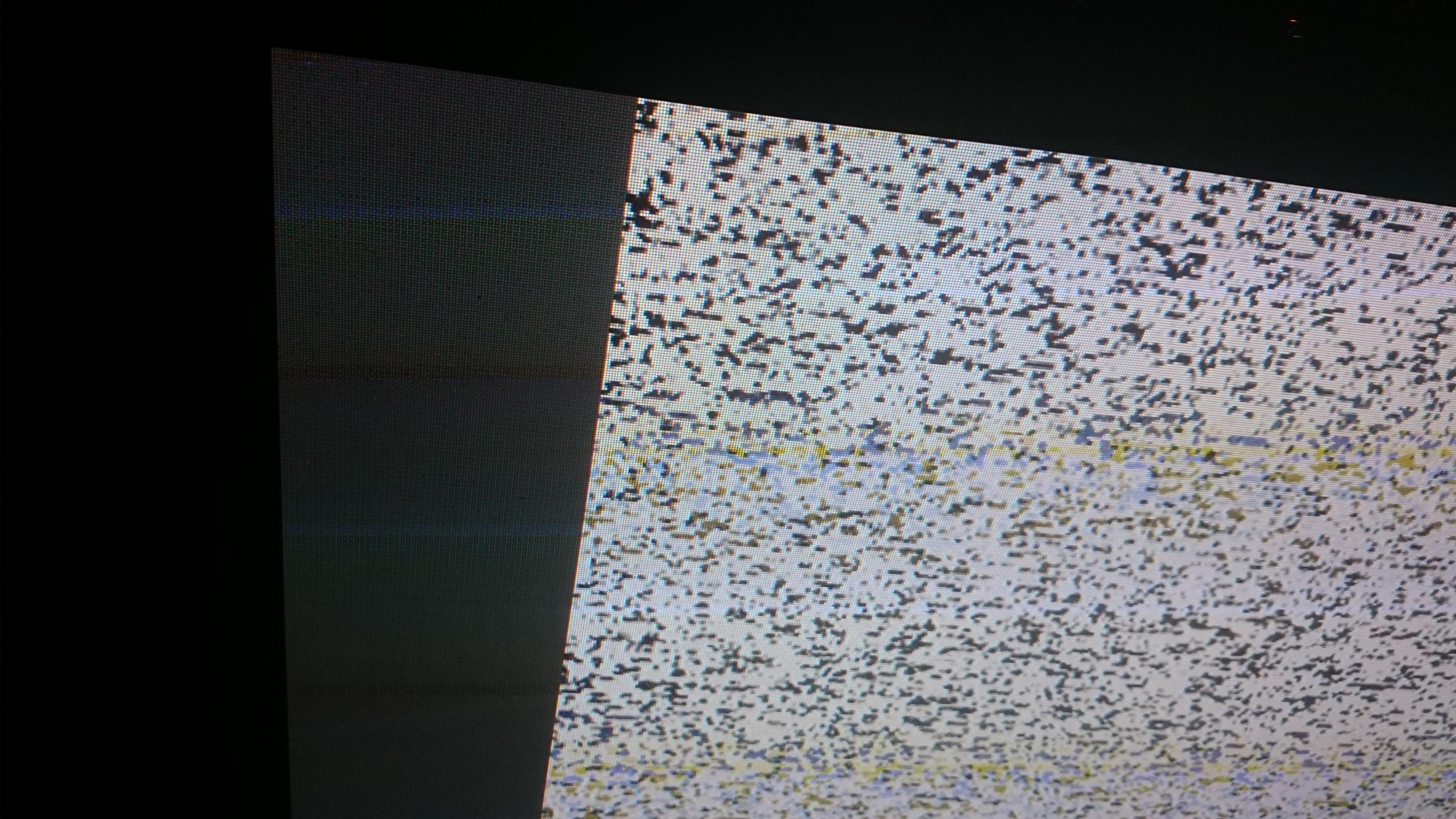

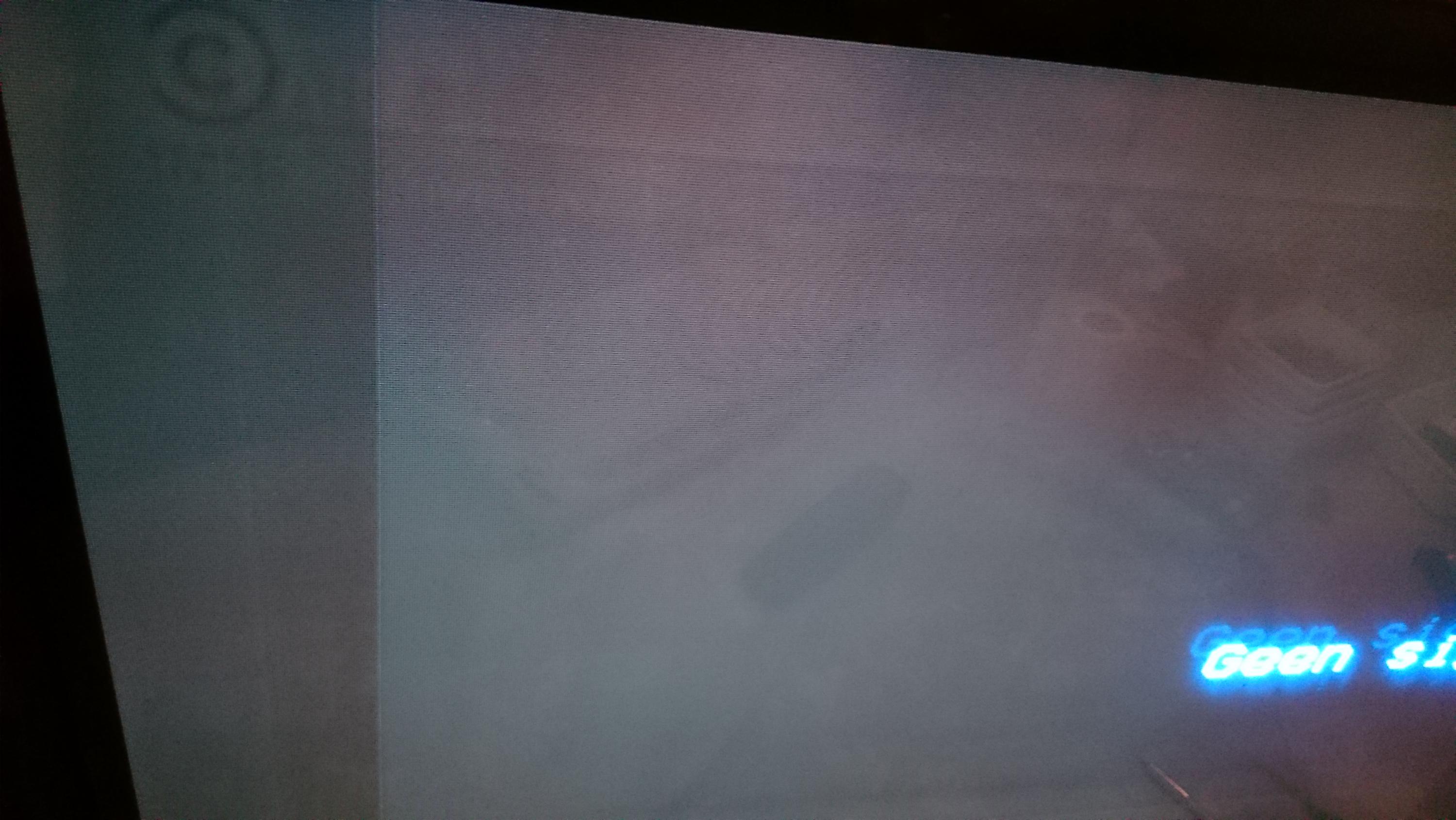

    So i got this plasma wich turns on perfectly but is having issues with the screen.
    On some input channels i get the "burning in" problem , so without anything connected to the tv and input is HDMI i see the comedy central logo but its gone when i use the menu or use TV input. ( snow )
    Also when i use the factory settings and reinstall the tv its completelt gone but the Menu itself will burn in inmediately. So after installing the tv with the correct language/country etc and i select HDMI 1 i see the menu in the background...like a burn in.
    Is the dynamics to high or is this something else? I almost want to degauss the tv if that was possible haha.....
    Is the screen getting to much power? I also get red sparkles in the lower left corner after 5 minutes , also around the lines of the menu i see also sparkles..

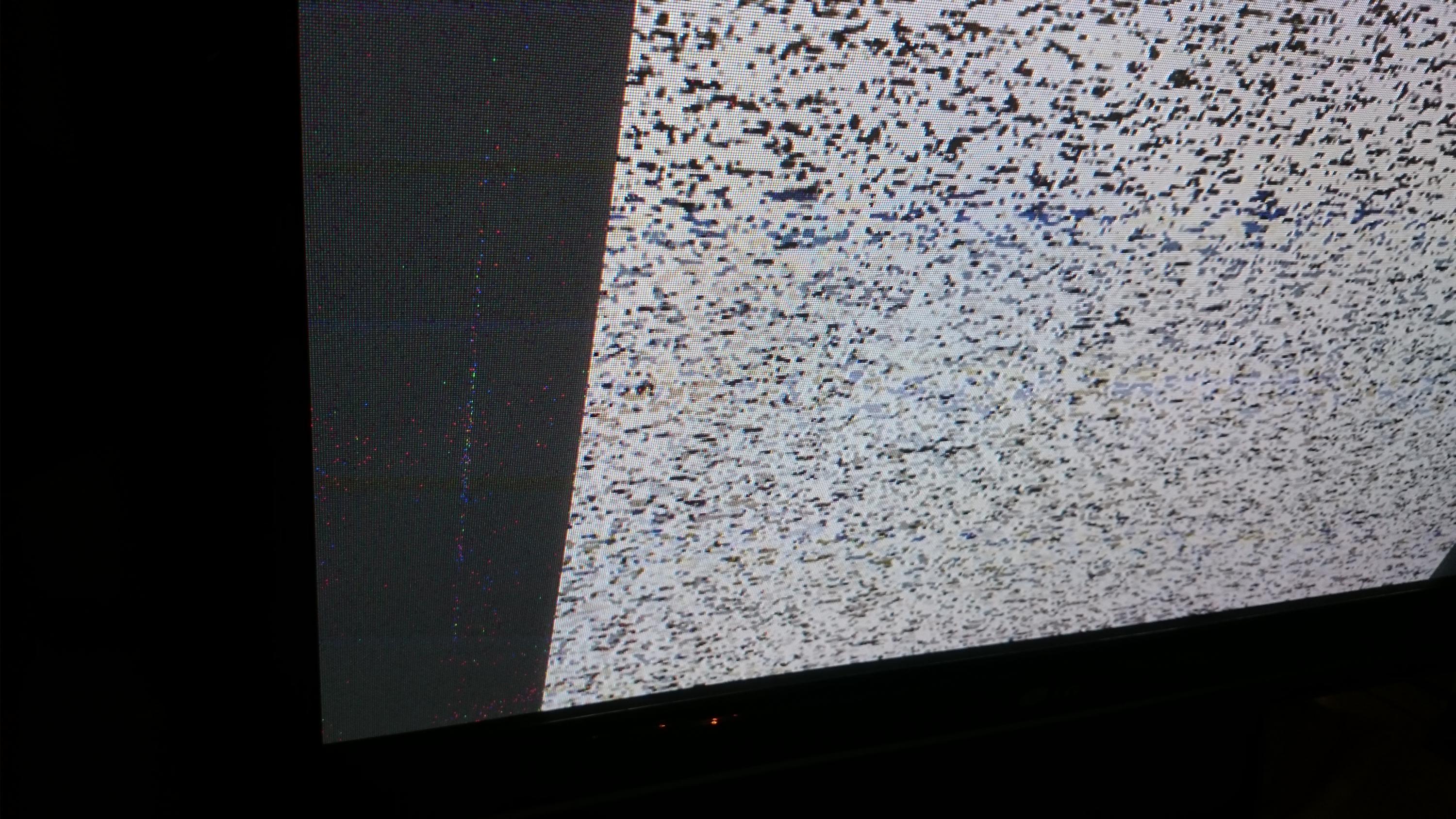

    Ps ,picture 3 is actually the first picture and when i switch to hdmi or component i get the first 2 pictures , it burns in almost inmediately?
      Re: LG 32PC51 ( Plasma burn in and sparkles )
      Looks like image retention to me. Worth checking all panel voltages. May need LG firmware update flashed to fix.

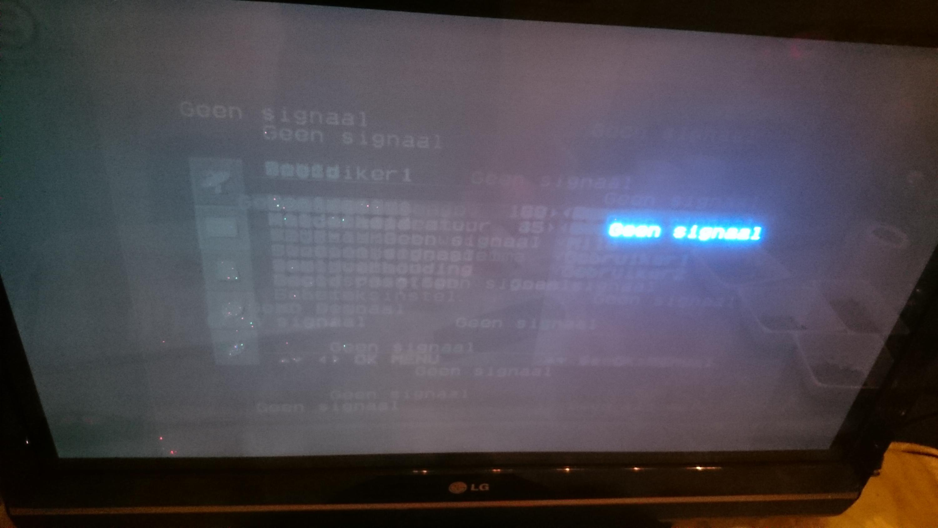

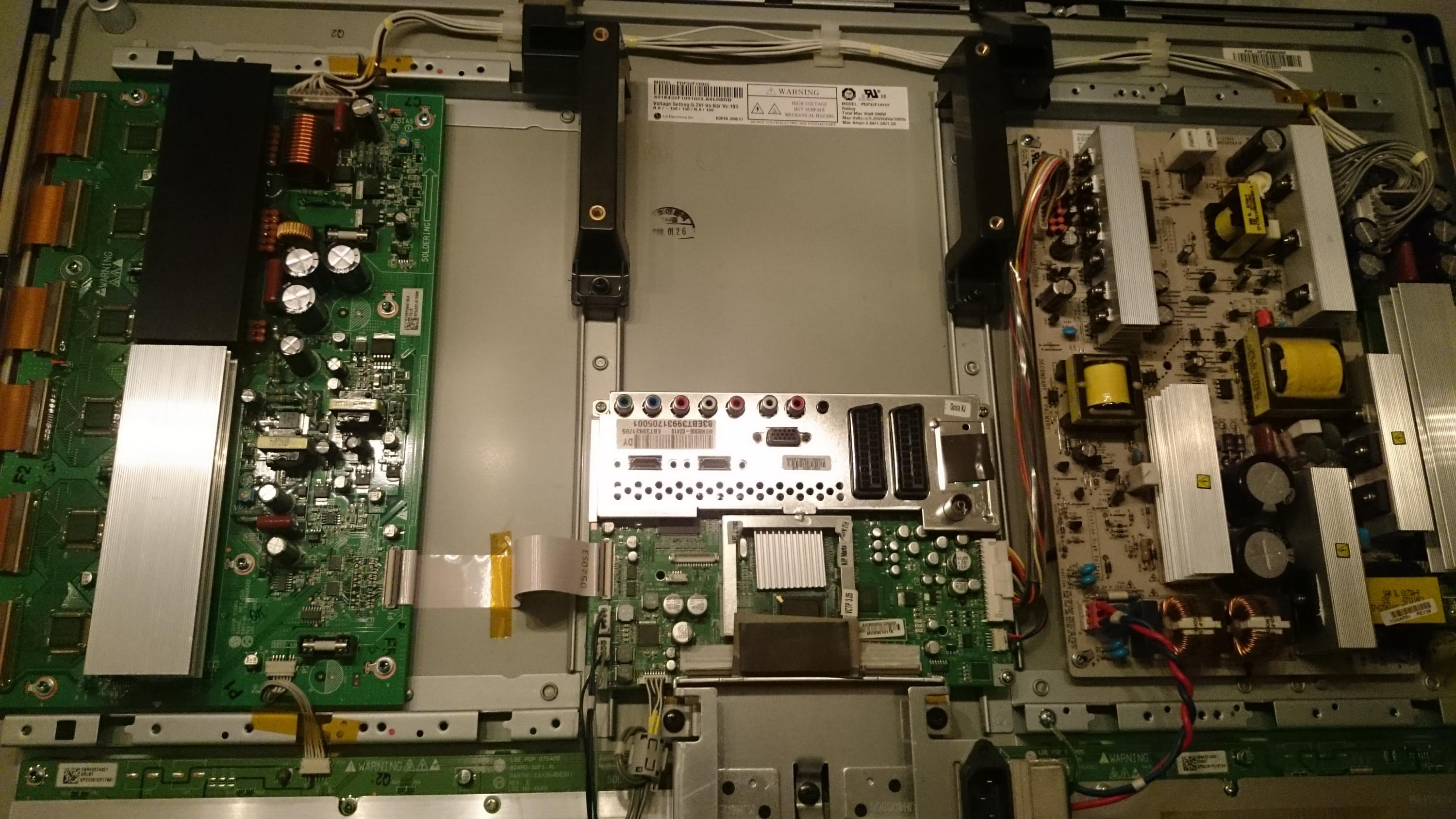

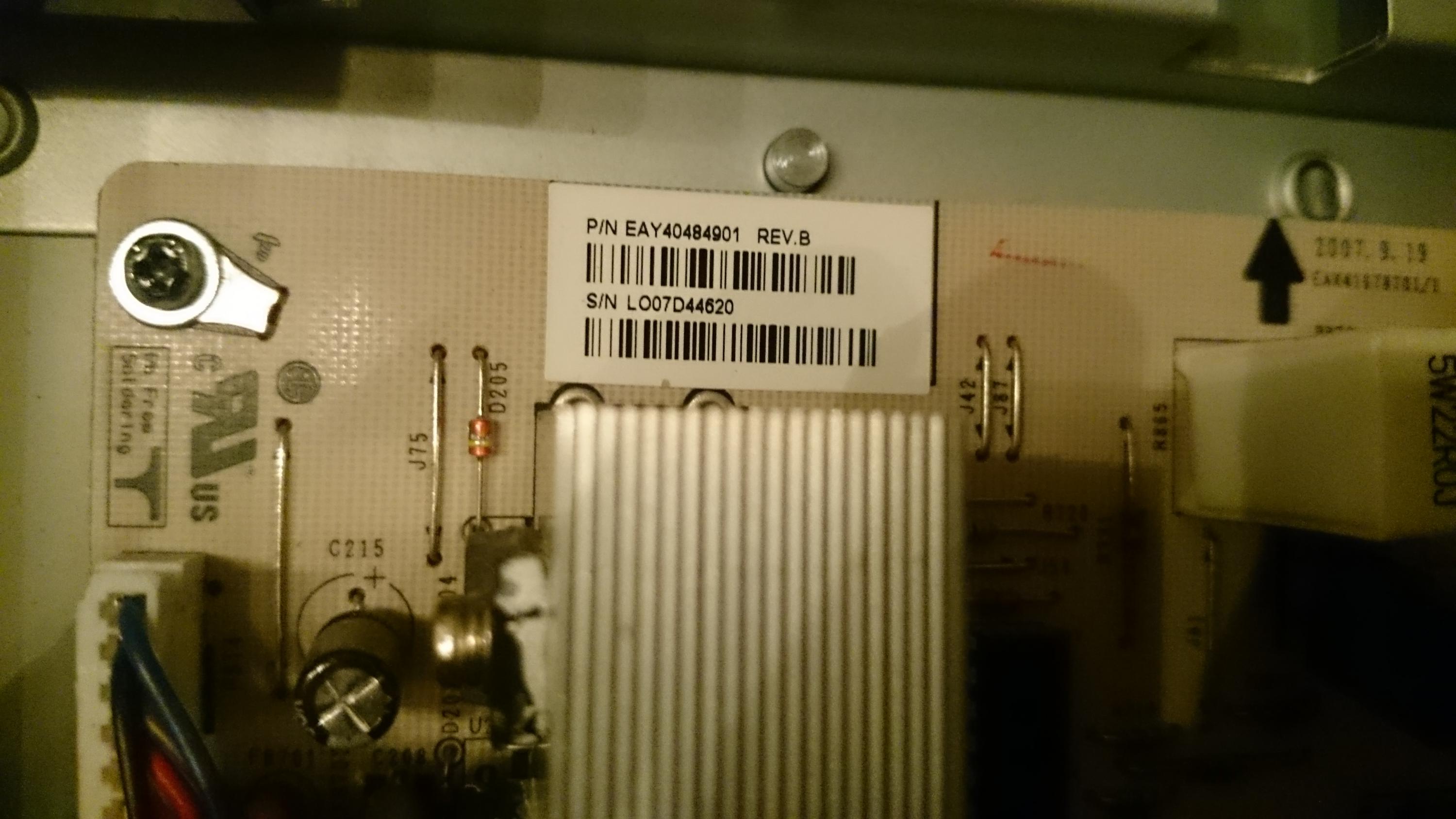

        Thx for the reply! Checked the voltages and they were 5v to low , replaced some suspicious caps on the ps and altered the voltages to 195v
        Sparkles are almost gone , some 5/6 random sparkles!
        Anyways just looking for 1 minute at the menu and i get this...
        Can i fix this by myself?
          Switching to "TV" with snow and its gone , notice the comedy central logo is gone?

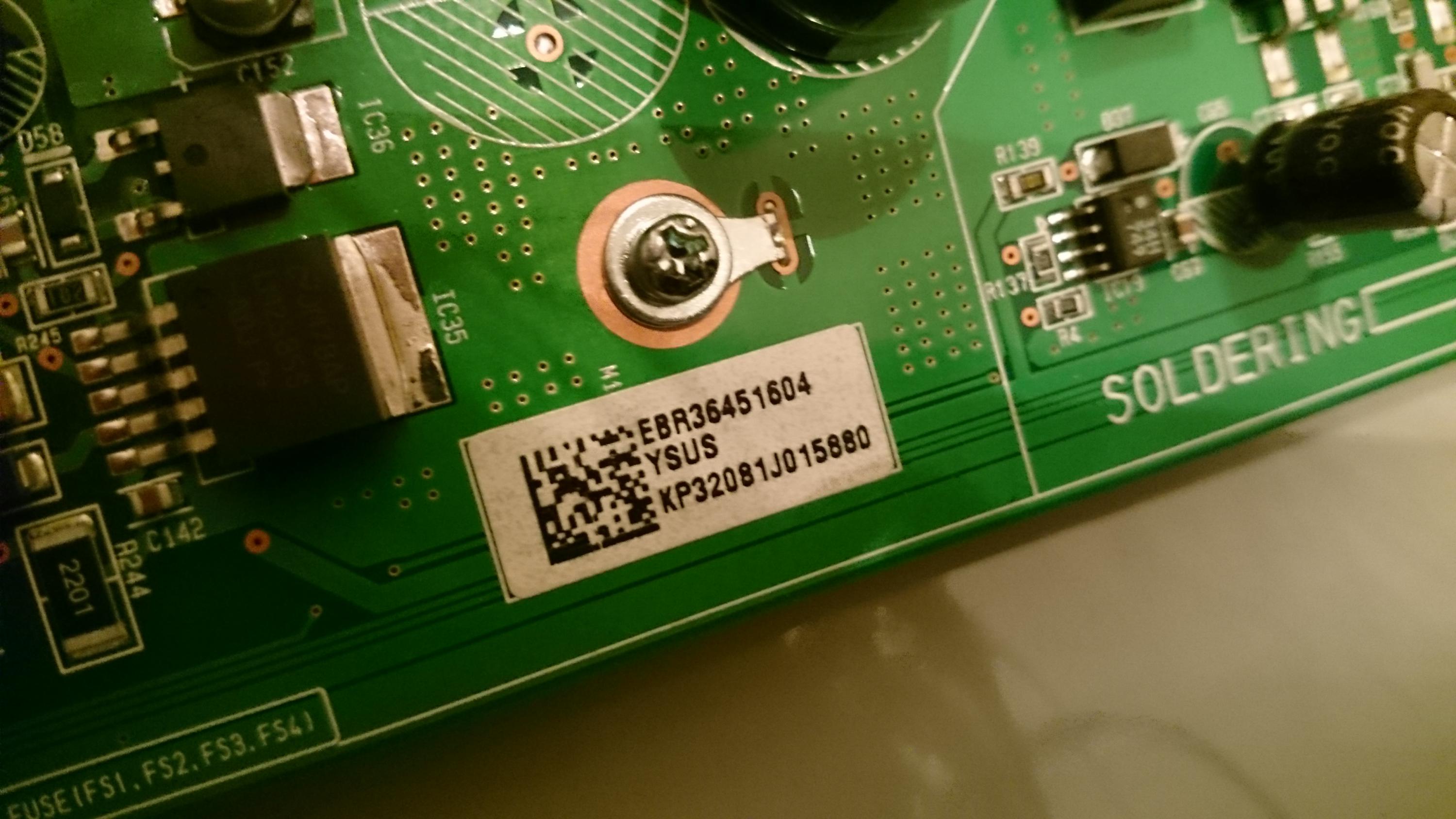

            Seems like part of your picture is missing too. These 32" plasmas are pretty unique as the X,Y and Ydrive buffer are all on one board.
              Nah picture is perfect , its on 4:3 mode so i could show you guys the picture.
