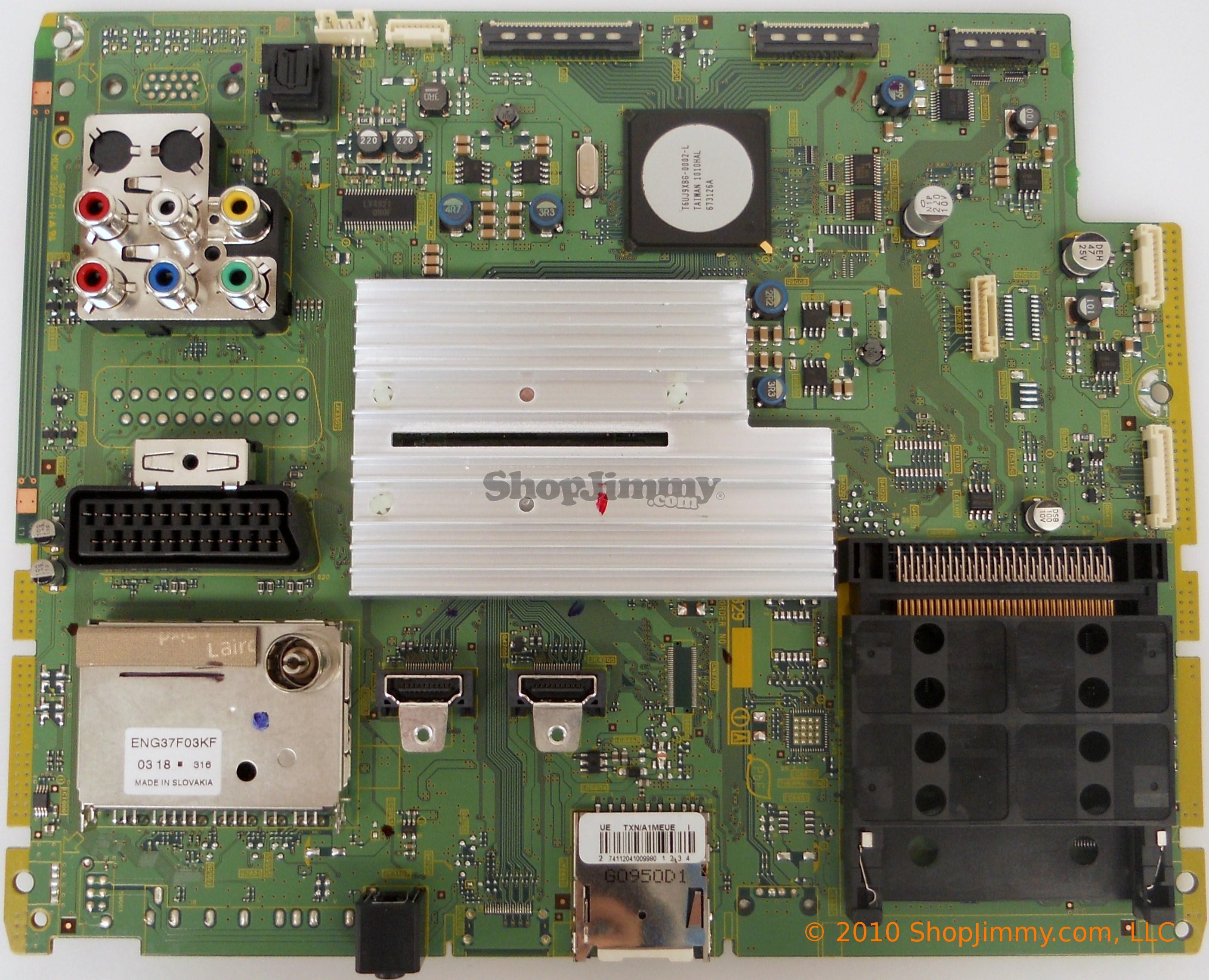

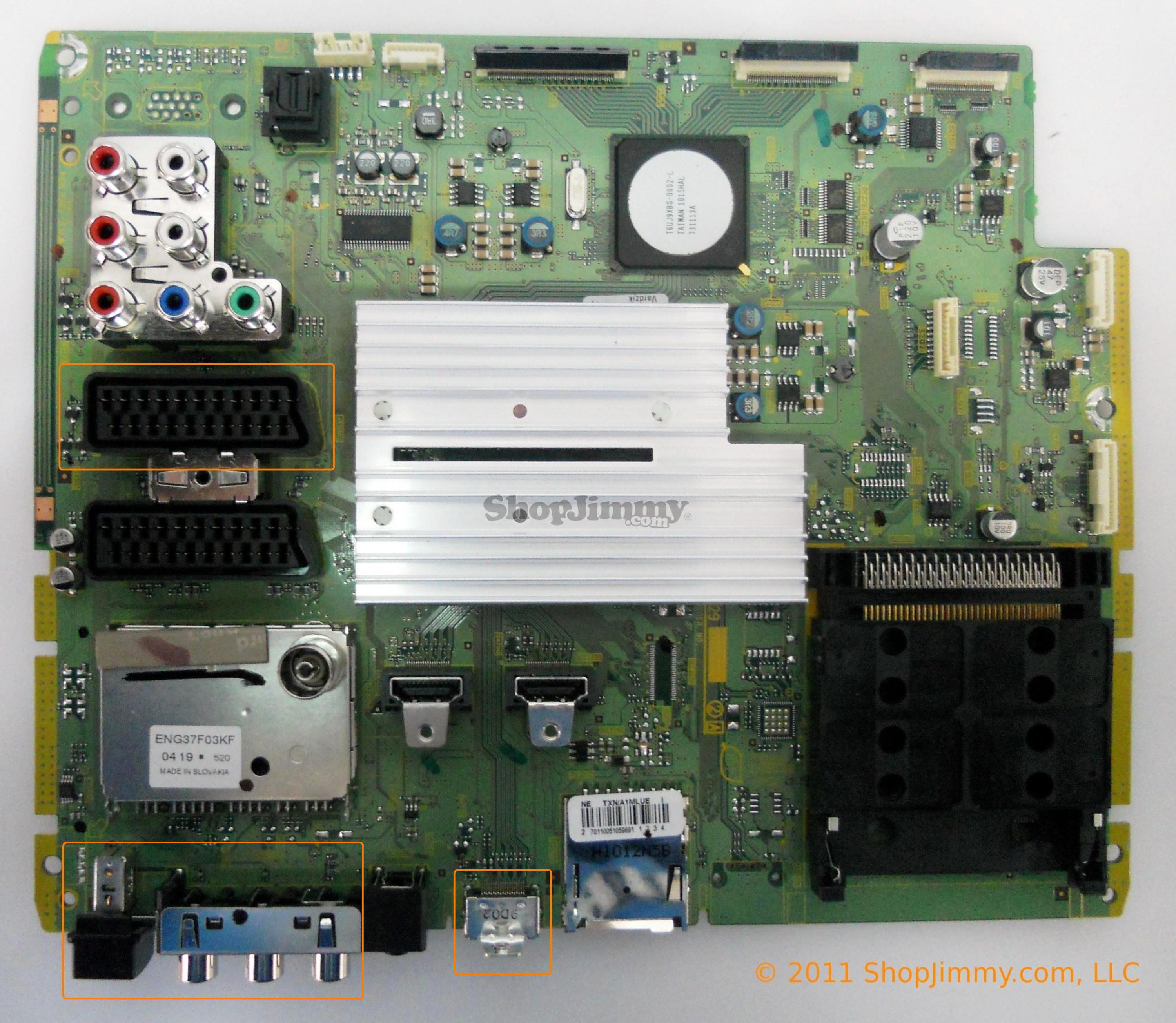

                        An x20 board would work but there's some notable features different like side Av , on/off switch, USB and additional SCART otherwise would bolt straight in. not sure if the PSU may need a link added or removed. Is the power switch on the front a soft start (momentary push)or is click on, click off

                            on the inside of the rear panel, is there a cutout for the additional SCART but covered by the sticker? If you can get the faceplate for the x20 board(maybe the seller on ebay has it) i reckon it will be fine because all other connectors are there and identical
                              Re: blinking red light panasonic 50" plasma tx-p50c2b
                              Is this what you mean if so whats the chances of it working http://www.ebay.co.uk/itm/PANASONIC-...item3f45d2ba00
                                  yep, if that board is good it will work, just an upgraded model, same panel

                                      yes there is a cut out for rear scart and also there is markings for the extra audio jacks ect on side
                                        so just replace with this and all should work i wont have to add any thing extra from power supply or disconnect anything
