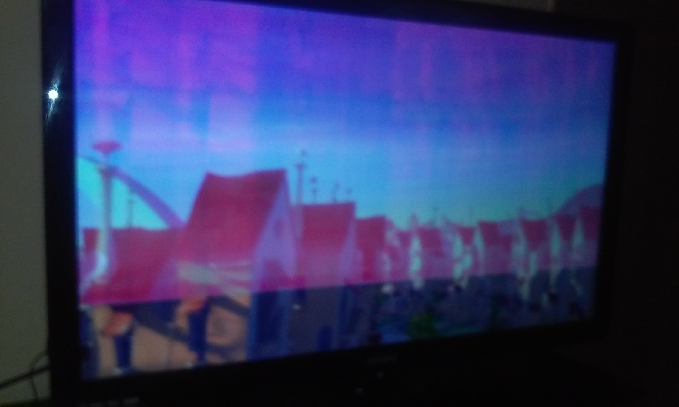

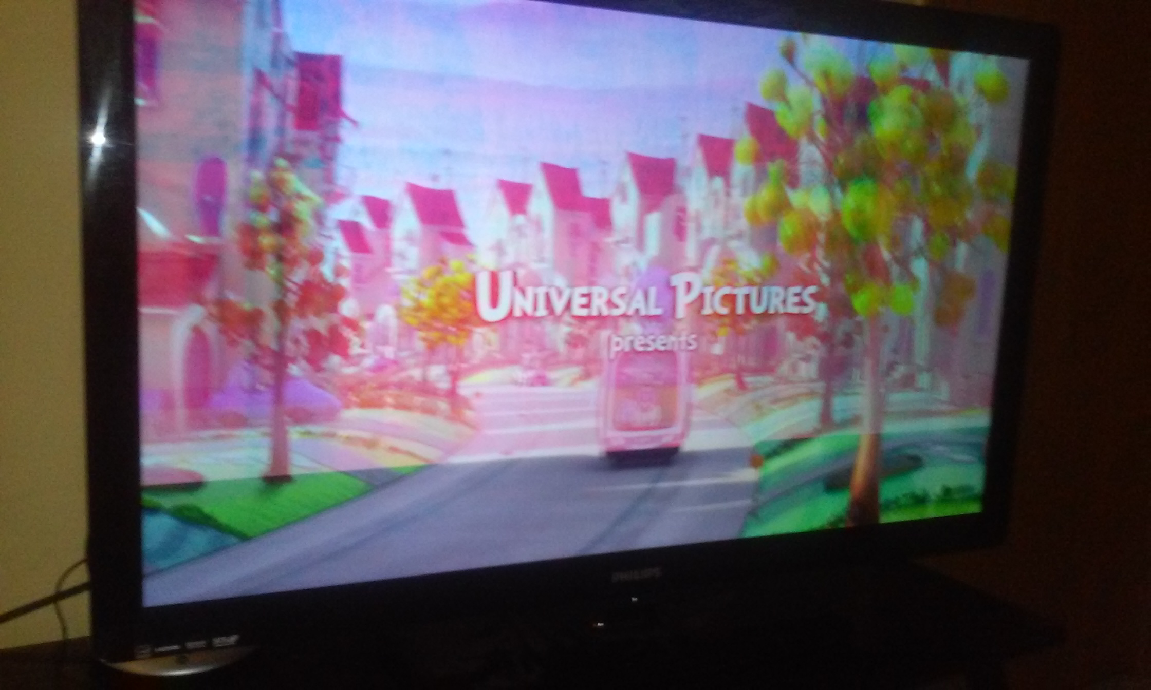

    The issue is almost like its double casting or shadowing from about 3 inches up to the top of the screen. But its also tinted slightly red on the top part of the screen double/ over casting shadows of the working 3" of the bottom of tg screen overtop of the picture on the rest of the screen and flickering.

    Do you have a picture of the fault?

      Re: Phillips 40PFL4908/F7 3/4 screen jumping fuzzy
      Yes here are some
        Hmm, not good, looks like a bad LCD panel to me :/...

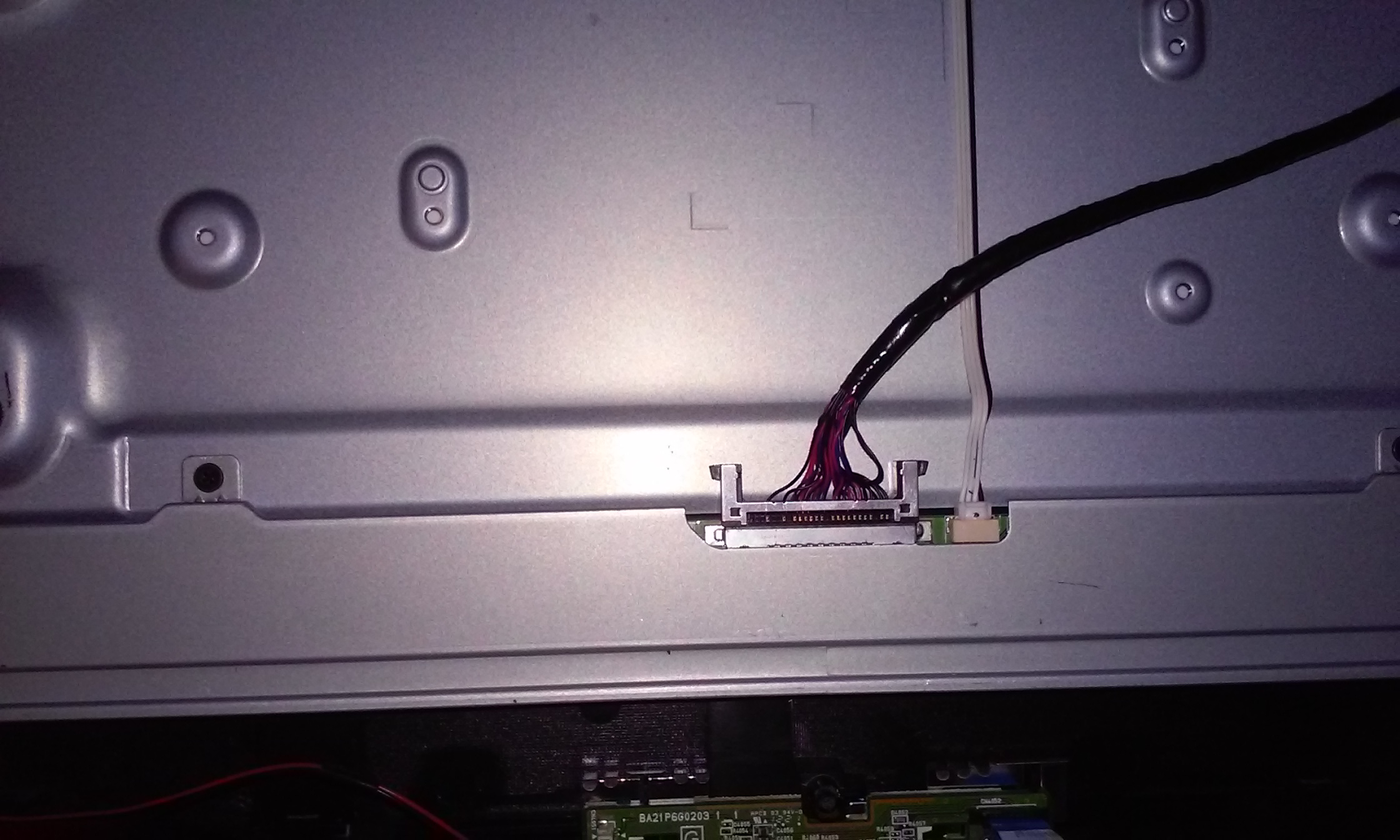

                I can't unplug the ribbons on the tcon its not that type of setup. The ribbons from the screen go to a small circuit board on the bottom lip of the screen, they cannot be unplugged. The the lvds cable goes from that small board to the main board idk if there is a tcon board
                  Post pictures of the boards in your set please. You probably can remove the ribbon cables, I have not yet seen ones that are soldered to the T-con.

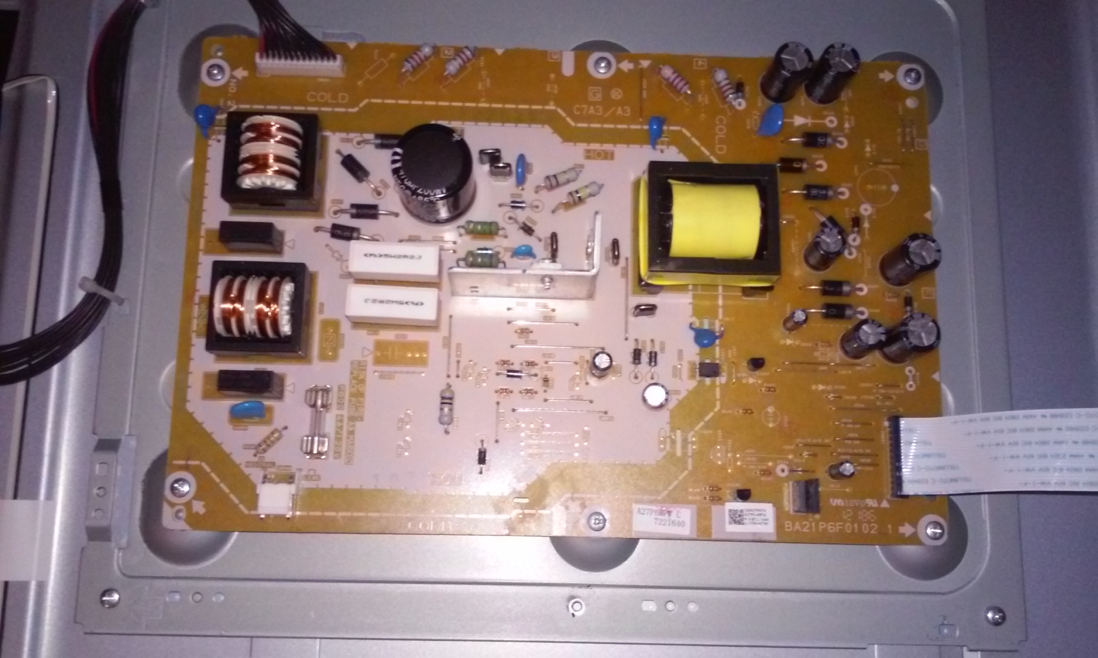

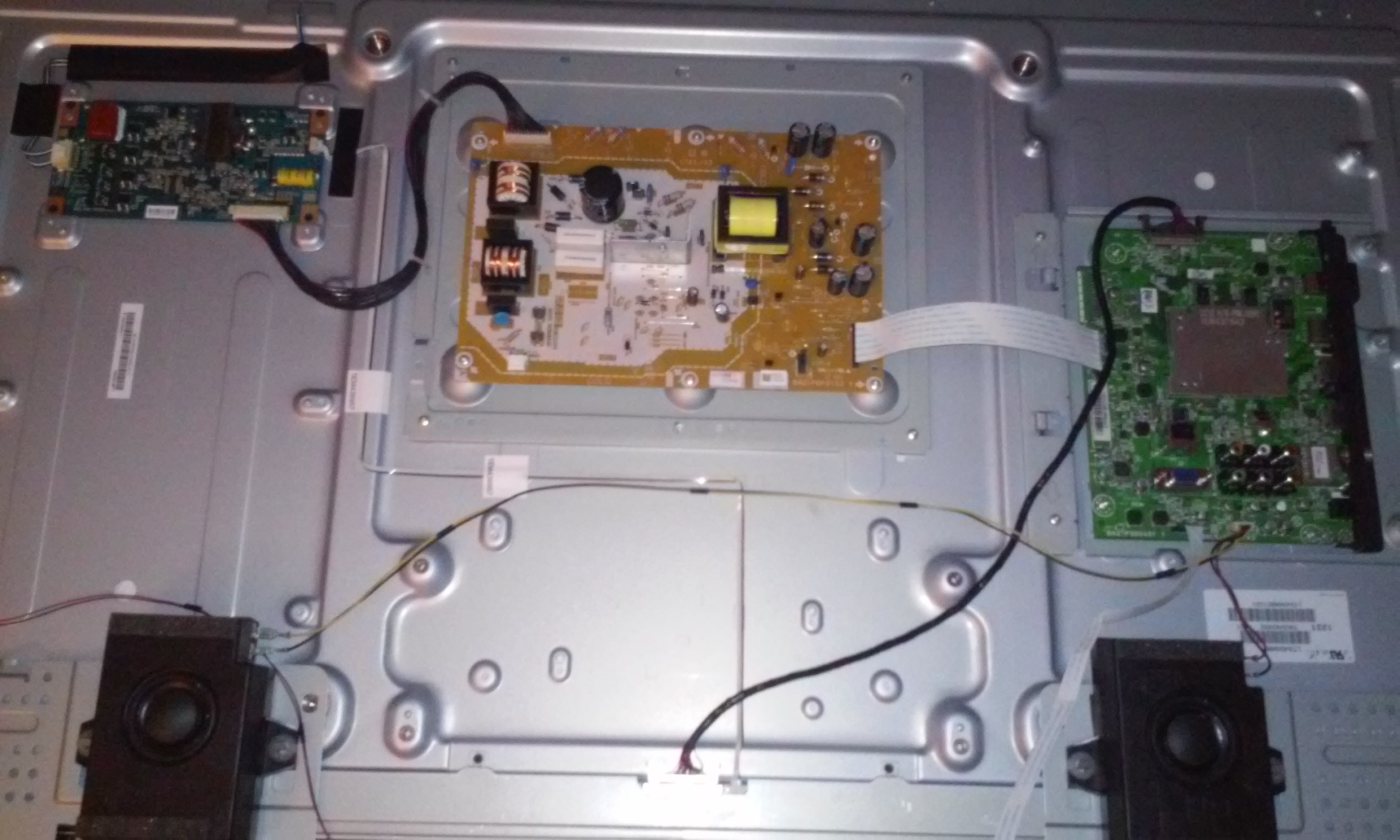

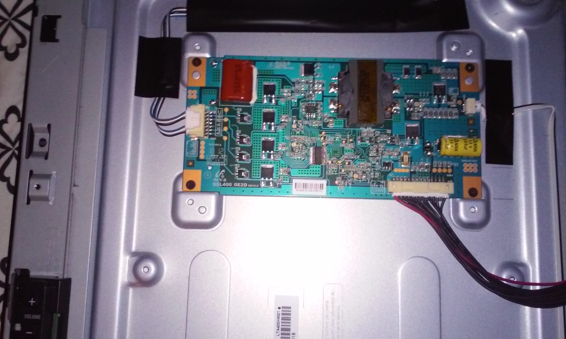

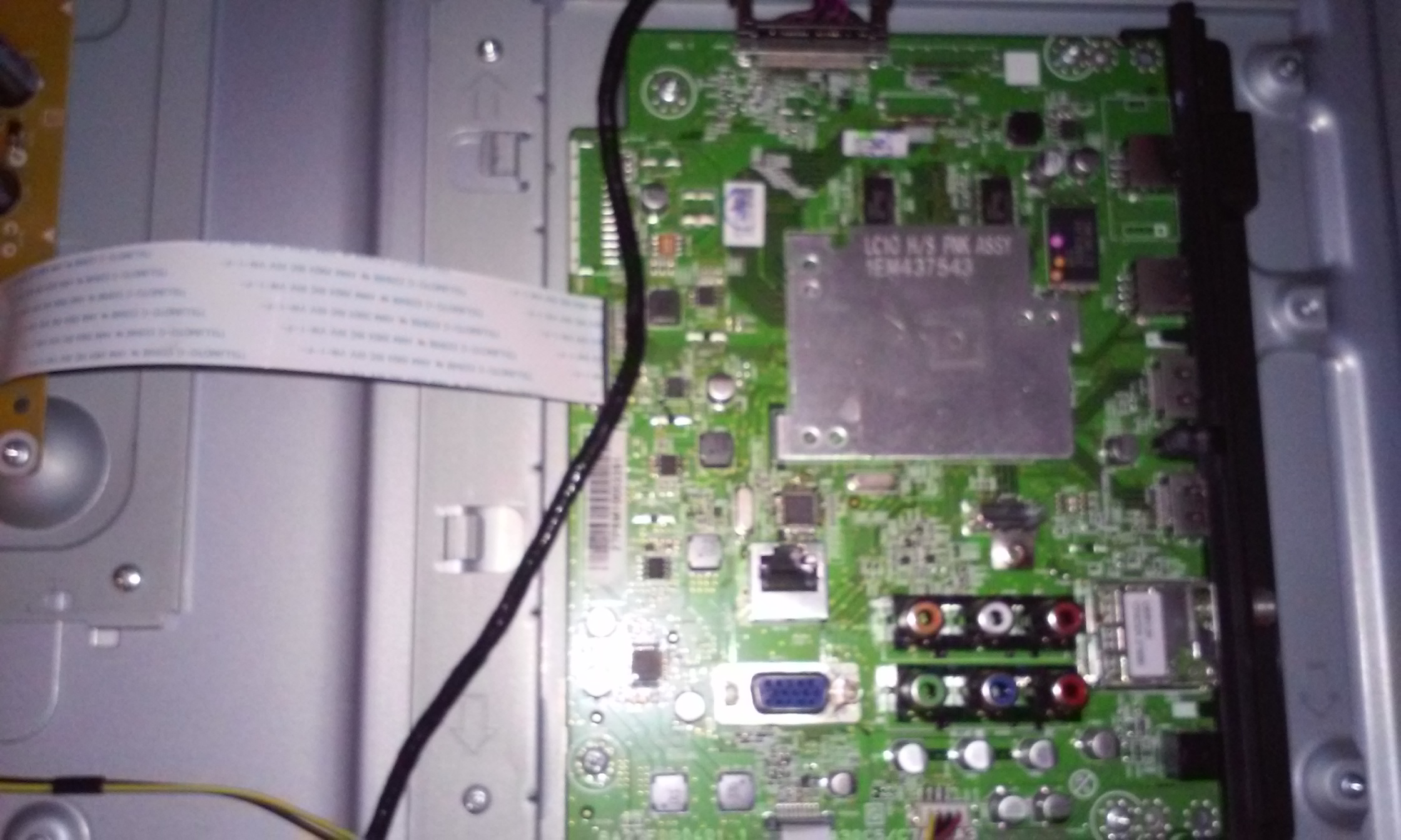

                      Here is everything inside it. The lvds cable runs from the green circuit board to a one inch wide 8 inch long board with two ribbons on the bottom legde of the screen
                        Oh, that is unfortunate. It looks like your TV bonds T-con to panel, and the panel or the T-con has failed. Unfortunately, I do not see this being economical to repair, due to it needing a new LCD panel.
