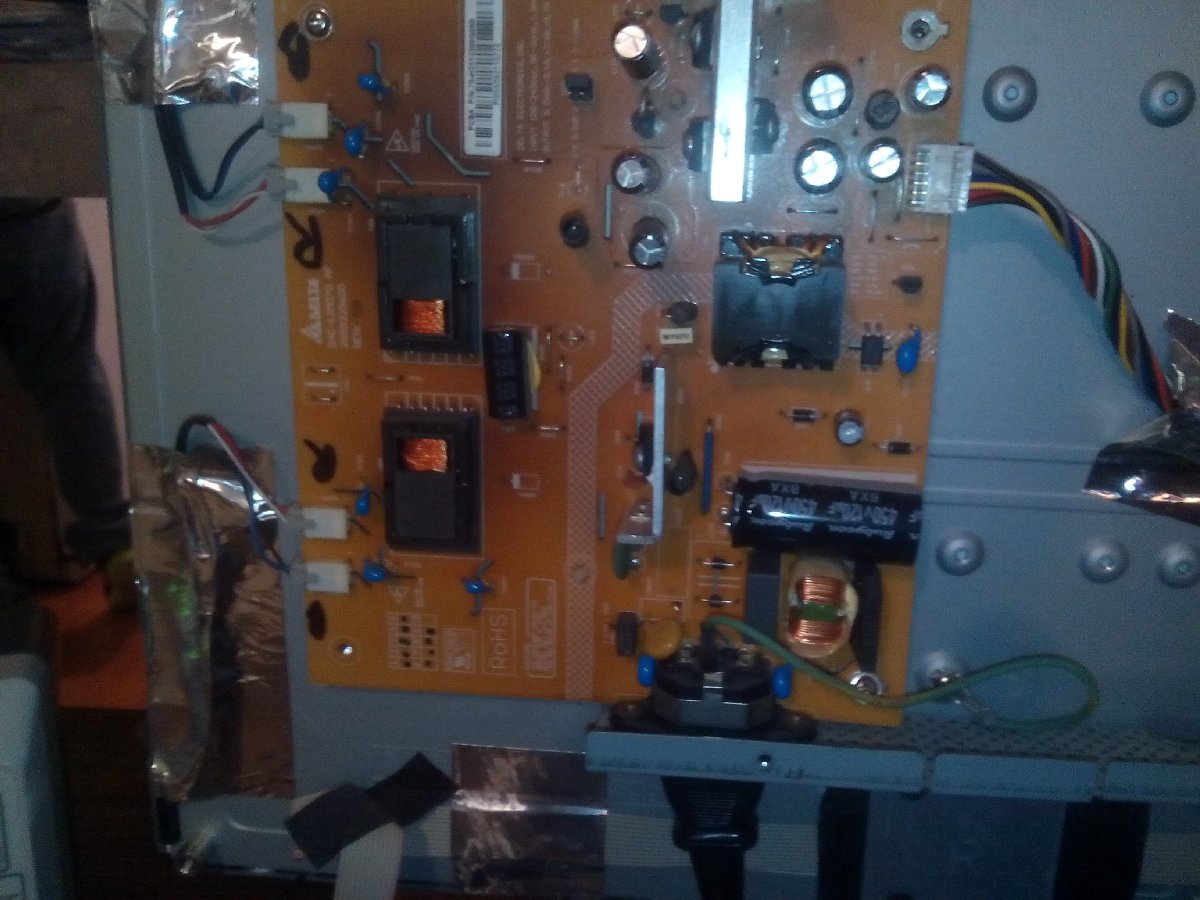

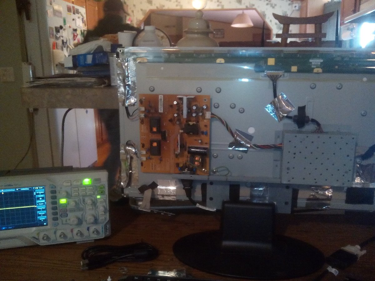

    I's a 25" LCD TV/Monitor.. Powers up, display looks great, but then it shuts off after a minute or so...
    No blown caps, no grossly burnt areas...
    I have the back off and the probes ready... Is this a candidate to check out the Rigol???

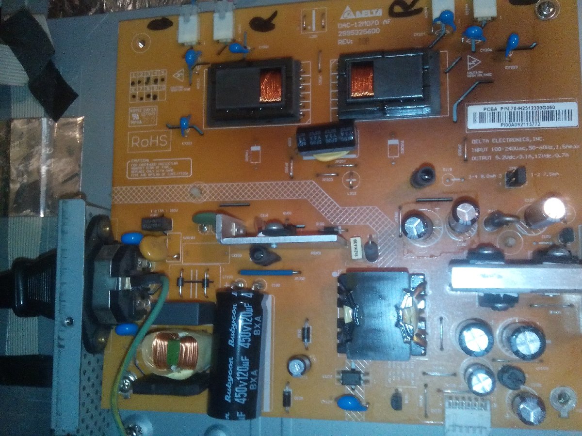

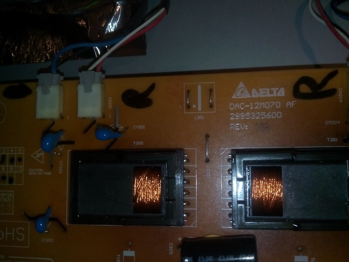

        Have another go then or at least tell us the board numbers
          Re: I-INC iH252 LCD Monitor. Powers Up, Display Good, Shuts Off After Minute
          Here ya go...
            When you say it shuts off after about a minute is that just the panel or the does the whole set go off? What does the power led do? Does it flicker then go off? Do the lights go off first
            then the power led?
              The display just shuts off. The LED remains green and steady.. If I turn it off, then turn it back on, it comes on but then the display blanks out again after a few seconds...

                          Remember I dont have one and others will be better informed to advise but just in case you are tempted, I think (and maybe wrong but )you cannot (should not )attempt to test anything connected directly to the mains this is covered very early on in the manual?.
                          You need to operate through an isolation transformer - I think either the item you are working on or the Rigol or both??
                            Yea, good advice.. LAST thing I wanna do is frak it up before I even get to use it.. I'll hang tight til someone who knows what they are doing chimes in

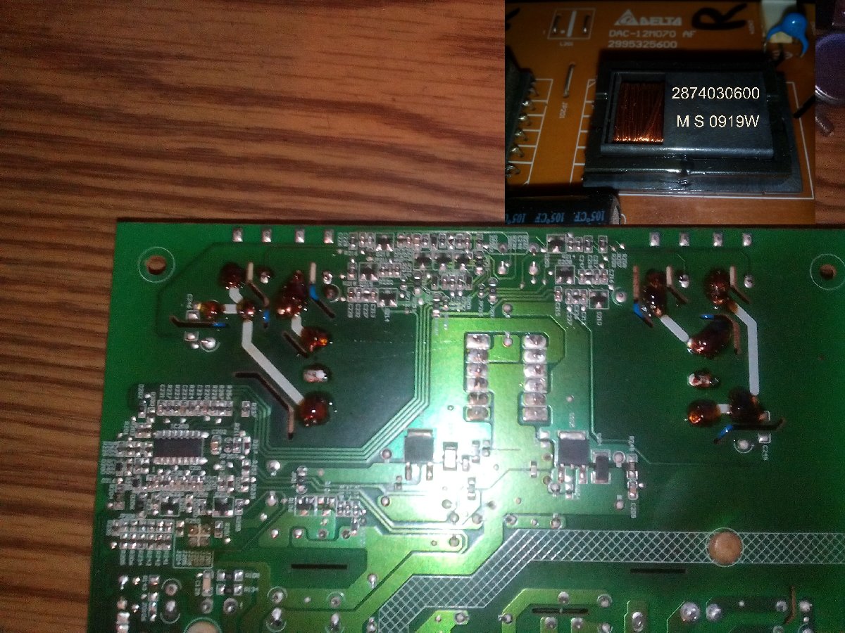

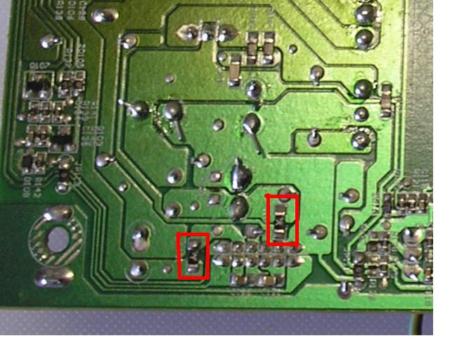

                                  What was the part number on the inverter transformers? and can you post a good well lit picture of the back of the board and a closer in one of the area at the back of the transformers.
                                    Here's a pic of both..

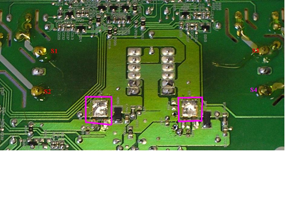

                                      Hmm - cant find much on the transformers (that may be good suggests they may not fail too often.
                                      On the attached I have marked what I think are the secondaries - if you have resoldered you may have burnt off the laquer if not you may need to scrape down to the joint. Meter on ohms test S1 to S2 and S3 to S4
                                      In the pink boxes are/were mosfets are yours part number AP9973GH if not can you read what they are?
                                      In the next photo marked in red are two fuses - can you test those.
                                      Meter on ohms should be same as holding probes together
