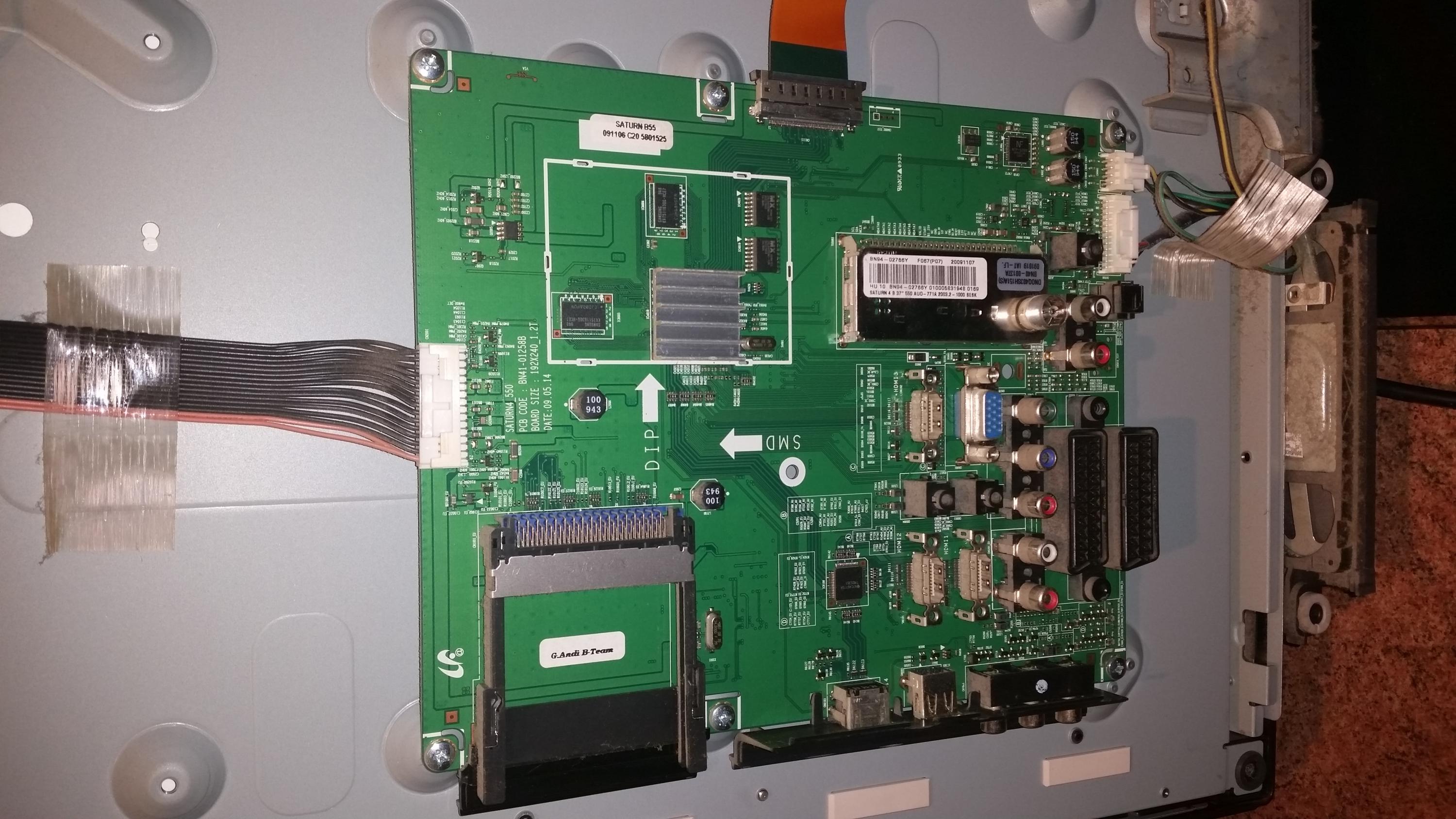

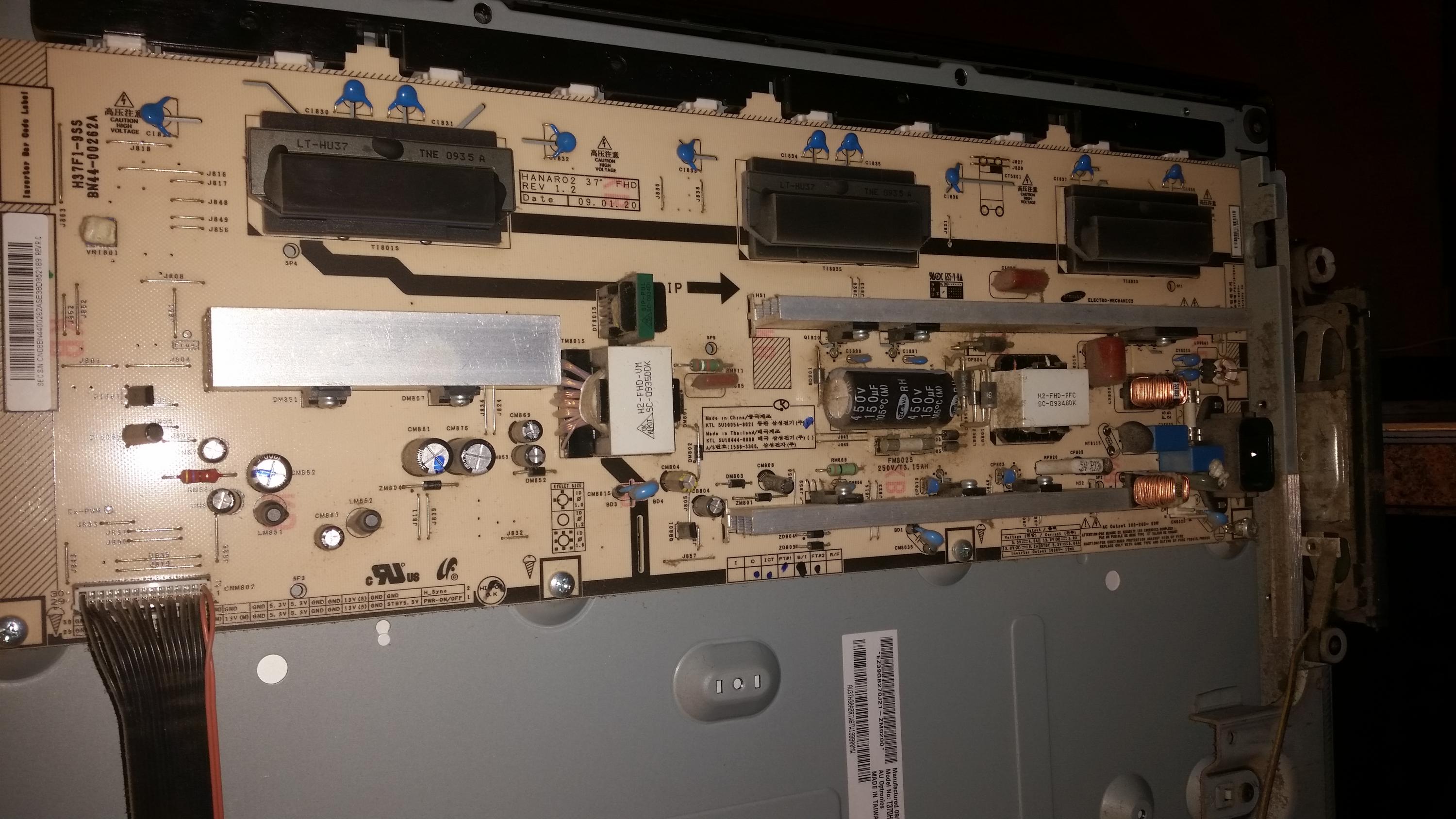

    hi guys
    got this set today was told it keeps restarting then standby light flashes
    13v are 12.9 volts
    5.3v are 5.0 volts
    main cap is 387 volts
    main board is BN41-01258B
    power supply is BN44-00262A
    i have tried heating up the main and power supply with a hair dryer but cant get it to cut out
    could it be the screen ?
    thanks

        There is an issue with some zener diodes on this set causing intermittent power off. Run it for a few hours I guess, then when (if?) it goes wrong, check the power supply voltages.

          One of the worst sorts of problem. Needs a good dust. I wouldnt have thought it was the screen or the inverter. If the power stays on when it goes into fail state what do the voltages do including the one on the big cap anything vary in time with the led flash and the restart?

            Ok strangely enough I just removed the board to inspect for any cold solder joints most of the screws where loose which holds the board on,but I leave it running until it cuts out

                Re: Samsung le37b553
                update:
                2 days now still working fine been running it flat out nothing
                with some of the power boards screws loose could it have been a earthing problem ?
                  Do you have a variac? I have had some TVs where low mains voltage (within tolerance, but slightly low, e.g. 220V) caused issues.
