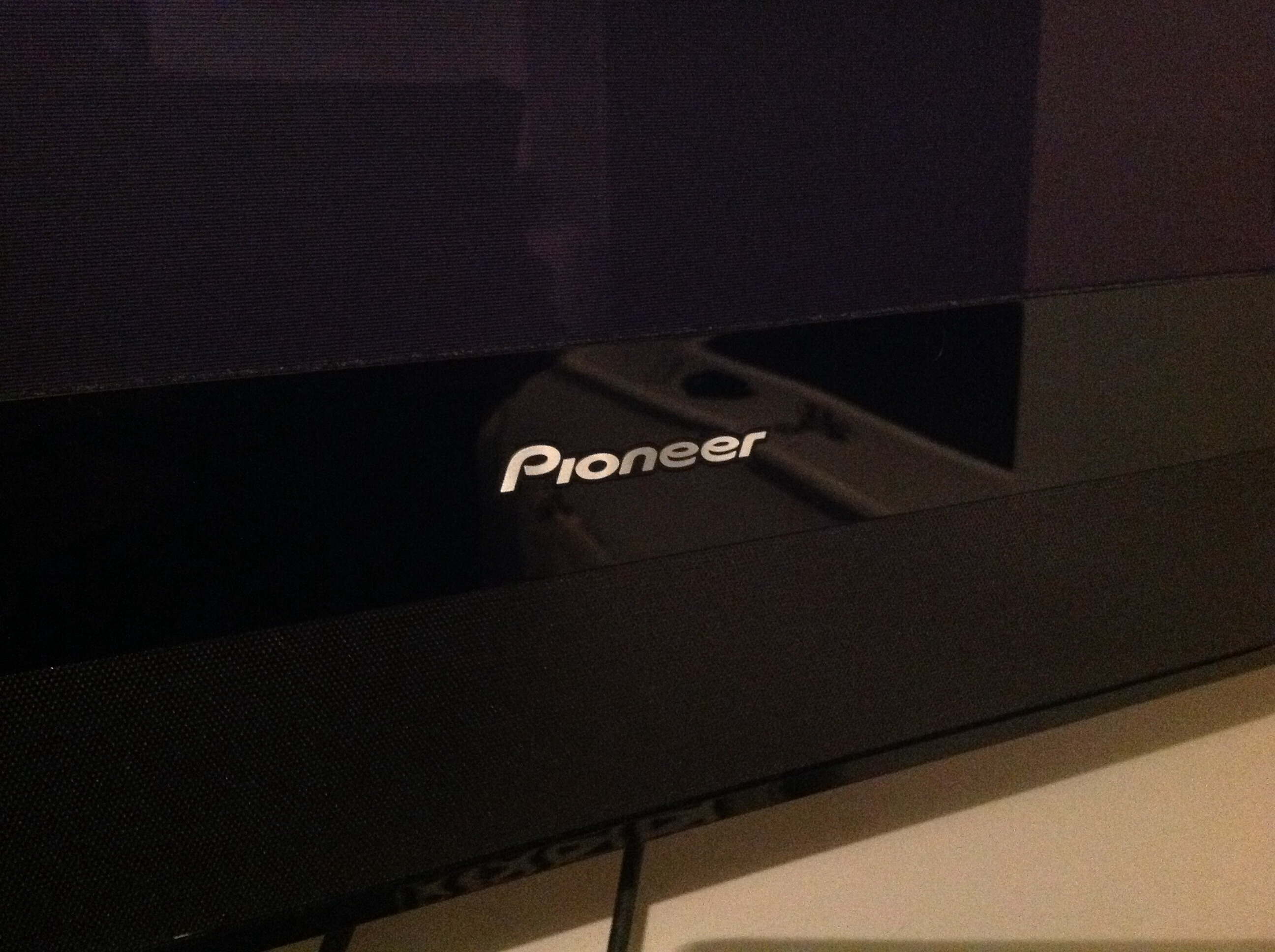

It depends on what you like for repairs. Plasma involves more troubleshooting but my success rate is much higher because LCD seems to have too many panel failures. I prefer plasmas for reliability, to fix and to watch - you can't beat a good 9G Kuro, or late model Panny/Sammy plasma for picture quality, absolutely outstanding.Please do not PM me with questions! Questions via PM will not be answered. Post on the forums instead!
For service manual, schematic, boardview (board view), datasheet, cad - use our search.Comment
https://www.facebook.com/Telford-Tel...7894576335359/Comment
Re: What tv brand do you most common repair ?
Plasma, sub 1% for Panasonic & LG, a few percent for Samsung.
LCD, easily into the 5% range for Samsung, a few percent for the other brands (LG and Sharp.)
Have you tweaked your set yet for deep blacks & red tint issues?Please do not PM me with questions! Questions via PM will not be answered. Post on the forums instead!
