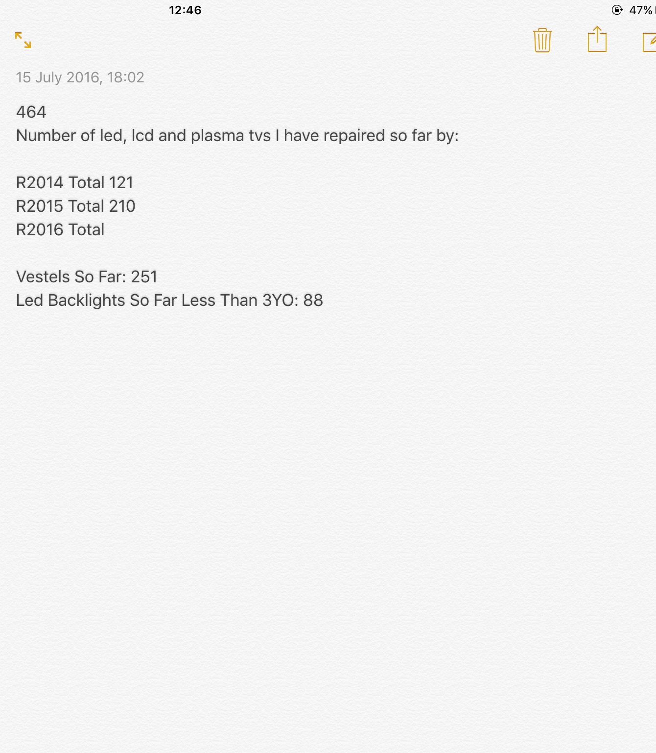

                  #68
                  Re: What tv brand do you most common repair ?
                  Update its now Vestel by a long shot been repairing a tonne of them lately.
                  • ReeceyBurger123
                    Never Give Up !
                    • May 2014
                    • 7325
                    • Britain
                    #69
                    Vestel have taken the lead due to their crappy Led Tv's failing almost half of what I have done is them. After Ves Id say Lg then Samsung tbh.

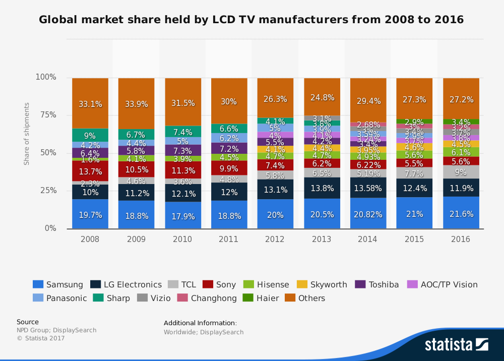

                        Not to open up an old thread but I'm curious, what makes some brands worst than others exactly?
                        If is the over all circuit board design or the individual components? I feel the components aren't as crucial as say the circuit design ie better filtering, smoother output voltages, less stress on transistors etc?
                        • saddle_au
                          Waste Warrior
                          • Jan 2013
                          • 121
                          #72
                          My experience is the brand reliability is defined by how many fail. New TVs are failing more around here more due to broken screens that failed electronics. Small bumps are breaking 50 inch and above screens really easily.
                          If you look inside the latest models, they have all gone for minimal structural support of the screens (weight) and more complex single chip boards. I have two LG 32 inch 720p LCD screens that weigh over 25kg each (cannot give them away, don't want to chuck them, nothing wrong), compare that to the current 32 inch LCDs under 3kg. The metal supports in there are numerous and thick. Complexity of the circuits seems to be decreasing, but this is due to both complexity of individual parts going up and the load requirements of power supplies becoming less.
                          More and more BGA parts, integrated TCONs on panels and boards that don't run for any obvious reason (bad eeprom settings, bad flash or micro code) are on the increase and these are proving difficult to cure.
                          Looking around my workshop, I see many boards that have soldering hassles under hot BGA chips causing a lot of LG problems. Fixing these is dubious because just reheating them does not permanently cure the original fault which is thermal expansion and contraction problems between the PCB and the chip. You need to remove it, clean the solder and use new solder balls - not a job for a hobbyist or small repair shop because each chip has different layouts, you need masks for each and BGA heating tables to do it right. Many boards have parts on the other side of the PCB under the BGA, making that fix difficult even with the right equipment.

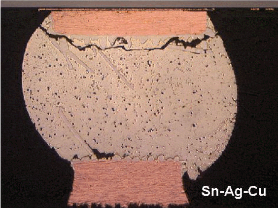

                            #73
                            Vestel chassis make up a larger proportion of the television part of repair work that comes through my workshop, that said televisions make up around a third of the repair services that I offer.
                            Rework of BGA / FBGA via re-flow and or re-balling tends not to offer a long term repair as the failure mode is often the eutectic bumps within the packages themselves where cracks initiate and propagate through the intermetallics and at the intermetallics/solder interface rather than the solder-balls. The only 'reliable' repair option for these failures being device replacement assuming the components themselves can be sourced.

                              #74
                              Learnt something new today. The inter-layer connections in the BGA chips themselves can be faulty. Heating the package only temporarily cures them as well (maybe). Eutectic tin/lead solder bumps.
                              We've had good results with the BGA problems by not allowing the chips to get that hot again, putting in active cooling. Usually PC video card heatsinks and fans thermally bonded to the processors, especially since the LG 560 and 650 series Tvs.
