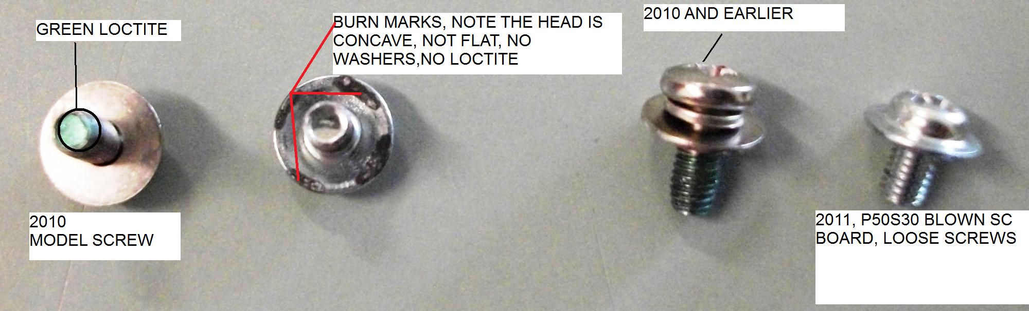

                      Re: Looking at fixing my T.V. - Panasonic TX-P42G30B
                      I'd shut it down and check the SN board mounting screws. they could be loose and poor earthing. If loose, may be a good idea to look on the back of the board and chassis for arcing / burn marks.
                      • tw2005
                        • Oct 2011
                        • 6458
                        The screws

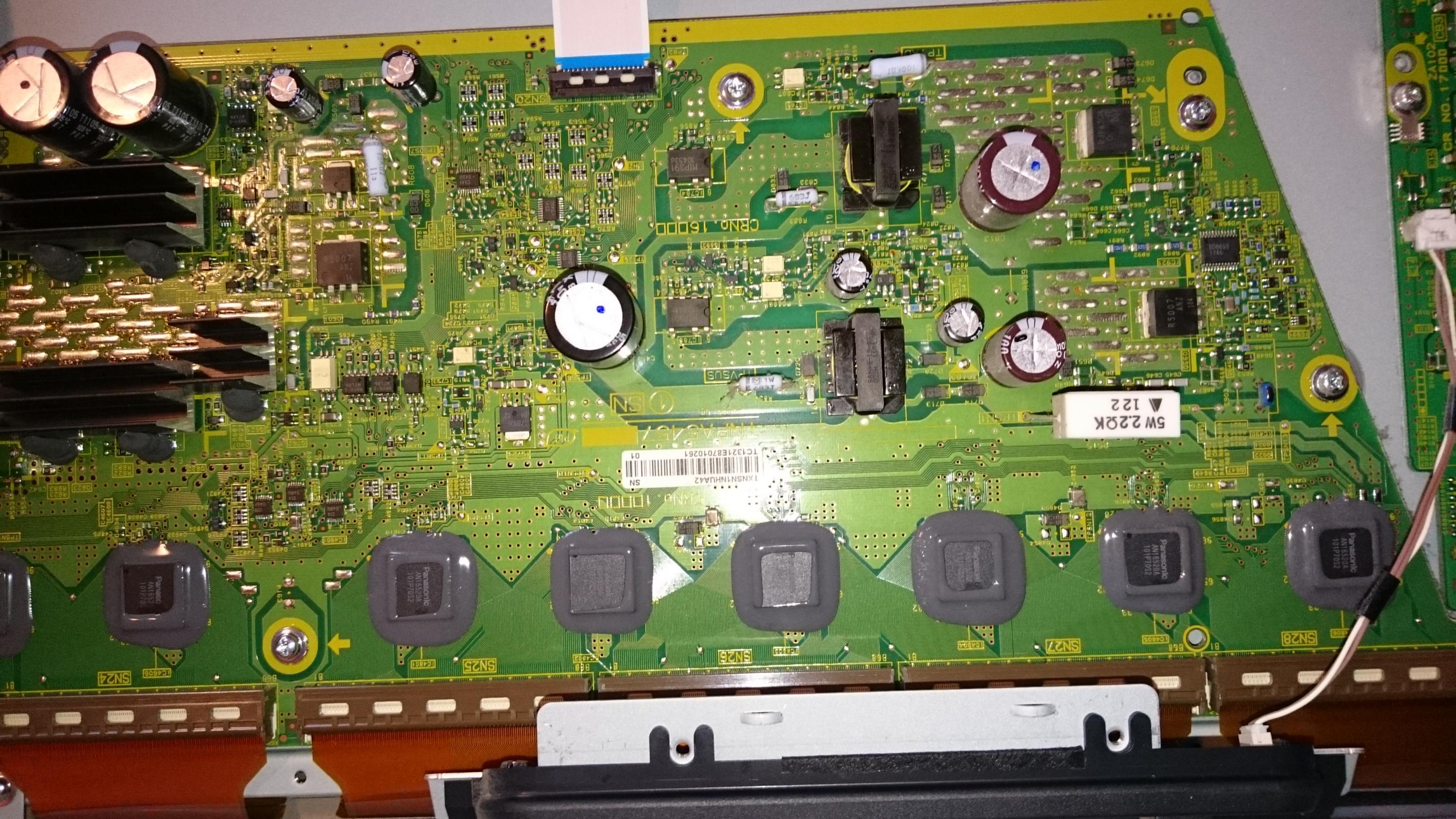

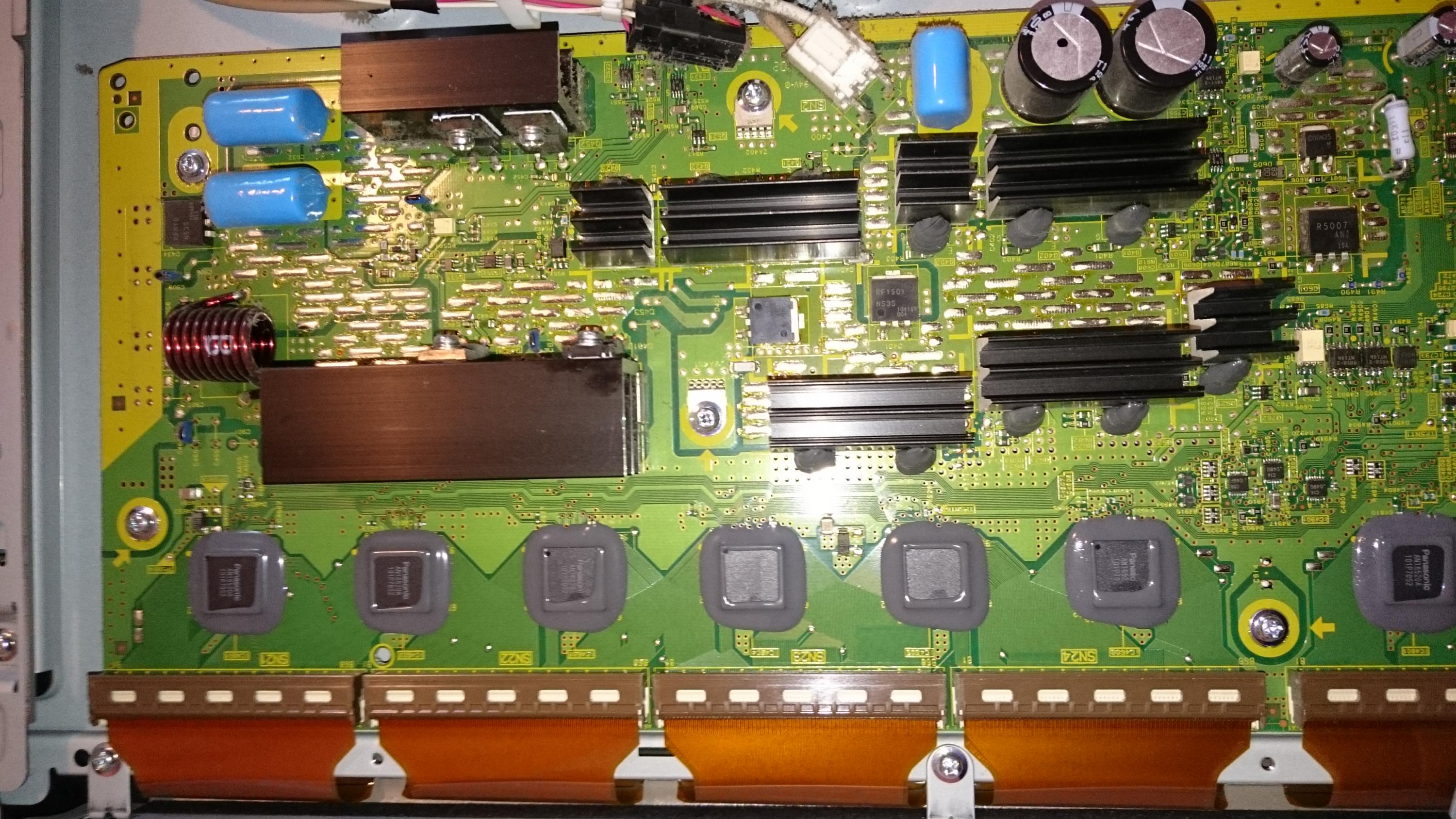

                            Well I finally got time to take the T.V. apart - didn't feel any loose screws on the boards, and didn't notice any scorch marks anywhere.
                            I took pictures of the boards in the back - doubt anyone will be able to see anything from them, but if you do that'd be awesome.
                            I'd really like to keep this damn T.V., and am not looking forward to having to buy a new one.
