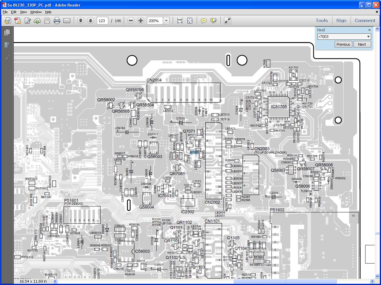

                I just repaird one of these, Its fault was when the power button was pushed, only the relay clicked on then off. no power led or display, This fault was intermitint also. All voltages from the power supply where there for a second when the relay closed.
                The fault I found was R7003 (3.3 ohm) was basically open (75 ohms), 12 volts is fed through it to the front panel where display voltages are produced but -9 volts is also produced and sent back to the main board.

                  At the moment, I'm not having that issue though perhaps I should check it out.
                  I have just changed the two caps mentioned previously and the problem still exists.
