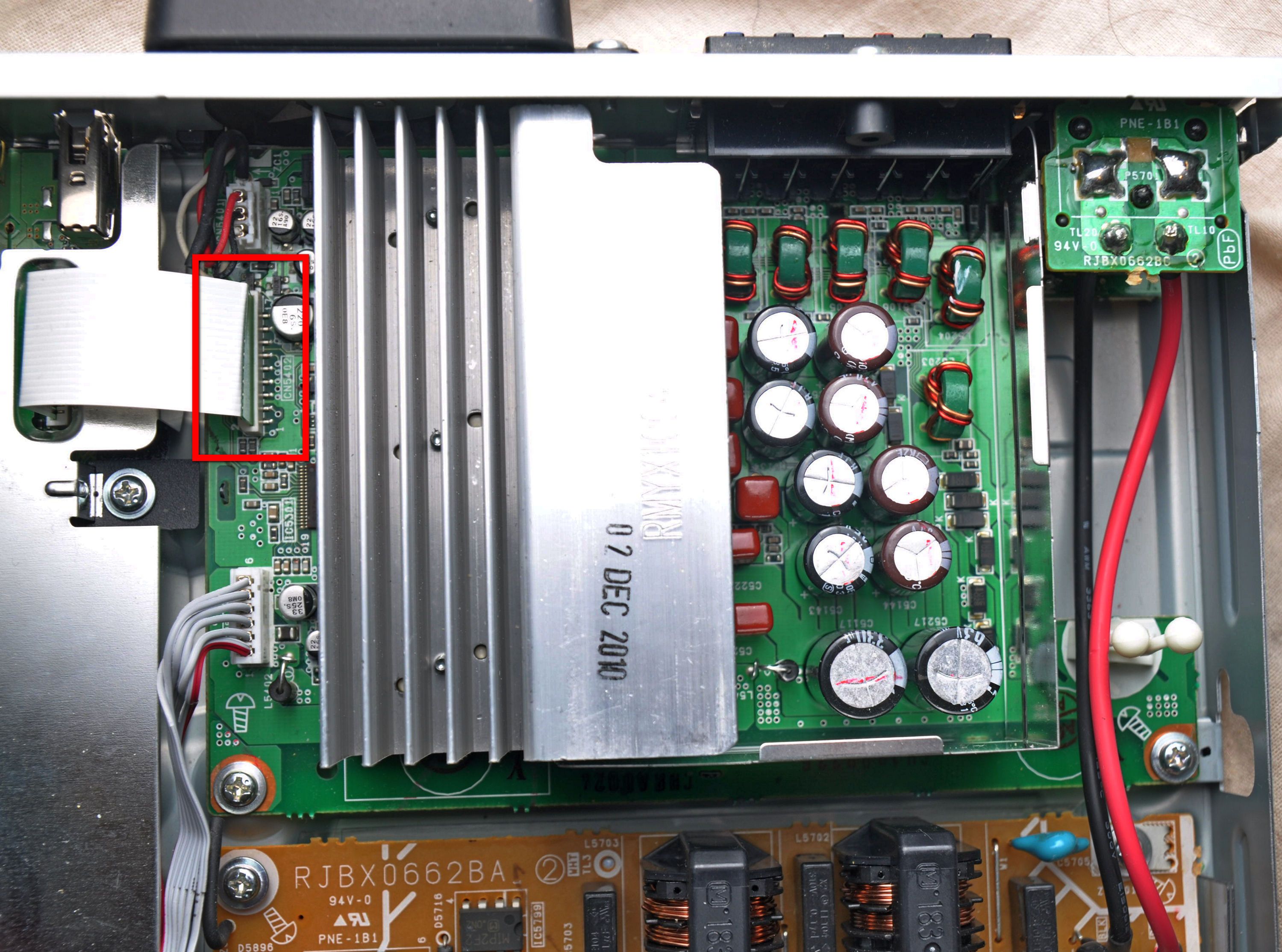

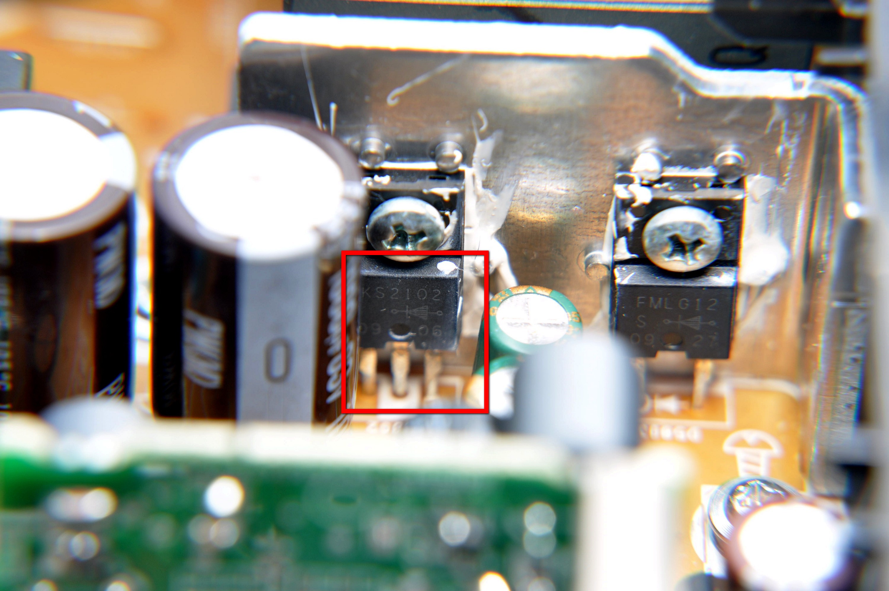

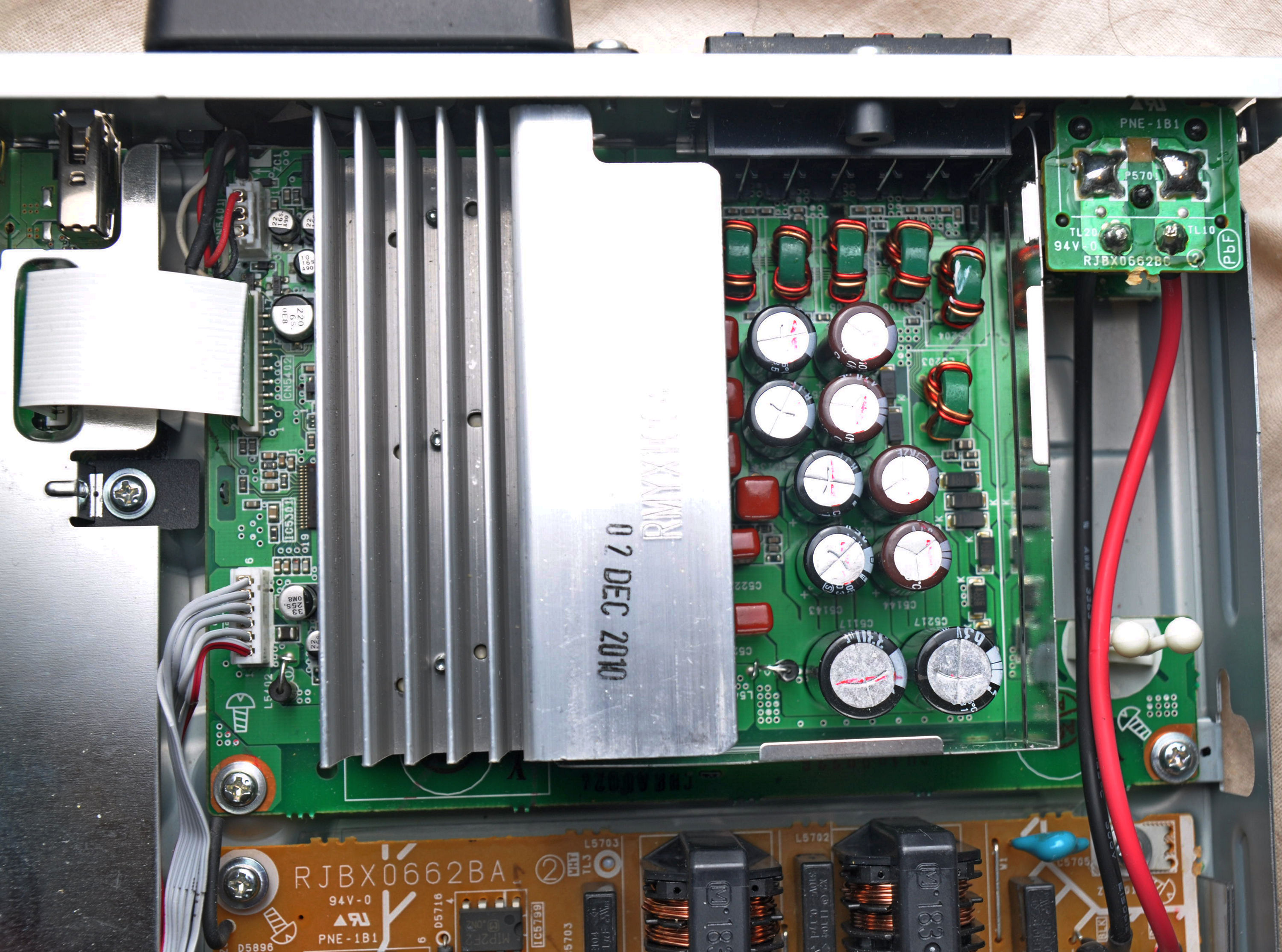

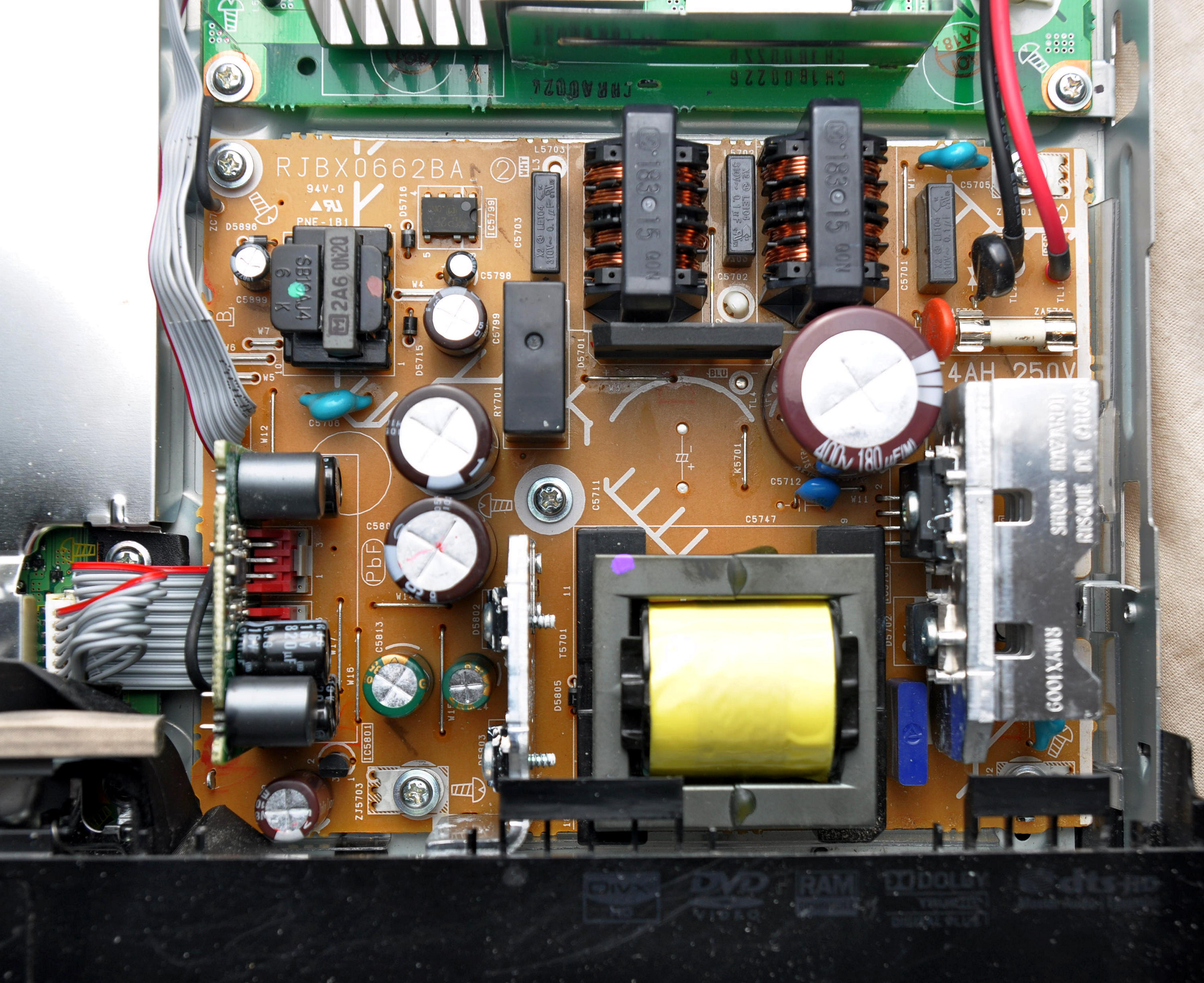

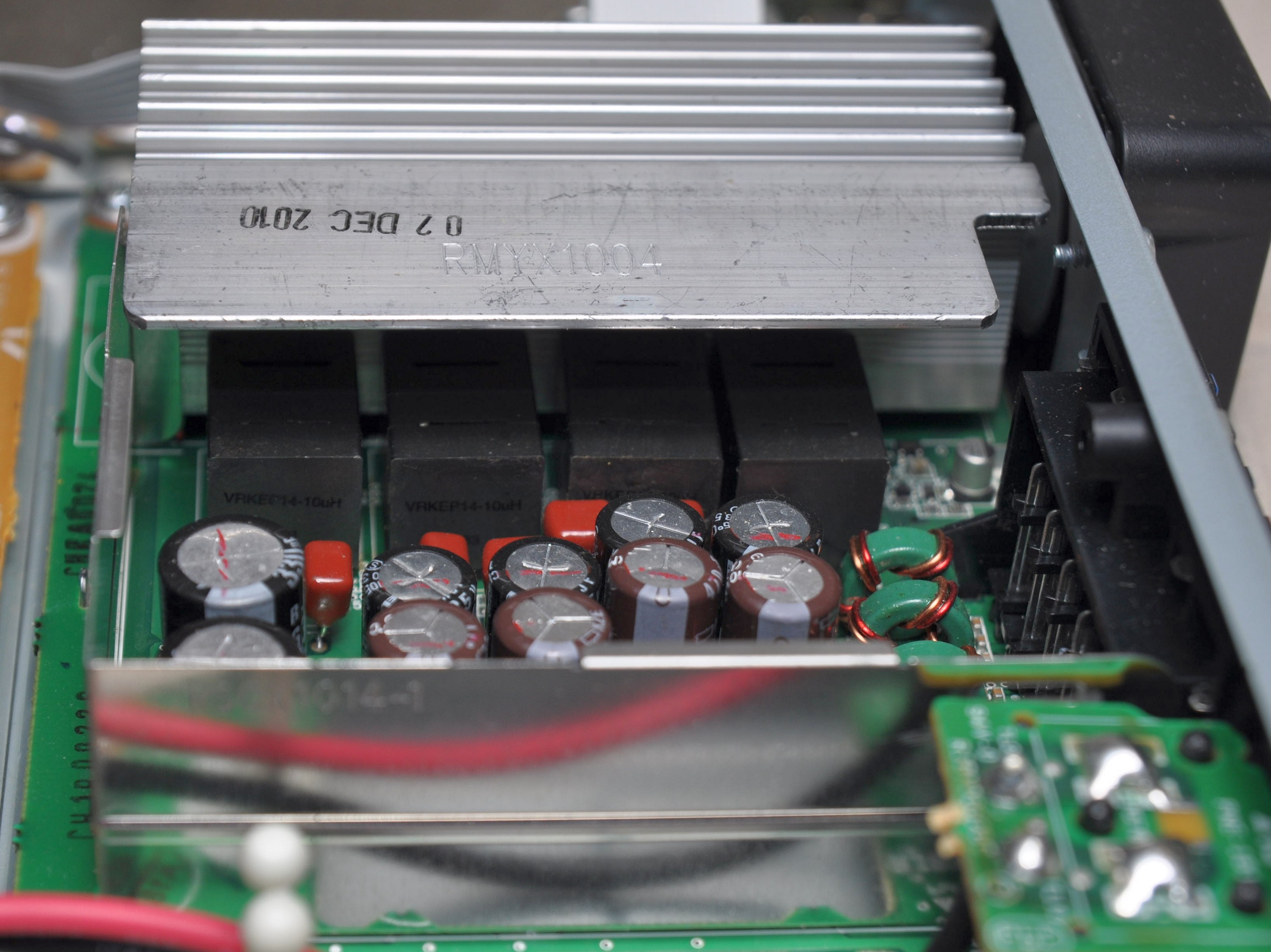

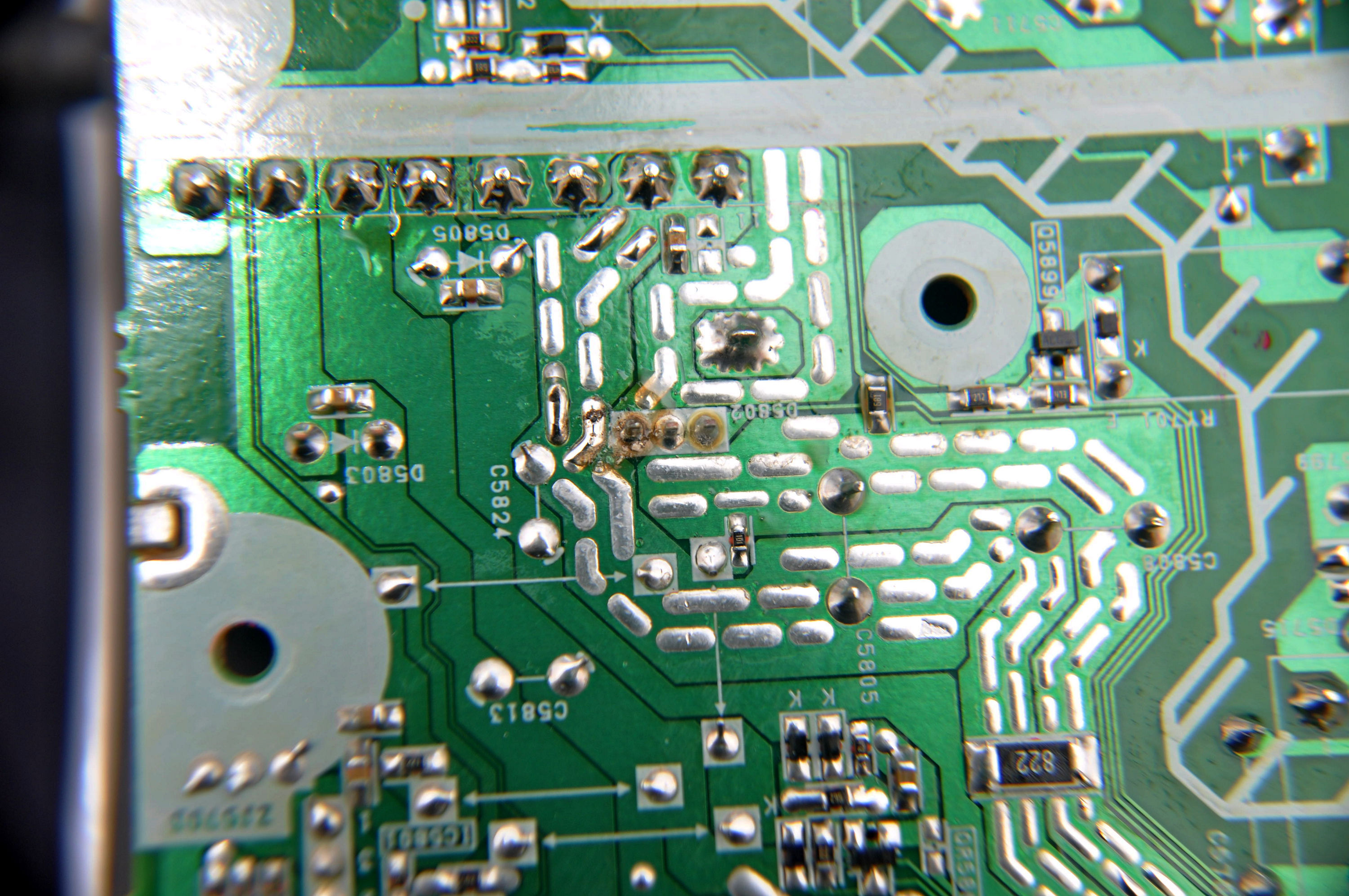

            Hi, I really appreciate you looking at my problem. I've taken some photos to give you an idea of what I'm looking at. Let me know any particular section you want me to concentrate on.
            What I did notice of the underneath of the power supply board, what looked like a fried/damaged solder section. I've taken a Pic of that, plus the component highlighted.
            Could that mean, that component is causing the issue?

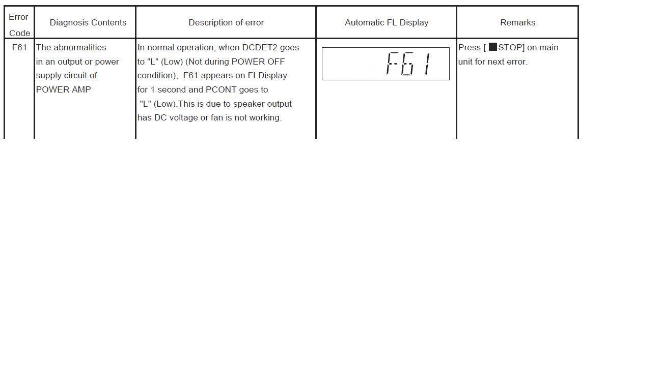

            tw2005, thanks for the service manual

              ...This is due to speaker output has DC voltage or fan is not working.
              You mentioned that the fan does turn. Measure DC voltage at every speaker output connector. You should measure 0V. If you measure more than 0V, then there is a fault

                  As I had the board out anyway, I removed that regulator diode and seems to be working ok. So I applied new paste to heatsink and soldered back in.

                  Out of curiosity I disconnected the flat cable from the AMP board to main PCB as highlighted in photo. And when I turned on the unit, there was no error and it stayed on. The fan was not working either now. I assume the main PCB reads/and controls the amp via this cable.
                  My assumption now is that the power supply unit is OK and something is wrong with the amp (I hope i don't sound stupid, with my maybe obvious conclusion).
                  This territory is beyond me I think, unless there are some basic tests I could do? I have taken out the amp module and cannot find no obvious visible signs of bad solder/fried components.

                            I had to borrow a meter, as mine was playing up. I had to test that regulator diode again (also referred to as rectifier in the same manual) or dual diode as mentioned here. On one side of the reading I get around .453 and the other side I get .200.
                            Do I assume that this component is fried?
                            This is the datasheet I found for it, though I'm not 100% sure if its correct, because the symbol on the component itself shows only a single diode, where as the datasheet shows two. Unless that's how they can be? :
                            https://cdn.badcaps-static.com/pdfs/...d3a767a955.pdf

                              Rather desolder the diode from the board and then measure it again. When checking for DC voltage at the speaker outputs, chassis GND should not be used. Start with the output on the left. Connect the red probe of your meter to the top terminal, black probe to the bottom terminal, switch the home theatre on and see if your meter measures any DC voltage. Then move on to the next output and do the same. What CapLeaker was referring to, are the supply voltages for the amplifiers IC5100 and IC5200. When measuring those voltages you must chassis GND

                                In regards to the diode, those readings I got was when the diode was out of the board. A dud?

                                  measure again, diode out of circuit, middle pin black lead, then measure positive lead to the left pin, then to the right pin. Note the values. Then put the positive lead to the middle pin and probe the other 2 pins with the negative lead and post the results.
                                        Middle pin negative
                                        left = 204
                                        right = 419
                                        Middle pin positive
                                        left/right = no value
