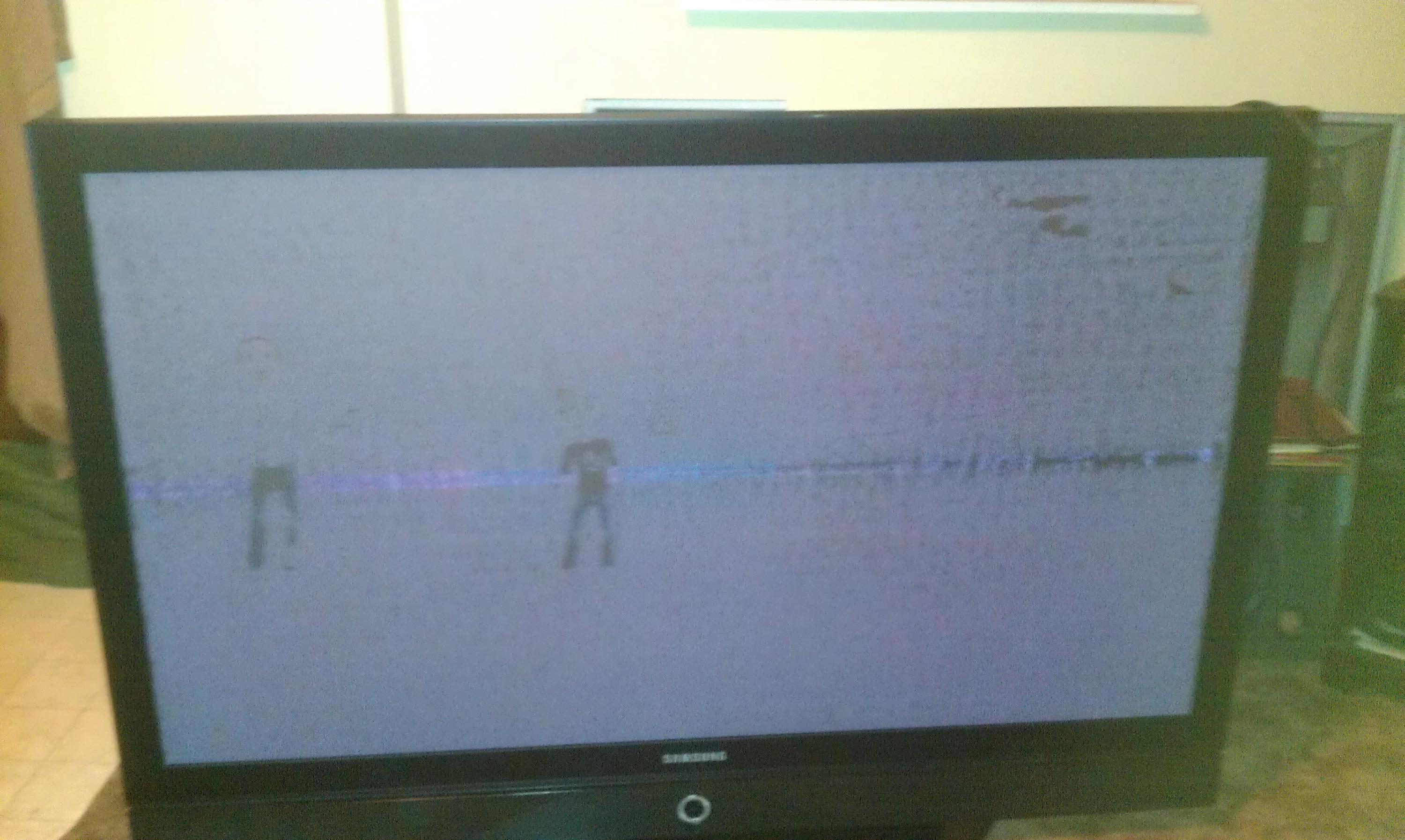

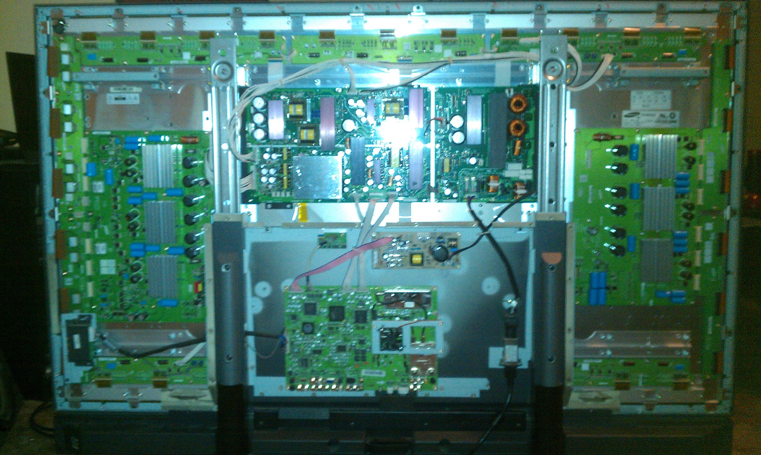

    Hi all! I recently came upon a nice 63" plasma that I thought couldn't be too hard to fix. After a lot of reading, I figured out that the x sustain is bad, after learning to unplug my sustains to test them. When I turn it on, I see a 1" thick discolored horizontal line bissecting the screen. I assume this problem is caused by one of the buffers, but have no idea where to go from here. Any tips on figuring this out? I'll try to get pics uploaded in just a moment.

    Bump. I'm asking this because I'm worried that what's causing this line is what caused the sustain to fail. I'd be pretty aggravated to replace the sustain and have it blow right away because I didn't fix the real problem.

      https://www.youtube.com/watch?v=CpWZTnAXbLg might be this, if you try it, like he says be very careful, the ribbons are delicate and non-replaceable, as far as I know, as always be careful of HIGH VOLTAGE in certain sections of tv, can be deadly.

        This is discoloration, not white or black due to no signal to the pdp. I had actually already watched that video hoping that was the solution. All of my connections appear to be solid.
