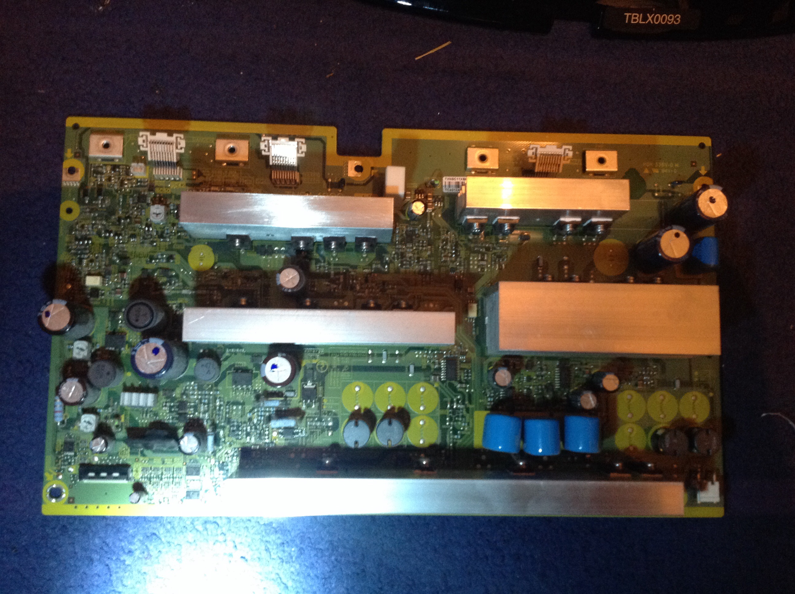

    Hello all I am currently working on this 42" plasma that has 14 blink error code, unfortunately I cant find a lead on anything obviously faulty on any of the boards and theres not much online to show me where to test either, just wandering what could cause this error I am thinking the sc becase when I remove it the error chages to 6 blinks but I could do with some help thanks in advance.

    Re: Panasonic TX-P42S10B 14 blink error ?
    Picture of sc.

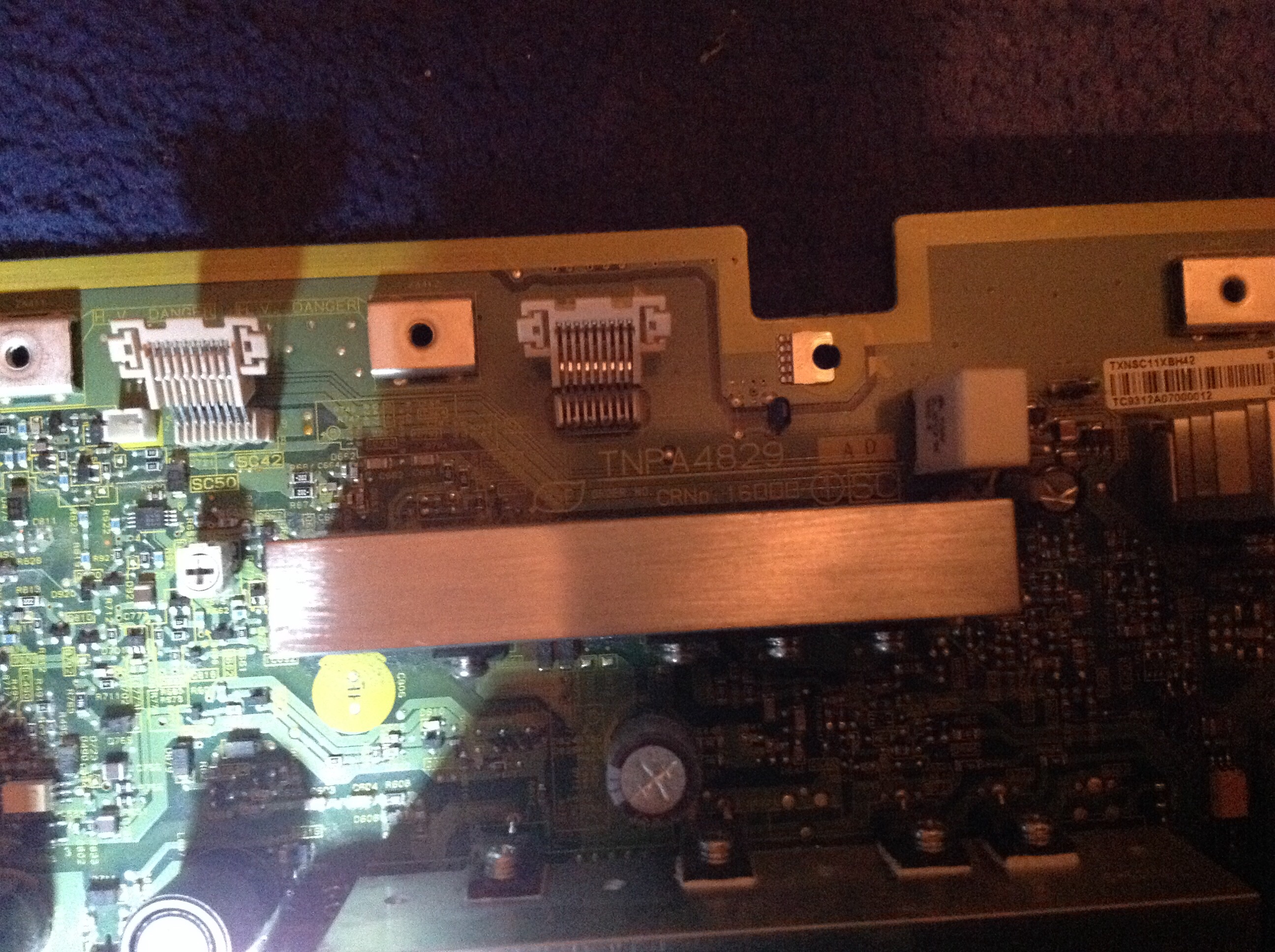

      Model number of sc.
        From the service manual, 14 blinks means Audio PWM SOS. So you possibly have a fault on the A board. Check the voltages at the outputs of all the regulators on the A board
          Thank you buddy will get on to that now
