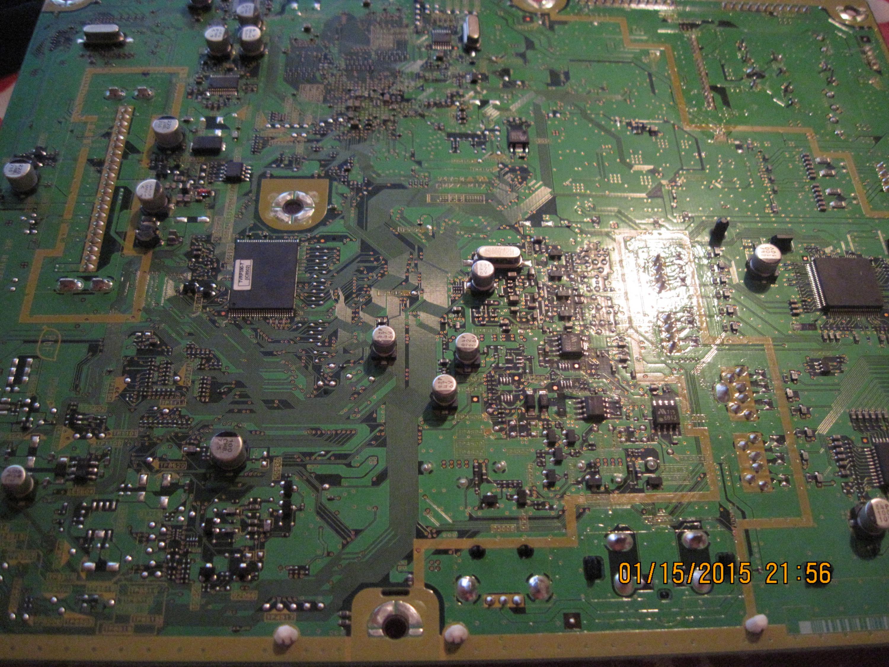

    Would like to know if anyone has did any component troubleshooting on the main board for this model. I get the menu but no video nor sound.

    Check for a short across caps C4599 and C4601. They might be on the back of the board opposite the HDMI chip, which is on the front, IC4510 I think.
      Could not find c4599 and c4601 caps.

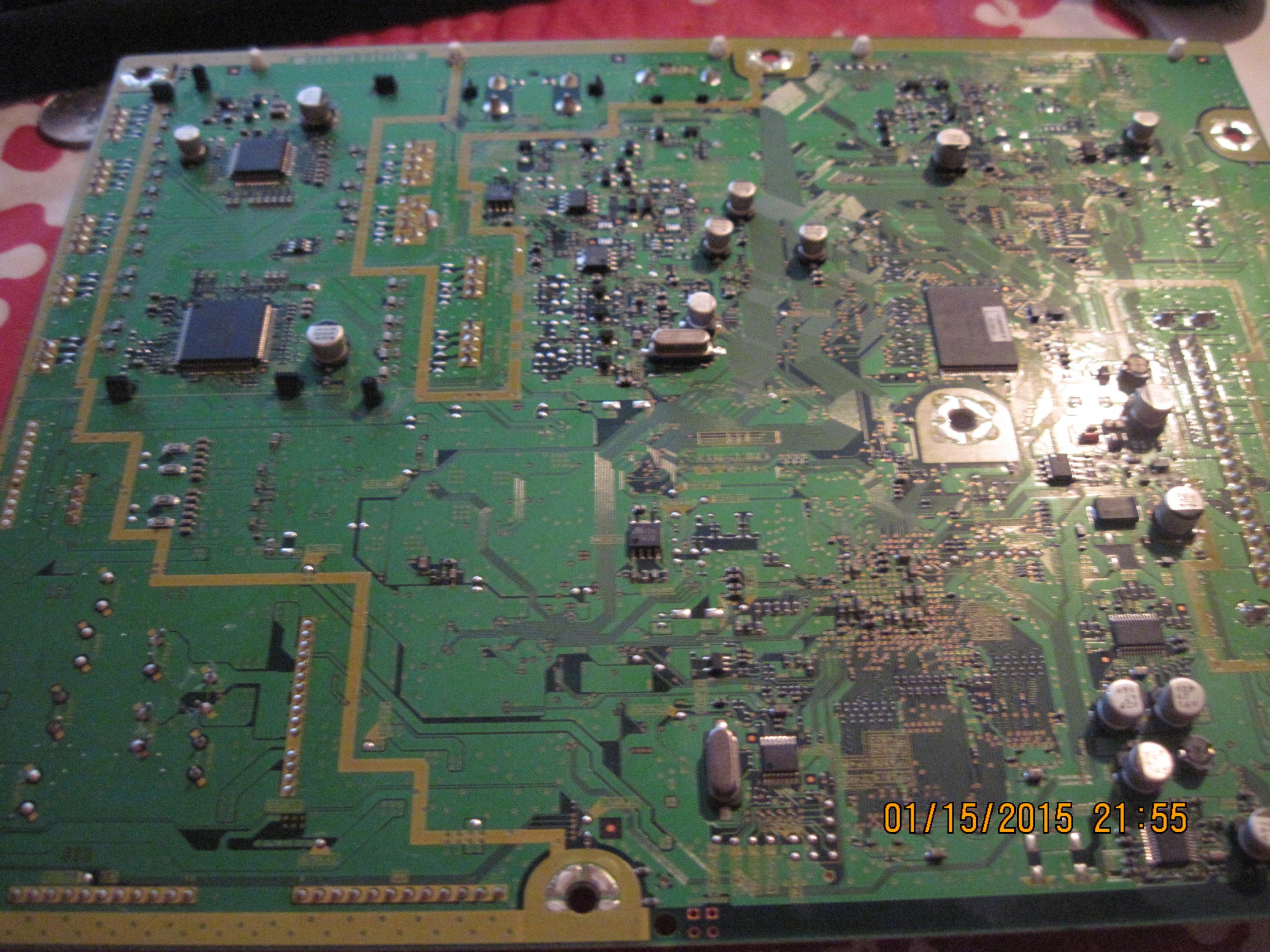

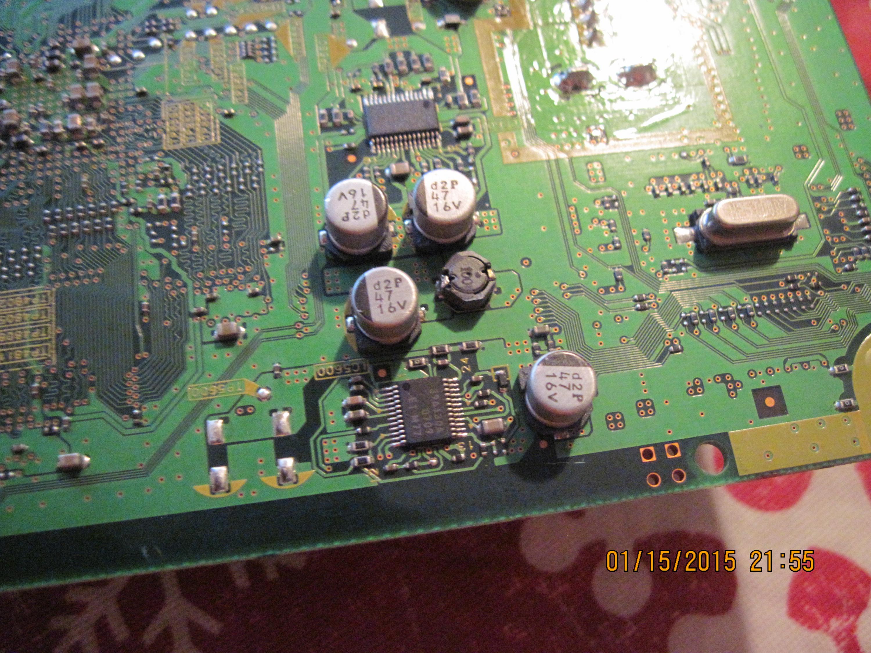

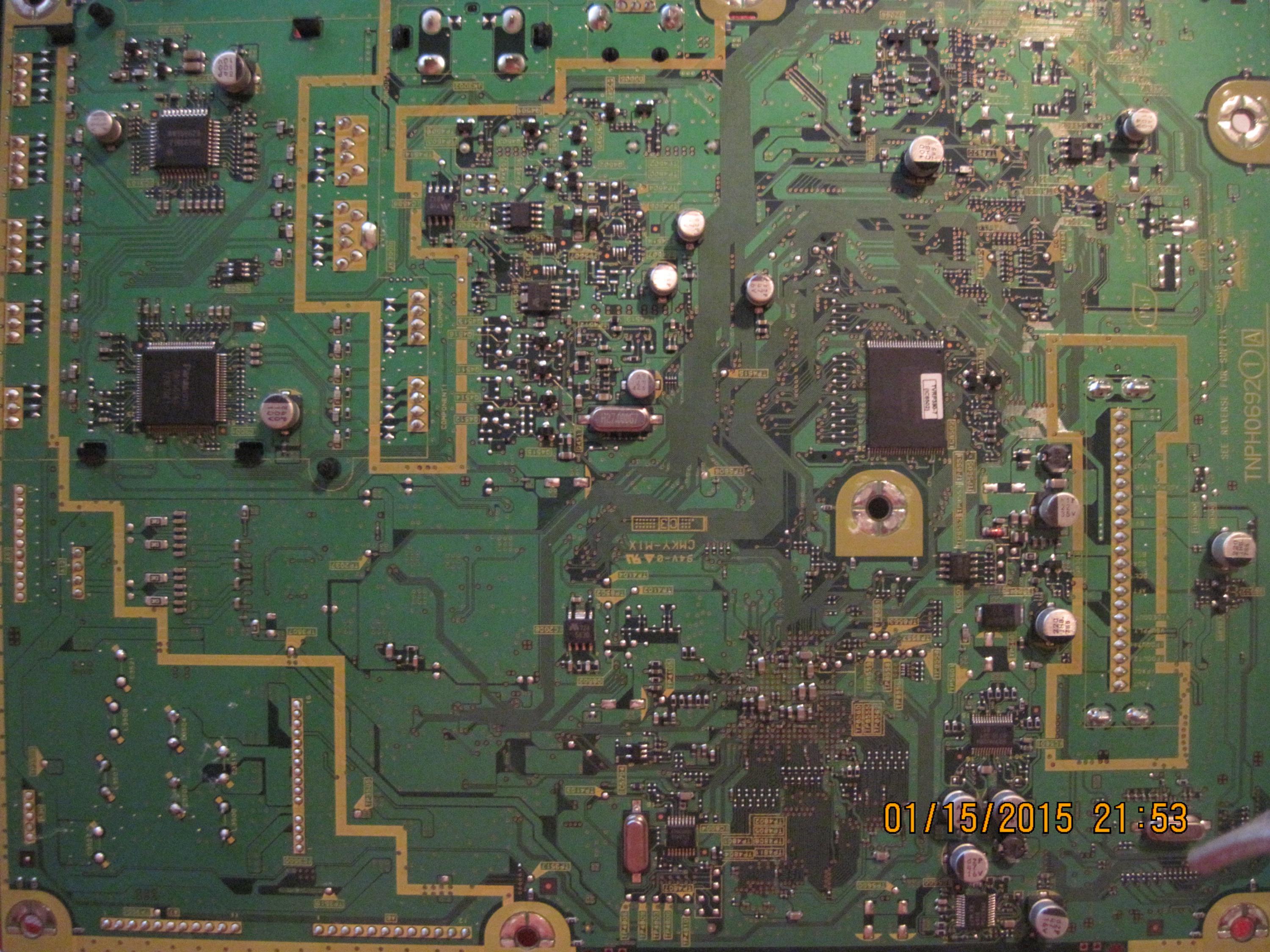

        Can you post good clear pictures of the back side of the board?

          These are the best i can do. Hope this help.

            closed. replaced the mainboard. It now working.
