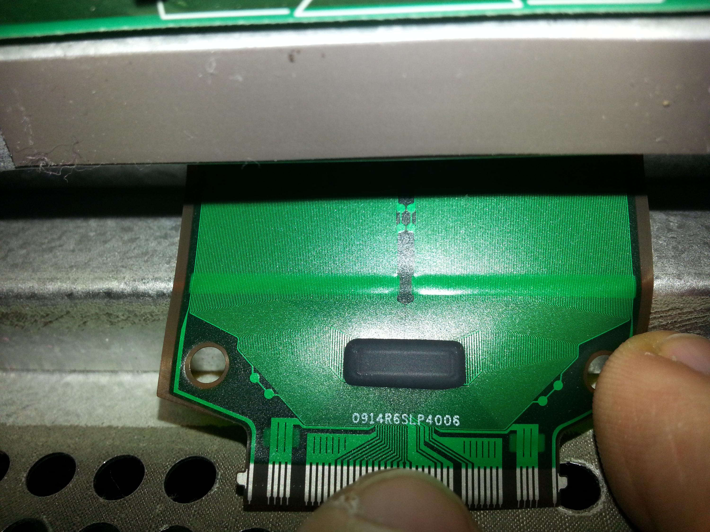

    I took it apart and was able to get most of the screen working by unplugging the very last vertical screen section. It was preventing the other 4 sections sharing the same board from working.

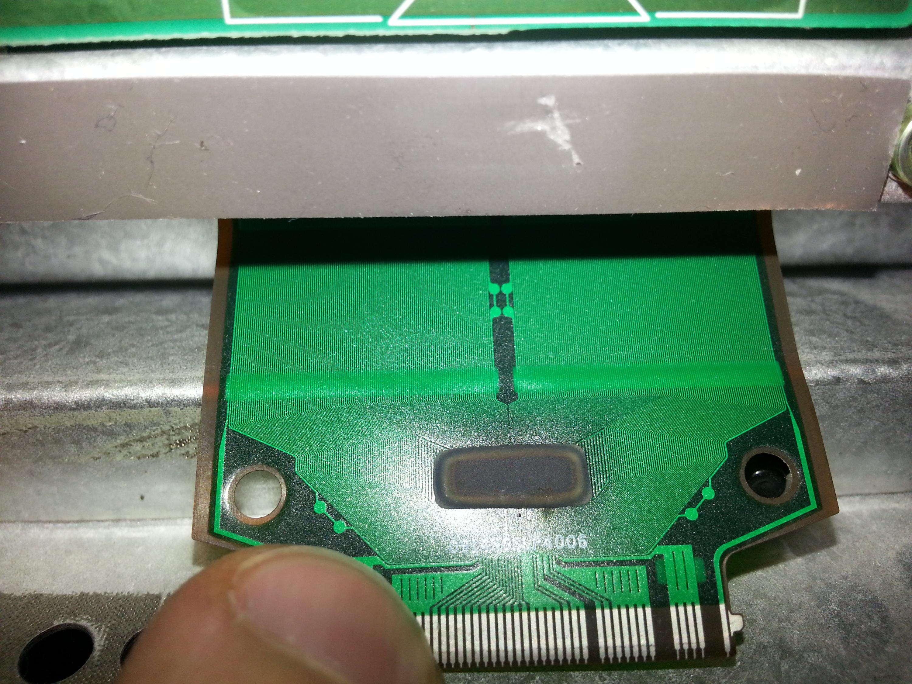

    The first picture I've included shows the connector for the faulty screen section. The 2nd picture shows the connector of a properly functioning section. It would appear there is some burn residue and brown discoloration. I'm going to guess that this connector is embedded in the plasma panel and is not fixable.

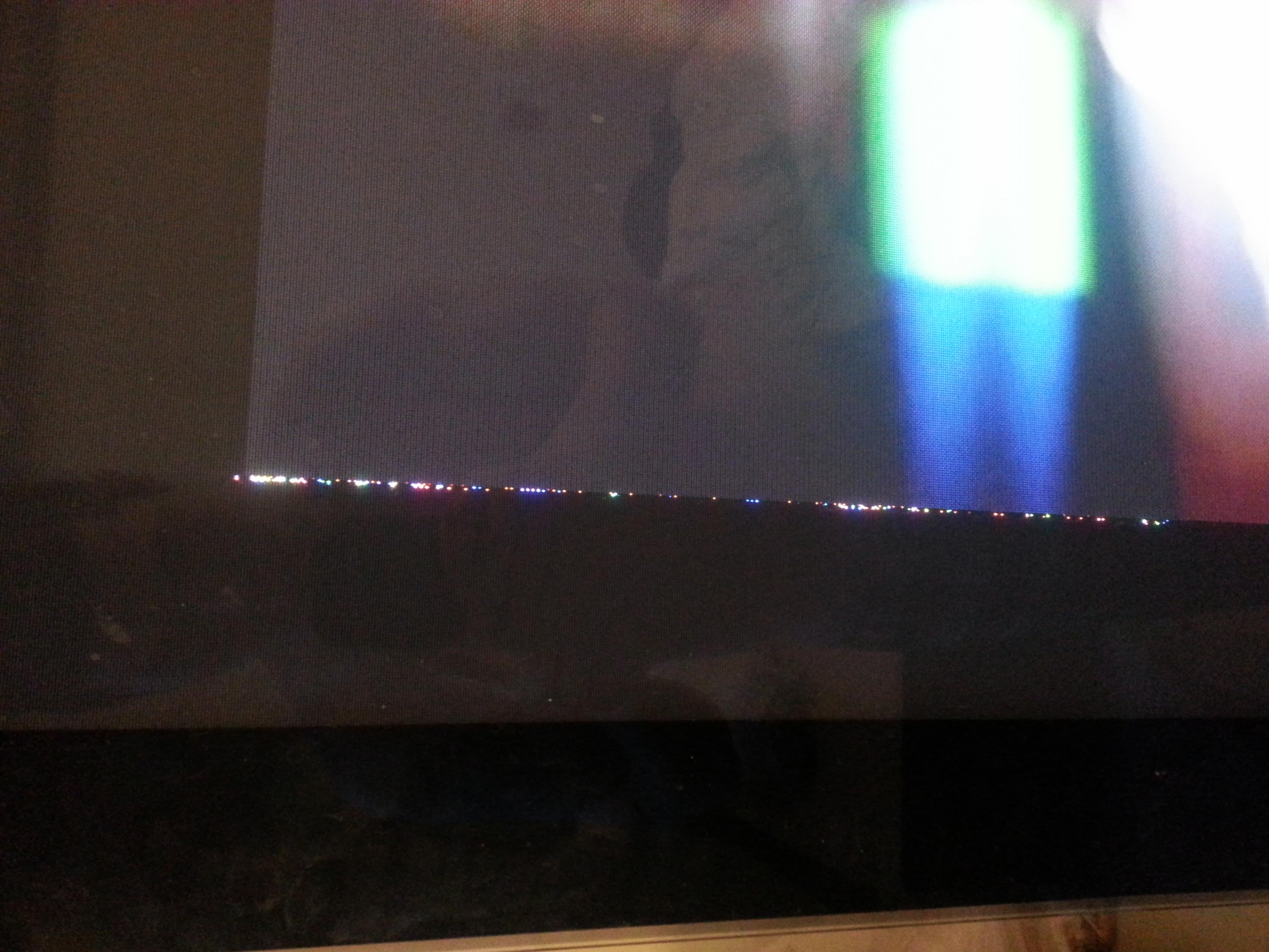

    The 3rd picture shows what I've got..
    1/16th of the screen does not work (presumably from that burnt connector)
    There is a bleed of misfiring pixels in the dead section

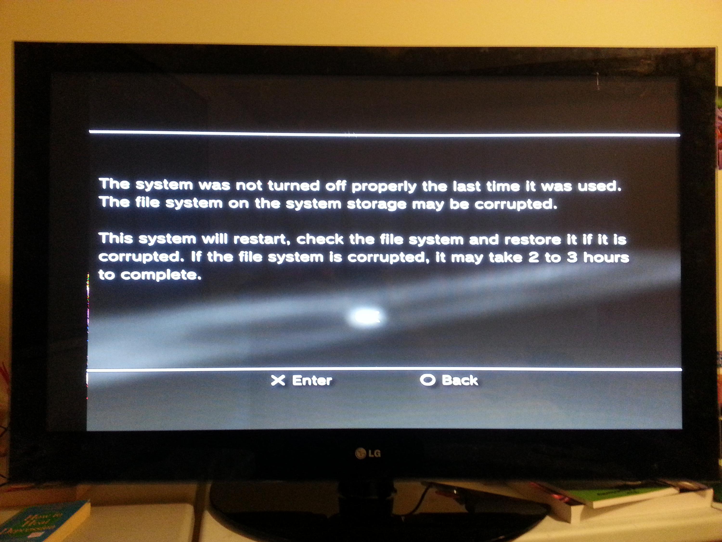

    There is a vertical line of misfiring pixels aprox 35% from the left side (you can see it beside the words "turned off properly"
    Also, all 4 HDMI ports will accept a source, as long as it's not 720/1080, they will accept standard def only. And whenever HDMI is used, the screen flickers with boxes of static, and the speakers emit random bouts of white noise. RCA inputs work fine.

    Yes, unfortunately that would not be repairable. As for the HDMI issue, try other sources. Some issues with "Deep Colour" on PS3s can cause issues with HD resolutions, it can sometimes be turned off.

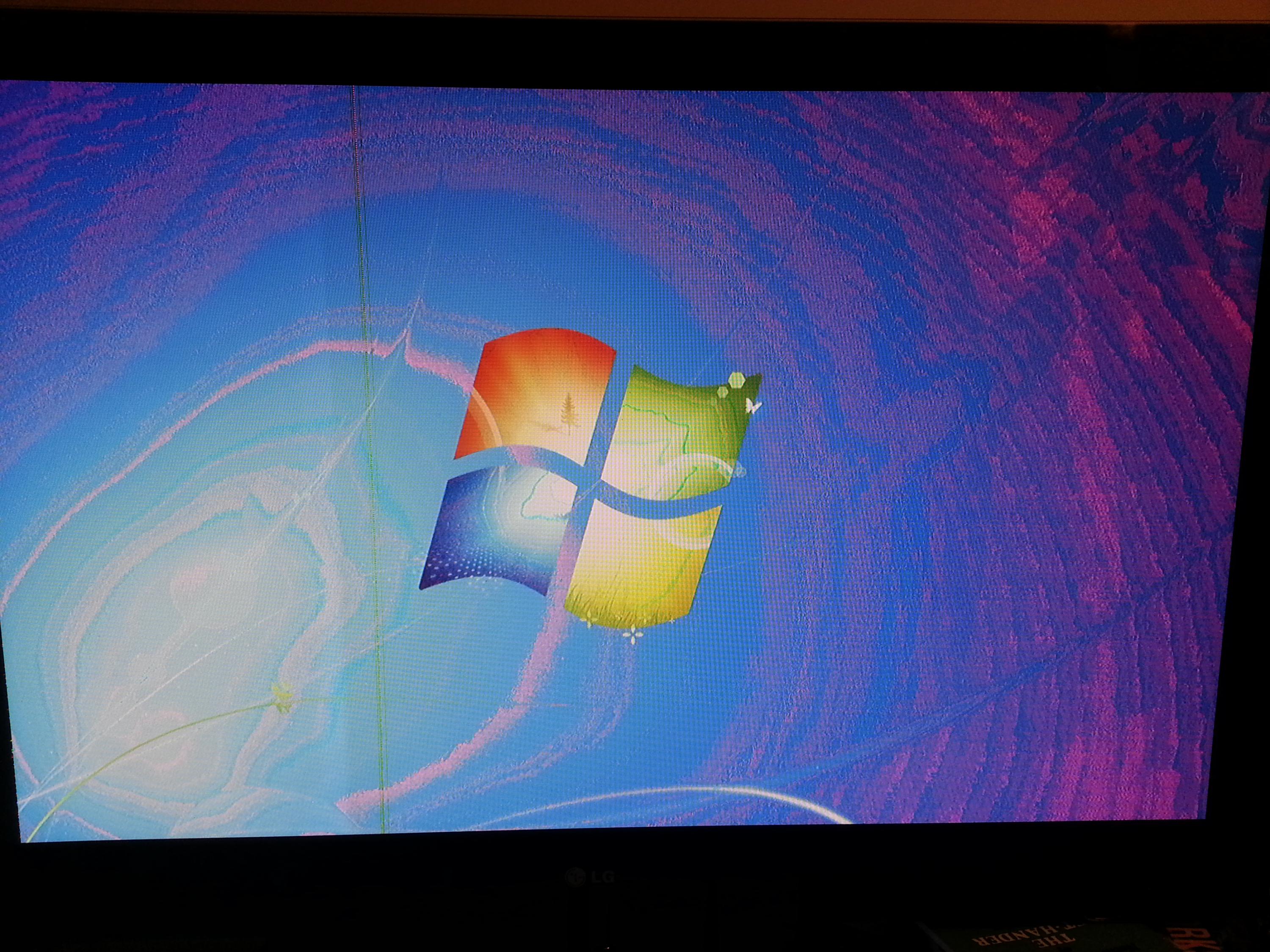

      Hooked the TV up to a computer, photo 1 shows what I get at 1920x1080. Display seems fine at 1360x768..

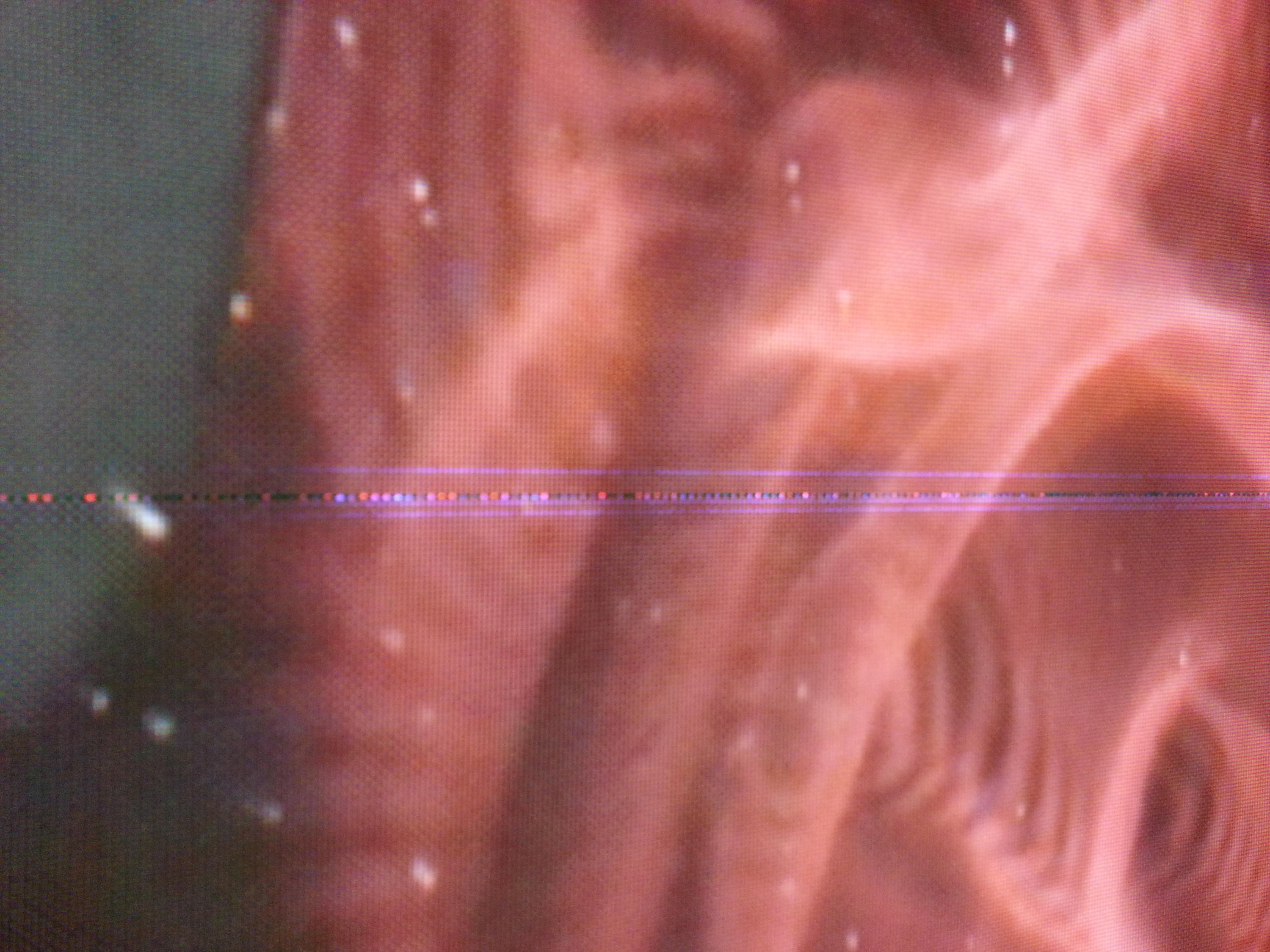

      Photo 1 and 2 show the mis-firing pixels (amidst the wormhole from star trek the movie )
      I tried the PS3 with all of the advanced display options turned off, to no avail. It only works via HDMI @ 480p and through composite @ 480p but nothing higher.

        It would appear that my PS3 issue and crazy colors @ 1920x1080 on computer are attributed to simply having too long of an HDMI cable. I got a 6 footer and everything seems to work fine now, minus of course aforementioned defects.

          Unfortunately the lines can't be fixed. These model LG plasmas are well known to have issues like this due to panel failures. Sorry

              One more quick question if you don't mind.. I don't suppose it would be possible to cut power to just the damaged segment of the screen? The bleed has started to spread quite violently! I'd rather just have a completely black dead section. I have the data disconnected but I'm guessing the power is applied to the entire panel simultaneously. Black tape time?
                Re: LG Plasma 50PQ60
                Which side, the left hand side? In theory you could cut the COF off. the middle lines can't be removed without killing one whole block of ~128 pixels.
