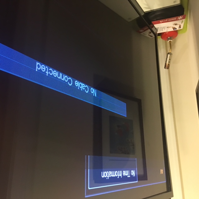

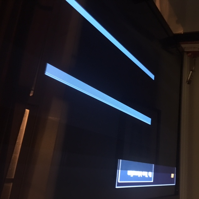

      Hi guys, been following this thread and decided to try and freeze the caps and chip on the y-main referenced by the attached picture. I was able to see a picture however there was a horizontal block missing in the center of the screen also referenced in the picture.
      I used a can of dust off upside down due to not having proper freeze spray, and there was some condensation. Did I damage something or do you think the missing picture is due to the original issue of bad caps. Or lastly maybe the panel is also bad or the y-buffer is damaged.
      Thanks hopefully this makes sense. Just wanna know if i should proceed with trying to repair this tv or recycling it if it's beyond repair.
      Also not sure how to orient the pictures in the attachment. Not sure why the pic got attached upside down.
      • mungk
        • Sep 2016
        • 3
        #123
        Re: Stumped on Samsung PN60E530A3F
        Turns out I just needed to reseat one of the connectors from the ybuff to the panel. Now I guess it's just a matter of replacing the three blue caps. Thanks to everyone that has contributed to this thread!

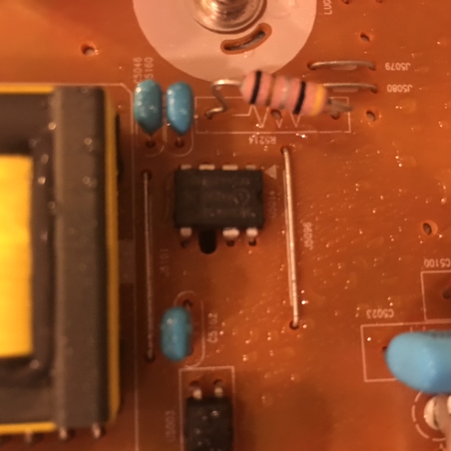

            Hi guys. I wanted to share my experience with this issue.
            I have a PN60E550D1F that for the last couple of years has had a deteriorating issue in which if the TV was warmed up, powered off, then back on, it would have no picture. Only sound. When it first appeared, usually letting it cool down for 5 minutes would resolve. More recently it needed to wait at least an hour before it would work again.
            Warming up the 3BR0665J chip area with a hair drier duplicated the issue reliably. I then cooled it with freeze spray and it came right back to life. I did try drussell's voltage divider trick, boosting the VIN to about 24.8v. It helped, but did not resolve the issue entirely. It only shortened the cool down time to about 5-15 minutes.
            This evening I replaced C5162, C5046, and C5160 with Nichicon 105c 10uf 63v electrolytics. I have a new 3BR0665J on hand, but wanted to try just those 3 caps first.
            I am happy to say that it now works like a new TV! I can power cycle any time, and it comes right back on!
            Here's a before/after of the caps I replaced for future reference:
            Thanks for the research and info guys. I was able to repair my TV for less than 30 cents!

                          Called Infineon directly.
                          The following is a direct replacement for the obsolete 3BR0665JZ (7-pin):
                          It's the ICE3RBR0665JZ (7-pin)
                          http://www.mouser.com/Search/Product...E3RBR0665JZXKL
