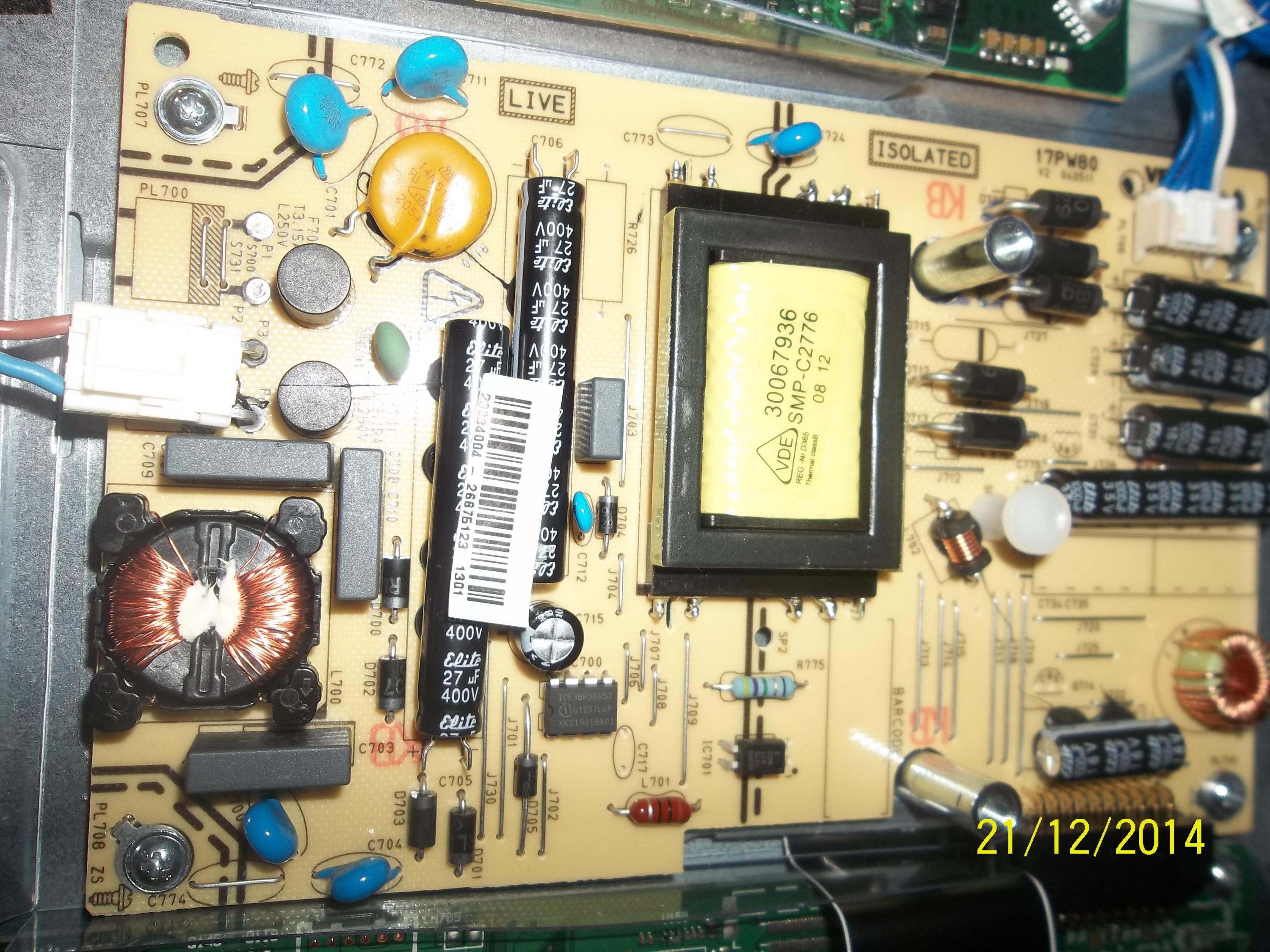

    hello, I have this TV ,there is no light on front panel,wont turn on.
    I only hear buzzing sound from powerboard.
  • JonathanAnon
    • Jul 2012
    • 457
    • Ireland
    Re: Polaroid P24led12 wont power on
    Could be a cold joint on the power board... Pictures of the backs of the boards would help, if you feel comfortable taking them out and photoing them... You would need to discharge the caps on the power board...

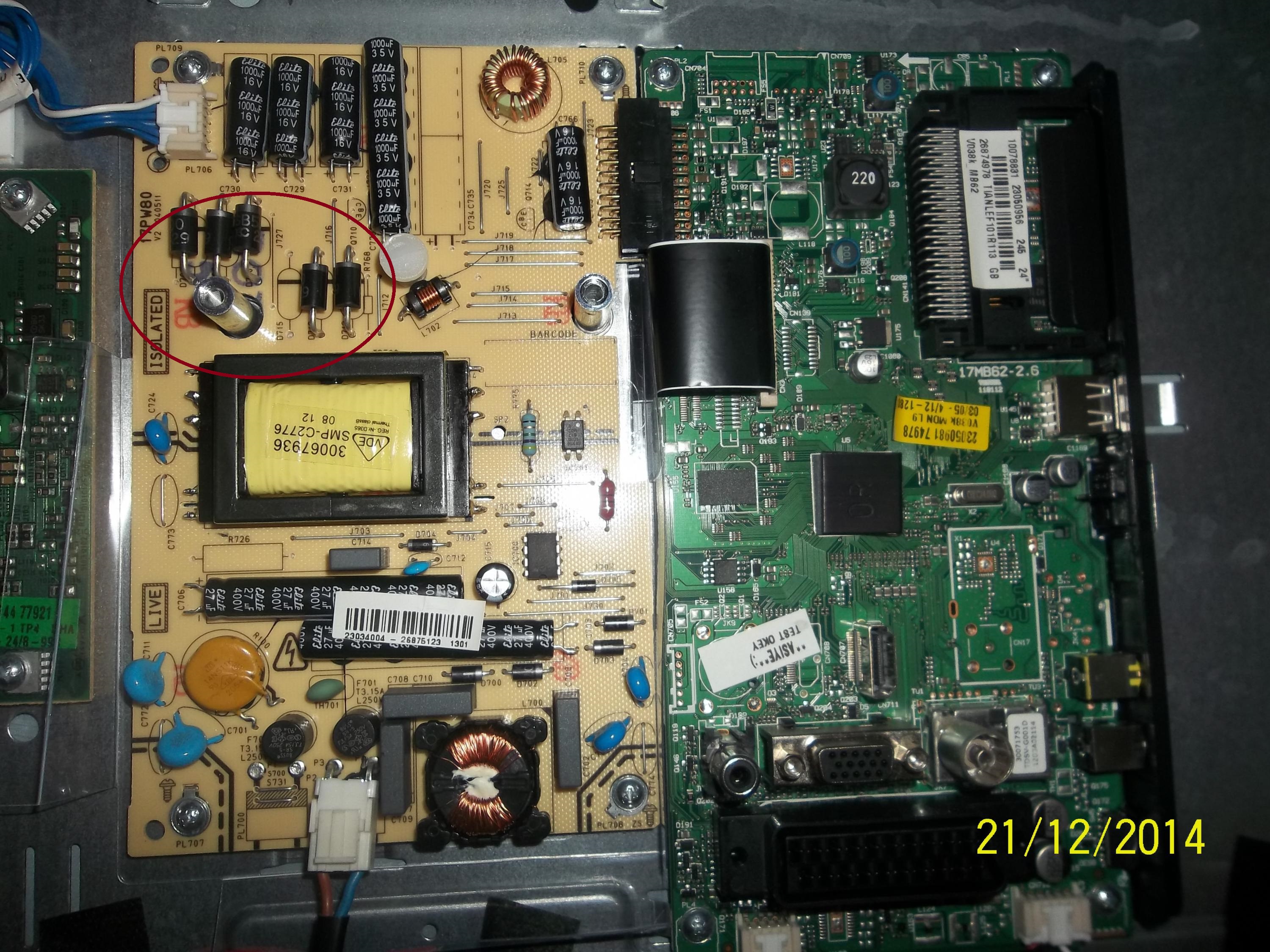

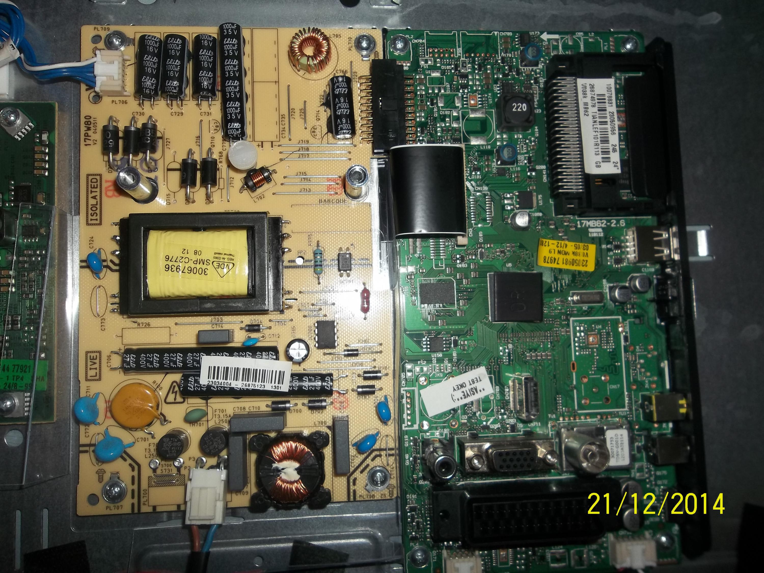

          have u checked the diodes for shorts i have circled in the picture i had this on a tv recently totally dead but just a idea....
          but pull one leg out at a time to test
            I checked this,they are ok...

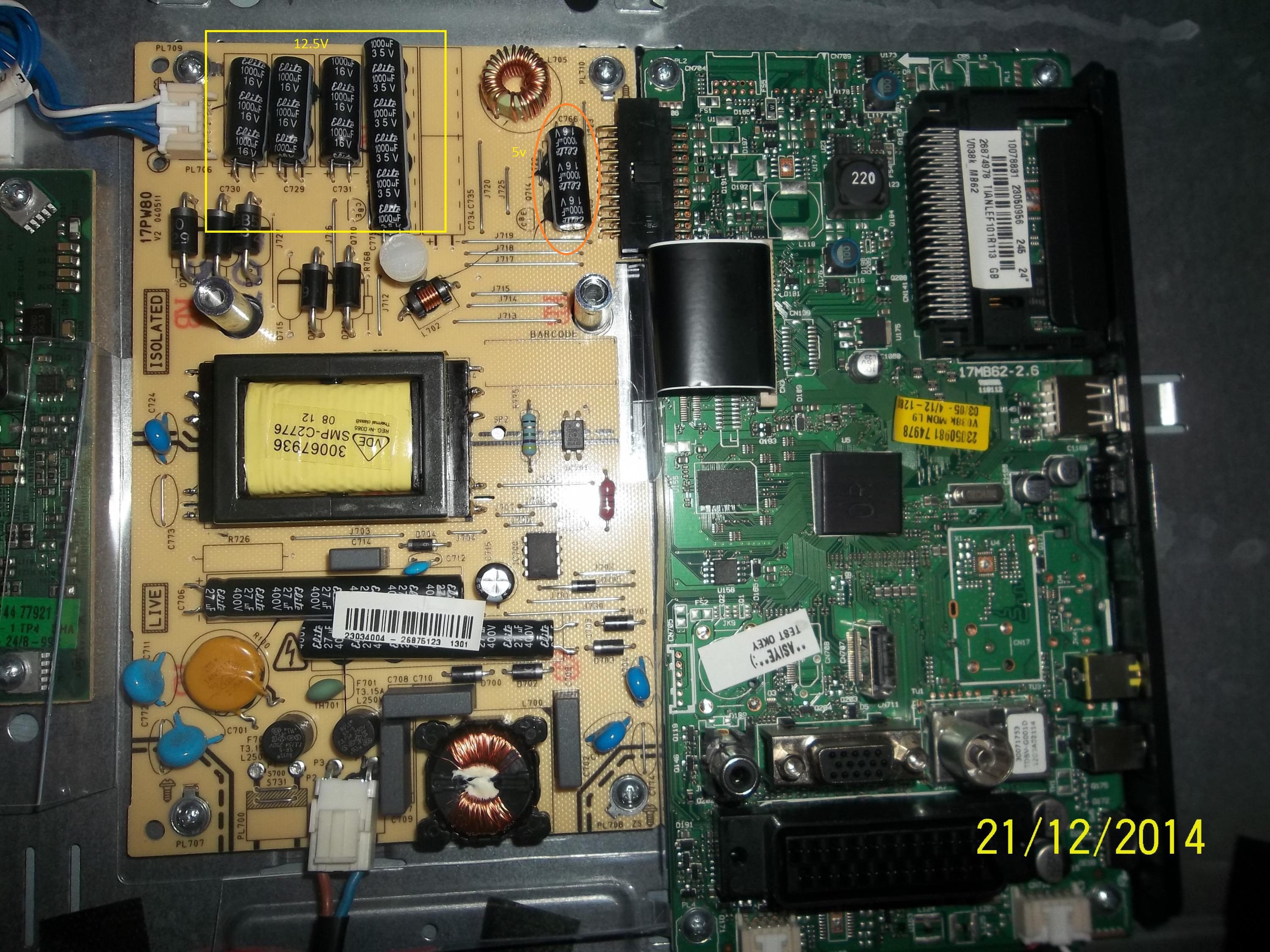

              Ok I checked this caps on picture,I get 12,5 volts on 16v and 35v caps
              and 5v on 16vcap.
                  voltage on diodes D708,709,710,712,713 is 12,45 V

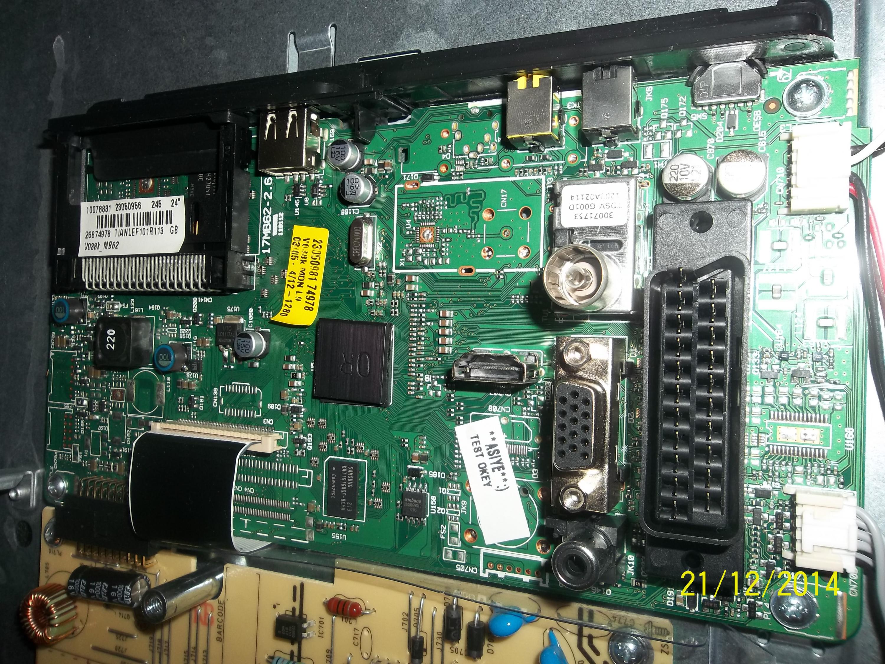

                        what voltages do you have ?
                          Seems like it is probably another main board problem.
                            I just replaced a mainboard in the 32" version, power supply was fine all voltages present, when plugged in the mainboard would start squealing and voltages back from the main would drop or non exsistant.
                            Replaced the mainboard and it worked, fired right up.
