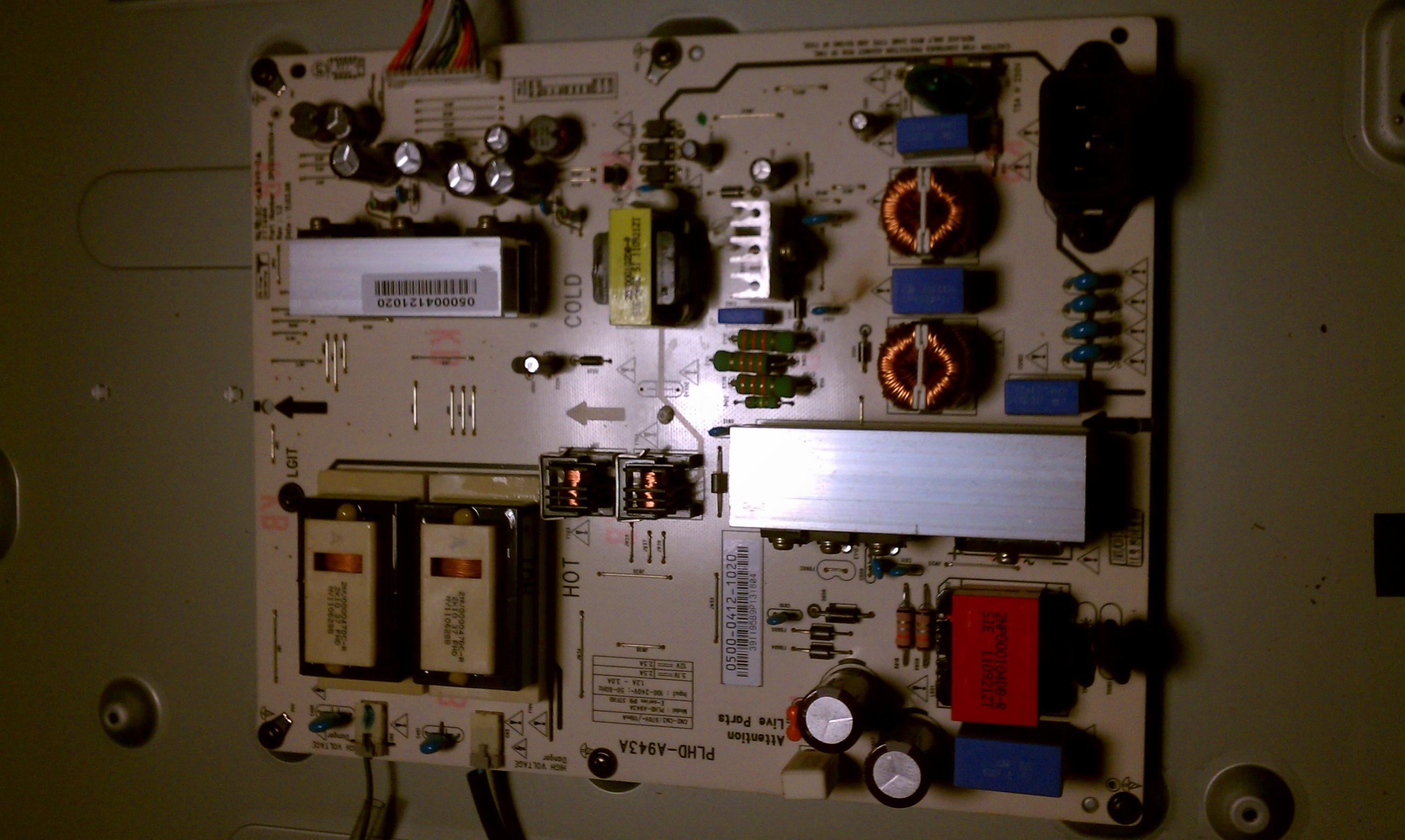

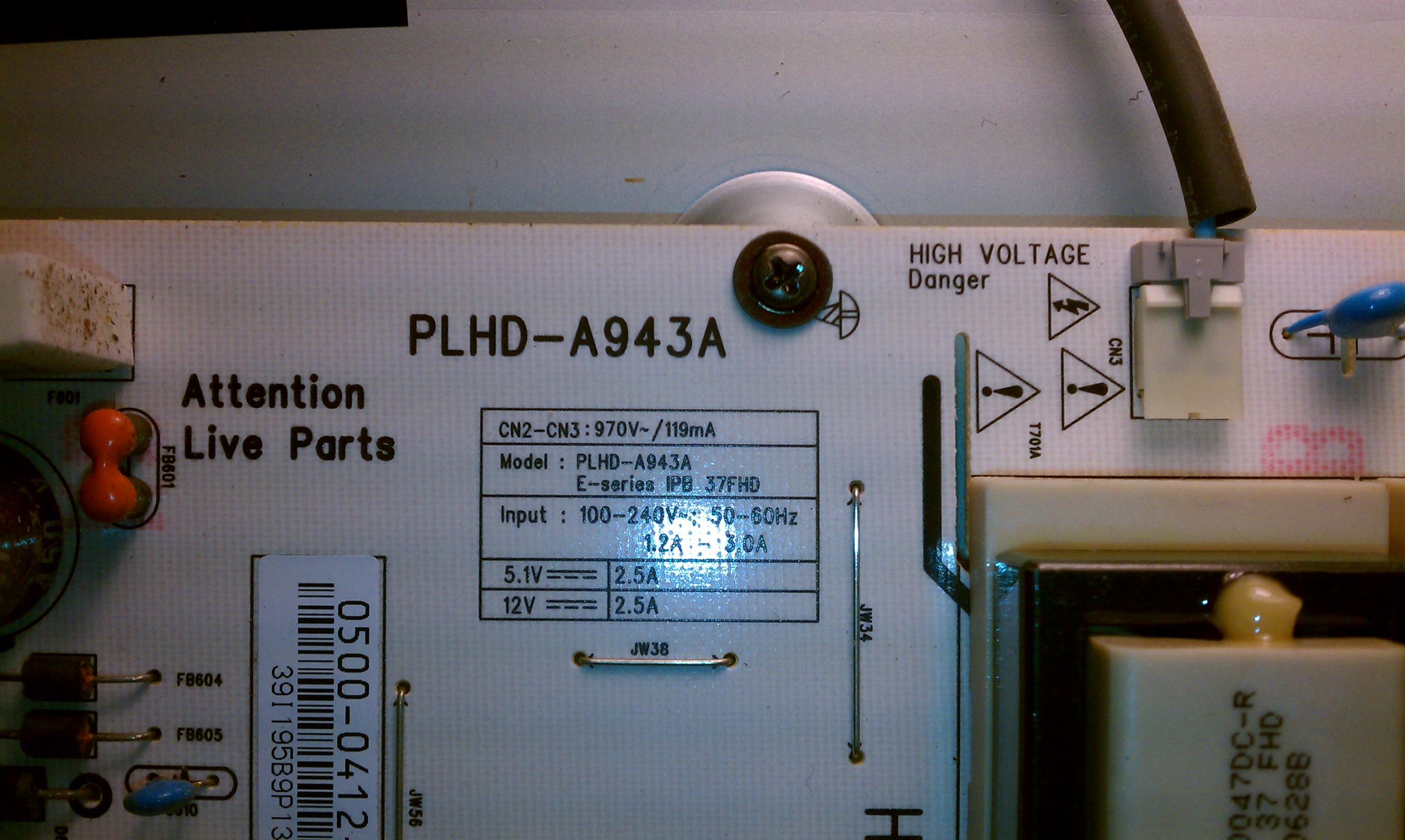

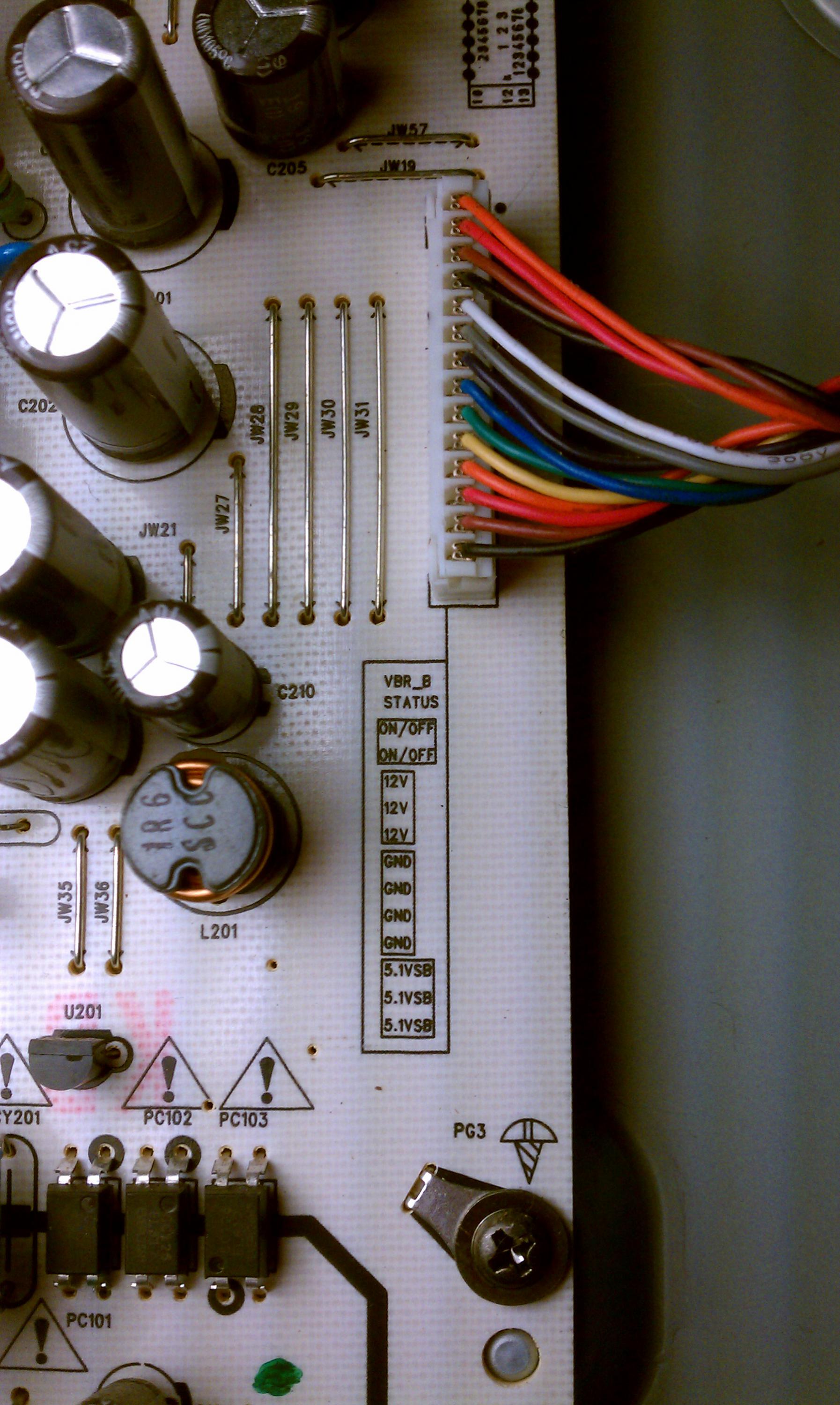

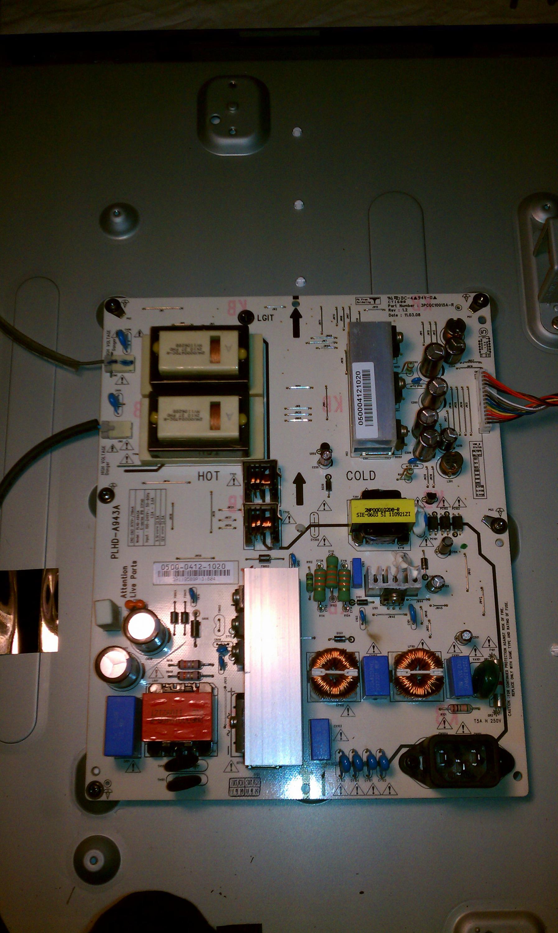

    first time seeing a JVC. this one is just 2 boards, a psu/inv combo and a mb/tcon combo
    seems like a bad psu since i dont see any voltage coming from the psu.
    i cant see anything visibly damaged. fuse checks out ok, i see some dc voltages on the components nearer to where the power comes in, but then no voltages on the components by the connector going out to the mb.
    anyone work on one of these before?

    Re: JVC JLC37BC3000 has no 5v standby
    Worth noting this is actually an AmTran set, same company that makes Vizio TVs.

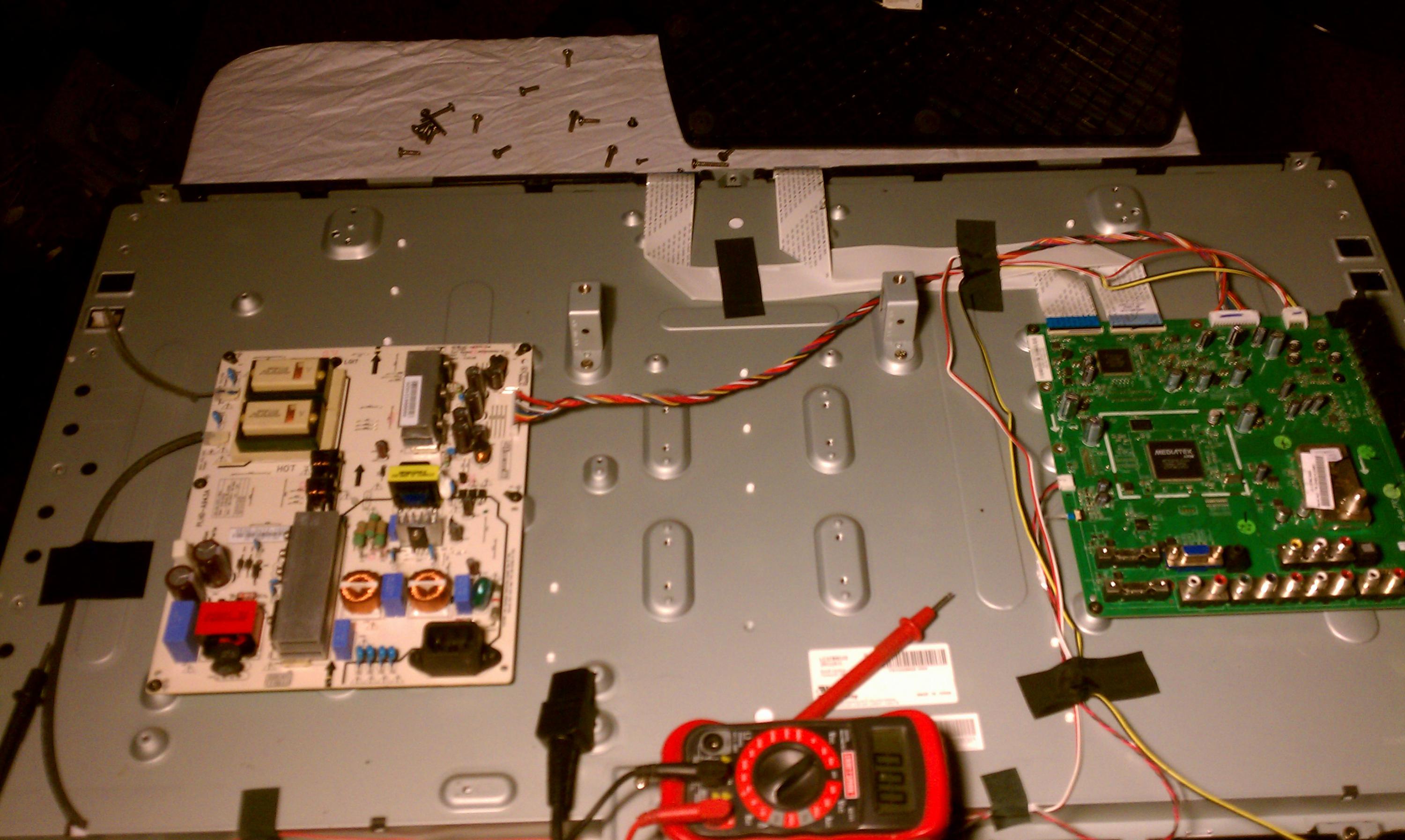

    Check for standby voltage with the main board unplugged, to eliminate a possibly shorted main board.
    • triplefour
      • May 2014
      • 1747
      dang i guess i should have mentioned i tried that already. with no difference

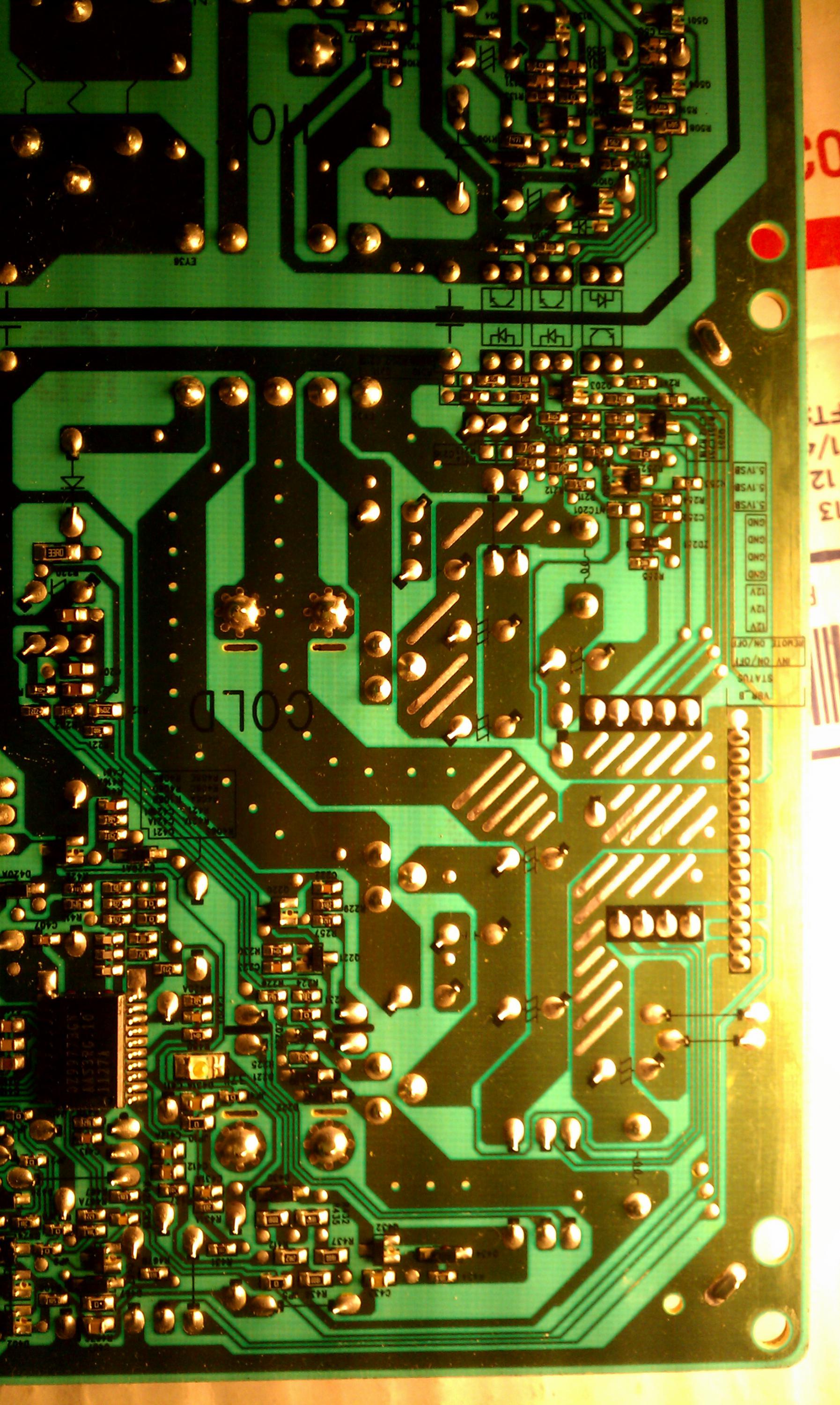

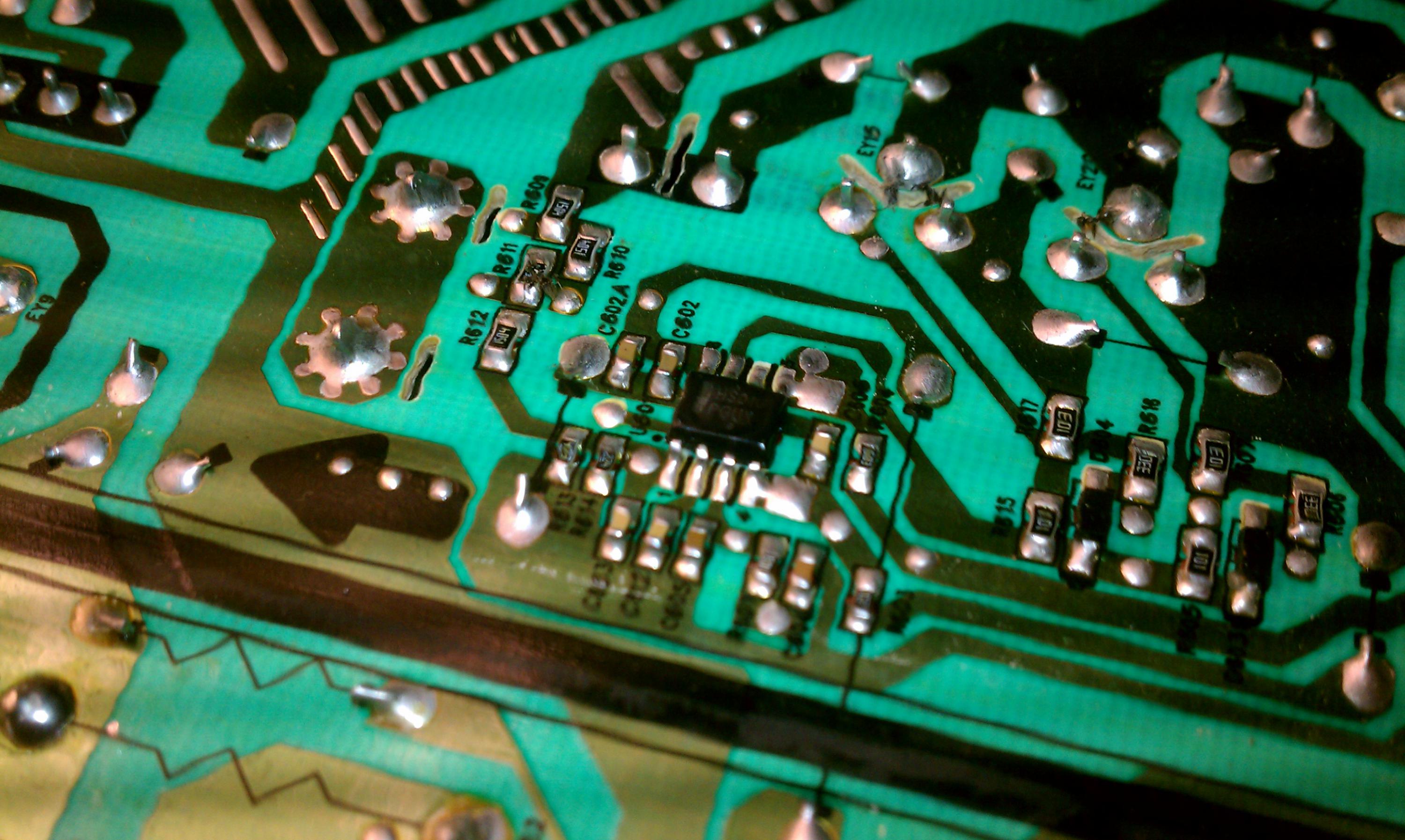

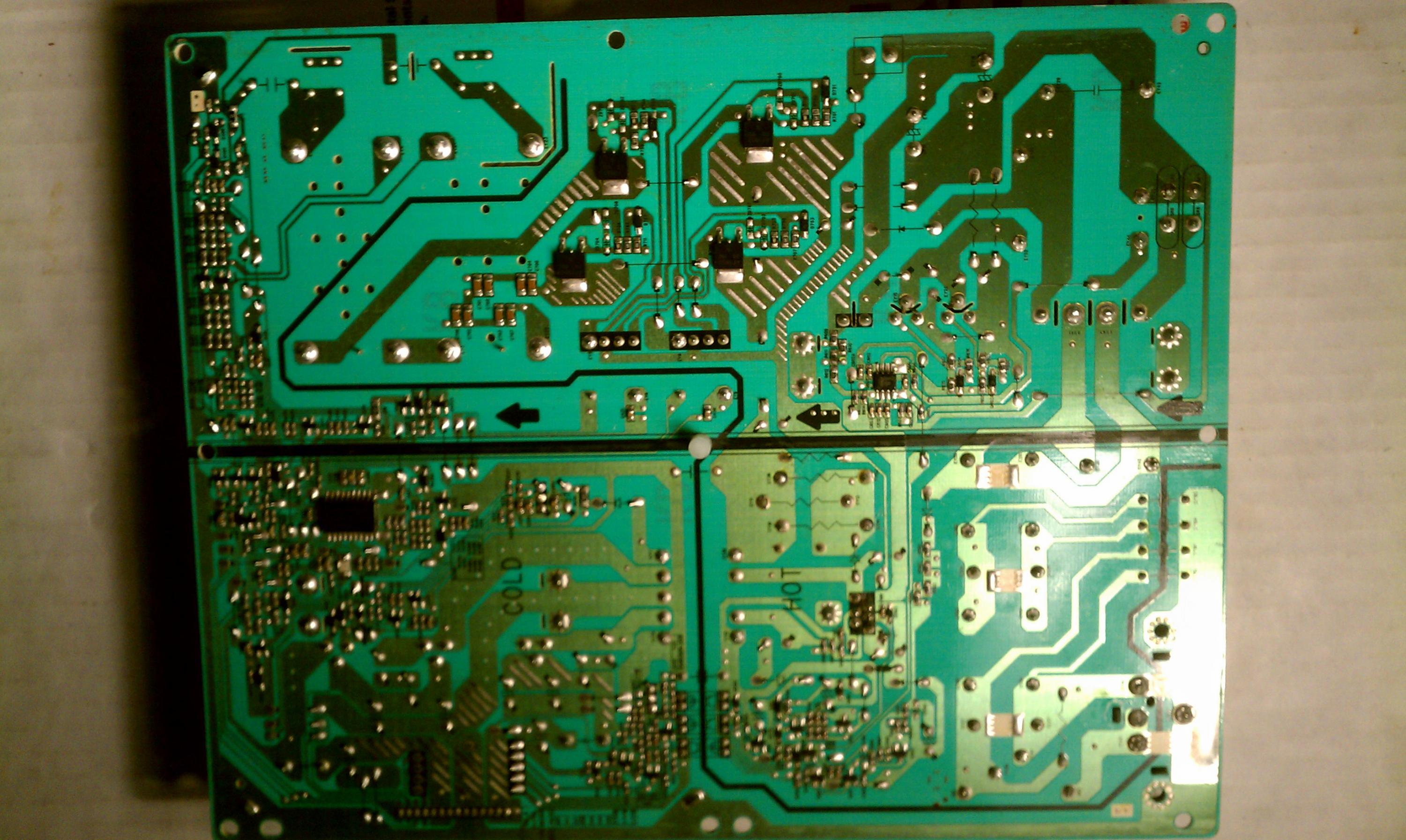

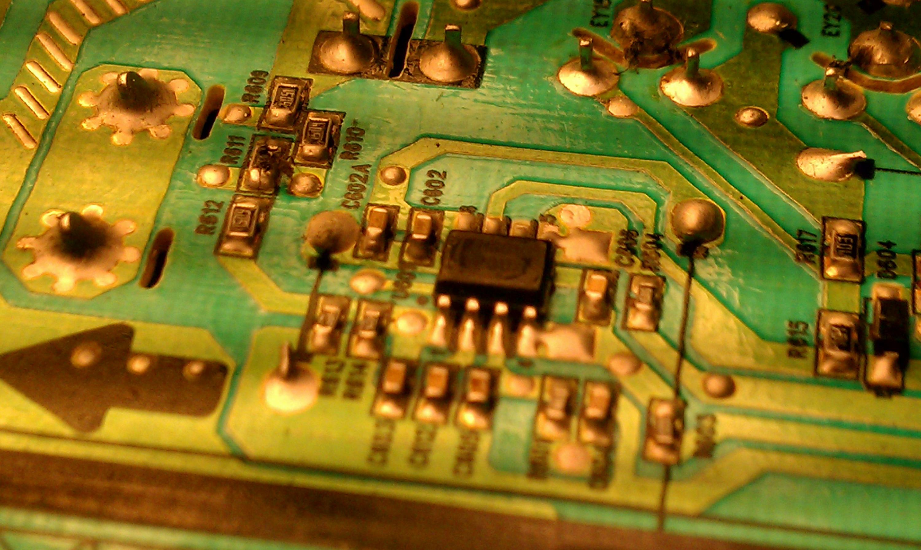

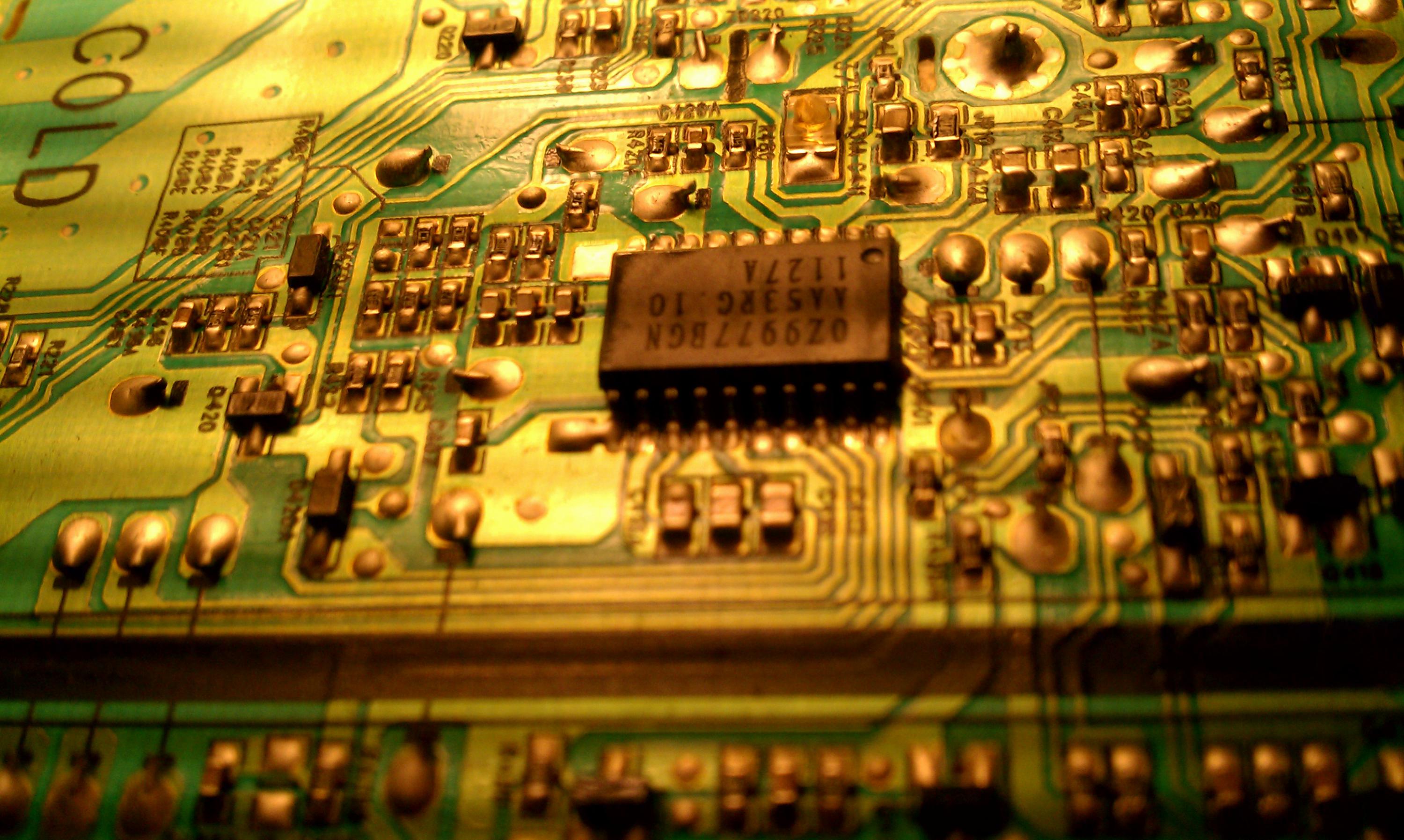

        Good clear pictures of the bottom side of the board so we can clearly see the traces? Need to see if we get b+ to that SMPS IC for the stby power supply.
        • triplefour
          • May 2014
          • 1747
          sorry for taking forever but ive been so busy lately.
          heres the pics of the underside of the board.

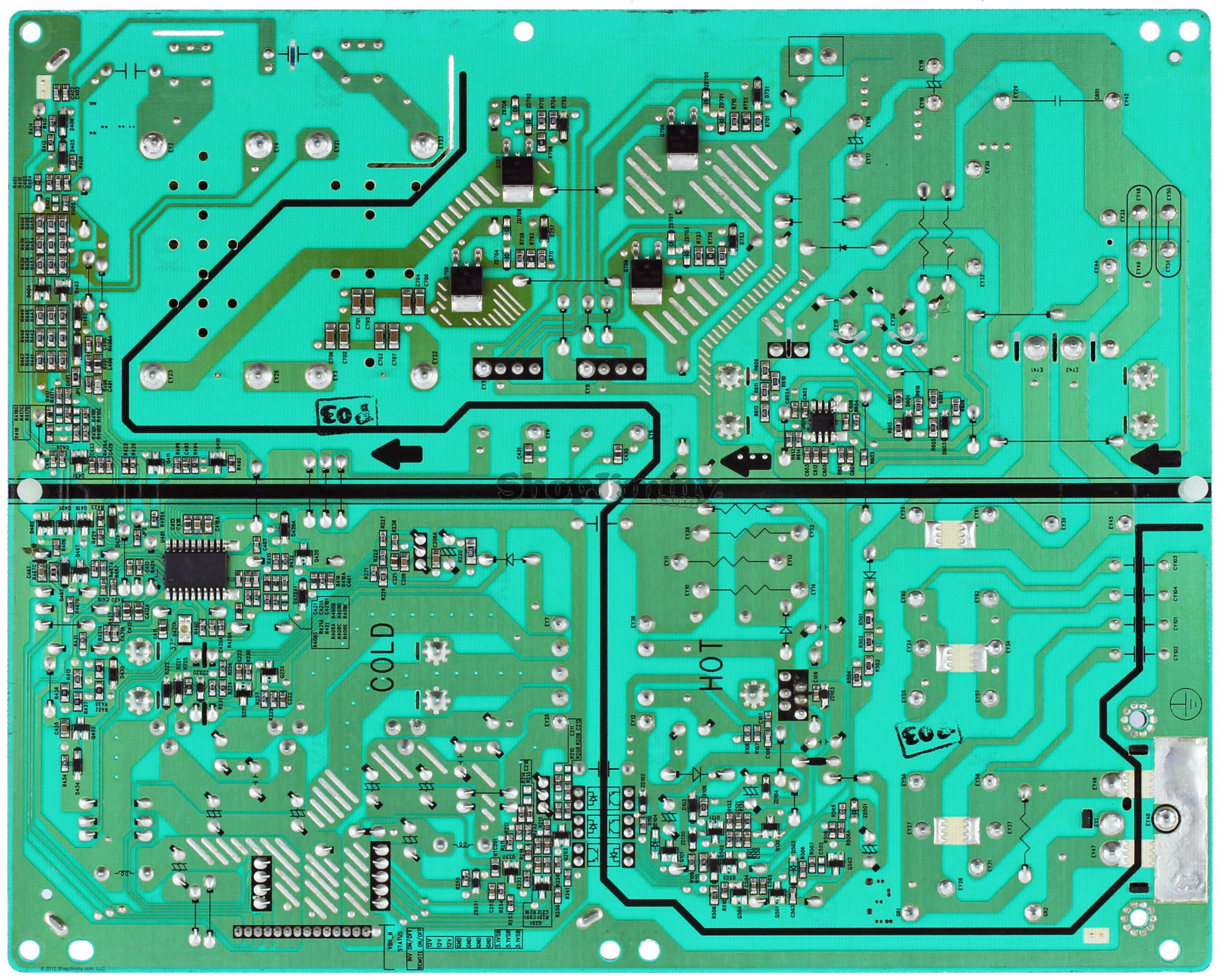

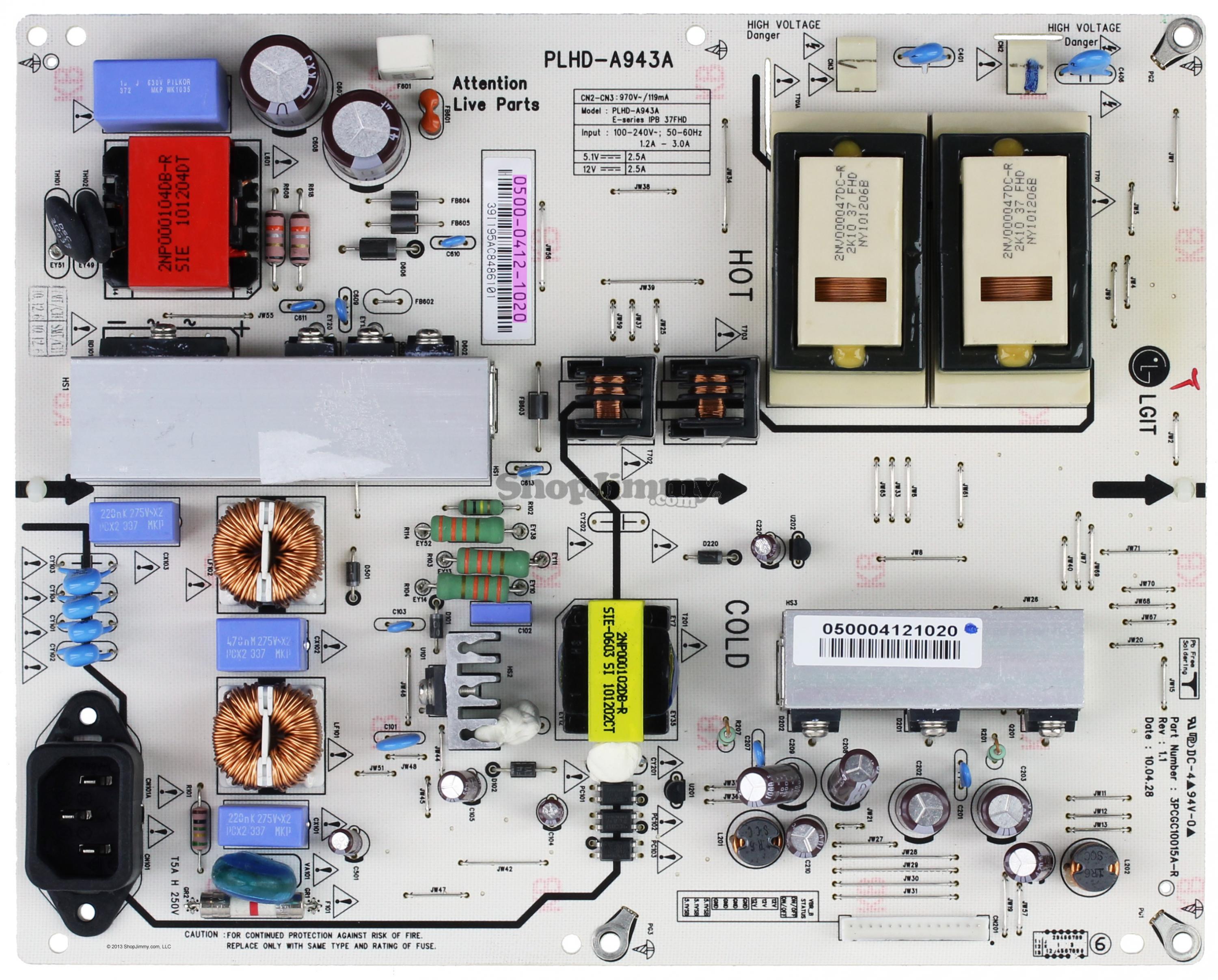

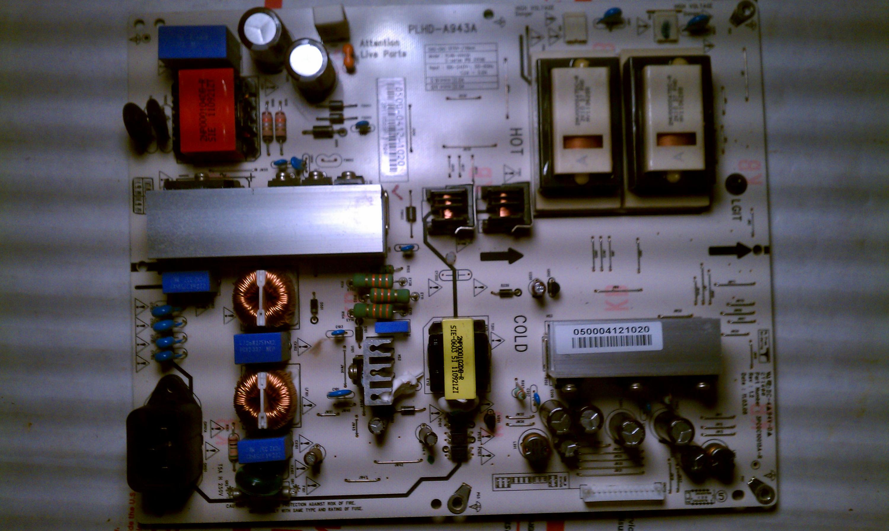

            whoops should have checked shopjimmy first. always with the much better pictures.
            according to shopjimmy its a Vizio 0500-0412-1020 Power Supply Board

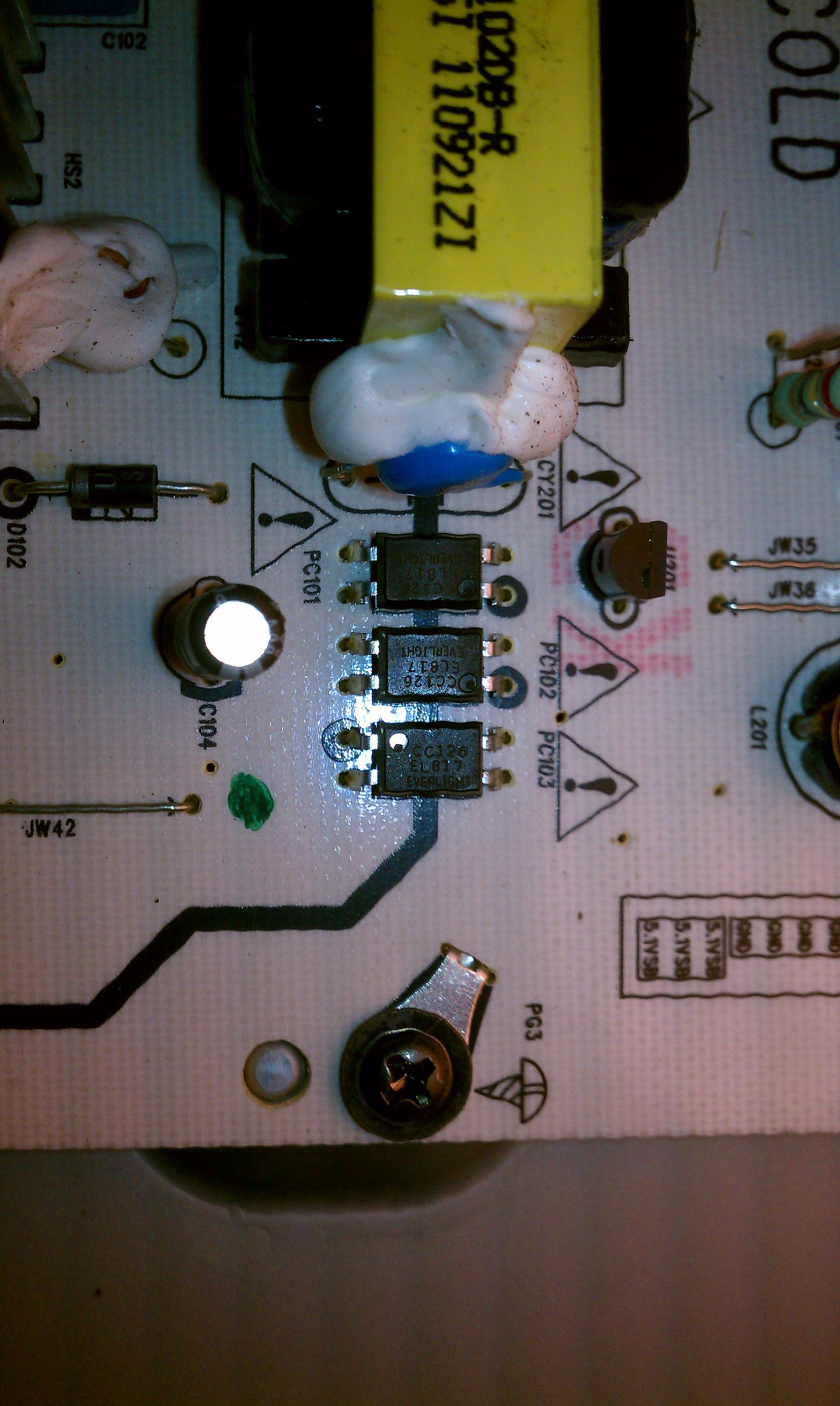

              sorry..what is B+ ?
              Don't fear the repair...
                Another word for PFC or rectified voltage i.e. across the 450V caps.
                  ok thanks. yes i need to check the PFC
