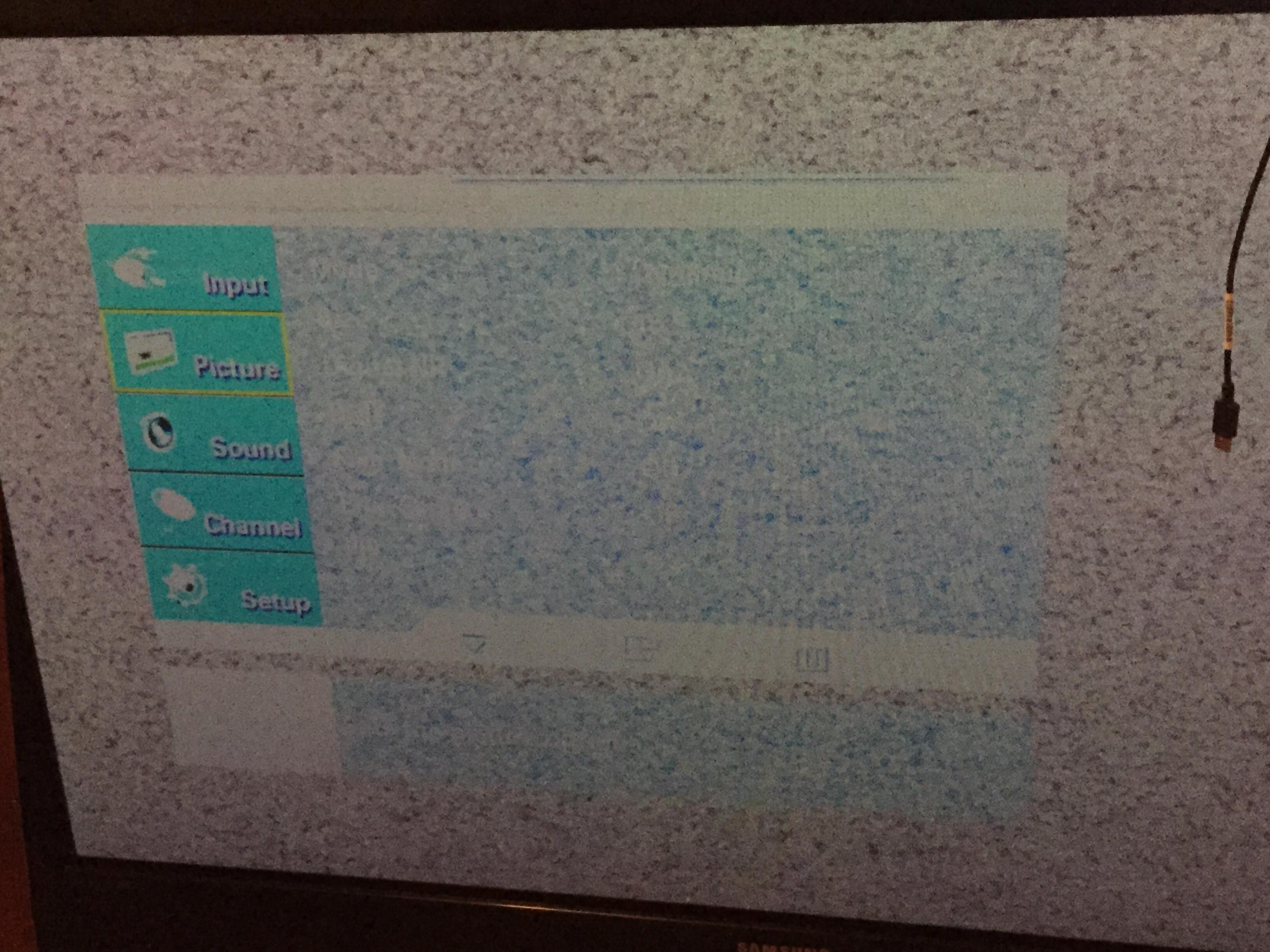

    Samsung plasma hp-s6373 picture color is off
    I woke up one morning with my tv not want to turn on. I replaced the y sustain main board and tv finally came on but the picture was horrible color issue.. Even on menu the colors weren't right. Black is like a teel color. I've metered all volts everything is a ok on x and y. Buffers don't have any shorts they are getting good volts from sustain. No fet or diodes problem. Power supply is in perfect working condition. The only thing I think it may be is. Logic board, video board or panel. That's all that's left. If there is something I'm missing please feel free to let me know. It would be well appreciated. I've talked to several other techs and nobody can seem to figure out what is going on.

    Re: Samsung plasma hp-s6373 picture color is off
    that looks like an incompatibility issue did you match the version and the part numbers on the Sustain when you replaced it?
      Yes absolutely. Double checked it as well.
