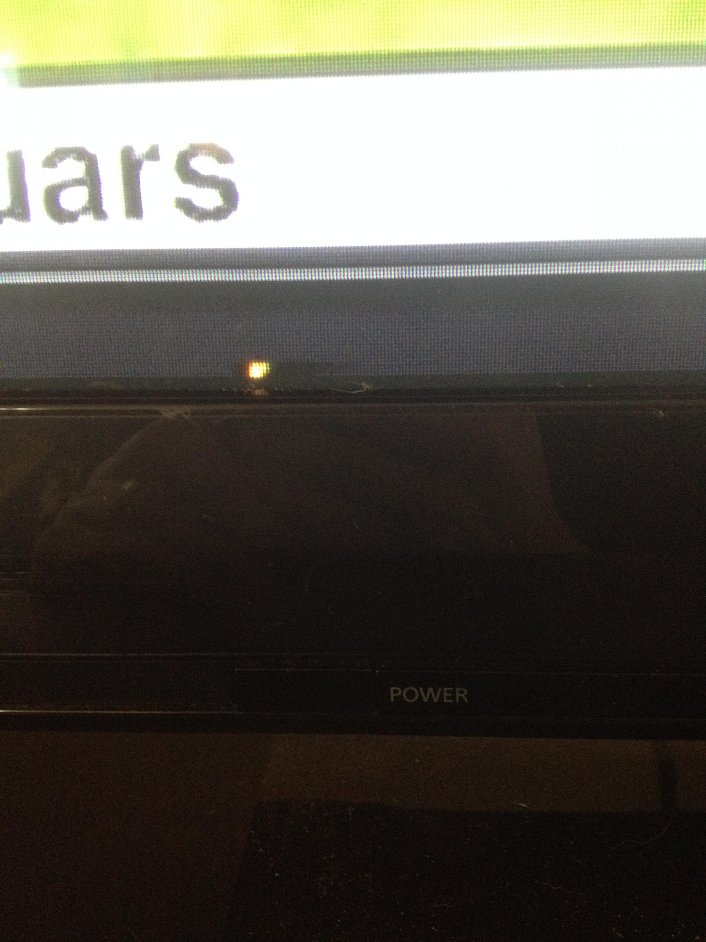

    This is my personal TV at our house here. My 4 year old was swinging a toy around and it went flying at the TV. It hit the actual plastic bezel but I now have this small spot just above it on the screen. My instinct tells me of course that I have a small fracture and it's going to die completely soon. Should I just quit using it and harvest the parts as is or is there any chance of it lasting for a decent amount of time with this spot? I don't want to end up blowing the buffers and/or SC board over a week or two worth of viewing. Any opinions are greatly appreciated as always.

    yes unfortunately that is a fracture now I have had some luck with stopping cracks on LCD panels using superglue believe it or not it's the air that gets injected into the panel you could try super glue around that area seal all voids within a Dimes radius of the crack. but unfortunately it still may not last but since it's so small it's worth a shot I've never done it on a plasma panel yet because usually when I find them they're completely aired

                  Low: it doesn't look like there's any actual damage to the top scan electrodes. I suspect the light is caused by damage to the cells rather than the panel surface, so it's not actually cracked. If the crack progresses and horizontal lines start going out, then there is an increased risk.
                  New territory to me though, so not entirely sure what to make of it.

                    Yeah, I thought it was strange that it still lights up. Also, the fact that it took a few days to show up. I'll keep you updated if it gets worse. As is, I think I'll be the only one bothered by it. It's literally smaller around then a pencil and right on the edge.

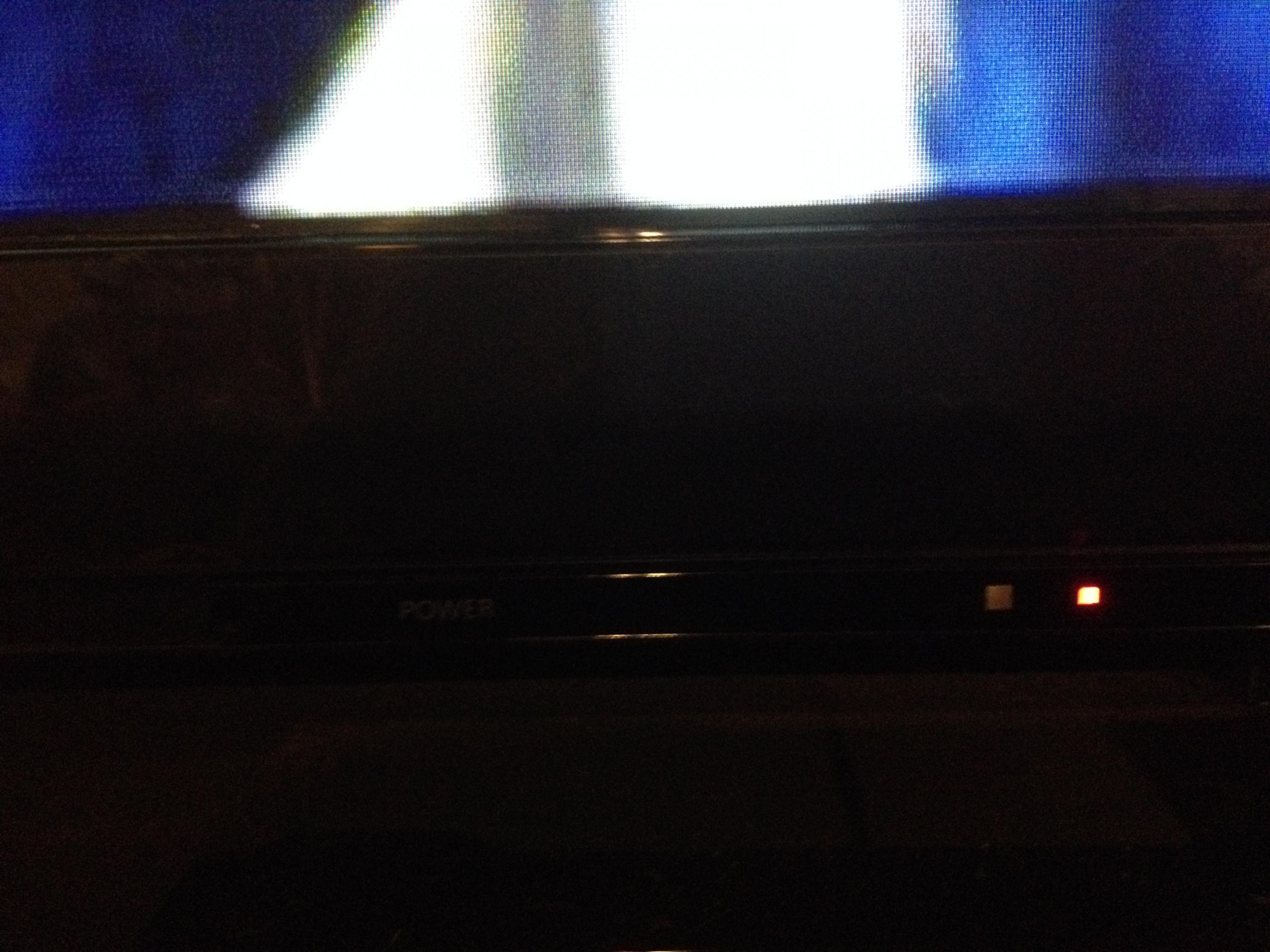

                              So, get this guys. I took freakaftr8's advice on the glue. It sounded like it could at least possibly stop the leaking in it's tracks. I removed the bezel at which point I could clearly see the crack. It was extremely small, but definitely visible. I coated a pretty decent circle around it with super glue, let it dry, and repeated a couple times. Reassembled the TV and gave it a shot. Last night and first thing this morning, the bright spot persisted, and actually had grown a bit and had some black pixels around it as well. Just now, I powered the set up and everything is back to normal. I certainly don't expect it to remain this way but I don't even see how that's possible. It's been on for an hour plus now and even if I get just inches from the screen I cannot even tell where the spot was. Keep in mind that I am very particular about how it looks.

                                Sweet! Can we get a picture of the area? like I said I've never tried it on a plasma panel only LCDs when they get whacked in the corner and they just start the crack

                                  I can give you a picture of where the spot was. However, the entire crack as well as the glue I applied is actually covered by the bezel. It's actually pretty awesome that I was able to apply the glue without making it visible. Basically, the lego he threw knocked the edge of the bezel into the screen. I don't think it actually made direct contact and I was actually quite surprised that such a small think even managed to crack it in the first place.

                                    apparently there's no more air getting into the panel because the black area disappeared meaning the gas mixed with the affected area creating a complete vacuum again.
                                    that's pretty awesome that it worked congrats hopefully it lasts. I know that the LCDs that I have repared with glue are still holding up to today

                                      Sorry for the poor lighting but you can see above the power button that the spot is now gone. It actually got somewhat worse than my original picture before I doctored it with glue but I didn't take a picture at that point for comparison.
