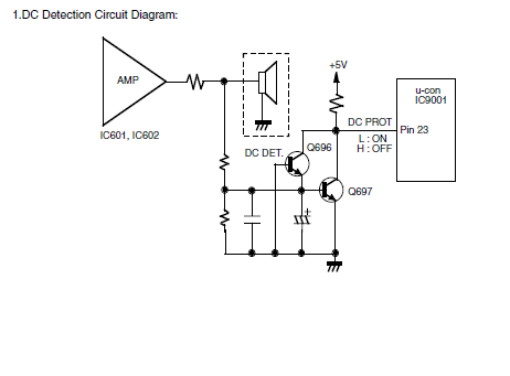

This stereo has a blinking red power light, when I push the Enter and Advanced surround for 3 seconds it will come on but then go to Amp Error and shut off so I tried pushing the Enter and Advanced Surround again but this time I hit the power button to shut it off before it went to Amp Error and the red power light would stay lit. Then I powered it on and held the Tone and Power buttons till it said reset then I hit Tone again then it said Confirm So I hit Tone again and it would Reset for a second or 2 then say Amp Error. I've read someone else had this problem and it was the transistors at Q696 and Q697. These are C1740's with R S P under that. From what I can tell these are obsolete so my Question is what are comparable transistors to replace these with? Any help would be greatly appreciated.

I did order the 2sc1740s from utsource 5 for 4 buck with shipping. Then found out they are in China so i think ill look for the 2sc2240's on Digikey or mouser.
Yes its a pioneer VSX-D812. Old but i am fixing it for a guy that seems to really like it.

Ok I replaced these 2 transistors after reading a thread on another site but still no go.
I have found a service manual but not sure how to follow it.
http://www.opweb.de/en/model.php?id=2138
Can anyone tell me what to check next?Comment

Had the exact same amplifier in today. The power led would blink all the time and wouldn't power up. Done the surround sound and enter button trick, amp came on for 3 seconds, displayed AMP ERR and turned back off. Checked the bricks and the DC detect circuit, bridge rectifier, diodes etc. and could not find anything.Anyway, I took the amplifier board out and resoldered both amplifier modules and some other solder joints that had rings around. Cleaned everything up with alcohol. Then I put the amp back together, plunged her back in an got the blinking power led again. Then I did the surround sound and enter button trick again, the amp came up and all is good!
This fix is specifically good for those that had a problem with the sound cutting out for a split second once in a while, then the amp turned off and the pwr led keeps on blinking.Comment
