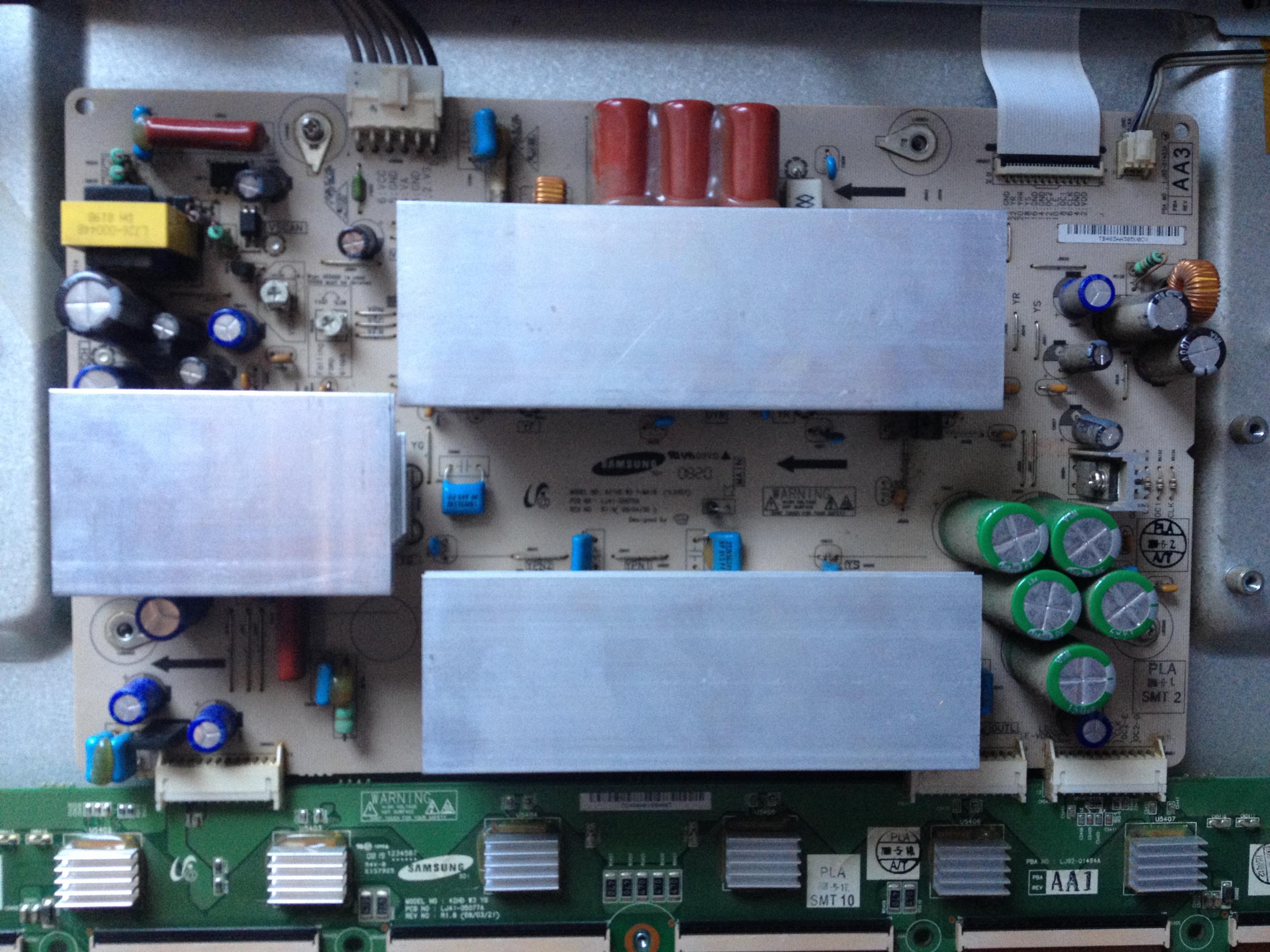

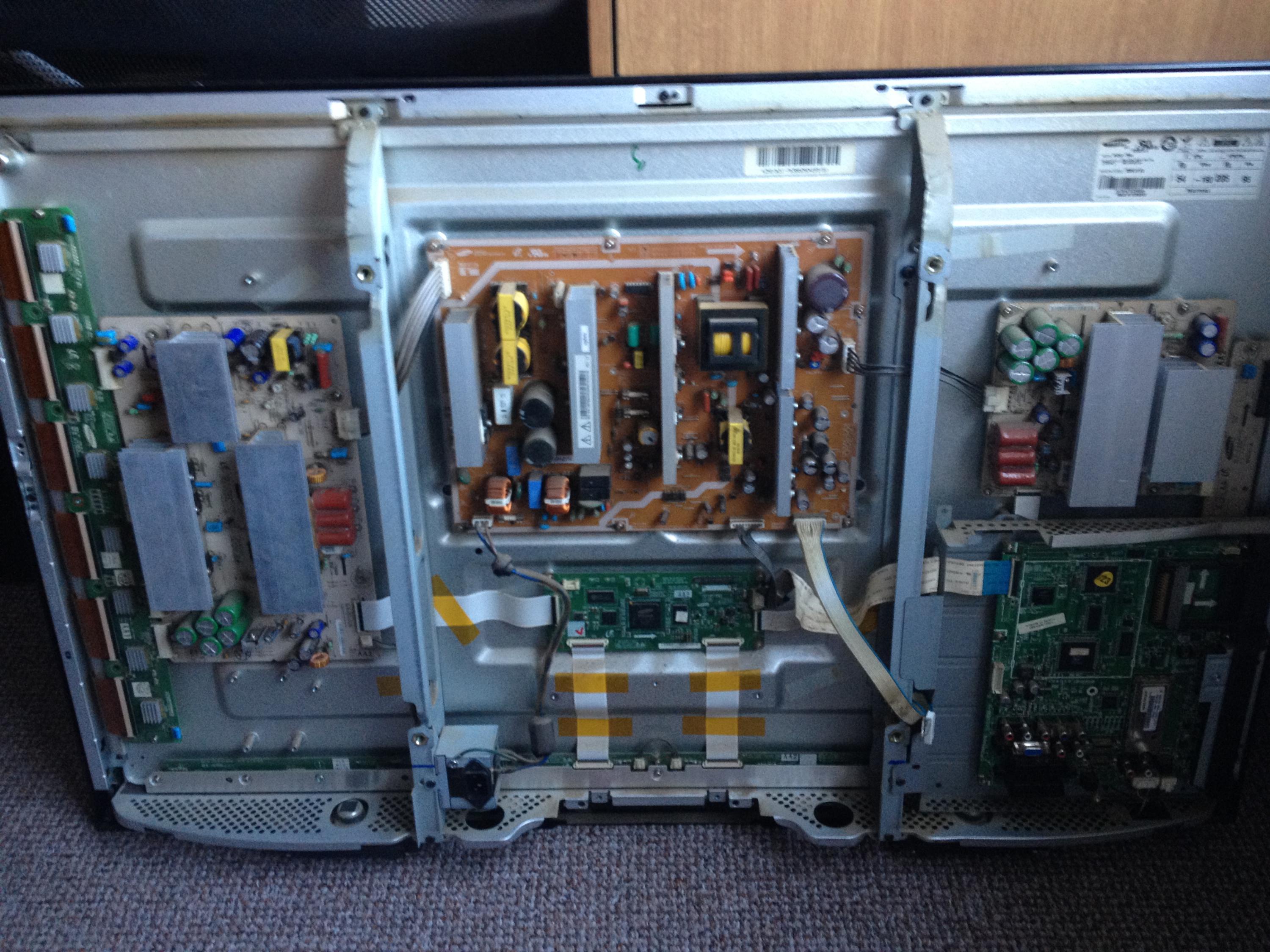

    Hi All
    Just wanted to confirm my diag of this set
    When powered up all comes on hear startup sound however no picture not even a glow

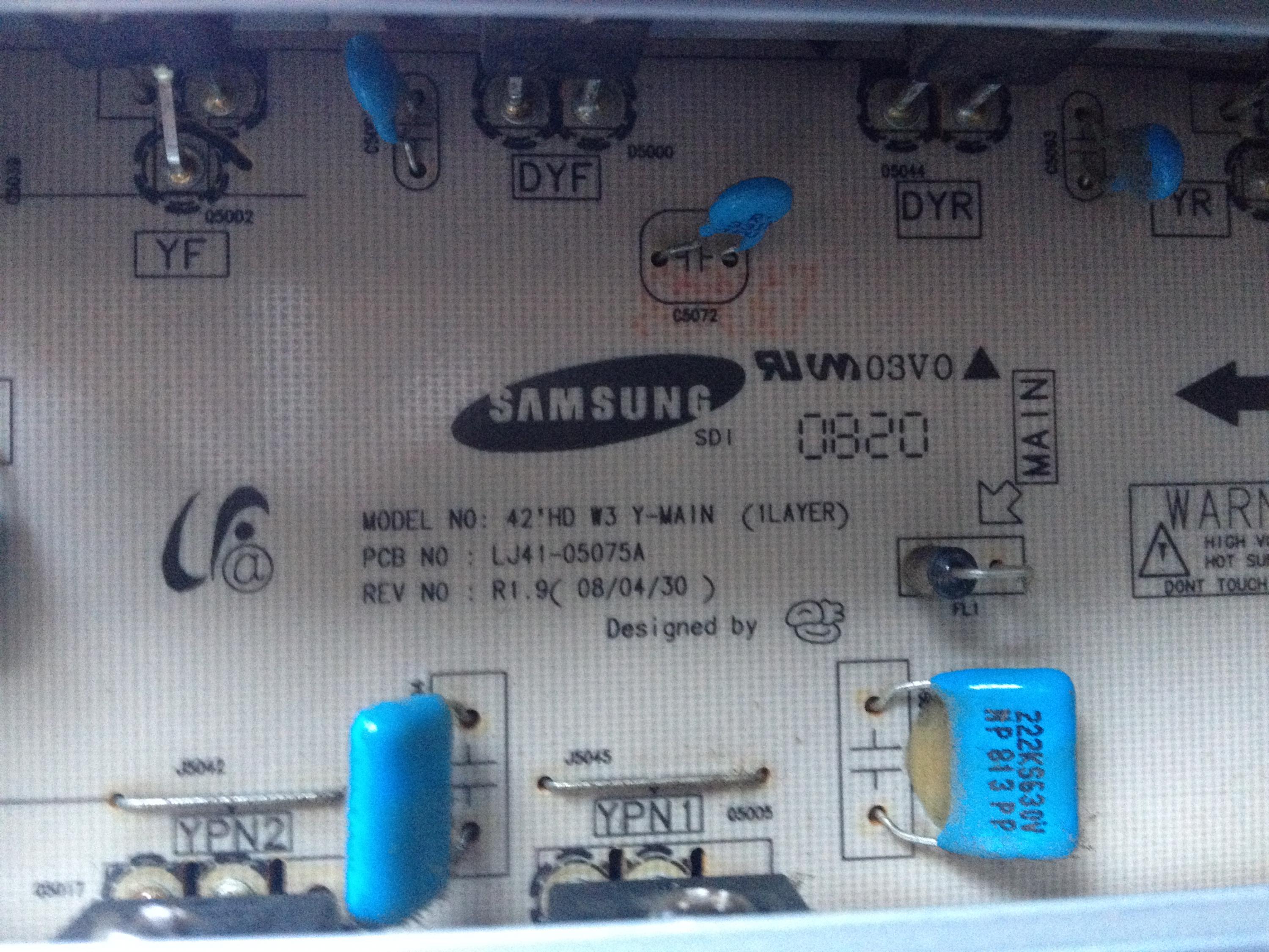

    VS / va votages correct with sticker on PS y ma ininput and xmain input
    No Test pattern when cntrl board jumped again just blank screen
    Checked y main
    VSCH jumps from 25.5 to 28 volts ( not stable jumpin up and down)
    VSCAN is -46v for a min then rises to -158 ( not stable jumpin up and down)
    No shorts on buffers or y / x main
    Correct me if im wrong but this tells me y main is bad my question is could it just be a cap charging problem ? - (all look ok to the eye )
    or could a bad panel cause the voltages to do that ?

    just tried it with panel disconnected from buffers and the voltages on the ymain VSCH / VSCAN still all over the show
