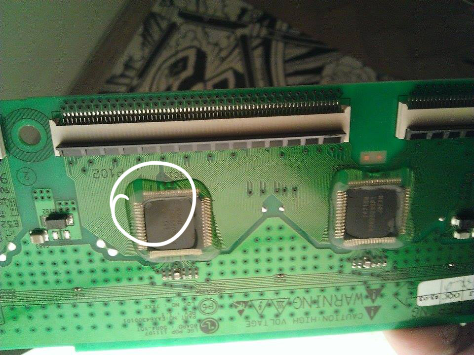

    Hello guys, I'm new to your forum, but I've done some extensive reading already.
    I'll cut straight do the point here:
    My set gives me no picture, sound is working, but If I remove upper buffer completely, I'll get picture on the lower half of the screen.
    Part number for the upper buffer is EAX64300101, it's used in other LG plasma sets too.
    There's only one visible problem with the top buffer: IC chips got slight "dark" mark in the corner, but it doesn't smell burned at all and I've seen couple boards online with this type of darker corner, so I don't really know.
    What do you guys think? It's it sole upper buffer failure or is the panel dead?
    (everything else seems to be in order, no bad caps or fuses)
  • MagicSmoke
    • Feb 2011
    • 275
    Re: LG 50PM680 No picture, sound working
    Watch this video to test your buffer. The chips can fail with no visible damage.

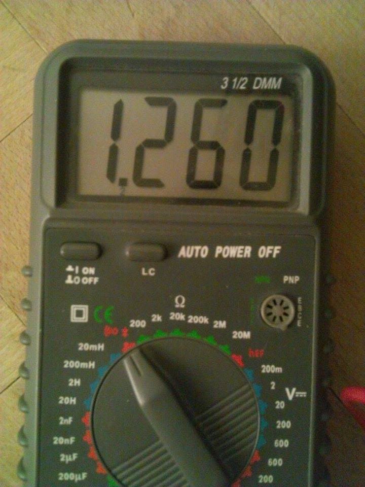

                Alright, that makes sense actually, the upper gives me close to zero both ways on couple pins.
                This is the resistance on the lower buffer. Upper gives me half of that on all pins, except for couple pins on top, which gives zero both was.
