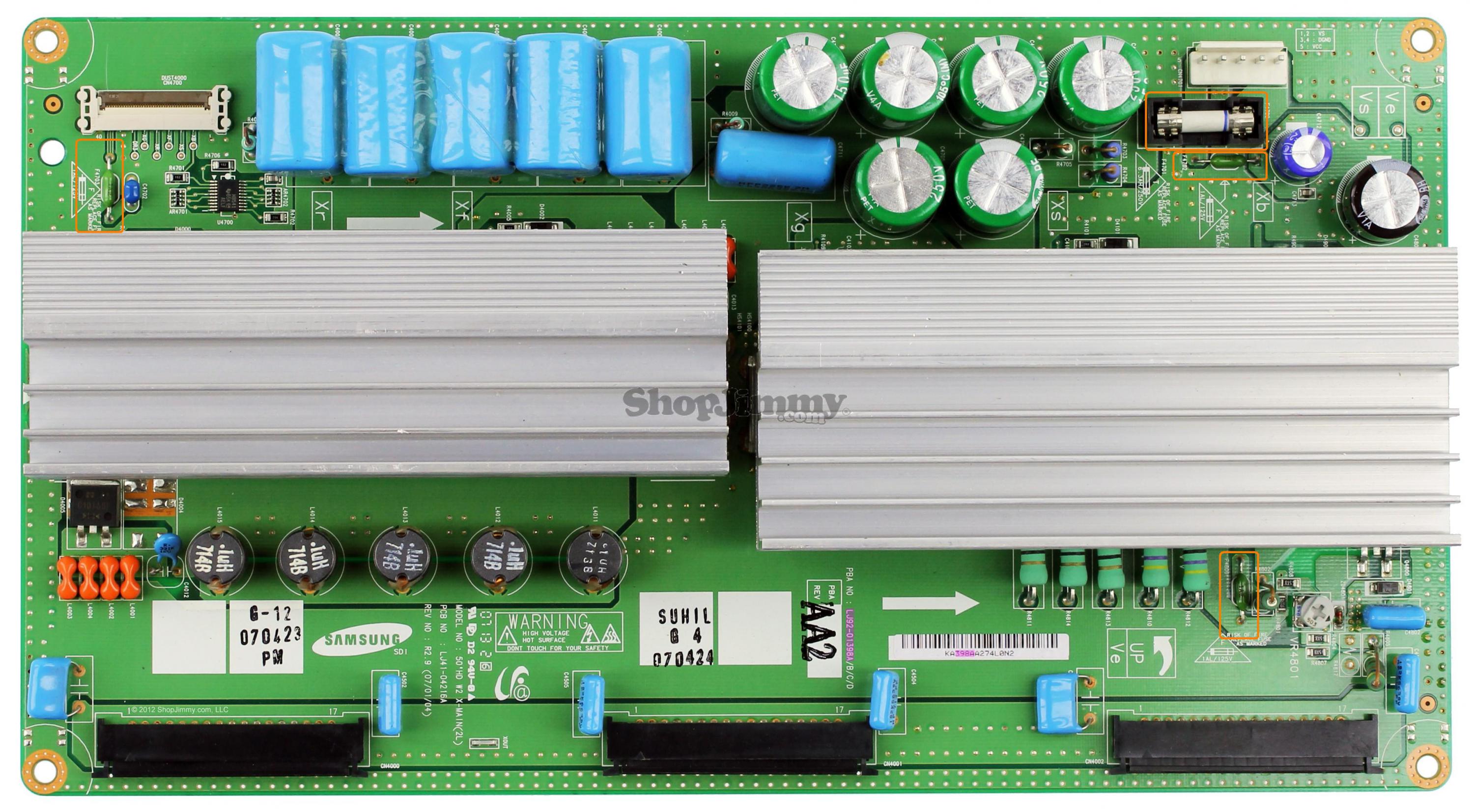

    Got the no picture fixed, but now on power up this happens. (1 min video)
    https://www.youtube.com/watch?v=xSewl8OINrA
    It will go away as it warms up, but even on highest brightness setting display (static, no antenna) is still kinda dim.
    Searched for a thread with this problem, but not sure how to describe it. It's like a curtain rising or ?????
    Would this be a X or Y main problem,Y buffers or bad screen. Checked all volts and they are right on what panel sticker indicates.

      No have not replaced anything yet. Found in dumpster w/ repair tag that said no picture.
      Tested all volts, VA, VS , Vscan and VE. all match with sticker on panel. All other volts match legends on PSU, 5v, 12v,etc. and they are stable.
      Reseated all of the ribbon cables and power wires and got the static on screen but with the problem shown in the video. The black curtain rising. Checked all fuses (good) No obvious bad caps or other components.

            if not bright and looking at the video i was thinking xmain / zsus. what boards are in it? samsung or LG?
              Re: Sanyo Plasma Display Problem Dp50747
              Everything is Samsung, panel, X & Y mains and PSU. Not sure on logic and main boards have not looked at them.
              I did find one vid on utube that showed a Sanyo with a dim picture and was fixed by changing the fuse on X main.
              Fuse on mine is not blown though and testing shows no shorted components.

                You said fuse, so is that 1 fuse or 4 fuses you checked?
                Xmain fail on these is rare but I have read one post where one of the pico fuses went open.
                I've marked the fuses.
                With that panel ymain and shorted buffer is the most common fail and also cracked solder joints on the PSu if it's samsung causing erratic shutdowns and relay clicking but that is not what you have here.
                Keep an eye out for bulging caps 680uf 25v on the ymain, not sure what's on the xmain
                same panel,boards and image shown looks just like yours. blown fuse on xmain. did not see or read which fuse though.

                  Have to agree with X-main looks similar to low Ve voltage on X-main side.
                    Actually the fuse was mentioned in that post. The pico fuse right next to the ceramic where the power inputs are. F4702 1A 125V pico

                      Thanks for that info tw2005. All I checked was the large main fuse. Did not know about the other pico fuses.
                      VE volts measured at test point on X main reads what sticker says. Will retest fuses.

                        Checked other 3 pico fuses on X main and none are blown. Changed the 680uf 35v cap to a 680uf 50v.

                          I've never seen those capacitors go bad on a sustain board. They're not under any significant stress.
                            Can 1 bad cap cause what was happening??
                            I put X main back in after changing the cap...... and lo and behold no more "curtain of black" Picture brightness is good, seems to be up and running.

                                Oh, nice surprise, so are we talking about a 680uf cap on the X?

                                  Edit, Yes the only low voltage cap on the X board. 680uf 35v.

                                    Cool, yeah I have a new x here from working on a couple in the past, I did not bother to check what caps it had but I know those on the ymain do bulge and cause issues.
                                    Can't say that was my expectation here but only mentioned it because I saw the smaller cap in the image and wondered.
                                    I guess it showed no physical signs of being bad?
