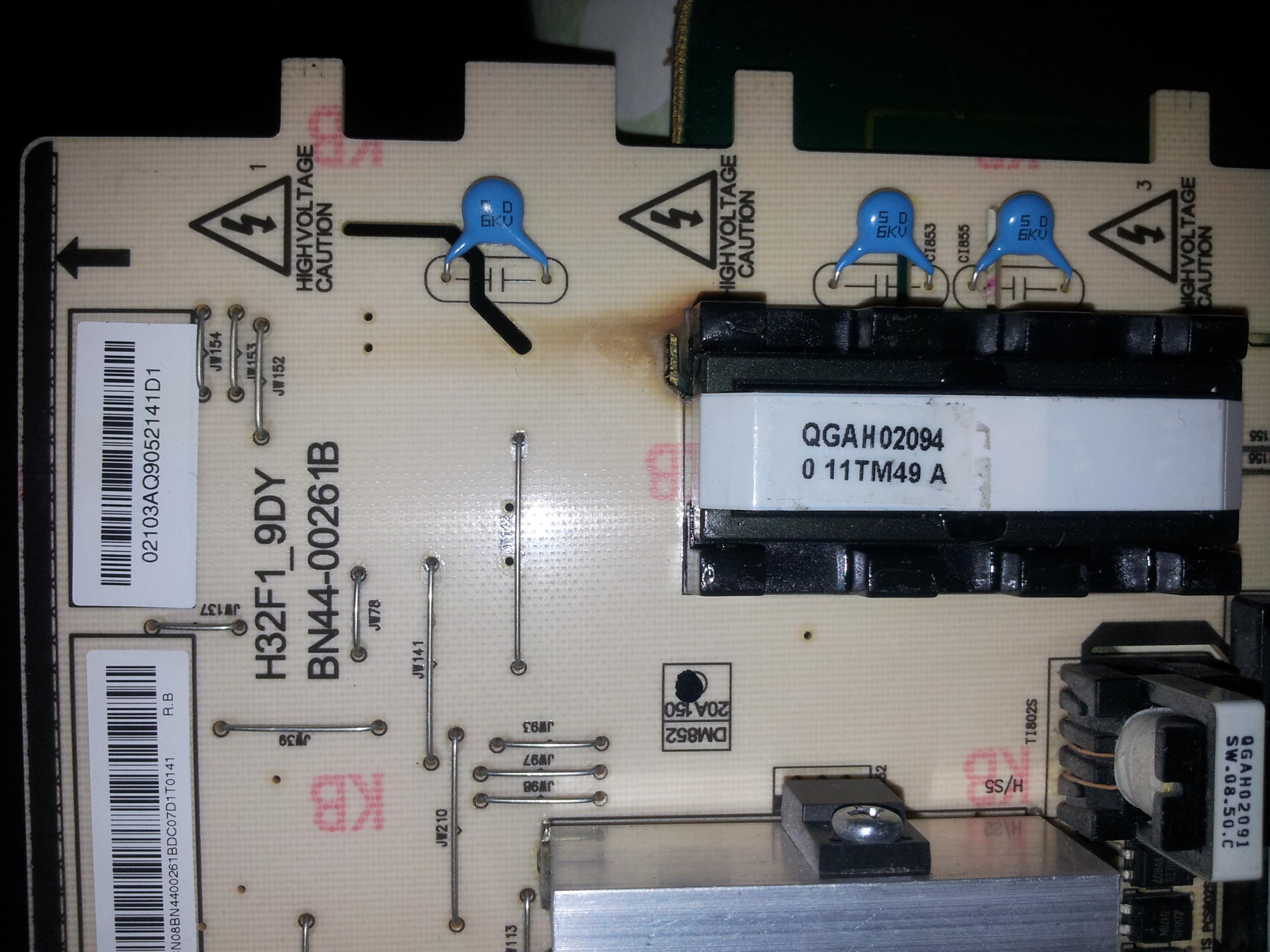

    TV received with a dark band across the top, picture fine - backlight issue.
    Tested ccfl xfrm and replaced after finding differences between the 2 on the board.
    Replaced transformer QGAH02094 NY0903FB with QGAH02094 0 11TM49 A.
    Had it on for an hour and had a burning smell, thought it was burning off lacquer from the new xfrm, but now when turning tv on it smokes and almost immediately after turning on.
    Could just be a dodgy xfrm, ebay seller immediately refunded, no questions or fuss, did advise could be fault on board causing this.
    Anyone had any experience with these xfms?
    On inspection found the HV output side burning/smoking and the resistance is way high,

    Re: Samsung LE32B450C4W smoking ccfl xfrm
    Photos to follow along with a few quick tests.

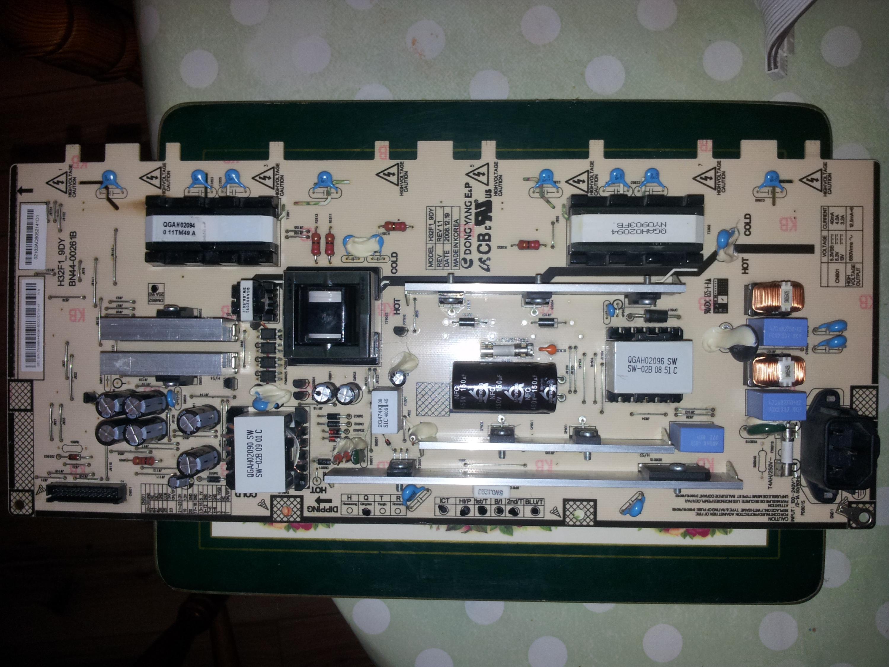

        That would be a reasonable elimination.
        How about a picture of the power board?
        Maybe the transformers are different parts? Check schematic, if available, to be sure.
        Are they driven from the same power electronics (transistors, etc) and is it a 24V inverter or high voltage (primary side powered, danger of electric shock etc.)

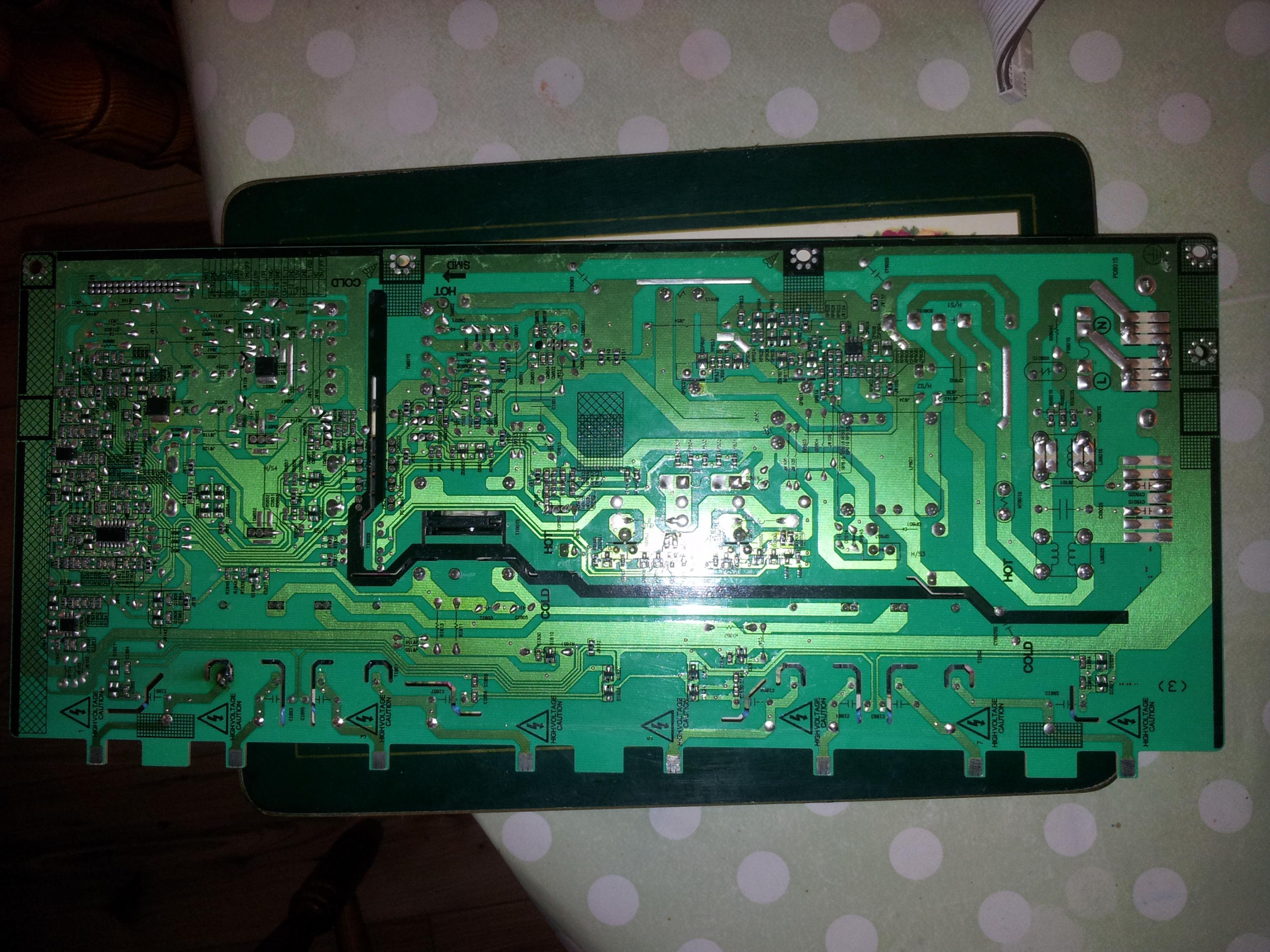

          Photos

            On COLD side of xfrm QGAH02092 SW , so must be driven by 24v.
              It appears to use a transformer to drive the transformers. TI9015. That creates the pri-sec isolation. Not a 24V design though.

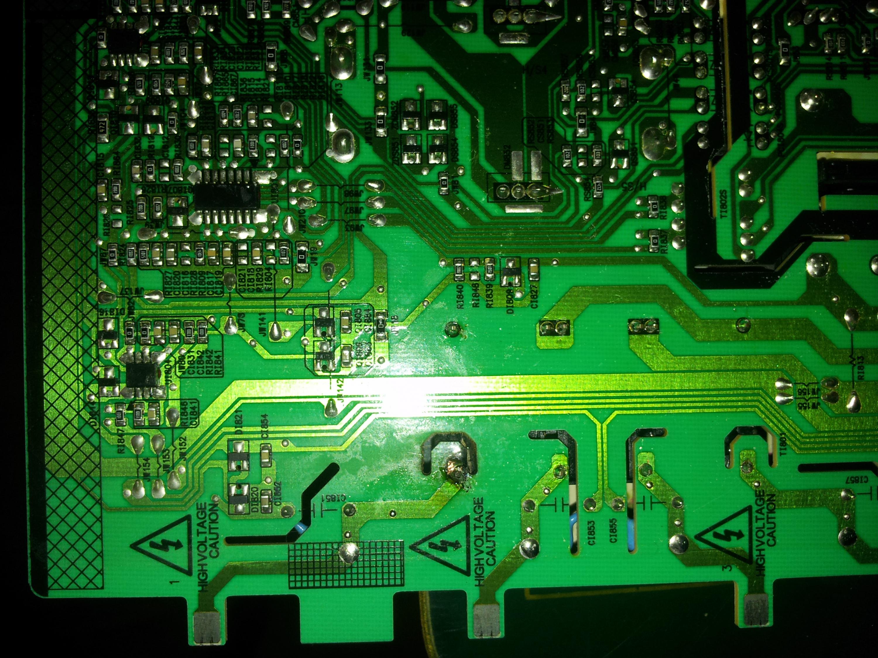

                    I ran into two of these setups and the lamps were bad, it has blackened ends (you can see red glow at the ends inside the lamps) and draw lots of current even though the lamps still light up. I would inspect the lamps real well also.
                    • Shinju
                      • Mar 2014
                      • 1239
                      Also these boards are known for bad soldier joints on the aluminum rails so I would check for that too.
                      I have repaired several of this style of PS/INV 4 to 3 to 2 transformer types. All of them have had at least 1 loose connection.
                        Looks like a dry-joint on that Tx leg caused a burn-up.....
                          Thanks for the replies.
                          Was hoping not to have to tear down the bl panel but may have to just to be sure there are no bad lamps as suggested.
                          I believe the solder joint to have been made good as were the others though possible I may not have made a good enough job on that joint and caused the issue.
