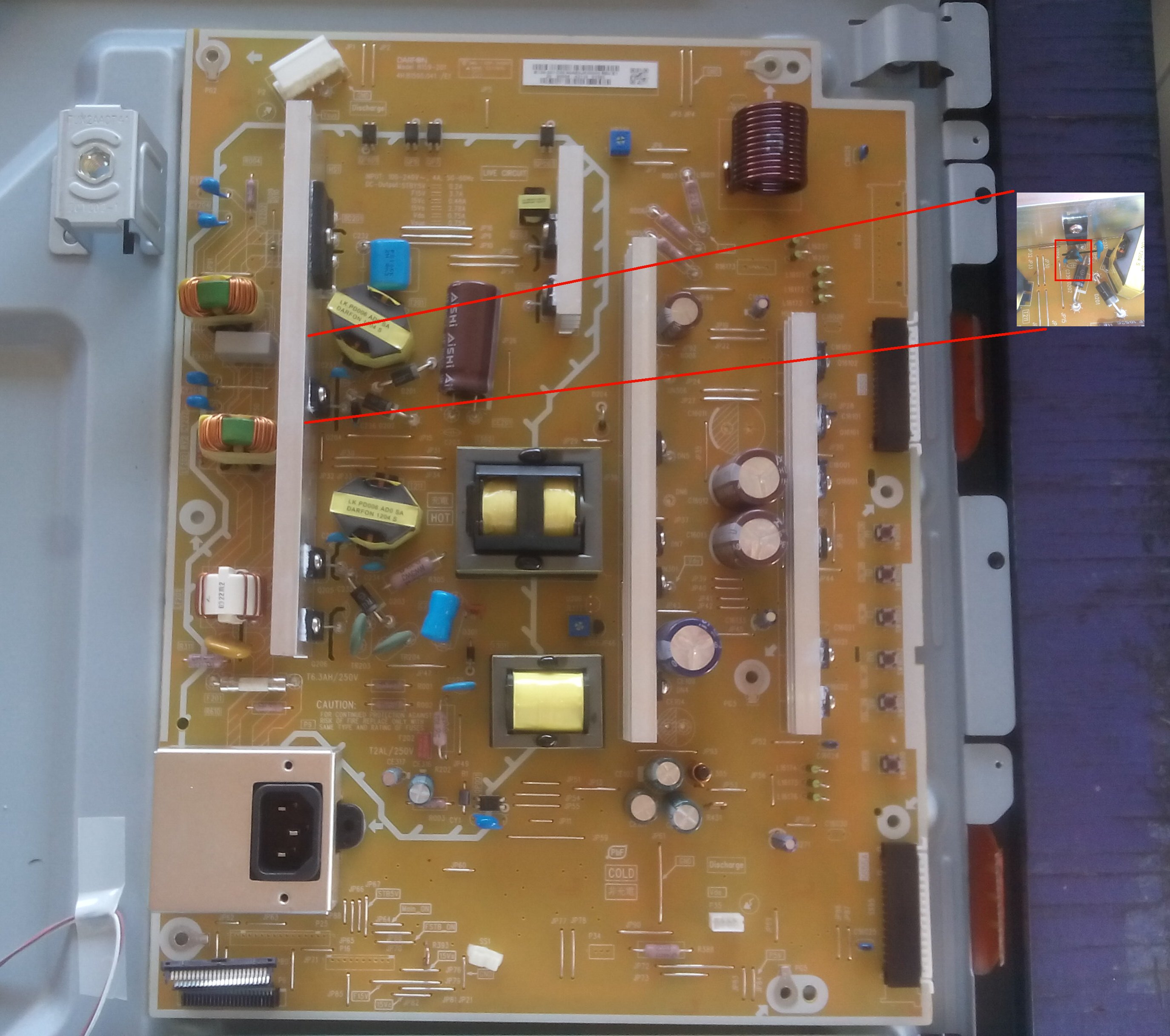

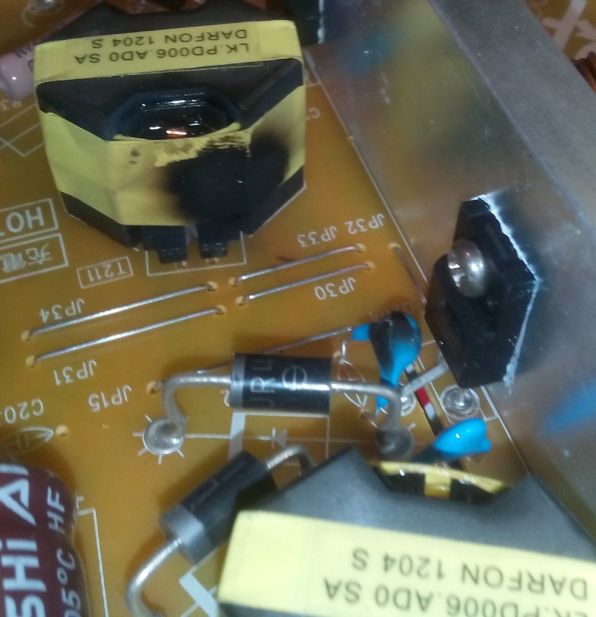

    Must be a bad month for me and Panasonics... I have a 42" that has taken up smoking.
    You plug it in and the marked part starts smoking like a chimney...
    The old me would have just replaced the board and be done with it.
    The new me wants to learn to fix and save $60 in the process..
    Any help would be appreciated...
    EDIT Mistake on SUBJECT.. It's a TC-P42X5... My bust...

          Thats a ceramic cap--prob several hundred puf, rated prob at a 1KV or so.....
          Check that transistor on the heatsink for issues, but its probably just the cap...

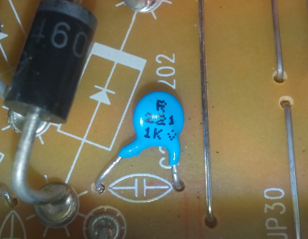

              Capacitor on mine is 221K = 220pF

                  Forgot to mention it's 1kV rated.

                    Well, I found a 221K Cap.. Put it in..
                    The good news is, it's not smoking..
                    The bad news is, it does nothing. Power light comes on RED, I hear a relay click and that's it.. absolutely nothing gets to the screen...
                    So, I am thinking there is more damage to the board...
                    Is there a +/- on that cap???

                              OK, back on this... I inspected the area a little more closely and discovered some more charred spots...
                              I cleaned that off and it appears that it was just residue from the capacitor, not any burned or damaged component...

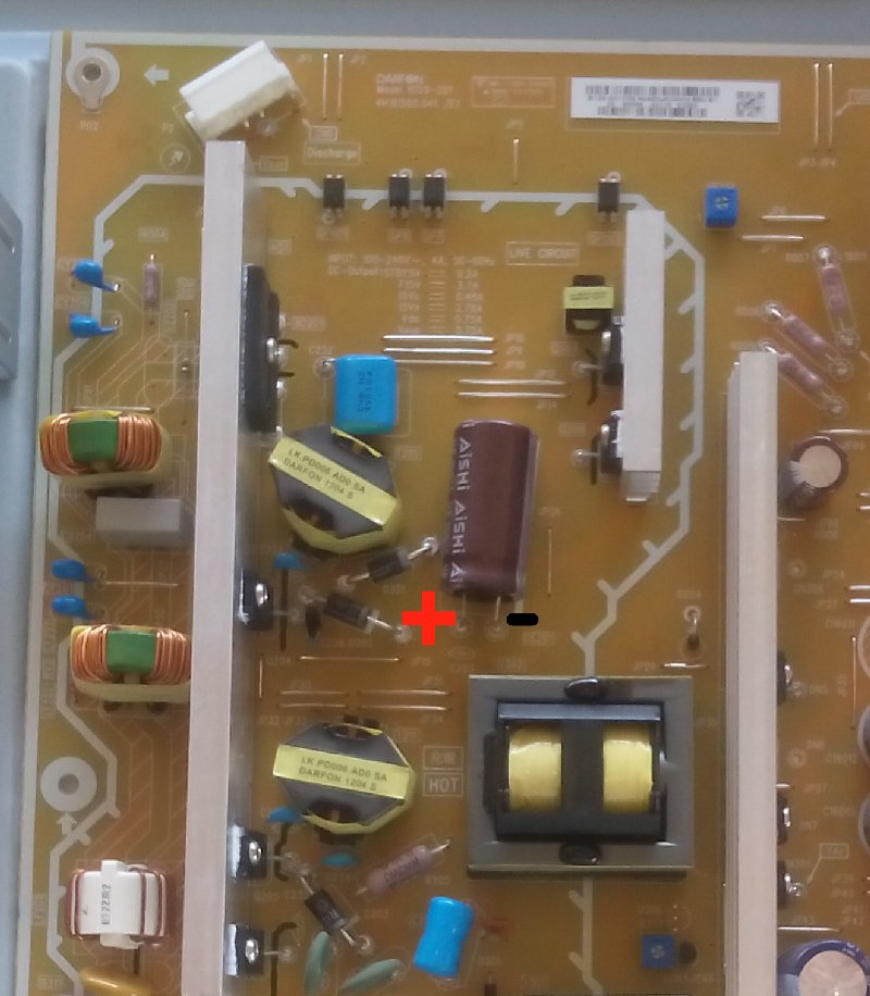

                                Just so I make sure I am doing this right...
                                At those points with the meter set for DC...
                                Sorry to be so anal, but I want to make sure I am doing this right..
                                Also, as an aside..
                                From experience it appears that the biggest danger in working on Plasmas is not the voltage...
                                It's the frakin' sharp edges of the metal cases!! I musta dropped a quart of blood so far....

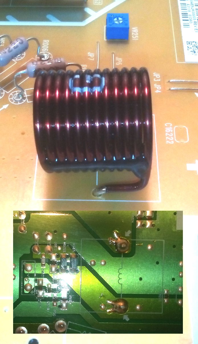

                                  I wonder if that inductor is failed. Check it doesn't have open windings on its two pairs of windings (will be obvious on the bottom of the board - if unsure post a picture)

                                        Here is a pic of the cap I put in...
                                        Tom,
                                        Not sure what you mean by windings, but here is a pic top and bottom of the (what I think is) the inductor...
