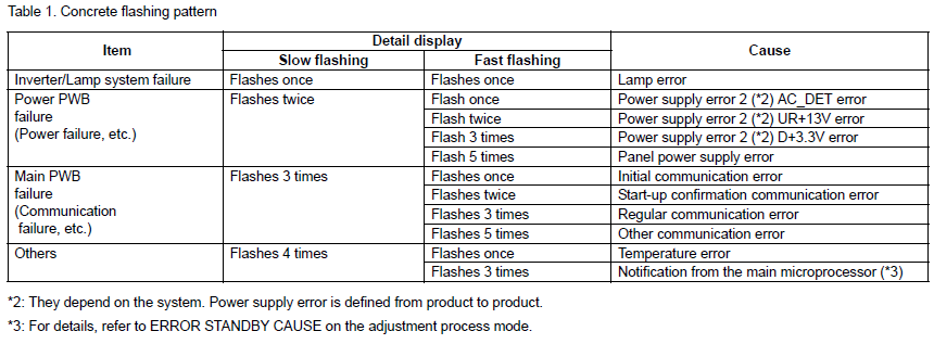

    I have a sharp lc 80le642 , no power at all. Ive tried forcing the power by holding the power button and plugging it in, All I get are 2 long blinks and 3 short blinks.
    Any ideas

    Without back cover off, and pictures don't think many can help?

      Here is the error chart from the manual
        thanks
        that is what I was looking for
