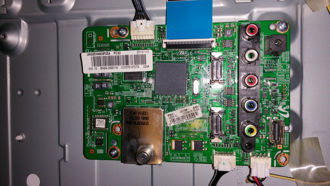

    Re: SAMSUNG led un32eh4003f Plays melody No picture & led blink
    Need photos of the insides of your panel, these 32" seem to suffer from a bad short in the LED strip but with out photos one is very limited on helping you troubleshoot.
    Post them and then someone will jump in and help you out!
        Well, so you see the video, so did you do as the video has shown to find out if the power supply is OK or not to at least narrow down as to which board is the problem?
        Did you look inside to see if the boards are exact the same? There are more than one versions of the boards inside that TV for the same model number as you can see here:
        http://www.shopjimmy.com/catalogsear...q=un32eh4003f+
        And since we do not have the TV and the boards in front of us, good clear pictures are required.

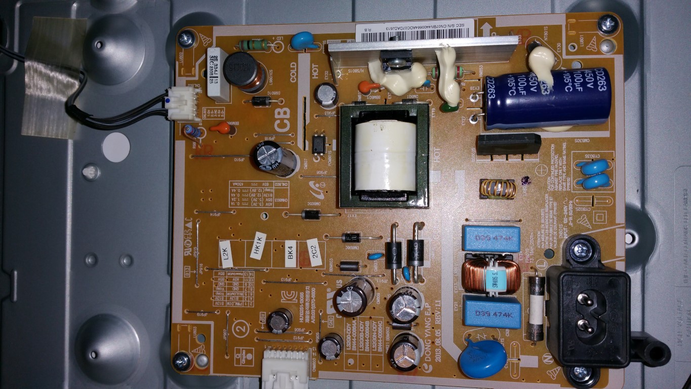

            Do you see the two white connectors on the power supply/LED driver board?
            There are charts that show what each pins are, we need each pin name and the DCV reading of each pin when TV is off and when TV is turned on.
                Look at the charts as printed on the board, black probe on the chassis and red probe on each pin one at time. Make sure to give us pin names also beside the voltage reading.
                Take the reading of all the pins.
                Do you see the charts?
                BTW, I will not be surprise if it has bad Bacxklights LED, very common failure in TV using LED Backlights.
                    Pin 6 BLU-ON is the backlights on command signal from the main board, >2.5VDC = Backlights ON, <1VDC = Backlights OFF
                      Ok, here is what I have so far...
                      Large connector - I can only get to one side with the board in. Sadly the BLU-ON is not one I cant reach....
                      1 - 15.28v - B13v
                      3 - 15.39v - B13v
                      5 - 15.50v - Vamp
                      7 - 15.59v - Vamp
                      9 - 0 - GND
                      11 - 5.46v - B5v
                      13 - 5.47v - B5v
                      Small connector
                      1 - 211v - D+
                      2 - 189v - S-
                      3 - 0v - N/C
                      4 - 191v - S+
                      5 - 0v - D-
                      If you have suggestions on how to measure that pin 6, I am open to them. I will keep looking at it - but I hope this might put us on the right track...
                      Thanks!
                      Mike
                      • mangus580
                        • Mar 2012
                        • 18
                        • US
                        Ok - got the rest
                        2 - 16.14v - PWM_DIM
                        4 - 16.14v - B13V
                        6 - 6.14v - BLU on/off
                        8 - 0v - GND
                        10 - 0V - GND
                        12 - 6.65v - A5v
                        14 - 4.23v - Power on/off
                        • mangus580
                          • Mar 2012
                          • 18
                          • US
                          So from what I can see, the BLU is getting the ON signal... I am guessing its likely a failed power suppy, or failed backlight.
                          Do my readings give me any indication which it is?
                            "Small connector
                            1 - 211v - D+
                            2 - 189v - S-
                            3 - 0v - N/C
                            4 - 191v - S+
                            5 - 0v - D-"
                            That looks like the LED driver circuit is not seeing any load (open connection or LED failed in open circuit).
                            I say you have bad LED open connections in the LCD string. Looking at the bottom side of the board, it looks like it is just one string of LED (all LEDs inside are connected in series like Christmas lights).
                            http://www.shopjimmy.com/samsung-bn4...led-board.htm#

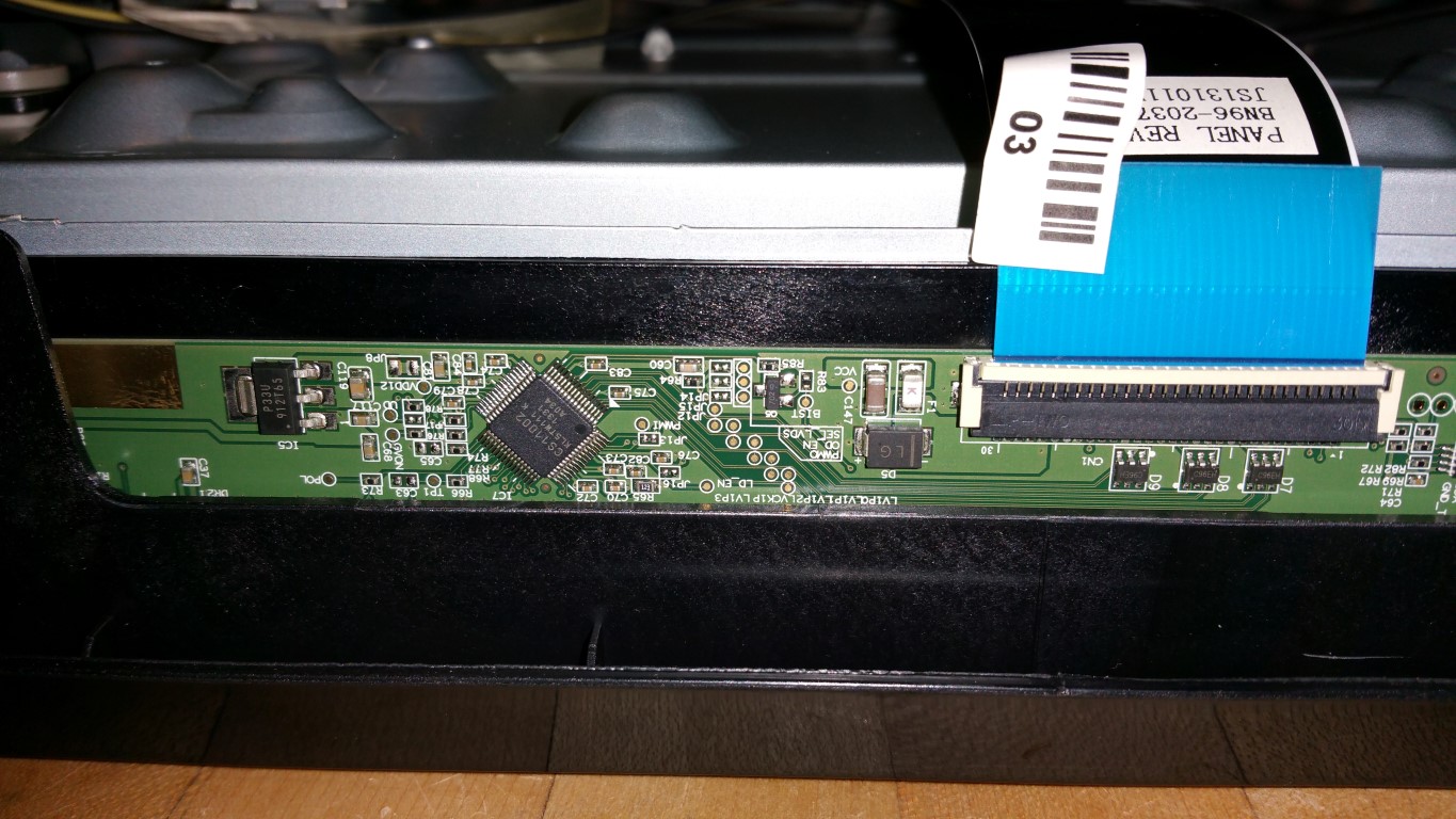

                                Found the LED strips! and I am into them as well.
                                So based on what you are saying, i should buy new LED strings. Its interesting, as they are 2 strips; a pair of wires for each.
                                I guess worst case, I need the LED's and the power supply both?
                                Looking at this - does the power flow go D+ -> LED1 -> S- -> S+ -> LED2 -> D-
                                Its the only explanation I can come up with, that would, that provides how both strips are out - unless the PS is dead.
                                  You can test each LED to see which one is bad using 3V battery and 100 Ohms resistor.
                                  Can we see the pictures of the LED assembly?
