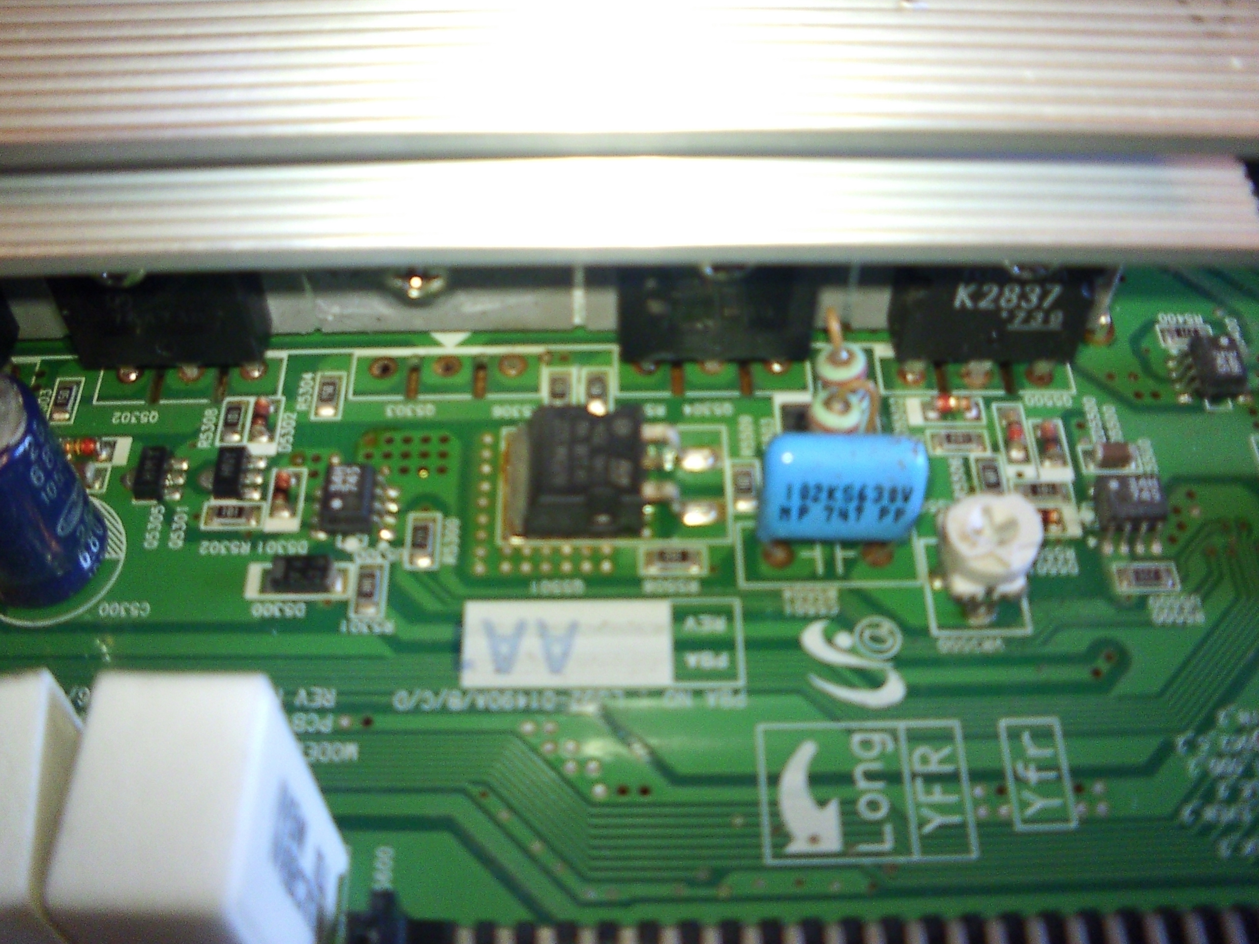

    Currently anymore testing will have to wait. I've tested out of circuit most of the MOSFETS so far and already found 2 that where shot. I did find two repair kits via eBay. (I love shopjimmy as well, but I didn't see anything this time around for this, other then out of stock of the board and the mosfets)
    http://www.ebay.com/itm/SAMSUNG-Phil...item1e8e17e9c8
    That seems to be a deluxe kit.
    That one only states contains 6 mosfet's--and does not state which ones.
    On the right side of the board is a row of very large red capacitors. Behind them are a nest of RJH3047. Anyone know if these also are prone to failing? I don't mind digging them out to test.
    The rest of the testing will have to wait. I have the two blown parts off the board until I can order in either the 2 chips alone, or the repair kit. (And maybe more parts if there's a good chance the RJH3047's need to be pulled/tested/replaced)
    With the two blown mosfets--Collateral damage--I know those two are blown. Sense I lack a schematic--Are there any other parts that are known to roast when these fail? Makes me wonder a bit due to the repair kits. One kit just contains the 6 mosfets. The other kit contains 11 semiconductors and a couple of caps.
    Sorry if this seems a bit of a ramble.

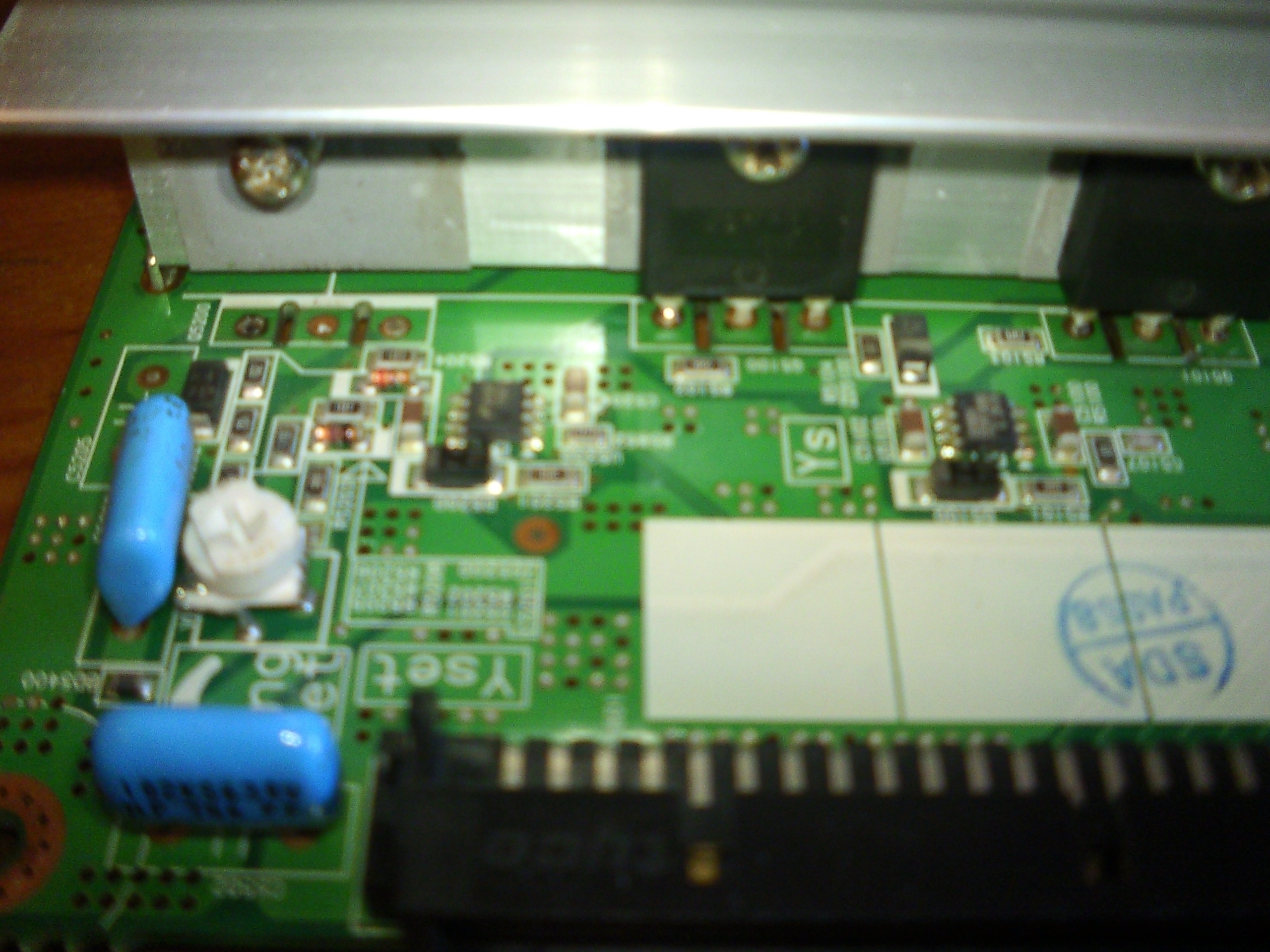

        Have not done any surface mounted FET's for testing. (This is my first venture into plasma sets and there's not a lot of schematics for this.) If that is what you are asking. I can supply more pictures of the board parts if that would help id where/what to test. (granted it would take a while to get the uploads LOL... This server hates me)
        1 known bad 88n30w
        K2837--I triggered this doing a standard MOSFET test out of circuit. When I triggered the gate the drain kicked 'on' as expected with low resistance on the diode check. Then for some reason--and this might be normal?? The resistance crept up quickly until it was back to an open circuit. I figured I might have a finger where it shouldn't be for the test. So I held everything in a rubber clip--and it did the same thing.
        The other K2837 acted like a normal mosfet should have. So I figured it's toast.
        Now there is a row of red capacitors along side the heat sink on the right. Sadly my iron went *poof* with the tip roaching. Do these go bad, or are they pretty well 'safe'. From what I've found, the one kit addresses the row of mosfets along the same side of the edge connector that goes to the buffer boards. (That's the cheap kit) And the deluxe kit does all of them.
        Just trying to do this and keep a budget in place.
        The two blown capacitors, I have on order and they will be here tomorrow. I can afford to order in the cheaper kit from eBay and just replace the two bad parts--and hold the rest for future use. I can't really see spending over $50 for the deluxe kit. Considering I'll have to spring for a replacement buffer IC...This is quickly hitting what I can afford to spend on it.

          I wouldn't be concerned with those red drop capacitors as they rarely fail. If a k2837 tests.with no short it's probably ok. what you're looking for is a MOSFET on the Y mainboard that is shorted as in 0 oHms. black lead on the middle leg red lead to each and leg if you get 0 ohms in either direction or even one direction I would suspect

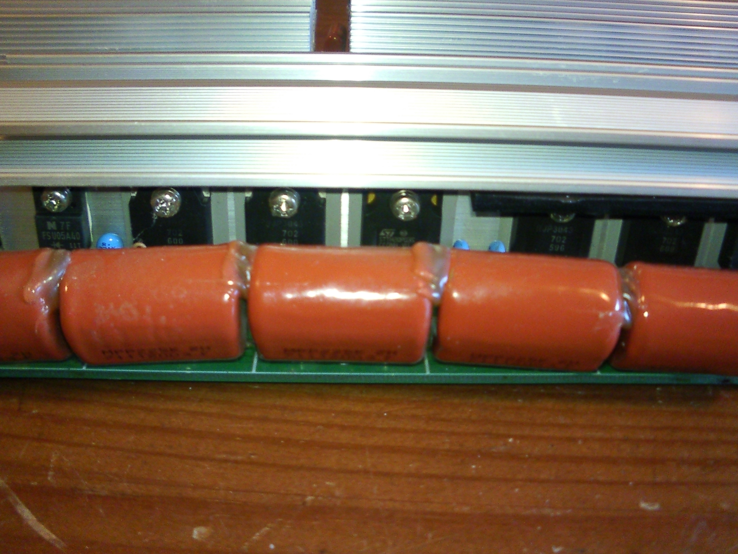

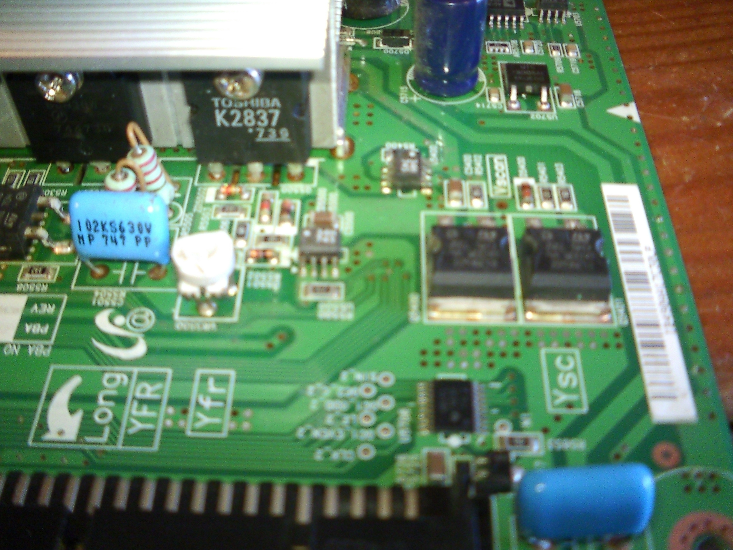

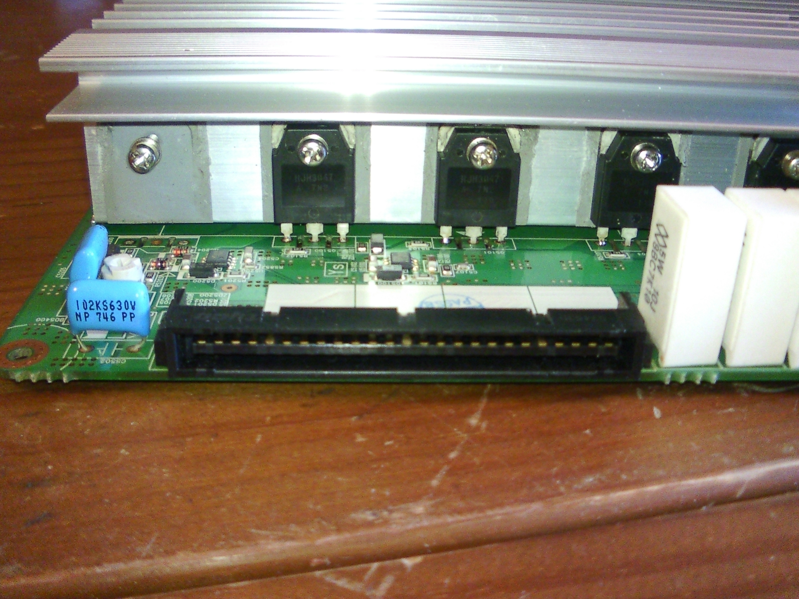

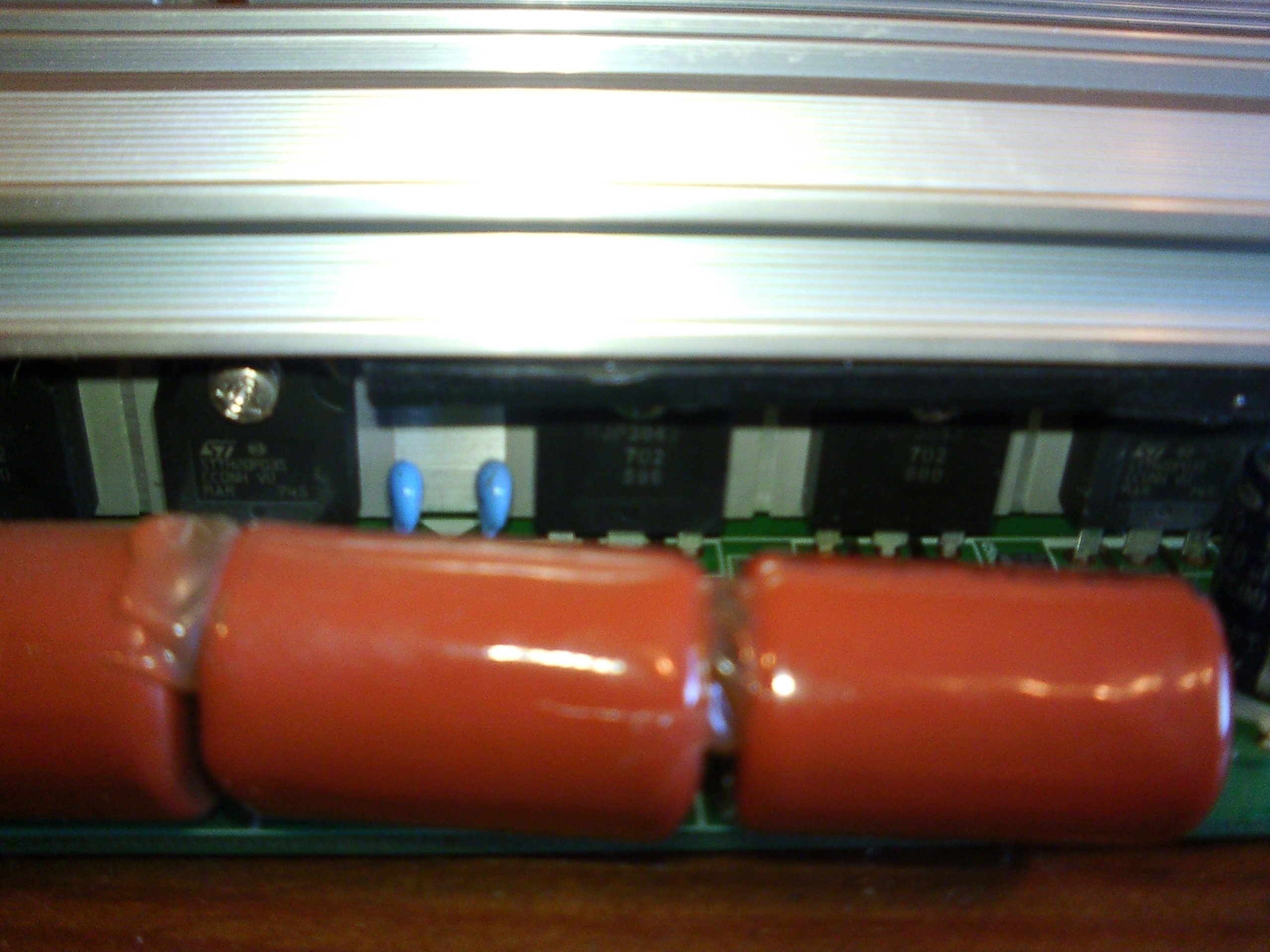

            I think the server gods must be taking pity on me. (just got back from having a wisdom tooth pulled out by an oral surgeon....took over an hour doing it..and over an hour waiting for my cardiologist to give clearance for the procedure.)
            Sense the server seems to want me to upload photos.... The ones behind the red caps. Those I'm wondering about checking in circuit, because they are in a PITA location.
            The ones across from the edge connectors have been checked. And the missing ones are the ones that failed testing.
            Can anyone, using the photos provided (and I can probably get more if needed) let me know of any other support parts/circuits that need to be checked? Such as mosfets normally have a small driver transistor that tells 'em when to turn on and off. Any such beastie on this, and can anyone let me know where and how to test?
            I have to hold off for a few days before ordering in more parts. The two capacitors with a severe case of "Chrome Dome" will be replaced tomorrow when they show up. The rest of the parts? I might have to bite the bullet as a few of the numbers are kinda elusive to find with the company I've been using locally.
            Feel free to "Ring my phone" so to speak. I'm here curled up waiting for the lideocane to wear off (or however ya spell it)

              I'm thinking along the same lines, this may be a very simple 88N30W replacement .

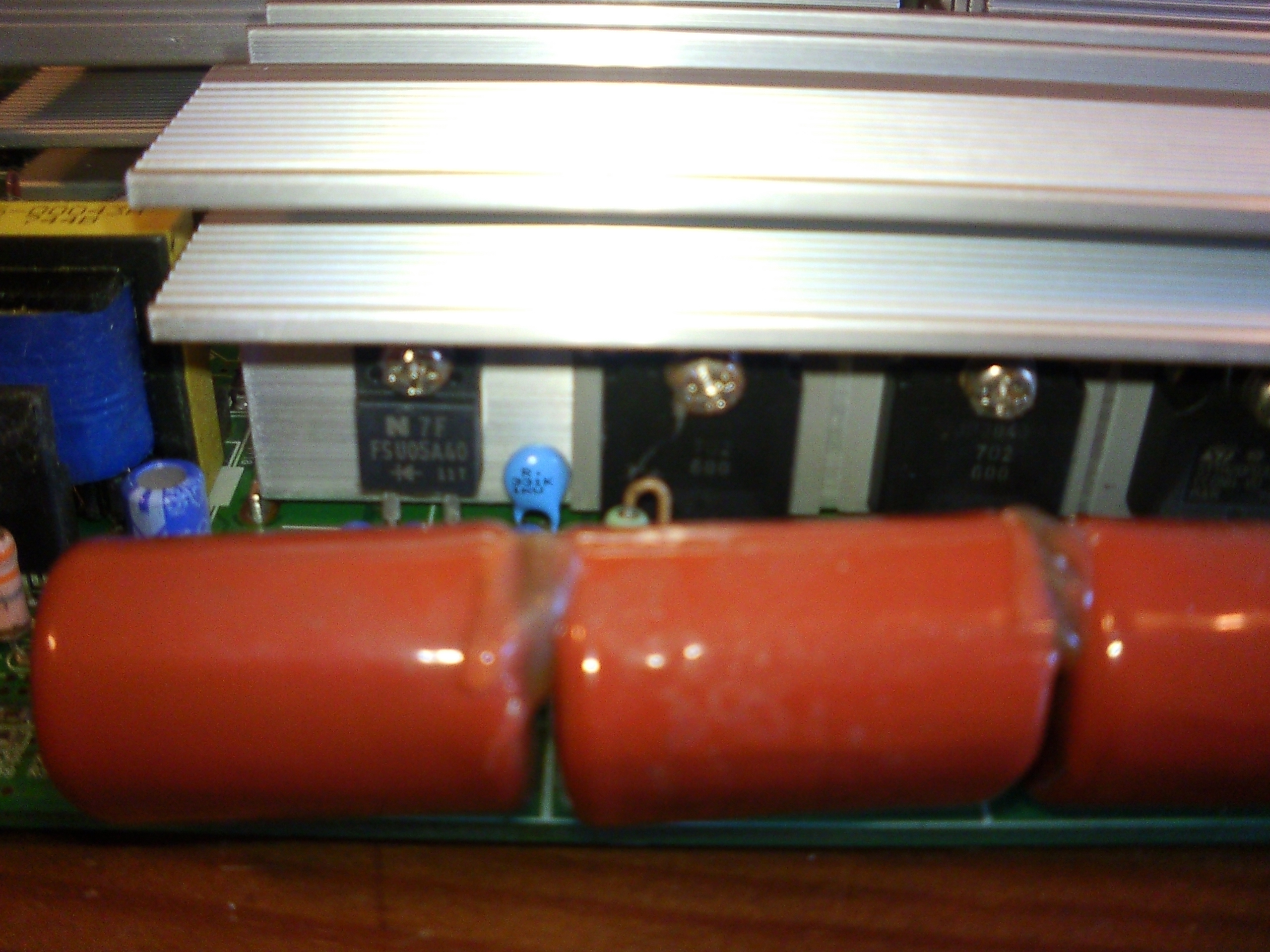

                The SMD FET i was referring to, is in pic 5. I was hoping since there are'nt many on that board and the part number I gave,you may have found it.
                I've only had a fairly simple approach to these. Inspect looking for burns, I think sometimes the resistors near the outputs burn, bell out all the fuses there's also some small green pico apart from the obvious , check diodes and fets for shorts, remove what's shorted, confirm out of cct.
                I know if 1 88N30W shorted, shorts the rest in cct but I have had one board with only 1 bad and that was the only part needed. So with the bad 88N30w removed , I assume no more shorts exist in that bank of them, and sounds like the 2SK2837 is not shorted.

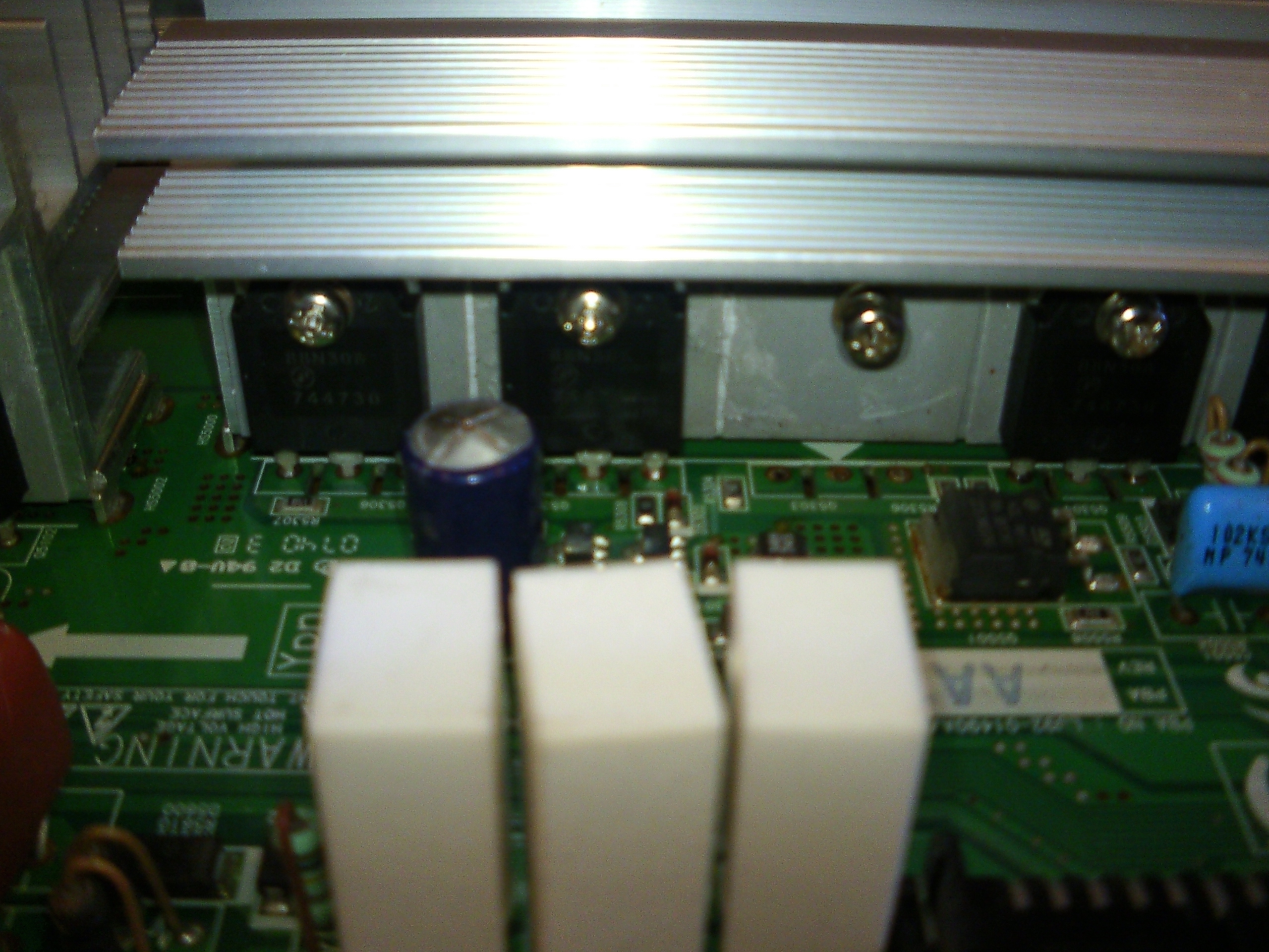

                    Minor update of sorts. Tested a couple of the mosfet's on the side with all the red capacitors. Thankfully the circuit seems to mirror. So I pulled and tested two from one row. Good. I then compared what those two 'good' ones did in circuit, against the two ones I didn't really want to pull.
                    Okay... That brings me to: B20NK 50Z GK138 VW CHN 704
                    This is the one that was pointed out in picture 5 (Thanks for pointing it out!)
                    Okay. Had to pull the surface mounted legs to test it.
                    It's doing the same thing the K2837 was doing.
                    Black lead on the source
                    Red lead on the drain.
                    Tested in diode test with "OL" This is expected.
                    Bump the Red lead over to the gate.
                    Return back to the red lead to the drain. Triggers the meter with about 1ohm resistance---good right? Maybe......not..... Leave the meter lead on the drain and I can watch the reading climb rather quickly like a capacitor chargeing...and then the meter will "OL" within a few seconds.
                    The trick with touching the gate/leads with the finger will shut the drain off and it will be "OL" until I touch the red lead back to the gate...at that time it starts off at about less then 1...then start to raise up until "OL".
                    Now I know it's nothing to do with the board, I had both leads (source and gate) off the board using jumpers.
                    Now I'm getting really confused. The other mosfet's I tested, except the shorted one and the K2837... All turned 'on' and stayed 'on', until I touched the leads.
                    Is this how it is supposed to work, or do I need to replace this part?

                      My thoughts are if it's not shorted out, it's ok. You may be going a little deep into this. I can only give you my experience and that is they fail short. I have more experience with the Panasonic boards and the IGBTs go short but I have had a couple show 100-200ohms between legs out of cct and they were bad.
