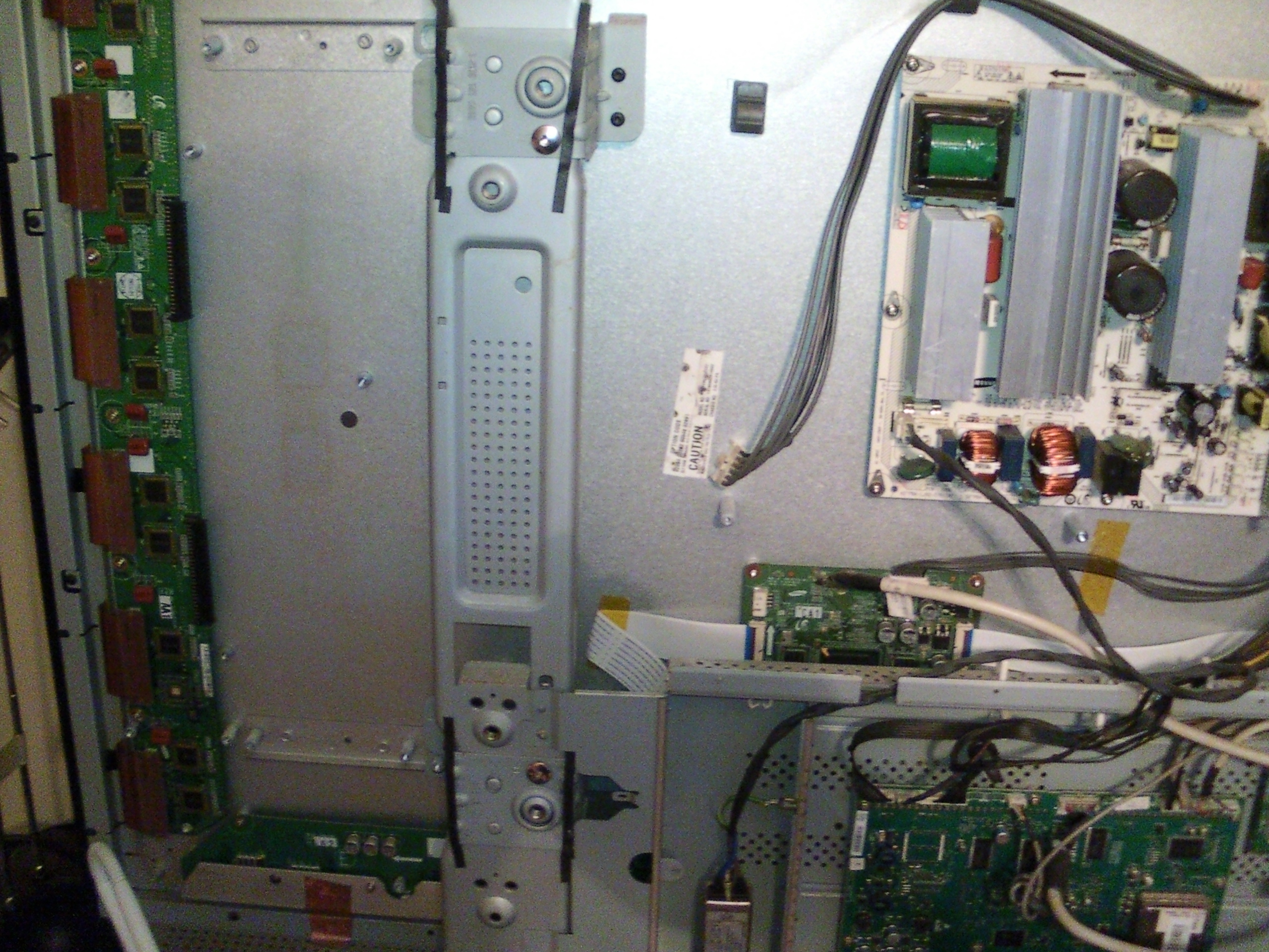

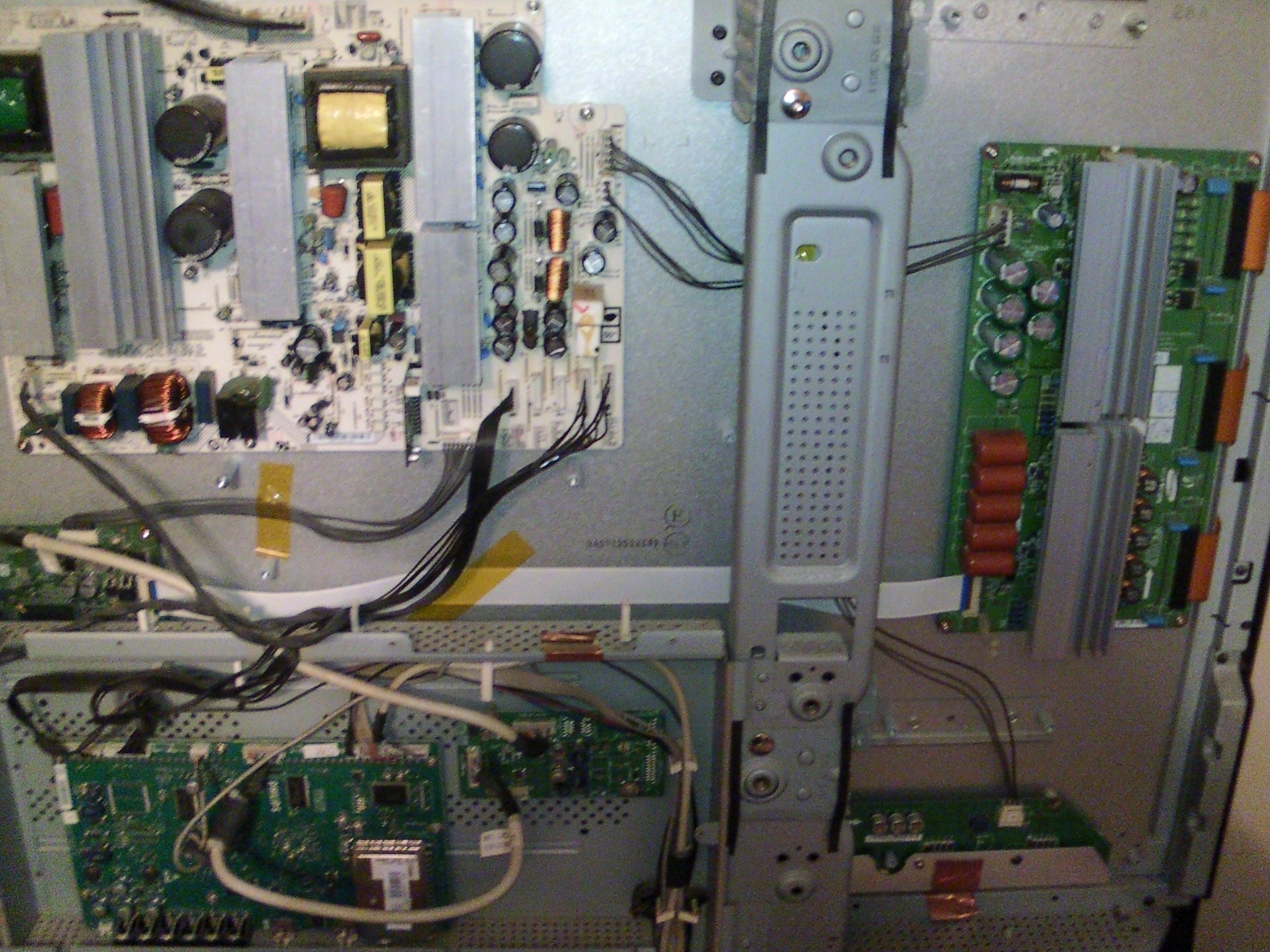

    Let's try it this way.
    Power supply repair seems to have gone well.

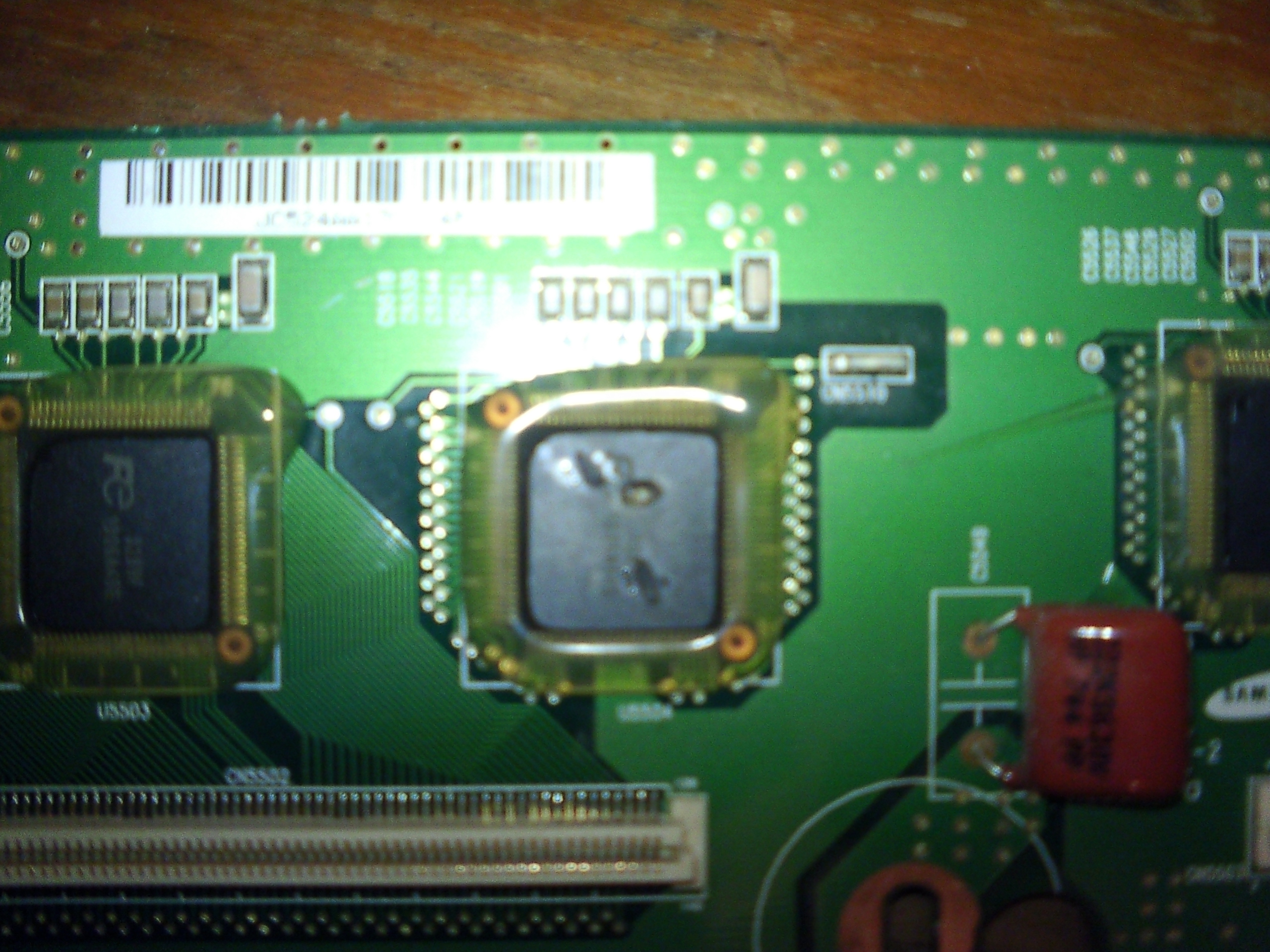

    One of the buffer chips went up in smoke. The only thing on the screen was some flashing white dots/flickers along the same "2 Inch wide" track. Rest of the screen is still dead.
    I did find another blown capacitor on the Y-Board..and I'm a bit P/O'd.

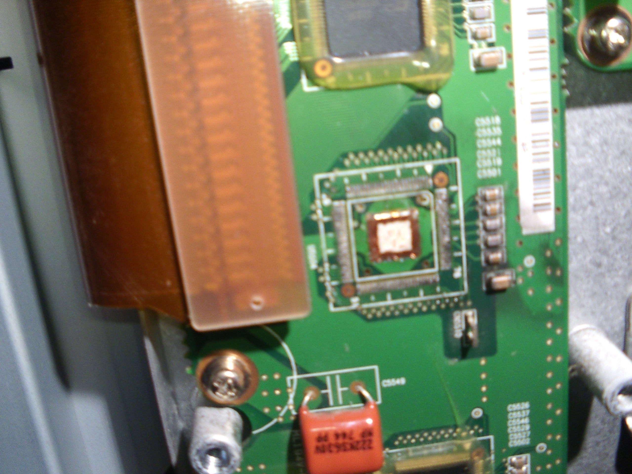

    On the lighter side I did manage to remove the surface mount chip and it's glue. (nail polish remover, exacto knife, and a lot of patience.)
    Chip is 3289F
    Need direction on how to proceed. Do I call this and part out the working boards? Or can I try to repair things.
    Photos attached for your viewing pleasure. The other post seems to be ignored, so let's try with the word "Blown Up" in the subject.

      Honestly I'm not sure what's going on with it.
      The bad buffer board extends down the entire left side of the set (as viewed from the rear) I removed the defective chip and powered the set up. No screen or anything. This is my first venture into plasma sets, so I'm not sure what to expect.
      The lower long board is still attached and connected--as is the smaller board (the 'z' board I believe) on the right side of the set.
      Kinda wondering what I should be getting and not getting. I also unplugged the large connector that the blown chip interfaces with. I would have at least expected to get a picture with a large 2" bar in the middle of it...but nothing.

        Need more pics. Are there not TWO buffer boards in this set ?

          Ok Shopjimmy says this is the Samsung variant which means it has an upper y buffer as well as what looks like the lower buffer in your pics. If you install a good upper buffer and a good y main you should get a pic on the upper half of the screen. There is a youtube vid on how to test the buffers for shorts, maybe someone will post the link for you.
          If there is a green led lit on your Ymain then it will need to be repaired as well. Keep in mind that bad buffers will destroy a good Ymain and vice versa so it's imperative you know the condition of these parts before proceeding.

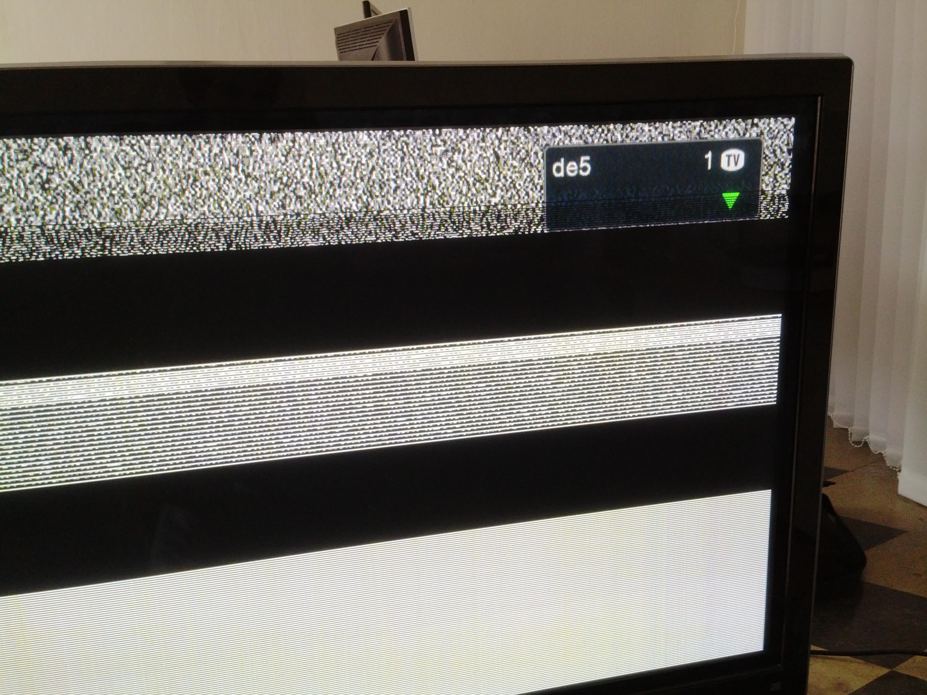

            I had a hitachi with blown Y-buffer ICs, but I was able to get a picture on parts of the screen after desoldering the bad ICs. Try to unplug all of the cables going into the Y-main and turn the tv on. Then plug the Y-main back in and unplug the X-main and see what happens then. Also the Vscan on my tv was acting weird (unstable), you should check it as well.
            If you get a picture do not leave the tv on for very long with the Y-buffer with the removed IC. My tv just kept destroying more ICs, but maybe that was due to the unstable Vscan and not the missing ICs.

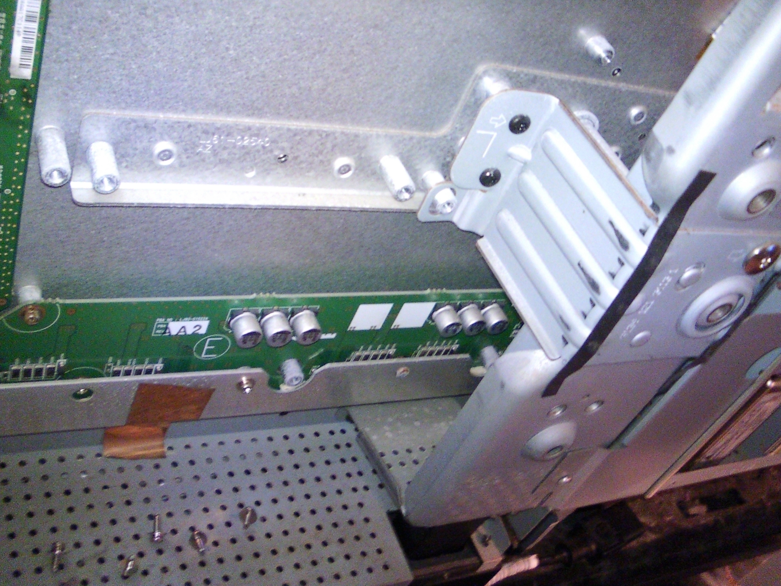

              That's why I was asking what to expect. I found the video about testing the buffers for shorts. Sure enough the one that went "Boom" had several lines with snorts and shorts on that one buffer chip. The rest tested okay using the multimeter quick and dirty method.
              I carefully removed that one blown chip. Managed to have only minor damage to one solder pad and I think it's saveable. (small small jumper should do the trick, just need to update my soldering stuff....or see if I can solder pad it like I've had to do in the past for slightly larger stuff)
              At any rate. With that chip removed, I still get 100% nothing on the screen. The rest of the buffers get hot to the touch, but not the "Let's blow off the board" kind of hot. Sense I do not know how warm these should run, I'm guessing.

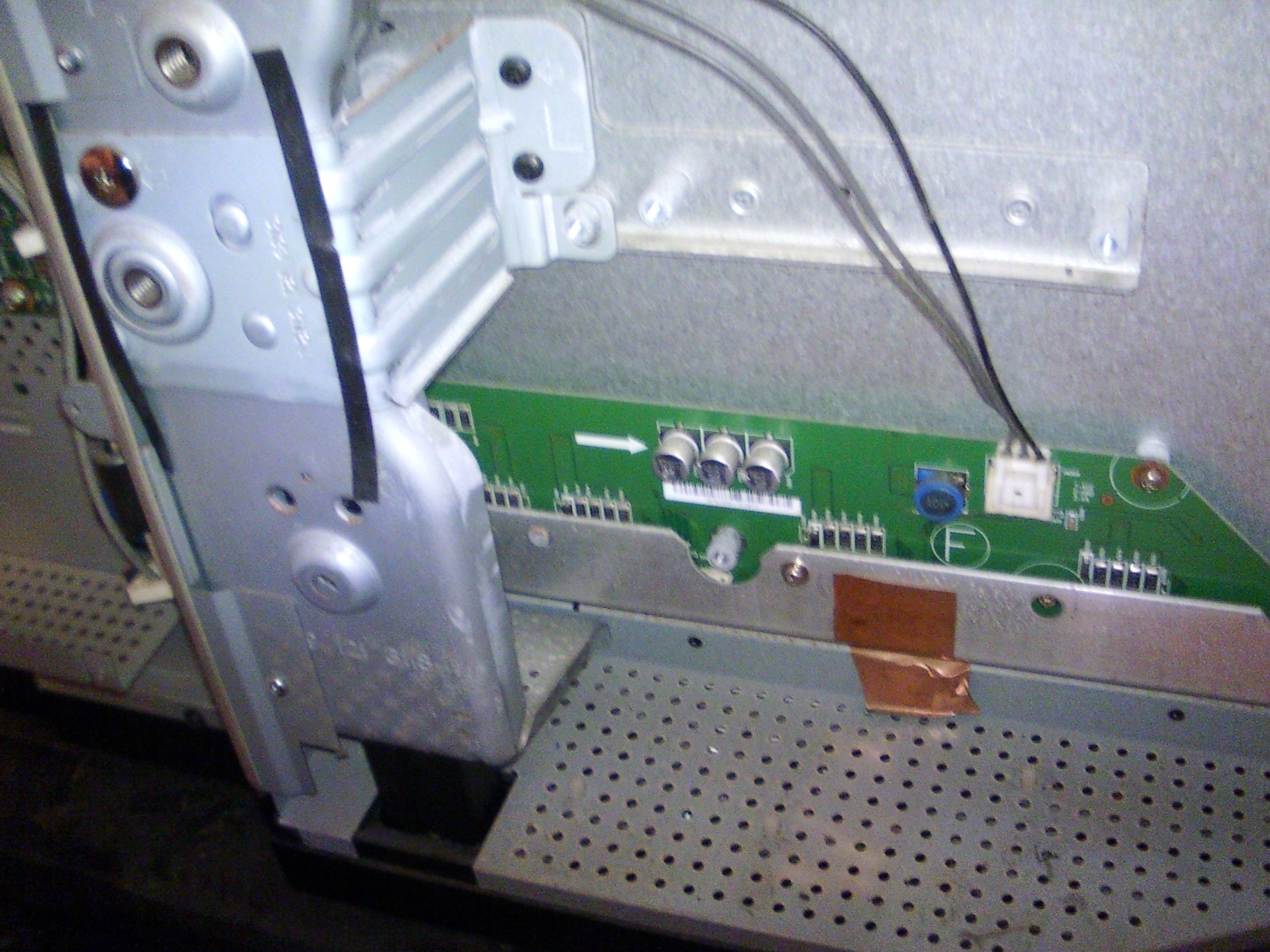

              Yes the lower board is present, it's a 2 sectional type that is covered by a metal shield. No smoke and such from there.
              I did locate another **grrrr** blown capacitor on that board. 25volt 680uf made by "SanWa" I found an electronics company in the NYC area that had a 10 pack with the same specs by Rubycon for about 7bucks with free shipping. But honestly--Even with bloated capacitors I would imagine I would see something on the screen--probably garbage, but there should be something. It's just "Blackness". The only time I did see something? Was when the chip was blowing. And it was just a thin area of flashing white dots in the same area code as the chip.

                      There is the one long buffer board on the left side directly attached to the Y board. It has 12 buffer chips.
                      The board on the lower side is the two long boards with the wiring pigtail connector/bridge. (Sounds very much like the one you repaired)
                      I currently have the Y board out so I can inspect it for cold solder joints. I can reinstall it and fire it back up. I might wind up relocating this in my 'office' so I can get around 360deg's. My bench is against a wall and it's a rather large object that's hard to work around. I'll get my face up to the screen and see if I can view any 'glow' once the board is back in.

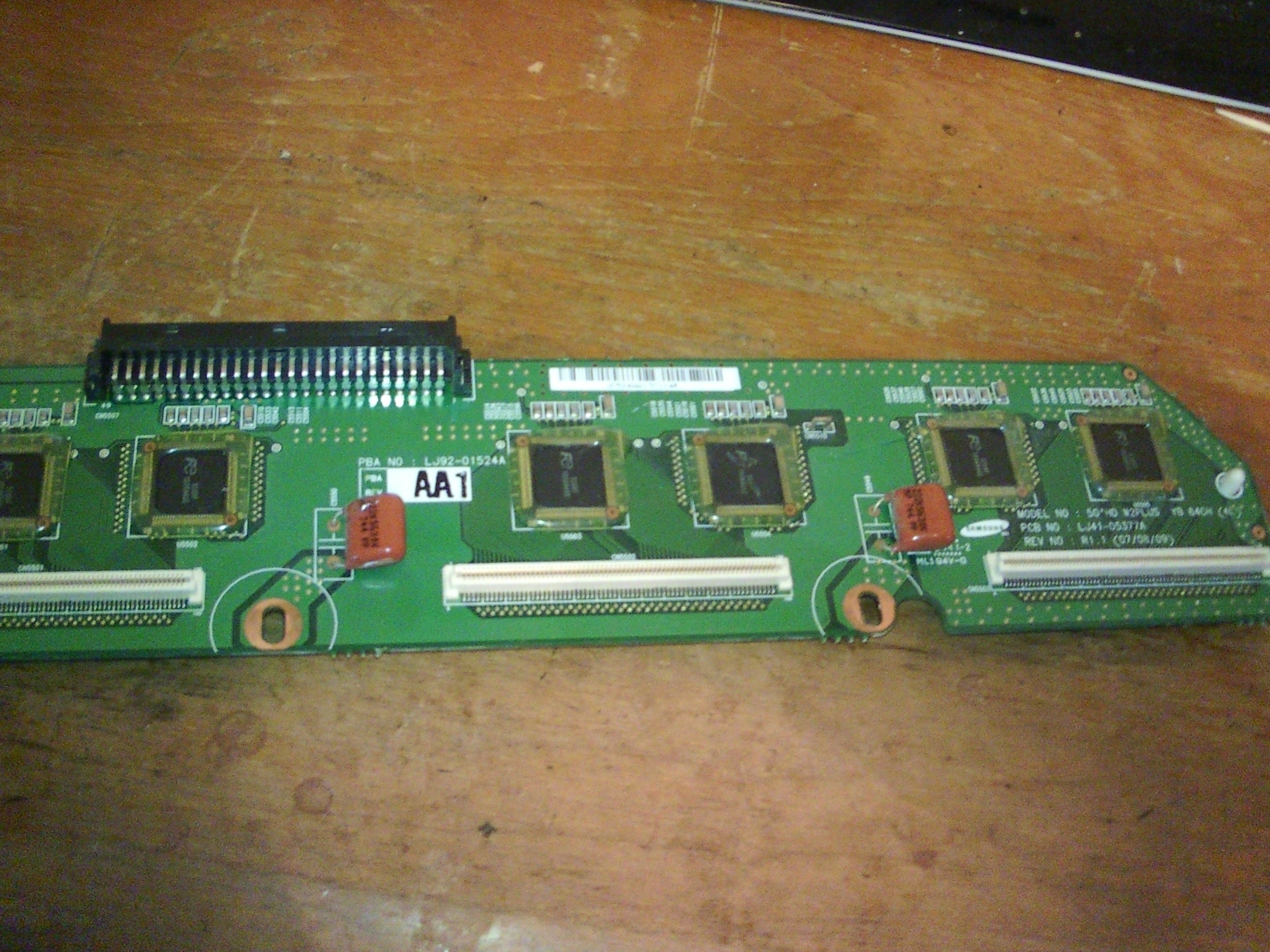

                            So I just took about 20 minutes out of my day to upload a few photos to save confusion.
                            Another post regarding the Phillips using Samsung parts is that a lot of the "Samsung Rules" may or may not apply. So when I double checked the green light I removed power and disconnected the ribbon cable. Powered up and the green light was NOT lit. Reversed the process and turned the set back on--the green light then lit. So it might also make sense that the green light could point towards having a data stream from the CPU board, and that if the light is NOT on--then it could be missing the signal. This is due also with consideration of where that light is, which is 1/2" from the ribbon cable.
                            The two parts that I found bad, K2837 (switches on and then bleeds back to full resistance within seconds. Not typical behavior when compared to others of the same part number) and 88N30W (blown, no switching action and source/drain dead short)
                            I'm still trying to further research: RJH3047 (Looks like a normal transistor, but can't find a decent data sheet for it) And STTH20P035 Which doing a search of the forum yielded results and helped explain what it might be.

                                  Ok here is the source of at least some of the confusion in this thread. The OP appears to have this YBuffer board
                                  http://www.shopjimmy.com/samsung-lj9...scan-drive.htm
                                  So no upper/lower we were imagining and hence when we reference the lower buffer the OP naturally responds about the address buffers. Mystery solved lol.
                                  So yes the YMain needs to be repaired and as freak points out the removed ic should be reinspected to ensure there are no shorts remaining. Then it's a matter of replacing the ic or the whole buffer board if all goes well up to that point.

                                        Bottom line, either replacement buffer and ymain or component repair of both
                                        The ymain may just need replaced of the shorted 88N30W FETs. I got lucky with 3 TVs and it was just those, I do have one here (samsung)which has those plus the 2SK2837 is short along with the SMD FET STB20NK50Z TO263 17A 500V is also shorted. Also had blown PSU and shorted upper buffer ICs.
                                        If you got the ymain going and managed to identify and remove the shorted buffer ICs, it may generate a picture on the balance of the good ICs . i have seen a video where someone had removed them and for a test produced a partial picture on what was left . Not something I've done and I have no experience replacing or hand soldering buffer ICs.
                                        Here are two videos of me doing that (starting the tv with removed ICs).
                                        First should be with some of the ribbon cables detached and the second with them attached.
                                        https://www.youtube.com/watch?v=Va9j...ature=youtu.be
                                        https://www.youtube.com/watch?v=GyTx...ature=youtu.be
                                        P.S. My phone's memory was low so the video was glitchy so I'll add a photo.
