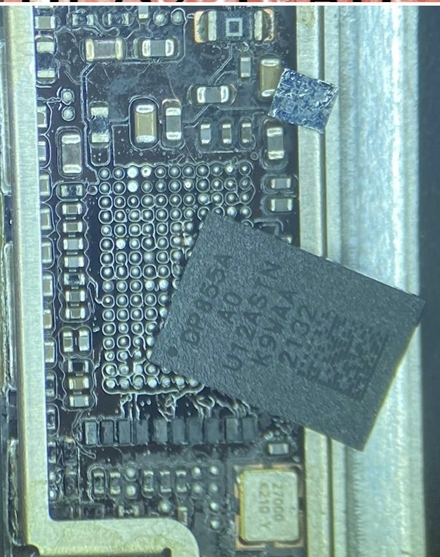

MacBook Pro 14". The screen DP chip failed.
  • SSBDADC234
    • Dec 2023
    • 6
    • korea
    When replacing the screen of this MacBook model, the DP855A chip must be moved from the existing screen for the screen to operate properly.
    However, when I removed the DP855A chip from the existing screen, I must have done something wrong and the chip broke.
    Testing the chip pins with a multimeter revealed a short circuit inside the chip.
    Is it impossible to repair this? I couldn't find a programmer for this chip, nor any eeprom programmer software.​
